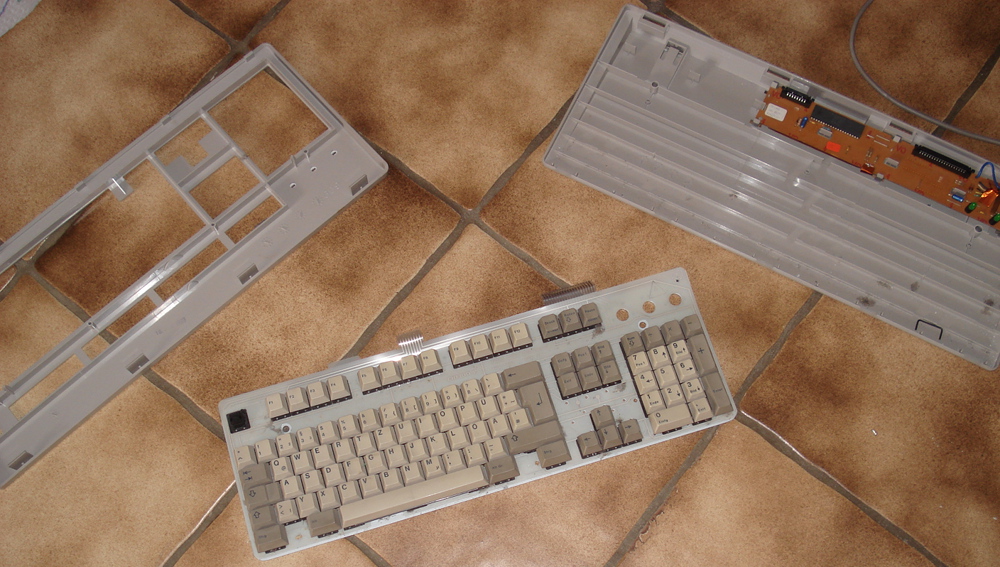

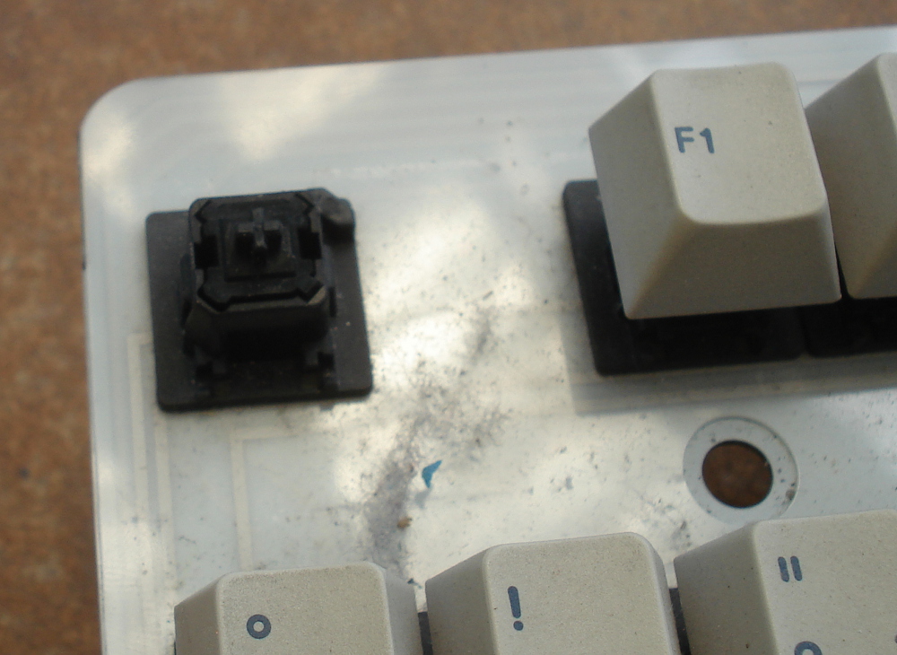

I've opened up this old olivetti board and would like some help identifying the switches. They kind of look like black MYs but don't feel like rubber domes.
overview
overview
switch
switch

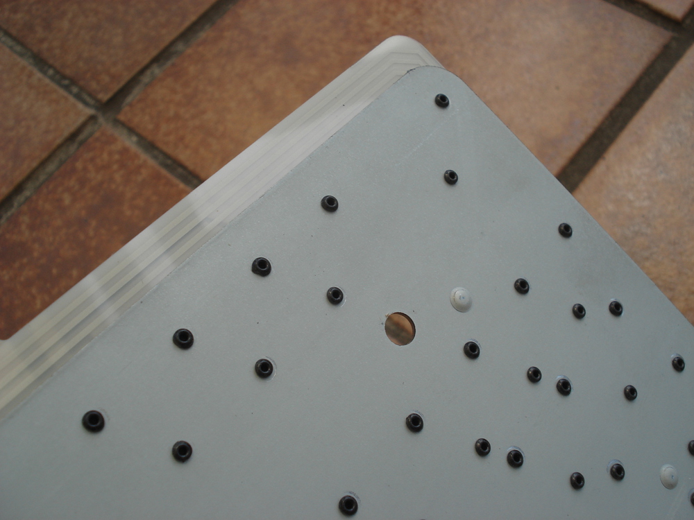

I can't open the switches without destroying them because they are mounted using plastic nubs.
switch fixtures
switch fixtures

Posted: 21 Jun 2012, 12:49
by 7bit
MY, the older variant.

So is it actually a rubber dome? Feels pretty damn linear to me.
Posted: 21 Jun 2012, 12:58
by off
Correct. And indeed, they feel nothing like rubber domes, but have fun typing on them for a while. :P
Also dismantling the switch can easily be done while mounted, much easier actually than what I did initially (cutting off the plastic nibs, and when done flowing superglue over that side (where the nibs used to be)):
Just take two small screwdrivers, or screwdriver bits, flat, and put them into those two slots. Tilt them outwards so the tips tilt inwards and release the plastic clips, while pulling up. You will be left with the insert, and a spring. The contact itself is inserted into the plastic holder from the bottom, so to get at that you'd have to cut them off; but no point in getting to those anyway, so.. ;)
quick pre-post edit: no rubber in this board. A membrane, yes.
