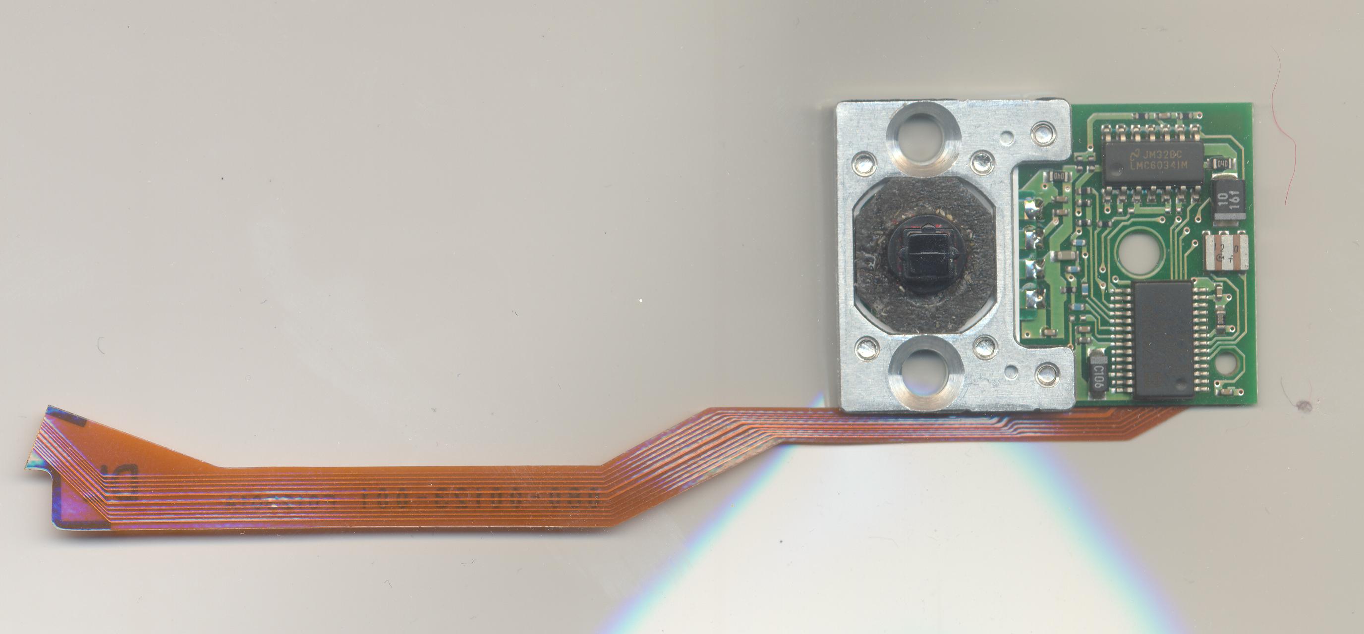

free to good home:
Trackpoint 001.jpg (195.91 KiB) Viewed 10199 times
Posted: 15 Oct 2012, 20:18
by Input Nirvana
So 4 of the 10 contacts the ribbon connects to, are the 4 usb wires (or ps/2). Those would be the only connections needed.
Am I seeing/understanding this correctly?
Posted: 15 Oct 2012, 23:30
by wcass
input nirvana wrote:So 4 of the 10 contacts the ribbon connects to, are the 4 usb wires (or ps/2). Those would be the only connections needed.
yes, i believe that 4 of these are PS2.

Posted: 23 Oct 2012, 02:13
by Input Nirvana
Wcass sent me the trackpoint shown above from an IBM G40.....2388-BBG (Thank you!)
At some point, I'll find the pinouts, maybe test with a meter, solder intermediate connecting wires directly to the pcb, and then to a passive ps/2>usb adapter which will connect to a 4 port usb hub located in the Kinesis. Locate the 3 button connections (I know each button has 2 wires...the buttons must just be contact switches). The other 4 wires are the ps/2 connections.
Of course, that's assuming Mac OSX will have no issues with it, just like the trackpoint from the KPD8923 is problem-free.
Icarium: Now that I'm holding the tiny thing in my hand, you're right, cementing the extended post will be a bit of a challenge if nothing else than other due to the very small size. It's all about the glue.

Posted: 23 Oct 2012, 04:37
by Input Nirvana
Looks like a PTPM754DB just like in Icariums datasheet link...not that I'm familiar...I'm not an electronics guy.
So according to some schematics, I'm thinking this is a Trackpoint IV, with firmware 3E.
I noted on Icariums photos, he had 7 wires (4 for the ps/2 and only 3 for the buttons, not 6 for in/out buttons?)
So maybe the 10 contacts to the ribbon are the same?

Posted: 23 Oct 2012, 15:50
by Input Nirvana
Thanks you guys...looks to be very similar. I've taken a look at the data sheets and the links to posts and pics. I feel confident that the pinouts may be the same. I already figured the 2 middle pins were for power and ground since they had the larger traces...and that matches your pinouts. I don't think I can go wrong as long as I have power and ground.
So for the 3 buttons,there is a wire going to each contact switch, then the other side of the switch goes to any ground, correct?
What is the 'reset' for, and what will it be connected to?
