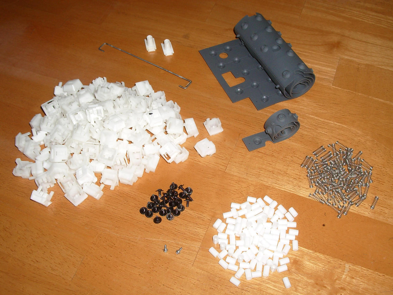

In case anyone was actually wondering what's inside a Peerless keyboard:
(Except there's one more stabiliser insert.)
I'm not entirely sure how it works, but essentially you have a hollow Battleship peg that sits on top of the dome, with a spring inside. I can only guess that the "give" point of the dome fires a shockwave through the spring.
More pics when I get chance. Strangely, I didn't lose one single screw, white cylinder, or spring, but one of the lugs that holds the case closed, broke. Losers were too cheap to secure the case with screws!

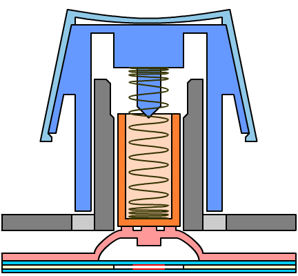

Posted: 25 Jun 2013, 00:20
by Daniel Beardsmore
The diagram is pretty (though I'd use the actual colours), but it's even more misleading than Lethal Squirrel's MX blue animation. For some reason, people who make animated GIFs give the keycap linear motion, even though that's not what happens in real life (otherwise it wouldn't be a tactile switch!)
I've tried to press the switch down enough that it actuates and doesn't bottom out, and it's impossible. Actuation occurs very low down in the stroke, like Model M, and the slider immediately bottoms out at that point (while hardly moving at all). The coil spring brings the actuation point down so far that you get a stiff linear feel. It's like a quiet Model M, except even more linear.
