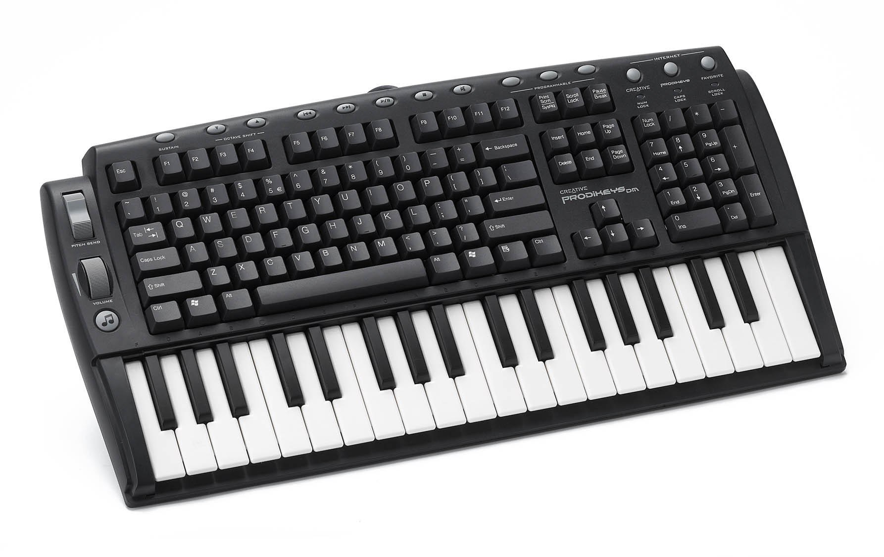

Posted: 22 Oct 2013, 17:40
by Peter
Muirium wrote:Ooh, cool! Makes sense it would be something good, sensitive and linear. As far as I know they just sample at two points, but a fully tracked system comes to mind!
Reminded me of this :
Knowing Creative, the keyboard is probably just rubber-dome mush ..
Maybe even both of them :(

Peter wrote: Knowing Creative, the keyboard is probably just rubber-dome mush ..
It really is! I saw one at a radio club junk sale and gave it a poke: not good. Most Creative! Absurdly, it was literally the only keyboard on sale there.
