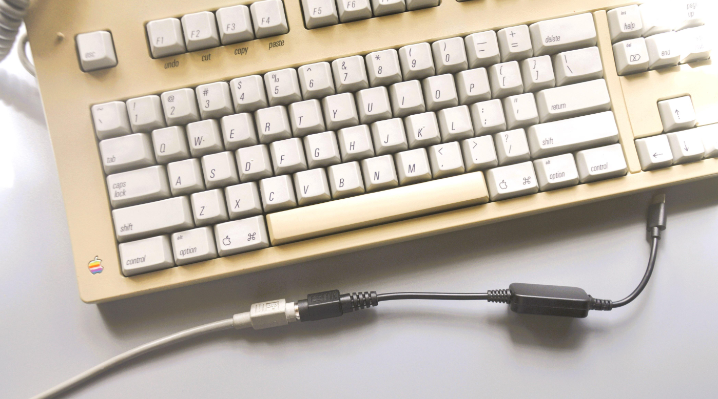

The most common Alps keyboards IMHO are Apple Extended II keyboards (M3501). These are easily available. In general, they
are fairly inexpensive. The most common ones use cream alps switches which are silenced tactile switches. Some people might find these mushy but if you look hard enough, you can find some with tactile orange alps switches.
The downside to this is these vintage Apple boards will require a ADB -> USB converter (TMK ADB converter, etc). Those are a little harder to find compared to the AT/PS/2 -> USB active converters (unless you build your own).
No matter which option you choose, it will typically require a fair bit of research and time to get done. I wish the best of luck and a welcome to the world of vintage keyboards.

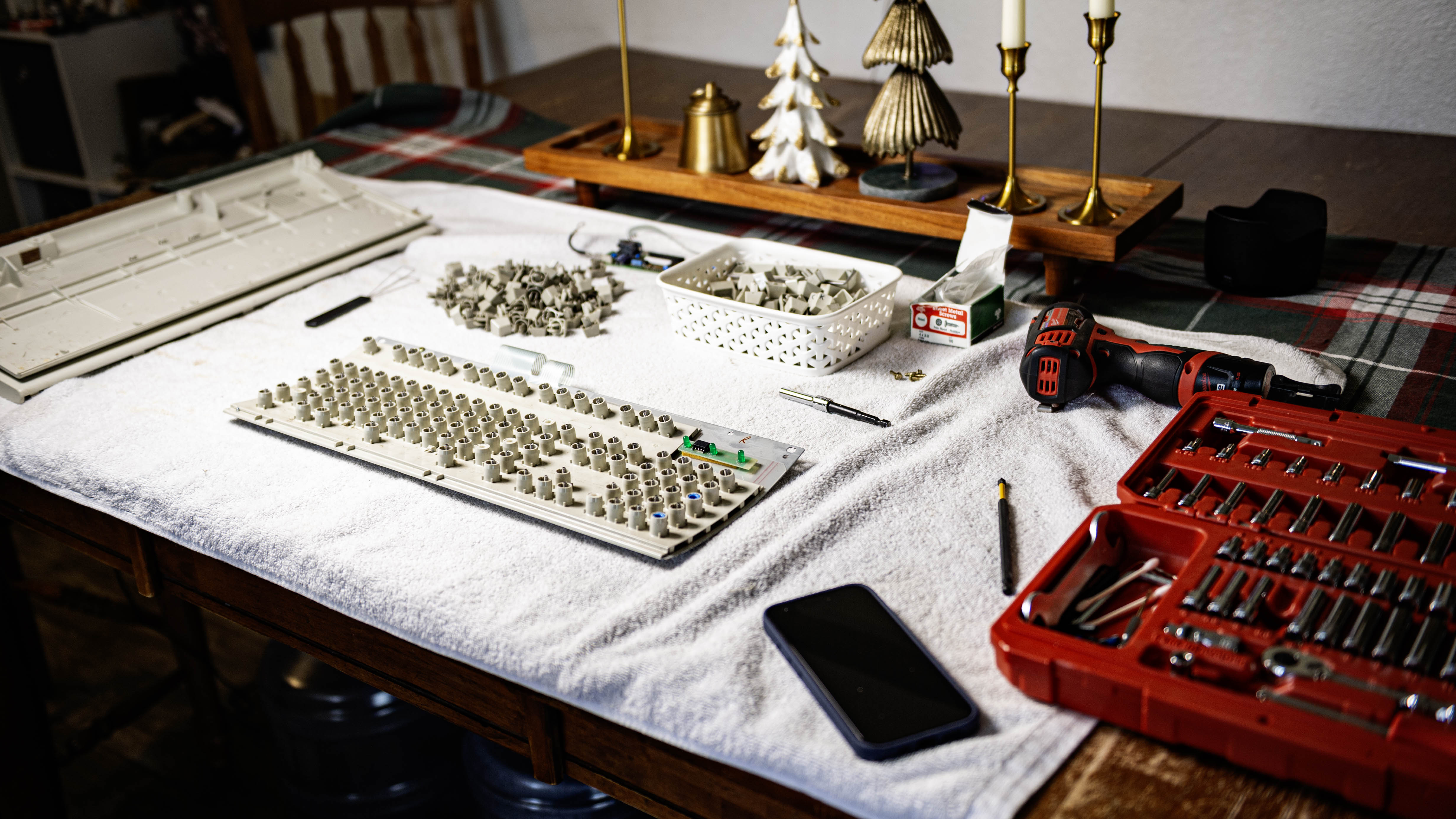

I want to point out for anyone looking to buy a vintage Model M, or probably a lot of vintage things: they are a rabbit hole.
My story went like this: I used Model Ms in elementary and middle school in the labs (we were/are a Mac household), and I thought them better than the Alps board on my Mac SE. Some time marched on, we got membrane Apple boards, and then I got tasked with the job of trying to help a friend's parents get him a computer, which meant police discard sourced IBM PC XT 286s among other similarly 10 year old technologically irrelevant 'junk' (they are far from being junk, but they serve no useful purpose then or now beyond exploring the past and playing old games). At that time, Apple was 'going out of business' and my dad bought me an Aptiva so I could learn how to use 'what everyone else is using.' I ended up running one of the Ms that came with those XT 286s on that Aptiva, convinced they were the best keyboard ever made.
USB became a standard, and that resulted in me abandoning all my vintage keyboards in a closet. But I longed for the feel of an M. A couple of years ago, I was lamenting this on a non-computer forum full of engineers, having bought Keychron Cherry boards, and they told me about Unicomp. I bought one for my home office... and shortly bought another for my mobile office. Then I pulled one of my IBM Ms out of storage, bought a converter, and... well the IBM model is a lot nicer than the Unicomp. And with converters, a Battleship/Battlecruiser can be made to do all kinds of useful single-button actions not available on a regular board.
In that time I have since bought eight IBM-designed mechanism keyboards: one 101-key IBM M, one IBM Type II battleship (that I destroyed trying to bolt mod and ultimately donated to Brandon Ermita), four Type I M battleships (a 1985 IBM, a 1988 IBM, a 1995-ish Lexmark and a 2000ish Unicomp), a Model F Projects Beamspring battleship, two complete custom key sets from Unicomp, a bunch of other keys besides, 75 relgendable keycaps from Joe, four Tinkerboy converters, a Focus FK-9000, and I have an IBM Model F Battleship currently on its way on UPS. If I haven't spent five grand on this yet, I'd be surprised. It also resulted in me buying two current production models of my favourite trackball from back in the day, currently the X-Keys L-Track.
I'm not saying it isn't worth it; any interest/hobby/obession is worth it if it brings you joy, and typing on these solid old reminders that modern disposable crap really is modern disposable crap, with everything exactly as I want it in front of me, brings me great joy. But I have been blessed with the financial comfort and the understanding wife to let me go this far into the rabbit hole... and you mentioned the word cheap. As I say on the Sprinter forum to people who are looking for a 'cheap Mercedes Sprinter', if you are looking to avoid spending money, you're in the wrong place.

Pretty much in the same boat as you Green Maned Lion. Defiantly passed the five grand mark long ago. Twenty plus different variant model Ms and Fs. I would have to do a inventory check on my stock to know the exact amount. Haha. Problem is I say I'm done then the next thing you know I'm on ebay browsing Model Ms or Unicomp comes out with a limited Blacked Out board with black keys and I'm sucked right back in. Plus I enjoy overhauling Model Ms that have had a hard life and bring them back to their former glory.
