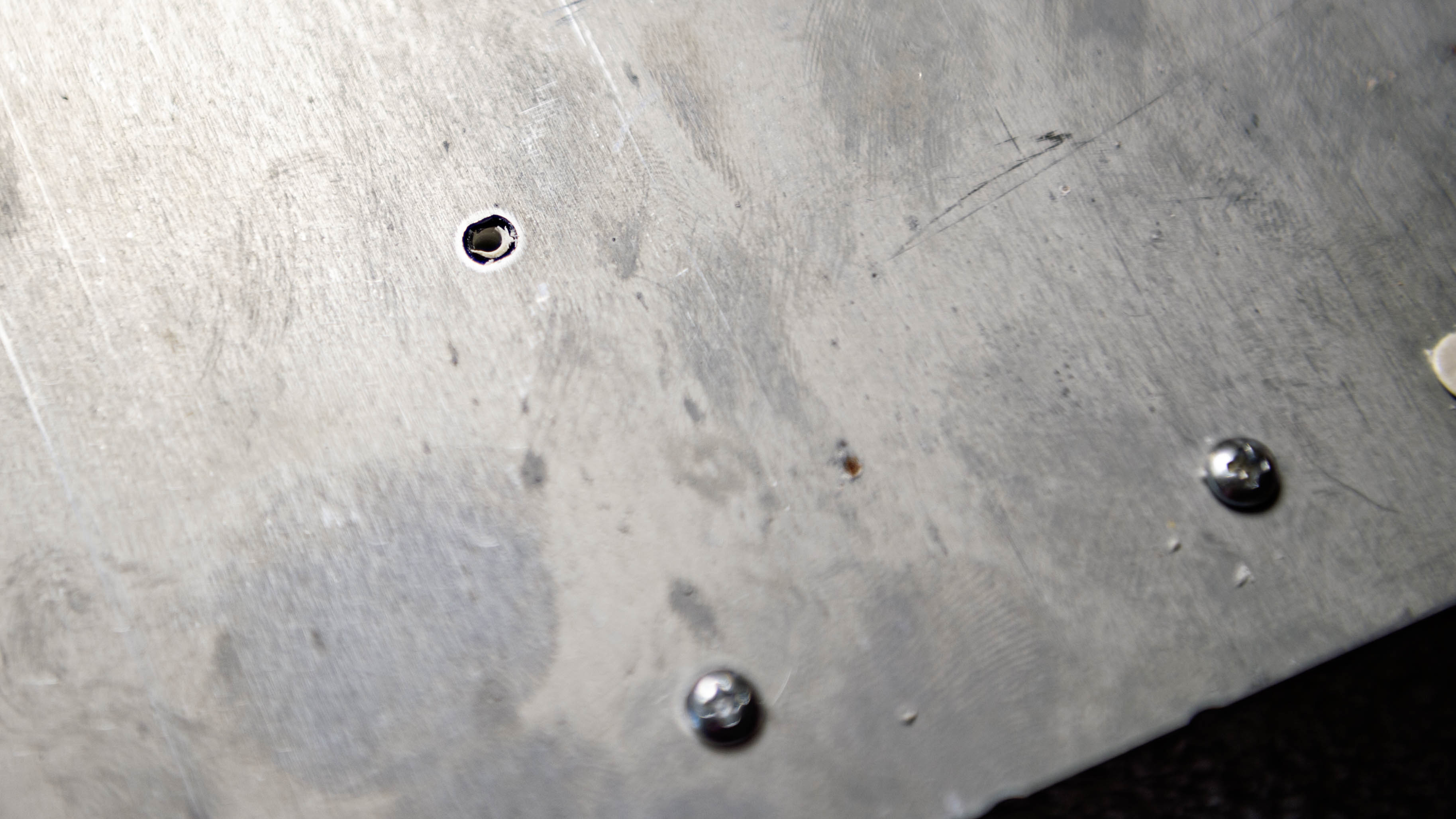

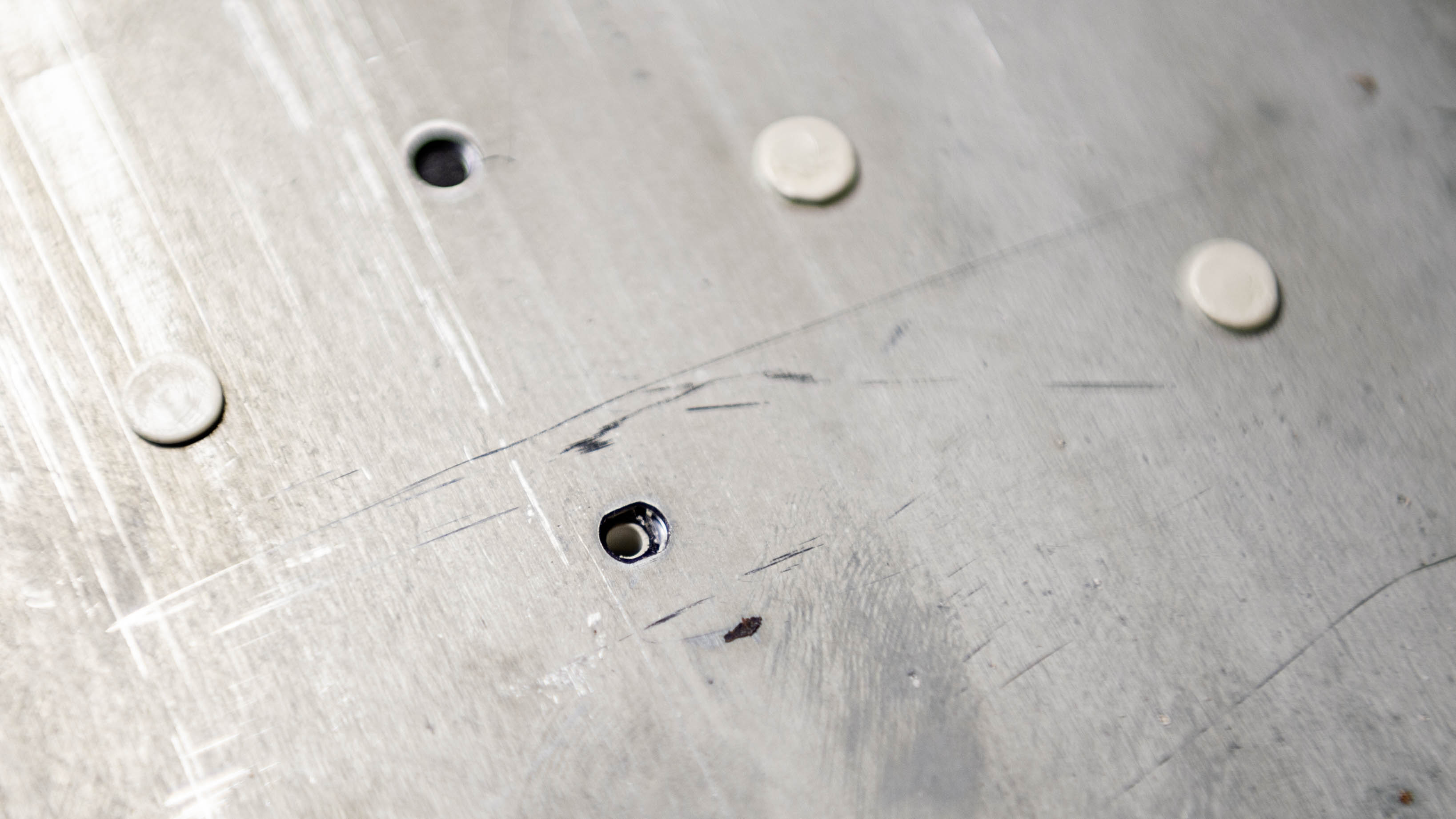

Thank you for your insights. The board probably needs a tear down but I have prided myself in keeping it as "stock" as possible. After studying the matter further, I believe the issue is a grounding problem. So I took the keyboard apart and tightened the screw holding down the grounding wire--it was indeed a bit loose. There are some detached plastic rivets in the number pad area of the keyboard, I will perhaps do a partial screw mod on that area and see if that fixes the ghost characters and clipboard problem. Lastly yes the controller in this keyboard has a date code of 4085 which I assume means the 40th week of 1985 and it does have the crystal 4MHz thing on it as well.

I have done a few partial screw mods with good results. Hopefully the controller is good. That could become a real headache.
