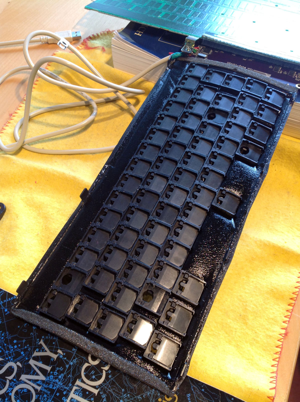

Hello,
I spilled a bit of coffee (black, no sugar) on my Mini M keyboard, not a lot, but some liquid did find its was into the hole by the support for the spacebar stabilizer.
I cleaned the keyboard and it has had a couple of days to dry. Sadly, some keys do not register (S, B, spacebar), and the N key registers while pressing some keys around it. I know I can sent the keyboard for repair to Unicomp, but I am wondering it there is something I can try to fix it myself, as the shipping from Canada will make sending it to fix not only take a long time, but also more expensive.
Does anyone know what I may try to do to fix it?
Kind regards.

My guess is some of the coffee got in the layers of the membrane and is causing the keys not to register. To fix this you’ll need to disassemble the board to access the membrane sheets to clean them off. Doing this will require you to break off your rivets on the back of the metal plate that hold the barrel assembly to the back plate, voiding your warranty and requiring a bolt or screw mod. You can find more info on the bolt/screw mod here:
viewtopic.php?t=9169
Once the membranes are accessible you can see where the coffee went, clean and test the contacts before reassembling.
In general this is a common practice, but I will caution that Unicomp told me they will not fix any keyboard that has a bolt or screw mod, so if you do this you can’t send it to them later.

They have to. When a membrane is shorted out by fluids, it’s so much work cracking everything apart just to clean it down, it’s not worth their time or materials.
If it’s worth yours: great. But a bolt / screw mod is the most invasive procedure imaginable for a keyboard. Open heart surgery, almost literally.

I am considering doing the screw mod to clean it, but I just re-tested the keyboard and to my surprise all the keys but B are working now! Perhaps I just need to wait for the liquid to dry completely? It has been 4 days since the spill.
A long time ago when I bought my Model M I put it on the dishwasher (it was incredibly filthy), I waited a few days for it to dry and it has been going strong ever since for more than 15 years now. Not that I am seriously considering it, but could perhaps giving the Mini M a 'rinse' be an option? At this point I will wait a bit to see if the B key starts working...

If the liquid was drawn between the layers by capillary action it could take a while. Putting it out in the sun could speed it up quite a bit.

Working with cheap membrane Chromebook keyboards, even if I flush the whole keyboard with isopropyl, I like to leave it on its side to drain (alternating sides occasionally) and let the alcohol evaporate for at least 24 hours or more. Water should take much longer and may or may not ever evaporate if it is trapped between layers of membrane without any exposure to ambient air. I have found wonderful mold colonies living inside membrane keyboards. Pressing random keys with the board unplugged might help move the unevaporated liquid around and/or expose it to air. I have seen totally dry coffee spills still prevent trackpads and keyboards from functioning as well (conductivity or resistance of the remaining residue maybe?), but that may have just been because the user just wiped the palmrest off and went on using it while the circuits cooked themselves and/or formed corrosion that wasn't externally visible.
Leave it unplugged a week and forget about it. The more you try to test it, the more damage shorts could be doing.
