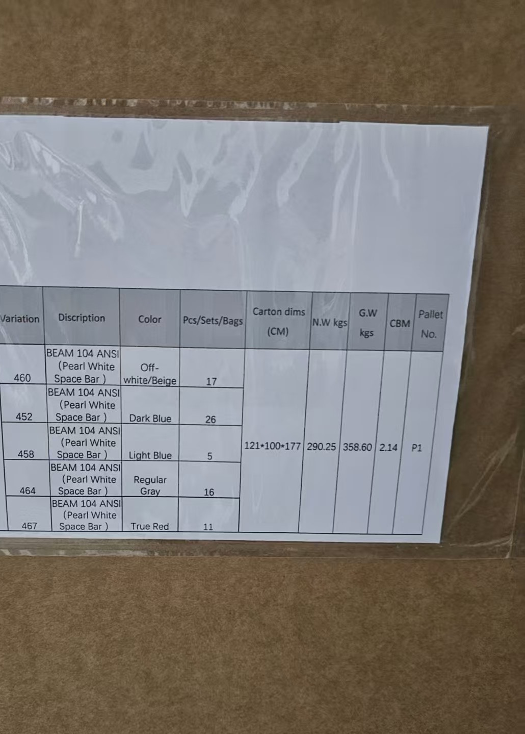

The first beam spring Round 2 pallet has been packed and sealed! They are still trying to get as many B104's finished in the coming weeks before the Chinese New Year. I've asked them to prioritize completing before CNY at least the quantity of each variation that has already been ordered, in case they can't finish everything. That way, those who have ordered can have a variation that can ship in late April/May after the container shipment is delivered.
The MX keycaps with the black (modifiers) and white (non-modifiers) keycap colors are selling out too quickly; please order the "all black keys with white text" version if possible.
