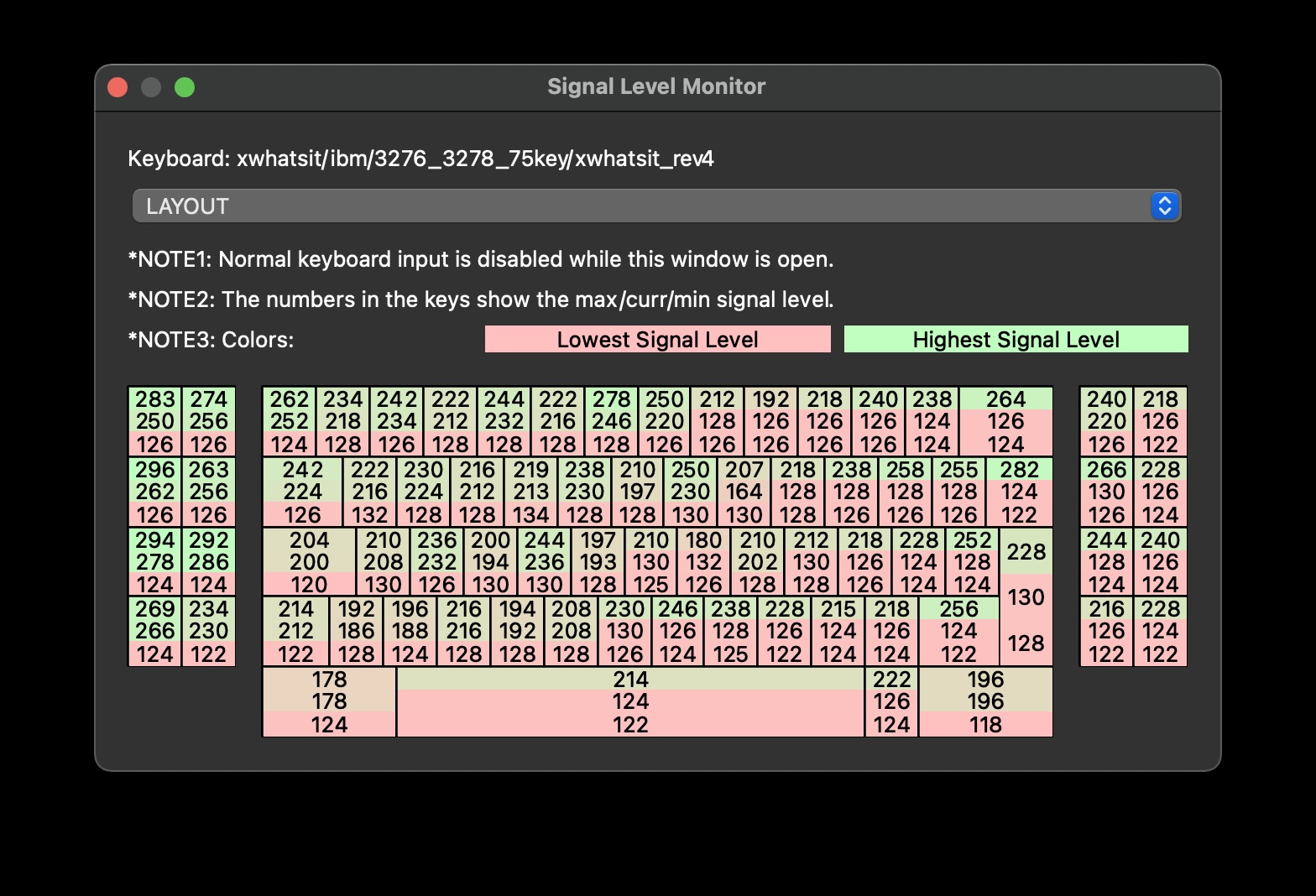

Correct. Only the bottom of the flipper, directly above the PCB, really matters for capsense. The downside I can think of with a thin conductive layer is wearing off with use. Capsense controllers are fairly forgiving—every key is effectively analog, as Pandrew’s signal meter shows—but if a thin conductive layer disintegrates with time, it will eventually disable the key until opened and replaced.
