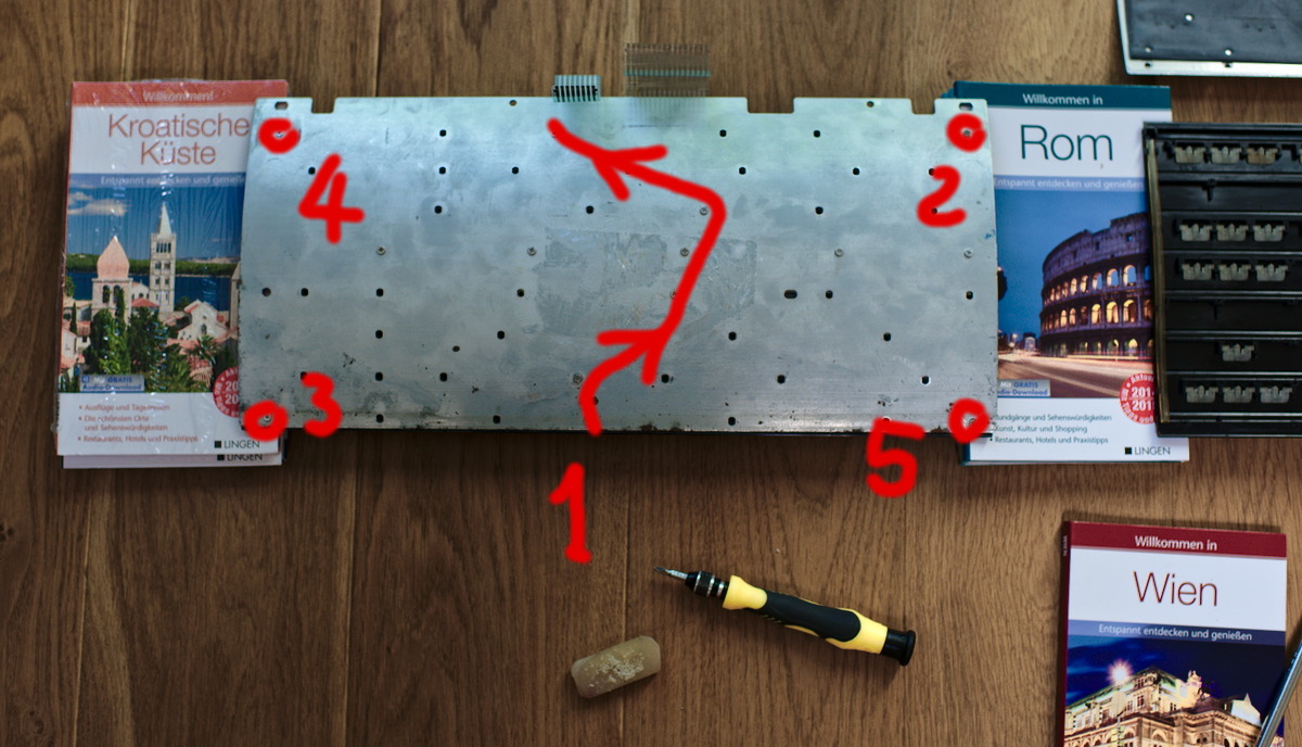

Time to screw ...
One of the most frustrating things with a bolt/screw mod is to complete the mod, place the caps back, and realise that they moved during the process. I found a procedure that normally works.
I start on the bottom of the board and WITHOUT FORCING THE BARRELS PLATE I keep on screwing up. When the board is back fixed with the forced bending, I screw the corners. This fixes all the flippers in place without needing to move the sandwich at all.
A picture is worth thousand words:
DSC_2888 - order.jpg (249.49 KiB) Viewed 6111 times

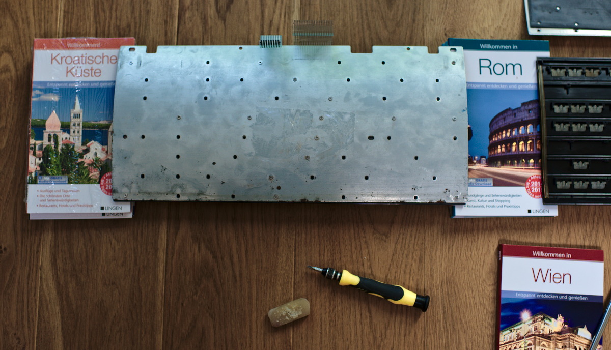

And there without the painting:
After this first phase, one can screw the remaining screws.
It is important NOT TO TIGHT THEM a lot. Actually I screw them until the end and then I UNDO ONE TURN.
Tightening too much will make the sandwich too rigid. Some keys may not work.
