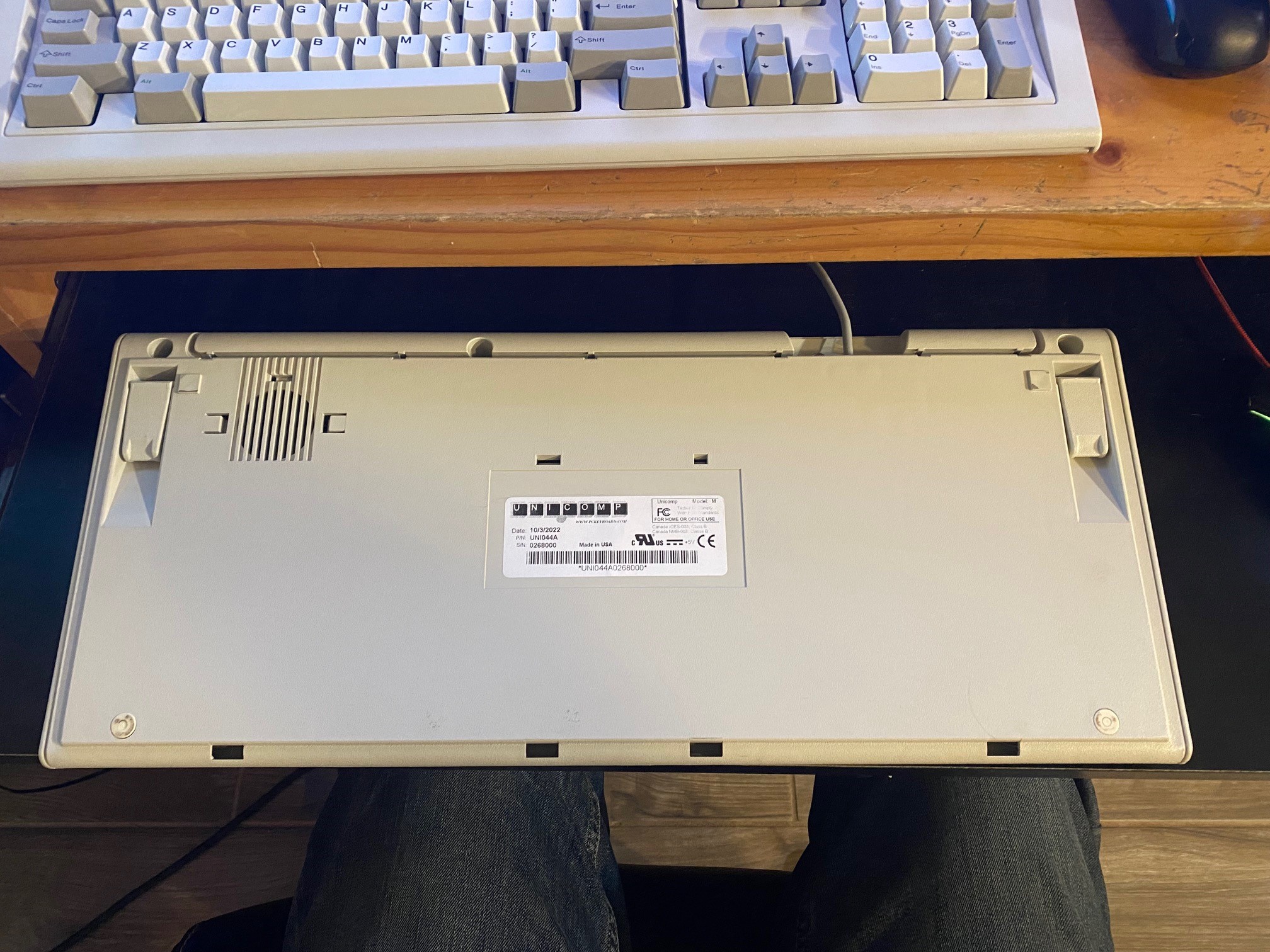

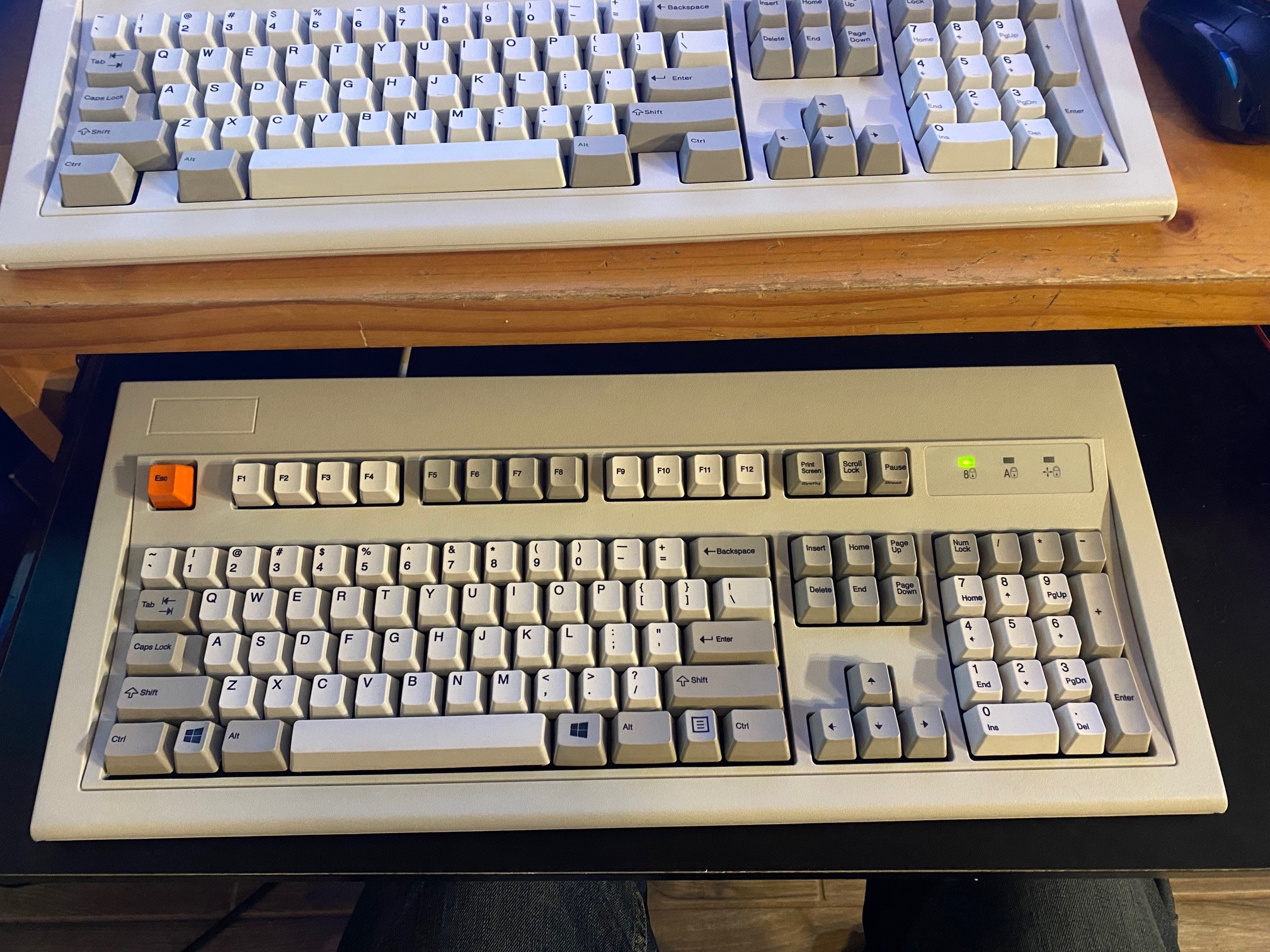

Took delivery of a new 104 Classic Unicomp Model M keyboard and I noticed the speaker hole has returned. Or has it always been there on the Unicomp model? Correct me if I'm wrong but I could have swore it was filled. By the way the typing feel and sound are awesome on this keyboard but the case plastic still isn't as good as the original. That's really where they drop the ball.

It also serves as a drainage hole, I suppose, though the clips definitely point to its design intent for holding a speaker that’s been absent since the Reagan administration…
- Location: Stockholm, Sweden
- DT Pro Member: 0011
Keyboards for the IBM RS/6000 had a speaker. It was wired to the unused pins of the PS/2 connector.
The holes in the front of the case are supposed to be for drainage.

I have handled Unicomp and Lexmark Model M cases with the speaker hole filled in. I was surprised to see it in this case. But maybe this version never had it filled. I know they have offered many version over the years. Or did Unicomp update some tooling or something recently?Muirium wrote: 20 Mar 2023, 12:41 When did the speaker get dropped? And has the case mold really not been tweaked since then?

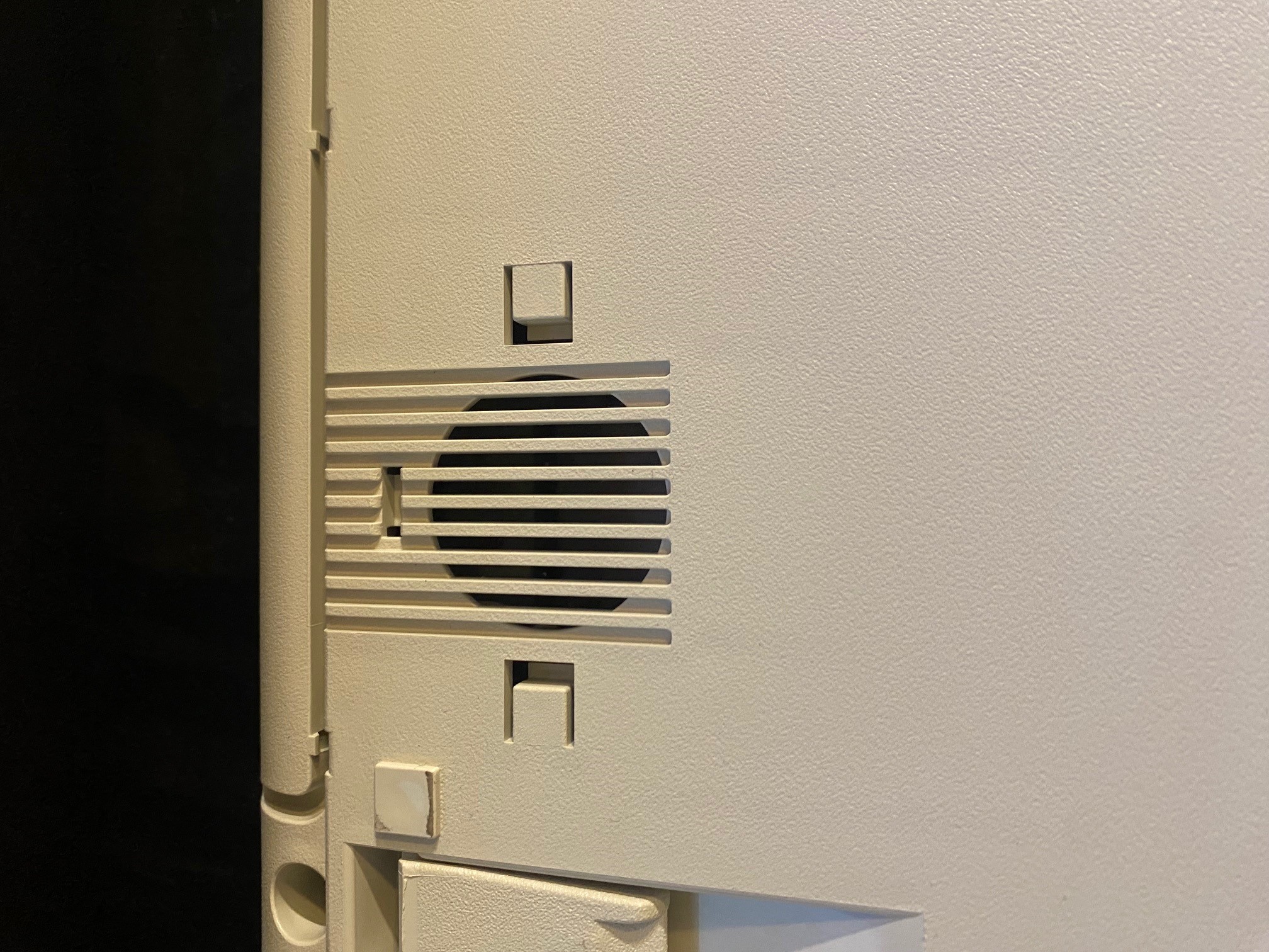

The back case piece seems to be made from the moulds IBM and Lexmark used for 102/103-key InfoWindow terminal keyboards such as P/N 1394204 (example #1, #2) - you can tell by the larger than usual [Type II/III/IV M122 style] flip-out feet and cable router that most Enhanced Keyboards/Unicomp Classics lack. If I were to guess based on the fact the original Enhanced Keyboard tooling was quite far gone at this point (for example, the flip-out feet of Unicomp Classics used to be quite mangled), they switched to less used tooling or they found some NOS parts to use? At least from the photo, the quality looks quite fresh. I guess I could just ask them, and I shall.
If it is a new manufacture, Unicomp products are now made of PC + ABS instead of PVC like most classic Ms. This change was made a while ago at this point, but with events like the EU seemingly soon banning all PVC, it's probably out of their control now.
1995 is when IBM/Lexmark introduced P/N 42H1292 and updated 13914xx that covered over the grille. However, this applied to PS/2 keyboards; their RS/6000 keyboards that were still manufactured for several more years were largely unaffected since those needed the speaker. So various tooling coexisted. The only noticable tooling tweak for Enhanced style keyboards since then I'm familiar with is was in 1999 when Unicomp made some college sports keyboards with a unique rounded 'squircle' badge. Although this was top case piece only and the style hasn't appeared since, I have no idea what happened to it.Muirium wrote: 20 Mar 2023, 12:41 When did the speaker get dropped? And has the case mold really not been tweaked since then?

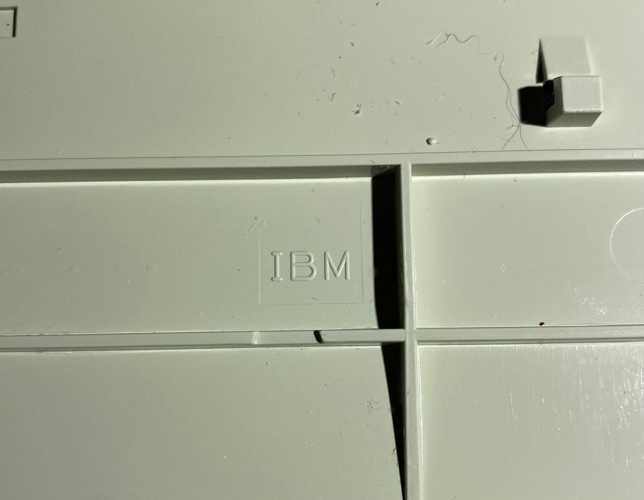

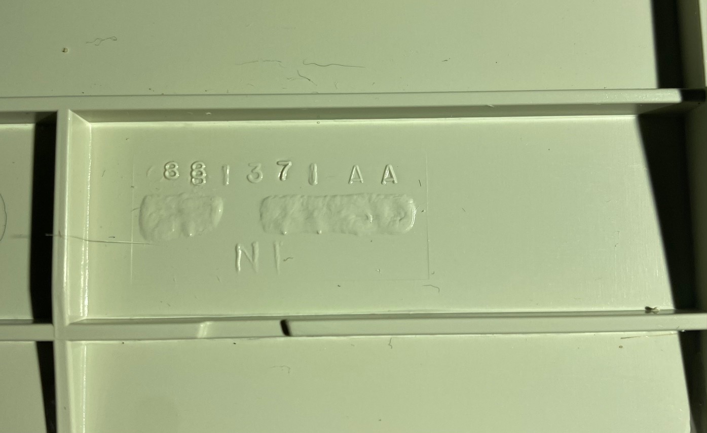

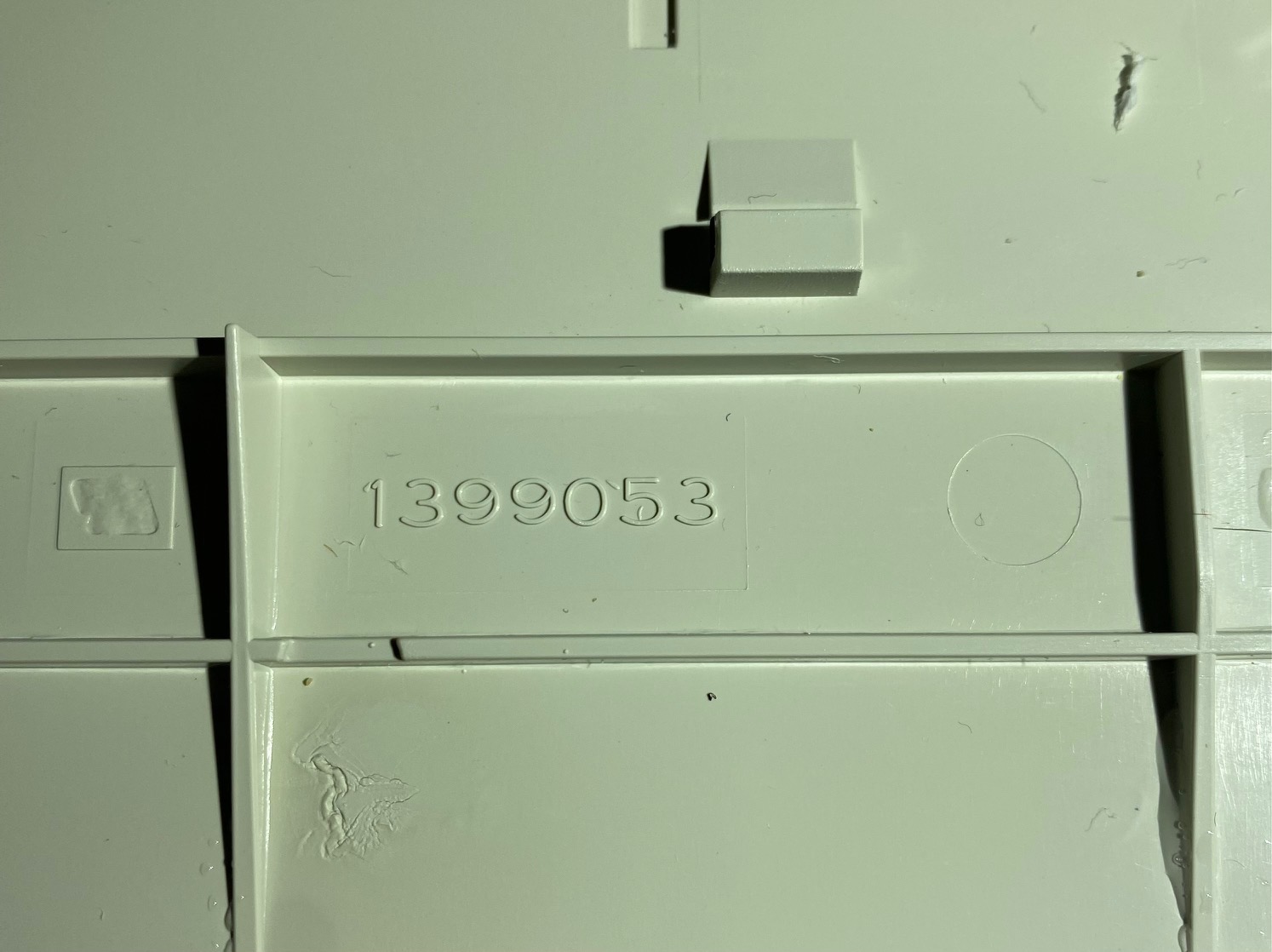

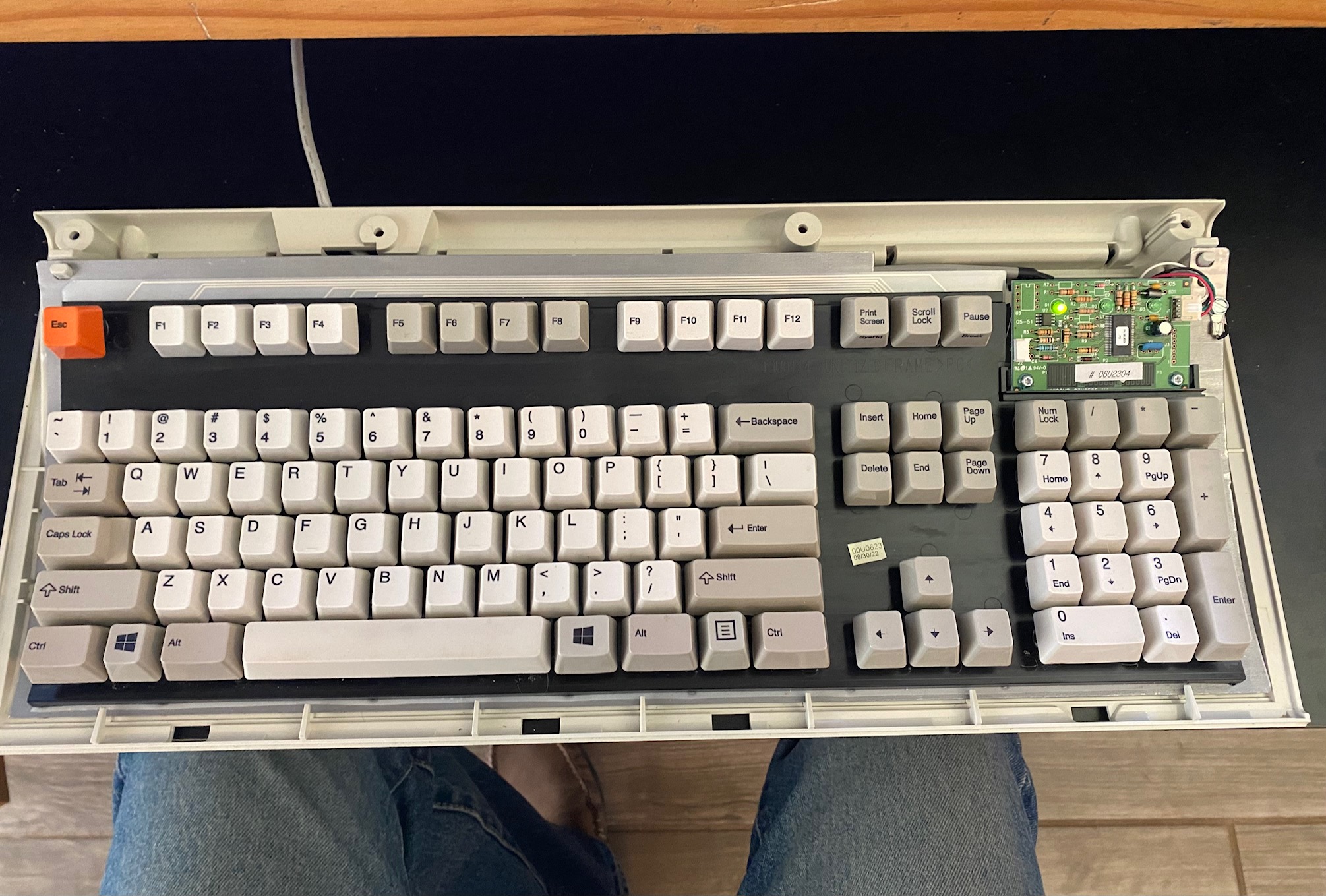

Follow up on this strange speaker hole in my Unicomp keyboard. Finally opened it up. Defiantly appears to be a new old stock part (1399053). Apparently the bottom of a Model M Terminal Keyboard.
Labeled IBM inside and feels like PVC. Has a different feel than the top of the keyboard.
Here are some photos.
