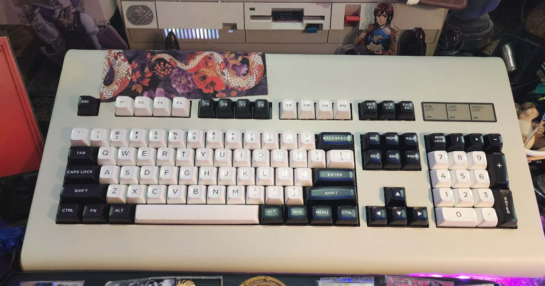

I just got mine in, and it's amazing to type on, the feel is buttery smooth yet with that tactile mechanical feedback - I didn't think the Model F repro could be surpassed but this did it.
Setup was painless and I'm more than satisfied - the wait was worth it!

I do have one question - my fingers are having a hard time adapting to this style keycap - is there a Cherry MX Set in existence that is basically on par with the Model M / F in terms of look and feel that I might be able to use on this?
EDIT: I found something on Amazon that might work, going to give it a try.

dr_xadium glad your keyboard arrived safely!
The project keycaps are designed to be like the original IBM beamspring caps which are spherical on the key top surface. Model F caps have a slight curve to their top. If you have any recommendations for MX caps like the Model F please do share after you end up testing them.

I recommend the transparent relegendables, or ordering two sets of the keycaps, since individual double shot keys are not available. Or you could use another MX type keyset since the project uses the MX stem on the beamspring modules.

About keycaps profiles: there was a thread some time ago that discussed in detail which MX profile was the closest to Model M/F.
I ended up putting a set of Drop MT3 keycaps on my B104. They are spherical (rather than cylindrical like M/F) and fit the aesthetic of beam spring keyboards yet I find them more comfortable to type than the default set that B104 comes with, although of course it’s all subjective. The only problem is that MT3 keycaps are not being made anymore, you will have to look for them on the secondhand market... or get MTNU keycaps which do not look as nice, in my opinion.

These are the keys I got from Amazon (I didn't swap out the spacebar because I don't have time to tackle that at the moment). They're shallower and a bit less sturdy-feeling than the IBMs which is to be expected, and they are slight misalignments in the printing (and some labels are completely different like on the numpad). These are, obviously, cheap caps hahaha.
Looks-wise from a distance it feels a bit more consistent with the other IBM tech I use, The color is basically on point, which helps my OCD. (I'm also going to change out the badge and the LED overlay to be more like a model F/M)
From a feel perspective, it's all right but I don't think any discerning keyboard fan would love them in the long term so I can't say "buy these now!". For a short term stopgap they're quite serviceable, and the beamspring's unique feedback profile helps them feel more premium than they are.

dr_xadium your setup looks great! A nice match with an IBM beamspring style keyboard. I like your PS/2-encased modern computer (?) too!
I'm extremely glad the off-white cases came in early--the beige looks so much better with these keycaps than the original black I selected!

GMK MTNU in finnish/swedish layout. MTNU has been the most problematic keycap profile that I have tried. The keys are held by only positive thoughts and possibly some ions form the air. The ISO enter actually falls of by just pressing other keys near it! I kid you not. Placing saran wrap between the keycap and the stem cross mounts seems to tighten the connection and helps a lot.
Cherry profile GMK Dolch double shots. Finnish/swedish layout. Cannot really capture it with my crappy phone camera, but it looks really, really beautifull. Keycaps are also held just fine, do not fall of like MTNU.
Random generic chinese SA profile keycaps bought form Aliexpress in danish/norweigian layout (because I thought it would fun to try Æ, Ø on my keyboard and now I cannot find the Ä and Ö keycaps).
