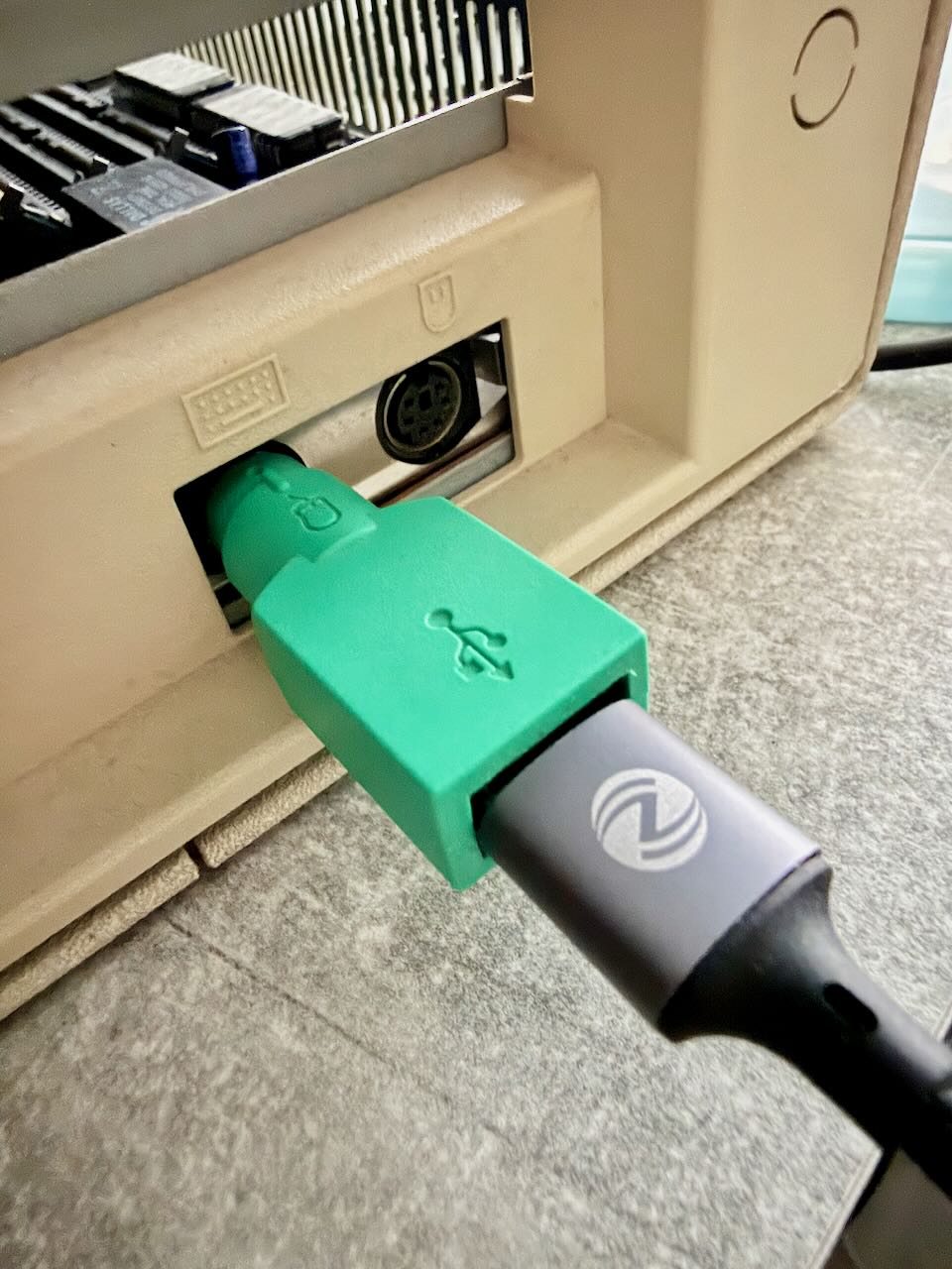

Some of you may remember from the new Model F megathread that I have made my own keyboard firmware (USB and key processing implementation from scratch), which also supports the new Model F keyboards. Anyway, one ambition I've had for this firmware was PS/2 output, since I'm also into retrocomputing and would like to use a "Model F" keyboard on vintage computers.
Well, I seem to have finally managed to do it: it just needs two free GPIO pins on the microcontroller, which the xwhatsit/wcass controller has (even conveniently located on a 6-pin header on the side), and either a PS/2 cable/connector wired directly to those, or (what I did) those pins can be wired to the USB connector's D+/D- pins and then one of those old passive USB to PS/2 dongles from the 90's can be used to share the same connector. (The dongles often came with early USB mice, and have the picture of a mouse on them, but they are just passive adapters and the PS/2 mouse and keyboard don't differ electrically at the connector.)

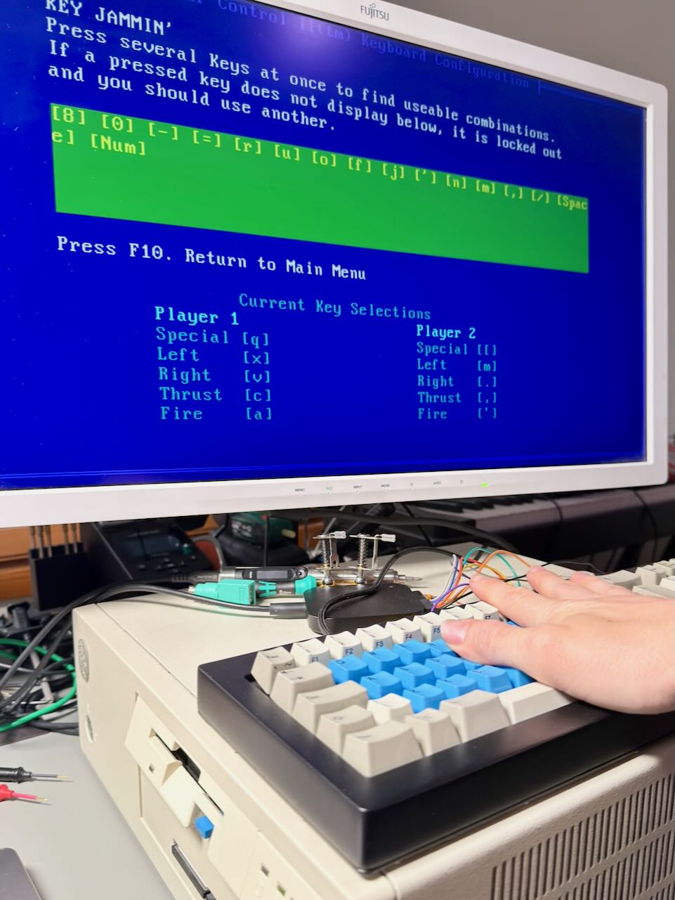

I tested it on a real IBM PS/2 as well as on my own earlier PS/2 to USB converter (yeah, it makes no sense to output PS/2 only to convert it back to USB, but for science (and debugging)), and commercial PS/2 to USB converter. After some initial mistakes and breaking out the logic analyzer (that I seldom bother to use, but really should do more), I think I have a pretty much complete emulation of the IBM Model M PS/2 keyboard that I used as reference, including all three keysets (many commercial keyboards don't even bother to support keyset 3 because Windows doesn't use it (probably because keyboards don't implement it), but I think Linux might benefit).
