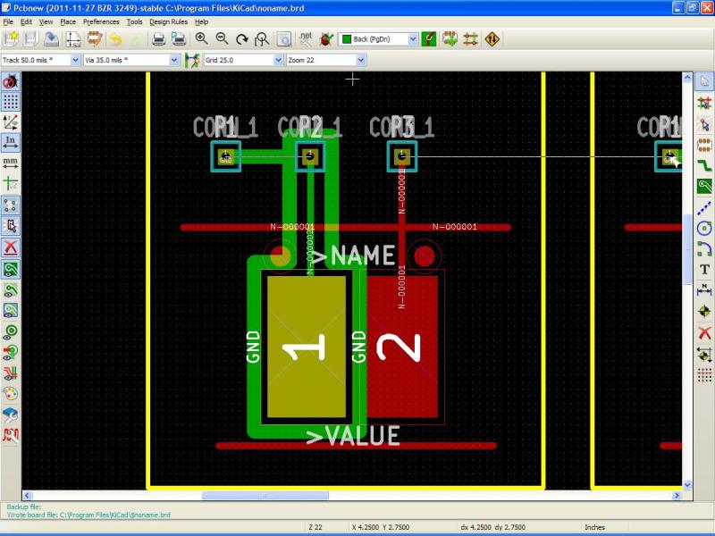

I printed out the switch and then compared it to the PCB - line-up by shining a light through it to check size and position. This led to more tweaking of measured values. I finished the KiCAD design and will try to make 6 one-key boards this weekend.
KiCAD switch test.JPG (89.14 KiB) Viewed 10478 times

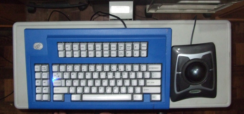

Adding LEDs is to be an optional part and it will not require drilling holes in the case. I am currently using what i call my Terminal SSK. The caps lock LED is under the caps lock key and the light spills out around the key. It is not as "in your face" as direct lighting but still very noticeable. This picture really doesn't do it justice as the human eye is better at discerning light difference than my camera.

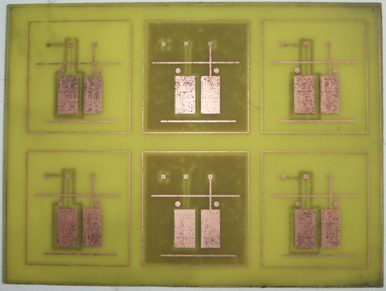

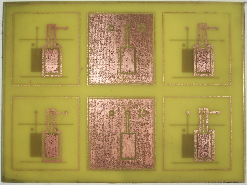

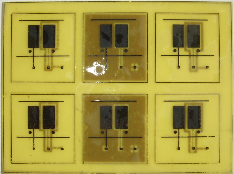

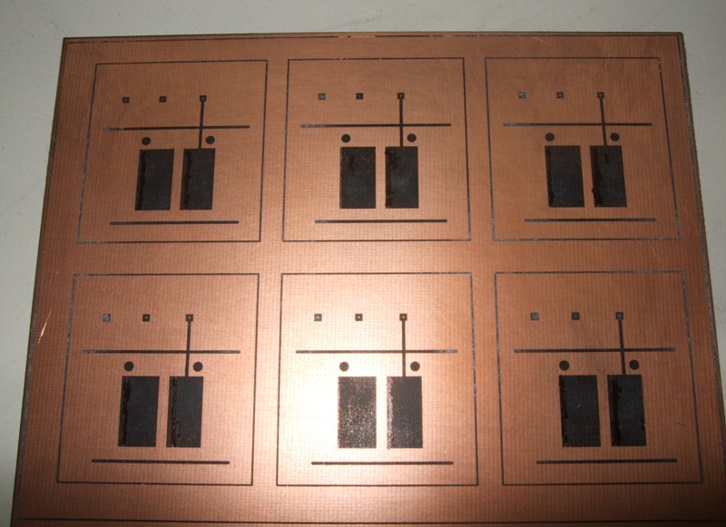

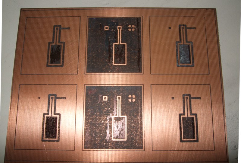

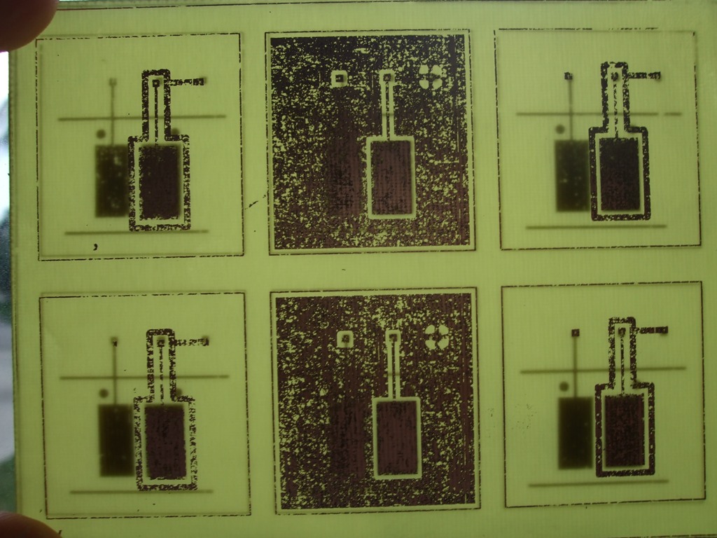

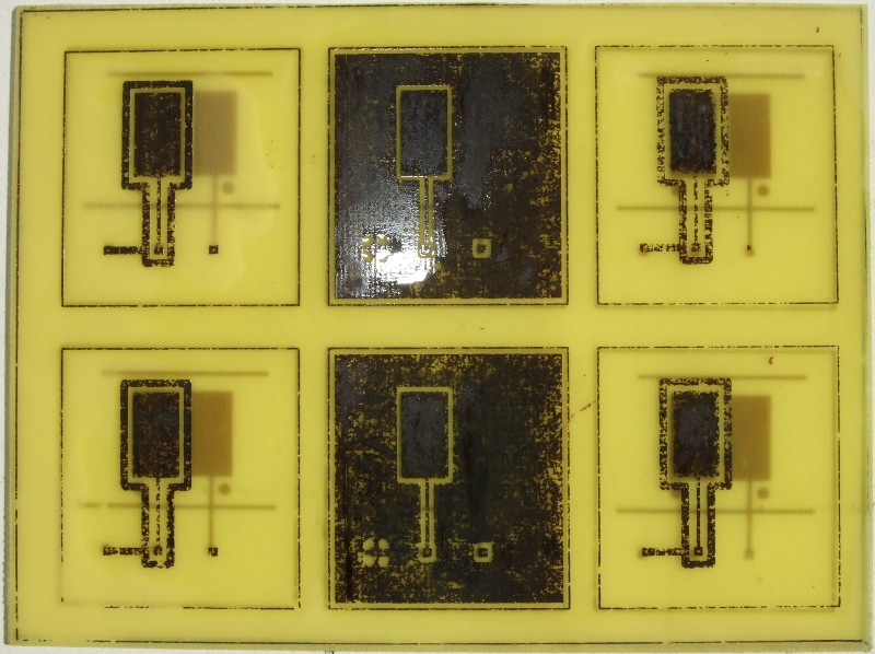

DIY PCB
This was my first time making a PCB at home. I thought I would share. If you plan on doing something like this for the first time, first read all of the How-To pages on the net and watch all of the videos on YouTube.
I used pages from a People magazine. I found 3 pages that mostly white, two of which were mostly monochromatic on the other side. I also selected two additional pages to use as tests. The pages were already 10.5 inches tall, so I cut the pages to 7.25 inches wide to make them “Executive” size. The first test page jammed, but the second one went through just fine. All three of the “good” pages jammed the printer just like the first test. I used the back cover as it was thicker and it passed through the printer just fine but bubbled slightly. A second attempt to print on a magazine cover produced a lot of bubbles, so now I believe that the outside covers of some magazines are covered with something that makes them unsuitable for toner transfer. I found more pages and just kept trying until I got both sides printed – and yeah, I had to clear about 8 more jams.
Most of the training material recommends using Scotch Brite by name. I used a brand new Scotch Brite pad but it didn’t seem to polish the copper at all no matter how hard I rubbed. I ended up using an extra-fine grit sanding block and stopped when the copper was shiny. I cleaned with alcohol, positioned the first magazine page, and started to iron. I ironed for about 5 minutes, flipped the PCB over, positioned the second magazine page, and ironed for another 5 minutes. I rinsed with water and pealed the paper off. Like a lot of printers, mine leaves stripes in some of the fills. I had to touch up these and a few other spots with a Sharpie.
I chose to etch with hydrogen peroxide and hydrogen chloride because I had both on hand. Mixed in a 2:1 it took about 5 minutes to etch. I rubbed the copper with a small piece of sponge during the process.
I am not happy with the end result. The two sides did line up pretty nicely, but far too much of the toner flaked off leaving pitted fills and broken traces. But I will still wire these up to see if they trigger the controller. If they work then it tells us that the controller will handle a signal far from perfect, and if not, it is something worth knowing.
I have a Brother laser printer at home and have heard that these have a different fuser temperature (and toner formulation) than other laser printers. Perhaps the sanding block was too abrasive or I didn’t abrade enough. I have plenty of blank copper clad remaining, so please comment if you have any suggestions on improving my process.
Ratfink
08 Jul 2012, 18:08
From the little bit of etching I did, I found that the Scotch Brite works best with acetone. When you're done with that, wipe the whole thing with an acetone-moistened paper towel, and the board should be very clean and shiny. Rinsing it with water afterwards might be a good idea.
wcass
08 Jul 2012, 21:16
5 out of 6 passed conductivity test on the top side, but all failed conductivity test on the back side, so i will not be wiring these up.
Thanks, Ratfink, i will try your suggestion. At work i have HP, Xerox, and Ricoh printers and have some glossy paper that should jam less.
