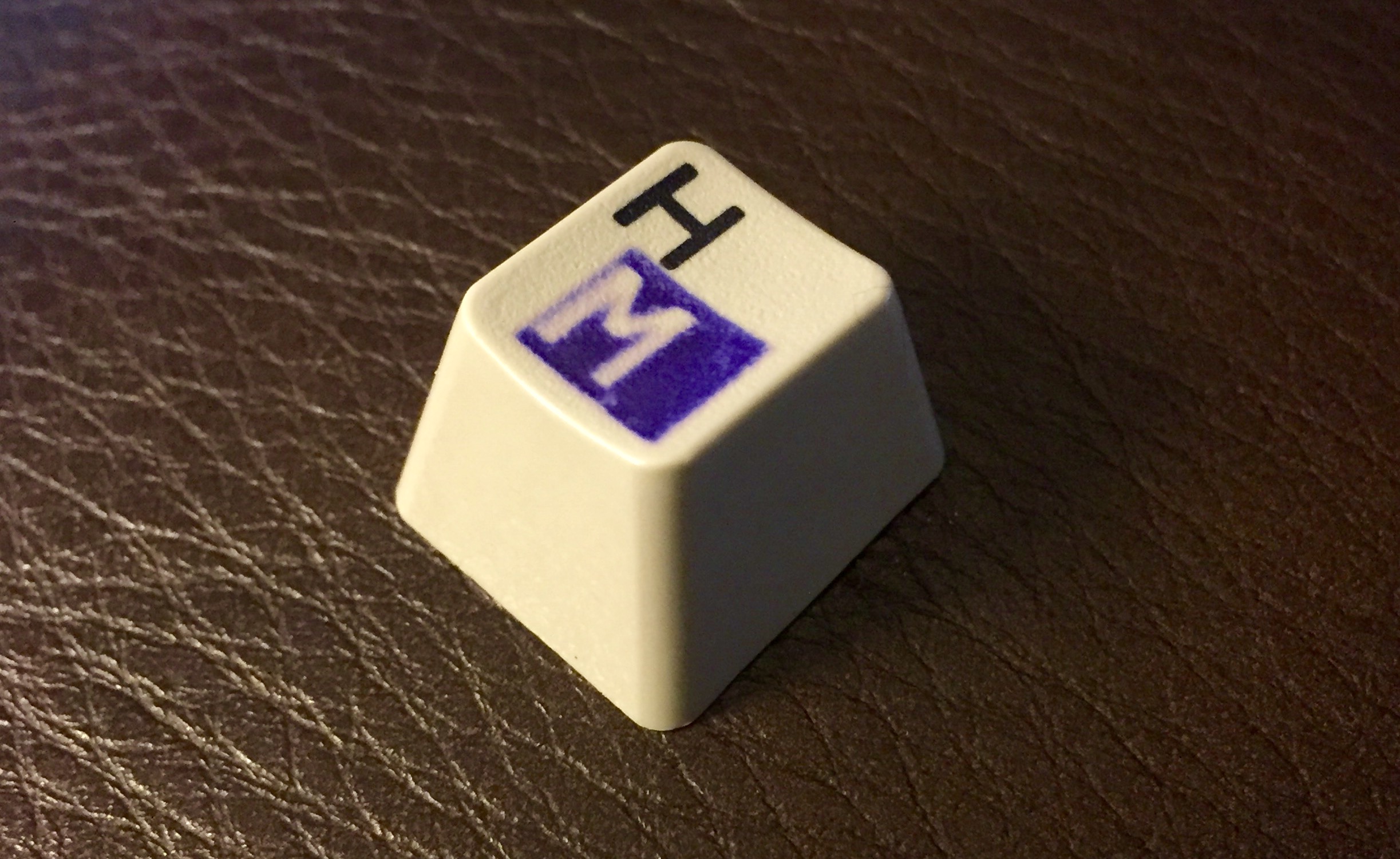

Decided to get rid of the F and work on the hard part (extended the M backdrop to even make it more problematic for testing). Getting decent at this, but think I've pushed the crayon to its limit.
Time to do some actual research about dye-subbing plastics with a laser (vs. just making $hit up). Unfortunately, this is pretty uncharted territory. We know enough about the properties of everything at this point to make some educated experiments going forward, but I would plan on Hajime being our go-to for MF caps unless a discovery is made (pretty sure we are the first to dye-sub PBT with Crayola with reasonable results... so it could happen), but who knows at this point. Orange turned out really nice btw.
At 1200 dpi with vector graphics, I know this is doable... Just have to find the right medium for the dye. The crayon, if I get the dye color right, distorts the resolution. I can get higher resolution, but bubble the wax causing color changes. If nothing else, a fun experiment

i have some caps that are dyed. The dye only penetrates a few microns deep but is very long wearing. What would happen if you hit that with a laser? I would like to send you some purples and blacks (pearl and pebble underneath) to play with.

The keycaps are looking REALLY promising considering you used a crayon *and* it stayed after industrial solvent. Crayola me impressed.

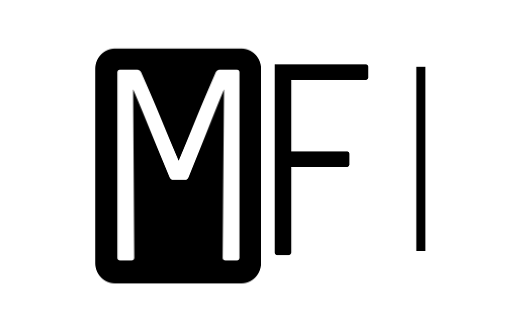

Added the SVG for the MF logo (key cap) to the GitHub repository. The document is saved as the size I need for cap testing currently, but it's SVG, so you can scale up without loss. Included a png representation in the repository as well (shown below).
https://github.com/lot-lizard/Model-MF/ ... ter/mf.svg

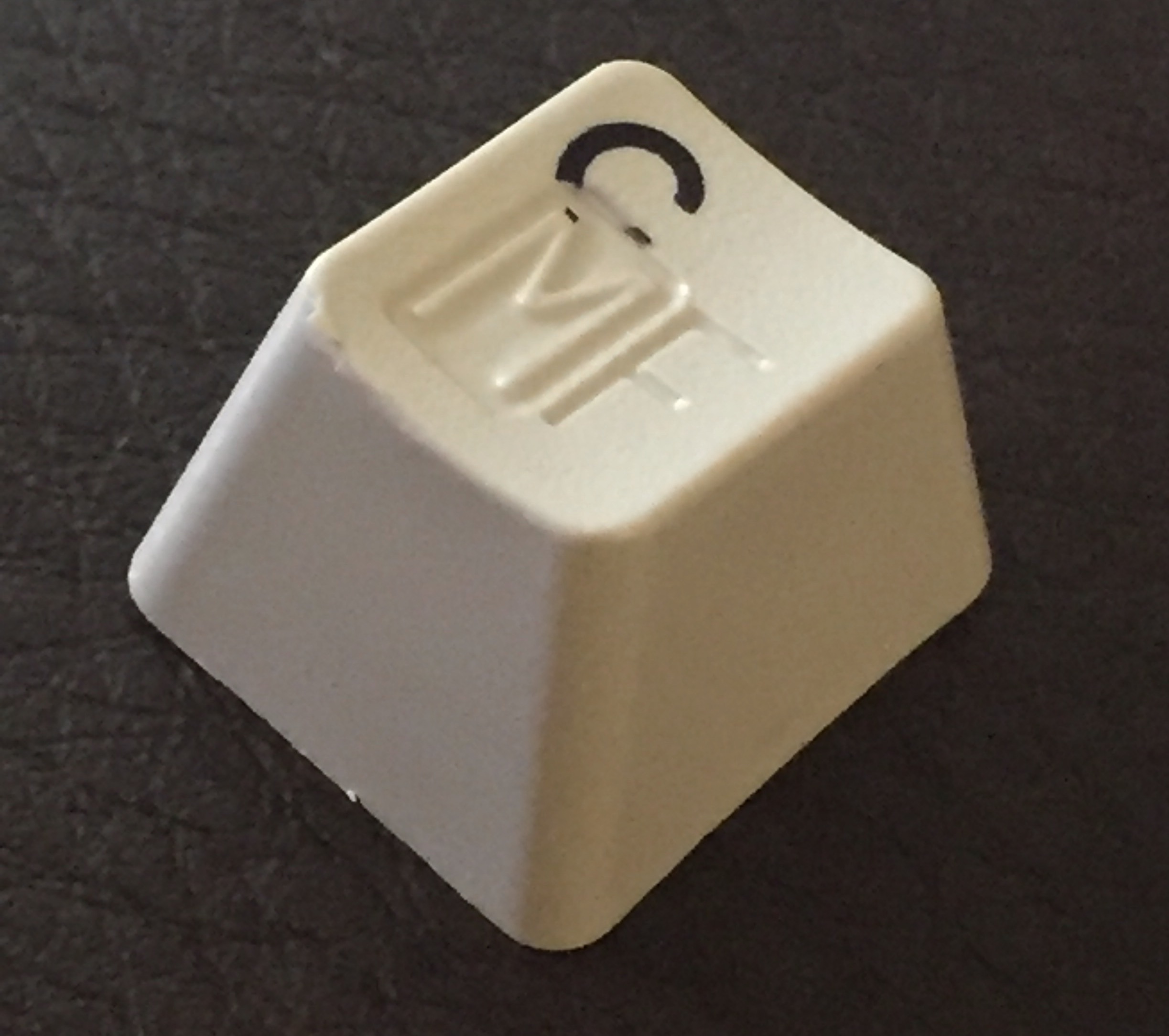

lot_lizard
13 Sep 2016, 22:02

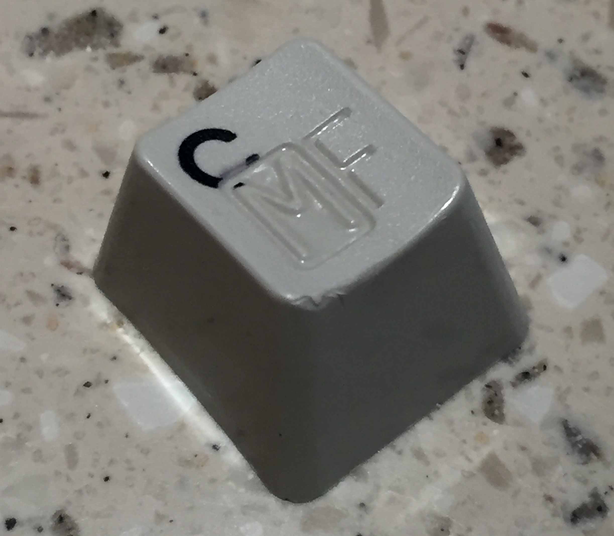

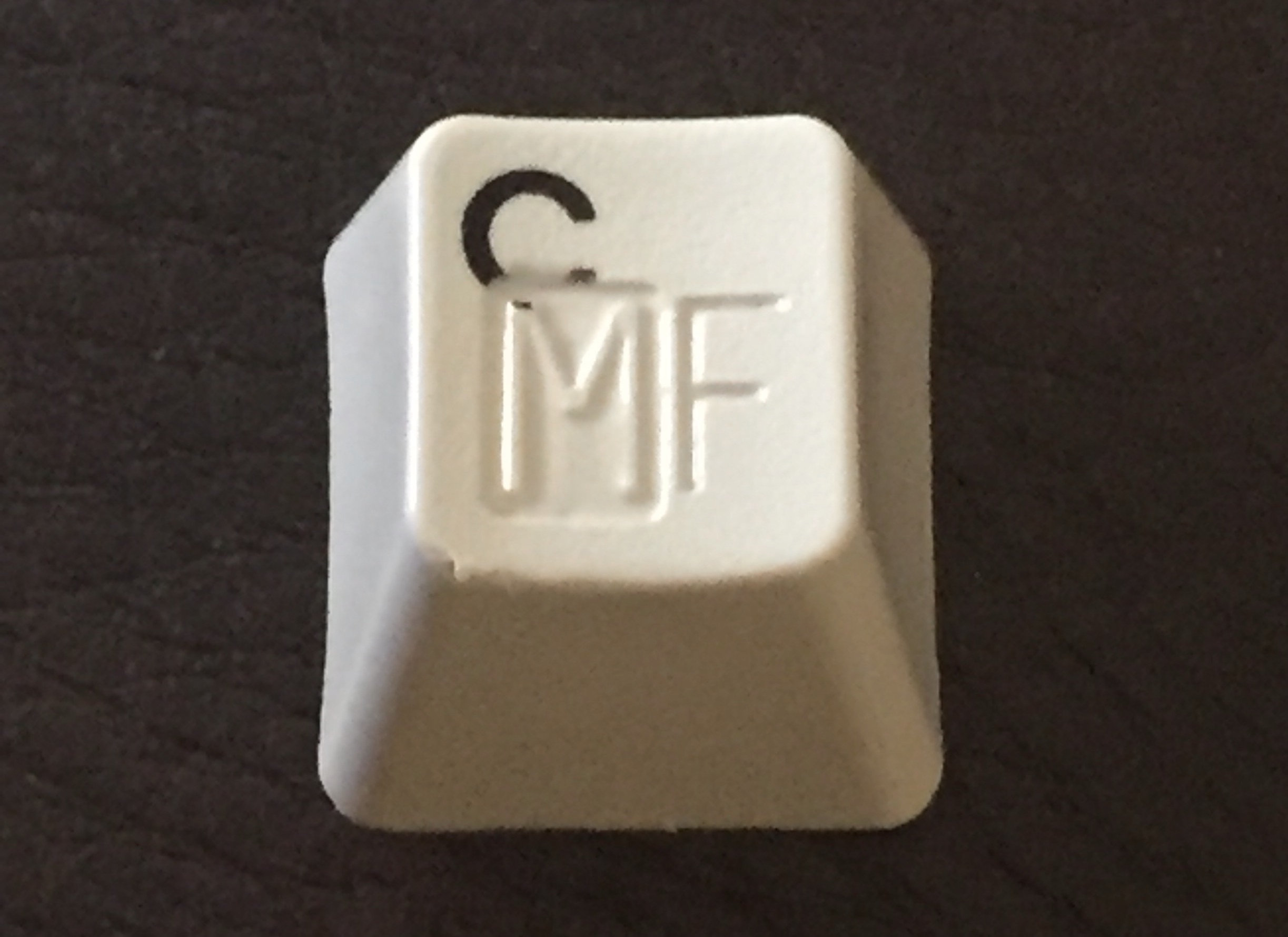

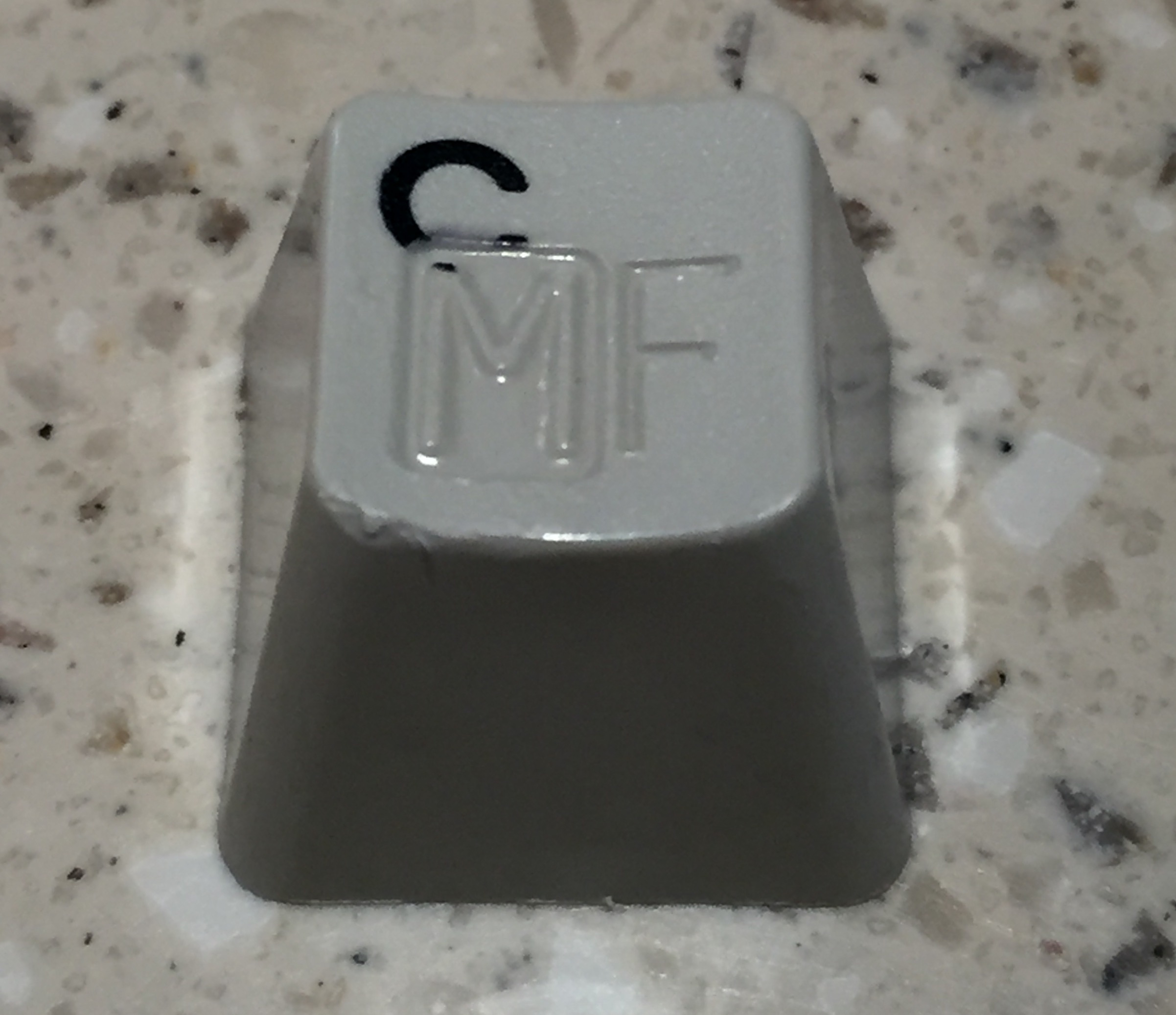

Got to play for a few minutes over lunch again today. This is about as deep as we can go before structural issues in the cap would become a consideration. @WCass... I believe about 15-20% of this depth is all it would take to reliably eat cleanly through the dyes you had pictured, but I wanted to see how much of a relief we could really give it. It feels lovely to the touch if wondering.
EDIT: updated pics
Correct color, but blurry
Horrible color, but detail

Techno Trousers
100,000,000 actuations
13 Sep 2016, 22:25
Woah, that looks really cool! Is that the thinnest you can make the lines? Like, could you actually do an infilled Shift key? I'm picturing infilled white on black, though I'm sure the cost and effort would be prohibitive.

That is flipping amazing. Seriously a new frontier for BS caps.
What I'm picturing is keys dyed dark grey then laser etched. Filling in the etching with white wax ala my old D&D dice or some other more permanent substance. Selectric looking keys, white on grey. :mrgreen:

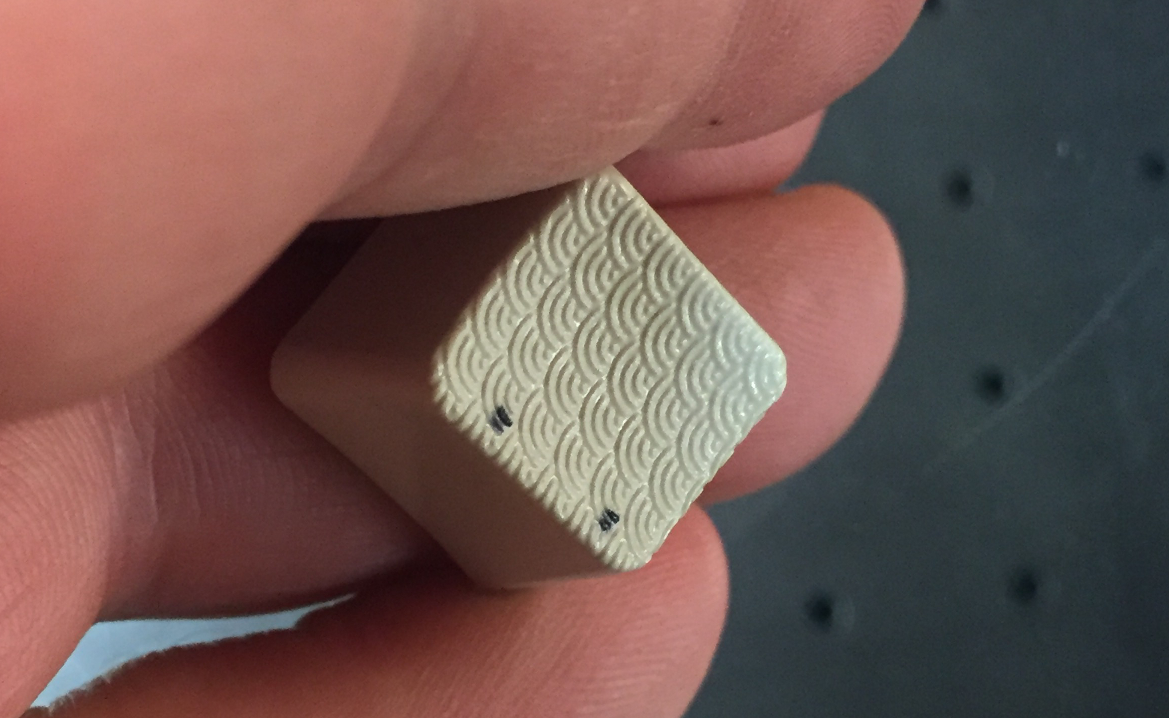

lot_lizard
13 Sep 2016, 22:57
Techno Trousers wrote: Is that the thinnest you can make the lines?
About ~1/2 the size of the F is probably realistic for a clean cut (attached a pic below for scale). 1200 dpi
Techno Trousers wrote: Like, could you actually do an infilled Shift key? I'm picturing infilled white on black, though I'm sure the cost and effort would be prohibitive.
E TwentyNine wrote: Filling in the etching with white wax ala my old D&D dice or some other more permanent substance. Selectric looking keys, white on grey. :mrgreen:
I believe this was where WCass was heading when he was thinking about dyeing the caps some color, and then etching just enough off to have the original color underneath. I got a little carried away just wondering how deep I could go. It would be about 15% of that depth to get rid of the dye in his previous pics I think (and that might be a big number... won't know till I try on the caps he is sending). Wouldn't take much. If nothing else, a fun experiment.
I think it would look nice even the same color all the way through on blue, purple, green, red, etc. in relief. Or as you say, if you come up with a clever way to fill, but that might get tricky because of the concaved surface of the key. Some brilliant white black caps dyed to the desired color, and then relief-ed just enough with the laser to bring the white back would be very doable. Could line up an entire set and pop at once with a trivial jig. As you were asking before, designs in relief would be pretty easy here too (now that I understand the settings).
The laser has the MASSIVE upside over dye-sub in that alignment will never be off (no sheet to position). So no wonky Unicomp alignment issues. Good times ahead I think.
EDIT: and with 2-piece caps, there is really no reason we couldn't cut all the way through in some pattern or font as well. Couldn't do with 1-piece, but might be a fun effect on 2-piece.

How does it handle curves?
lot_lizard
13 Sep 2016, 23:13
E TwentyNine wrote: How does it handle curves?
Really well... Better than I expected. You have to have quite a variance in depth before the laser becomes out of focus (think like 1/4 inch). The cap looks good in person. It would be higher detail if not so deep (just the nature of anything that burns/heats).
But personally... I think it is as crisp as any dye-sub technique. There you have bleed (especially with a rough surface), and would explain why Unicomp struggles to not be blurry
EDIT: 1/2 inch should have been 1/4 inch above (correcting). I have to think at 1/2 inch it would get blurry, but didn't try

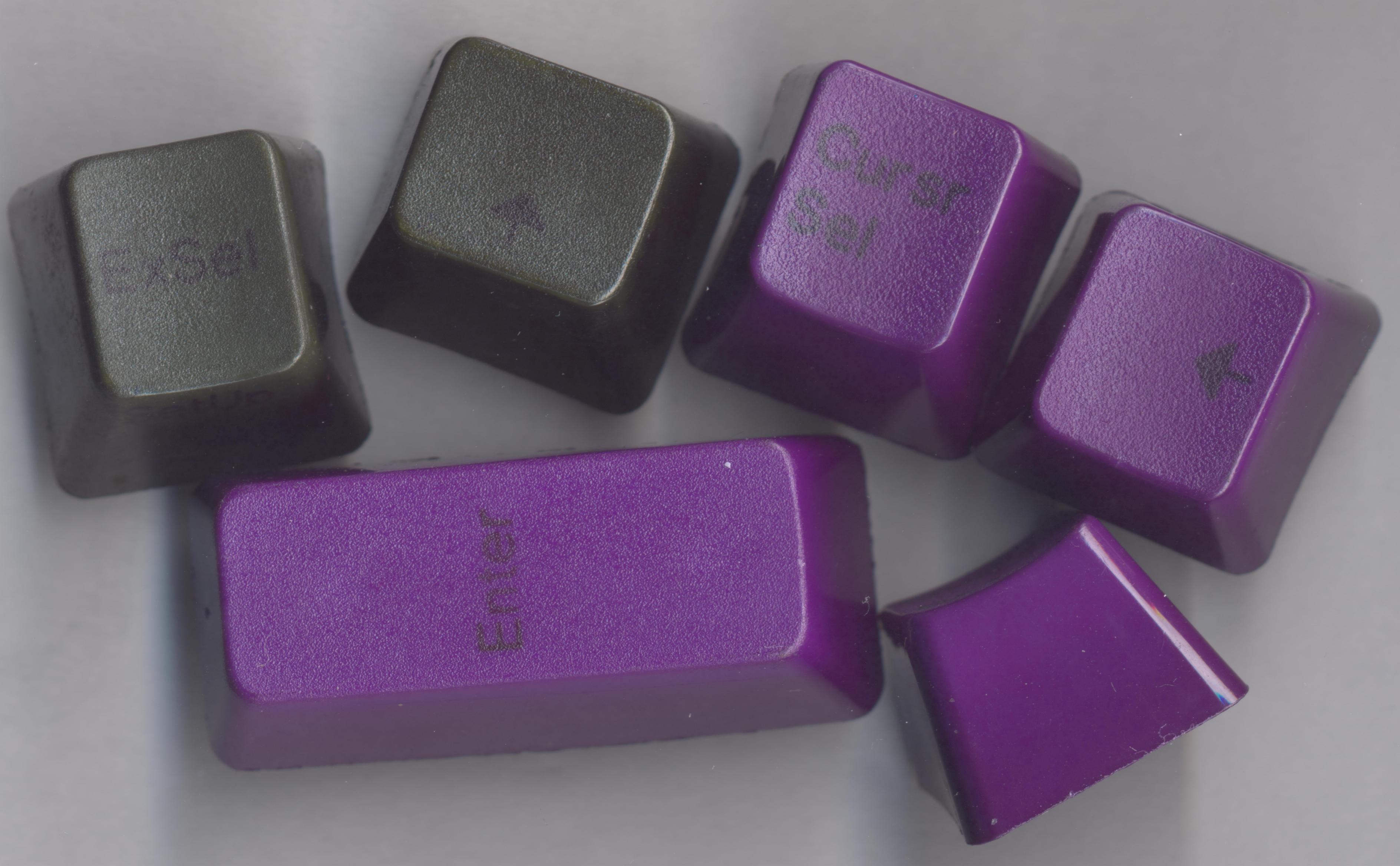

lot_lizard
14 Sep 2016, 04:17
It dawned on me that you might be referring to curves in the 2D and not the 3D (my last response was about how forgiving the laser was on the z-axis for differences in key cap height). Here is an Inkscape vector I threw together to test 2-D circles (smallest inners are 1mm). It would get tighter, but anything less is a little silly. We will only get better with experience (this is day 2 mind you).
The texture feels great for something like the Esc (wouldn't want out in the middle of the board myself). Moral... I think we can dream up some fun stuff here. Do patterns, dye the entire thing afterwards, then Selectric font the white back (preferably we started with brilliant white instead of ivory)... sky is the limit really.
EDIT: I should mention that my phone is crap at taking pictures of these things. They look much better in real life. Might should try videos to see the texture. For some reason, the pictures look much less defined and uneven. Not sure why... but an optical illusion is occurring.

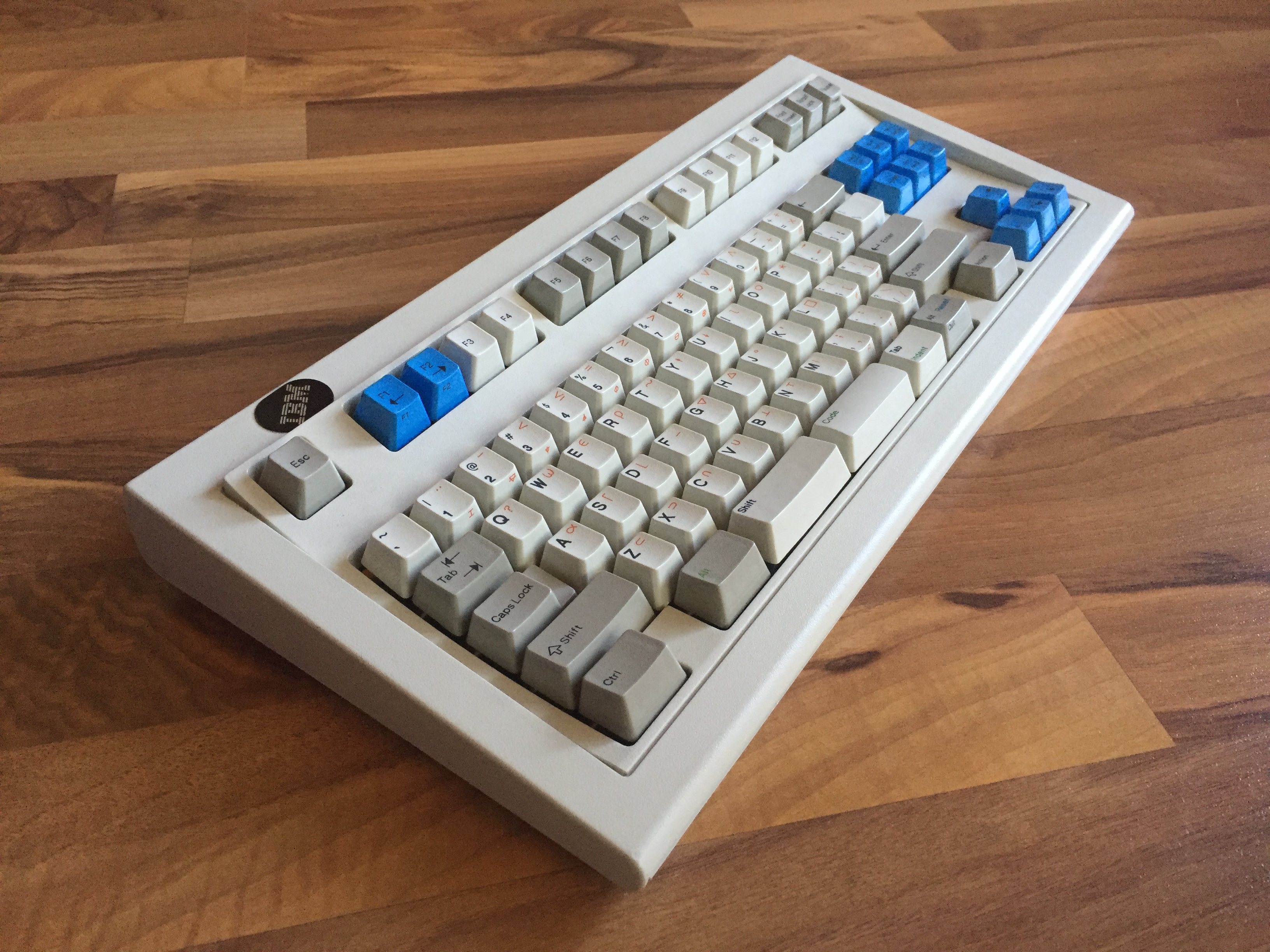

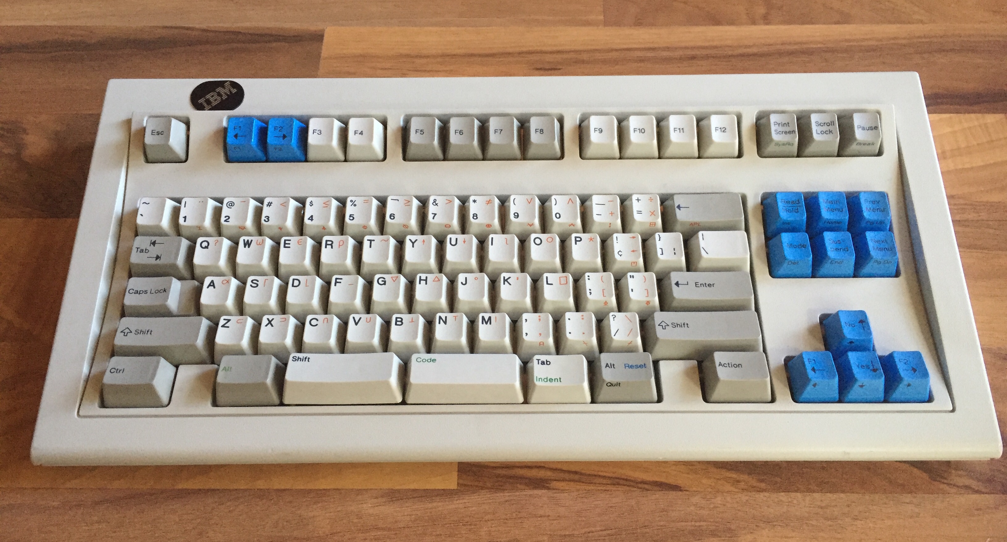

lot_lizard
14 Sep 2016, 22:08

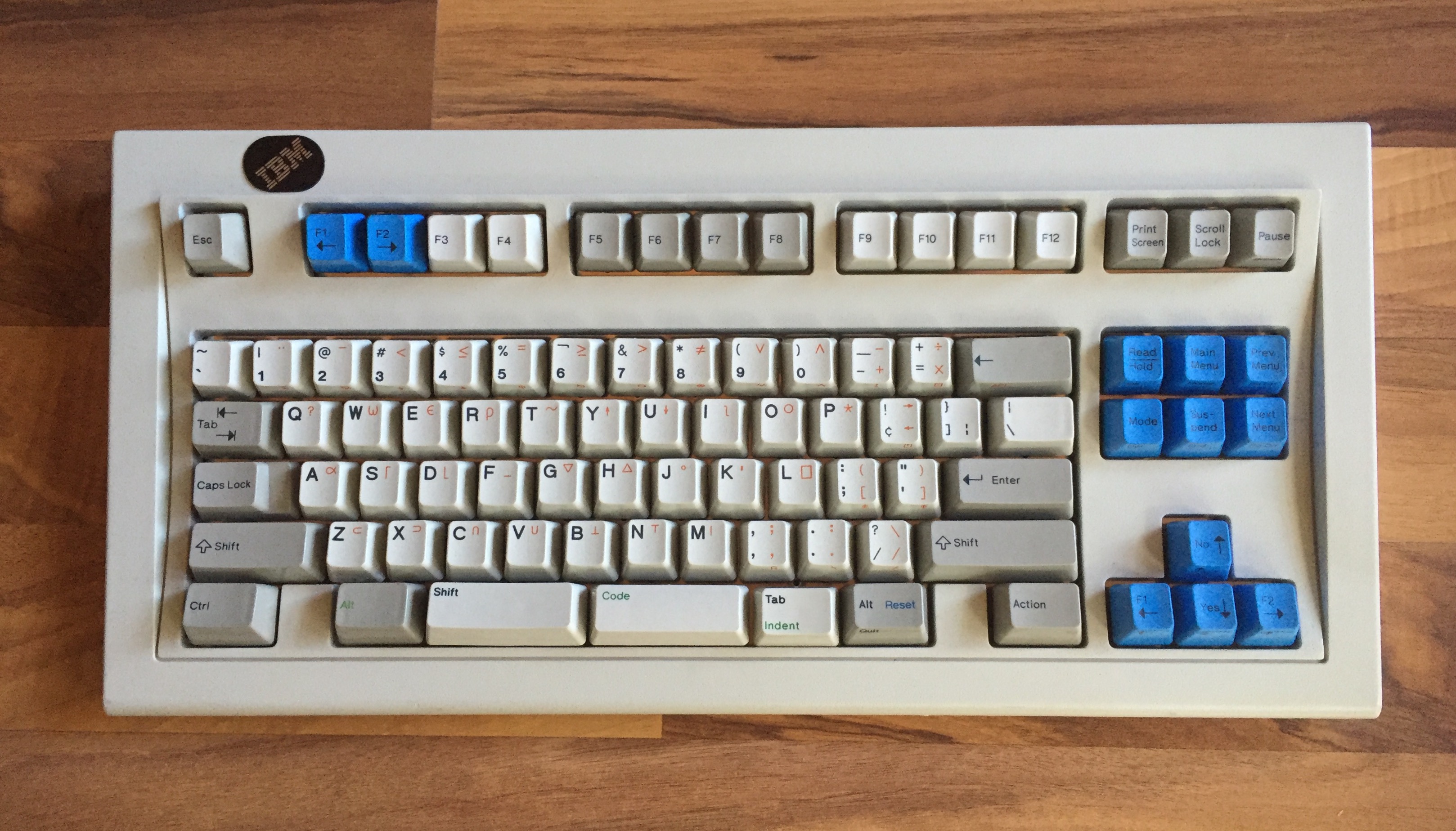

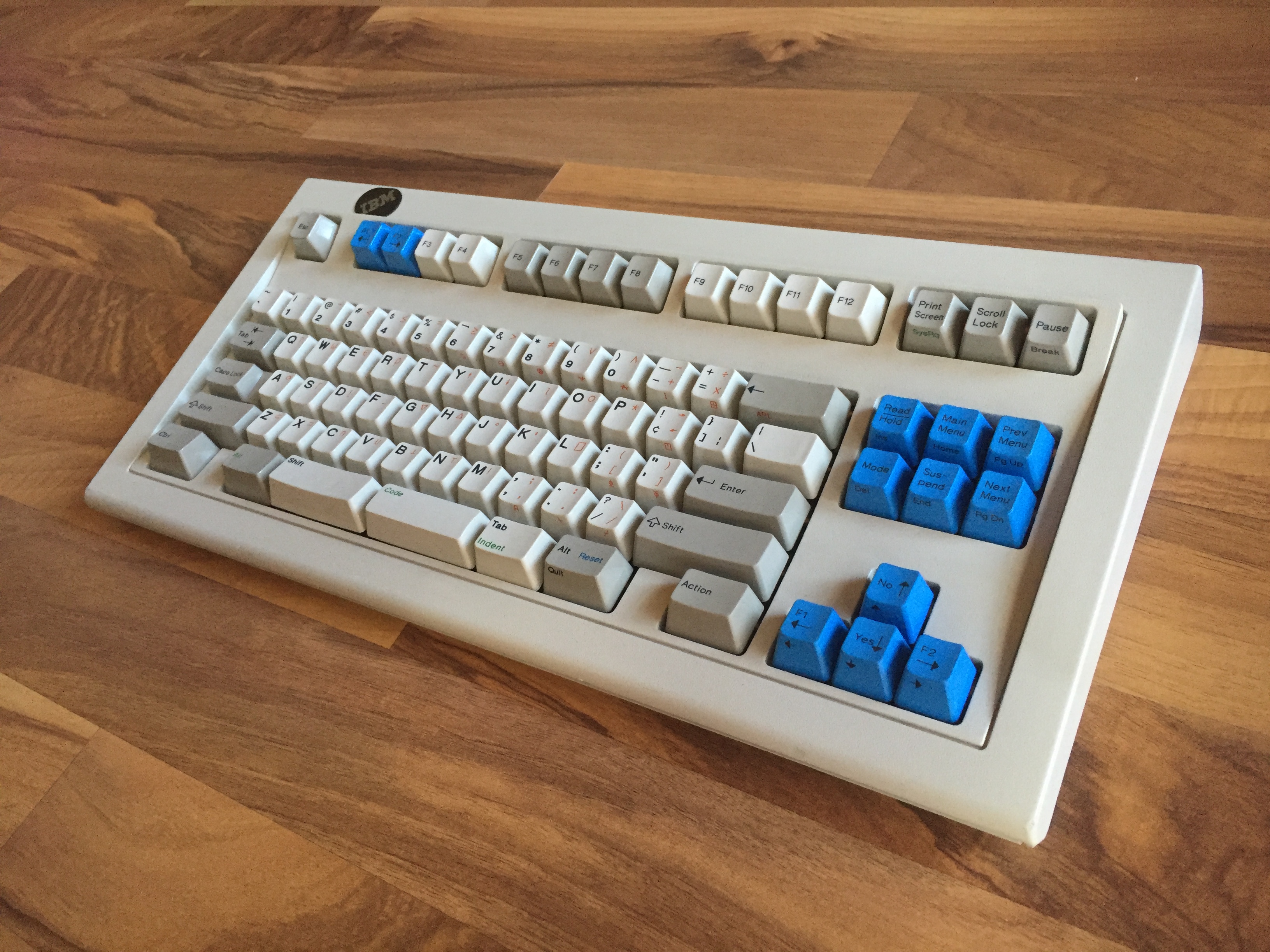

Couple of bits. I just acquired 8 XT's for a song from a local. So they will be joining the switch pool, and dropping the per switch price a couple of cents.
FINALLY got around to getting the split spacebar sizes over to WCass and i$ for the additional PCB traces/pads (sorry guys). As part of testing and finalizing key spacing, I decided to test fit another shell and stole a couple of more keys from the Wheelwriter (note that are not inserted into barrel cutouts, and are just resting to get the idea if they looked misaligned). I like the look, and not sure if I've ever seen the industrial blues on a white shell... so thought I would share. Phone potatoed the blues a bit, but the idea was captured. The black badge is the WCass PCB badge from the Seebart buy. We still need to have the smaller SSK version made.
14 Sep 2016, 22:10
lot_lizard wrote: Couple of bits. I just acquired 8 XT's for a song from a local. So they will be joining the switch pool, and dropping the per switch price a couple of cents.
I will be willing to buy as many XT key-sets as you are willing to sell.
I love me them 1 part caps .

lot_lizard wrote: I decided to test fit another shell and stole a couple of more keys from the Wheelwriter
Boy, you threw the whole gamut there, Mopar Blues*, APL, split spacebar with the Code key even, that Reset is off a terminal isn't it?
Looks good.
(* a little terminology nit on the blue keys, which keep getting called "Industrial Blues" by multiple people. They were seen on industrial keyboards, but they were in a very specific setting, an auto shop/dealership. They're from a Mopar Diagnostic machine that used an industrial keyboard with some custom caps. I prefer to call them Mopar Blues.)
14 Sep 2016, 22:35
lot_lizard wrote: The black badge is the WCass PCB badge from the Seebart buy. We still need to have the smaller SSK version made.
That's right because that badge looks silly on that otherwise awesome SSK. That bottom row. :shock:
E TwentyNine wrote: but they were in a very specific setting, an auto shop/dealership. They're from a Mopar Diagnostic machine that used an industrial keyboard with some custom caps. I prefer to call them Mopar Blues.)
You know that for sure? I'm just asking. I've heard several people say that. IBM made them specifically for Mopar shops?

lot_lizard
14 Sep 2016, 23:16
seebart wrote: That bottom row. :shock:
I would prefer if the shift/tab were blanks, but didn't have on hand. I do like the idea of them matching the original space bar vs being a pebble color. Would be nice if it had the same rounded profile as the Code key, but those are first world problems. In the end I would likely order pearl blanks for the right shift and 1.5u from Unicomp (or just sandblast text off ala-Wodan Style).
E TwentyNine wrote: that Reset is off a terminal isn't it?
It's part of the same Model M APL set as the backspace and other keys. It's a fun set.
Ultimate irony... mixed keys make me a little nauseous. Not sure why, but never cared for it. Figured if there was ever a time, it would be these pics... but to be honest... its growing on me. Just someone please stop me before it turns into this

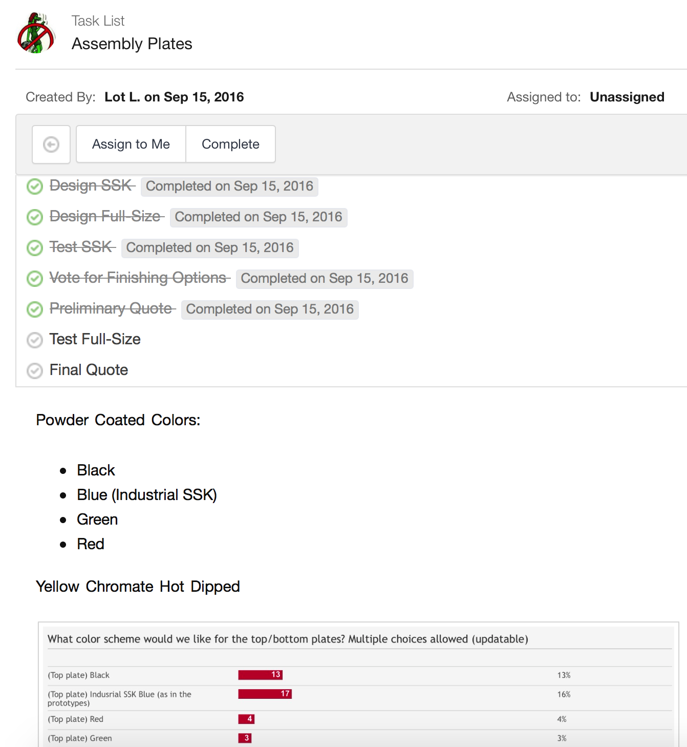

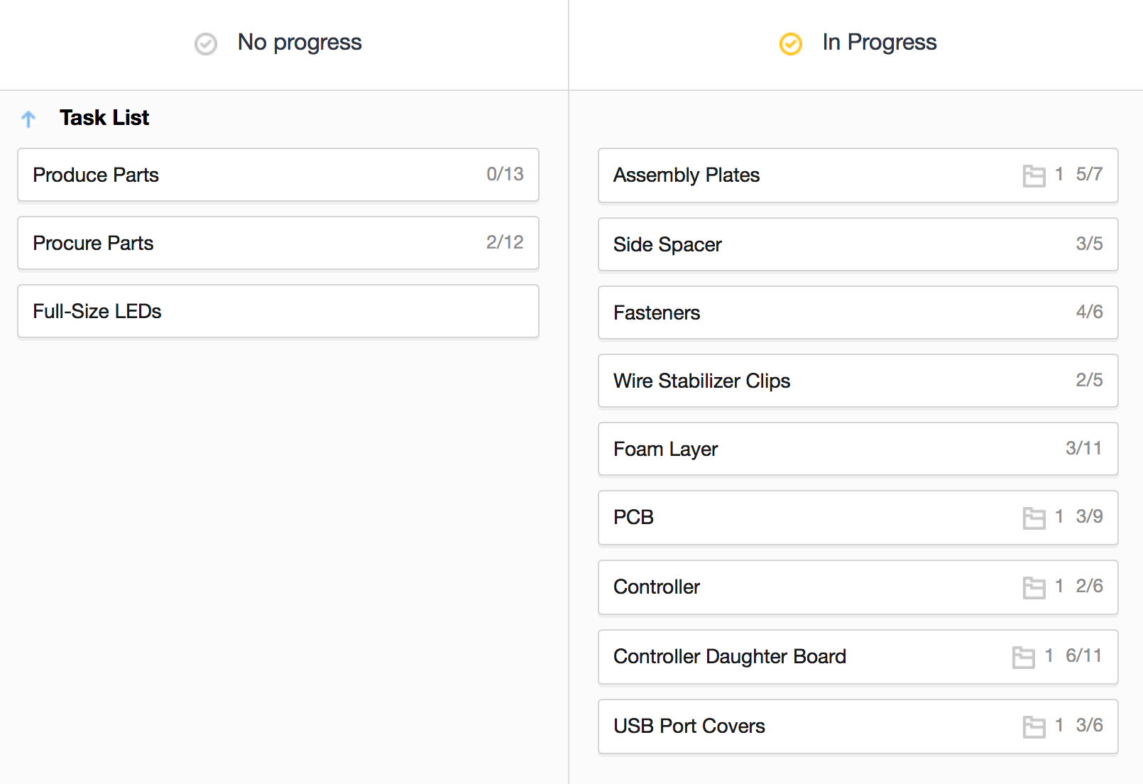

lot_lizard
15 Sep 2016, 18:17
Been on a call this morning where I am just a warm body, so threw together the start of a project task list to help coordinate this a bit better going forward. The following data feed is about the only thing that is visible publicly to the world without you having a freedcamp account, and it is basically worthless lacking any sorts or filters. If you would like to be invited as a "contributor" where it is much easier to see status, PM me. If nothing else, the data feed spreadsheet gives an idea of scope if anyone ever debates about taking something like this on.
Freedcamp is a great little tool for silly stuff if anyone is ever looking to learn a "free" tasks tool. I am very pessimistic about when something is marked complete if you are concerned on progress, and pay no attention to the dates or owners. Just a nice checklist
Live Data Feed: https://freedcamp.com/api/v1/csv/f8fc95 ... b127a3f36b
The following are portions of the screen that I see to give you a better idea:
Kanban perspective (also has a tasks list perspective if that is more comforting)

Details of a task
Details of a task
Screen Shot 2016-09-15 at 10.57.17 AM.png (281.7 KiB) Viewed 7394 times

lot_lizard
15 Sep 2016, 20:51
elecplus wrote: I use Dolibarr, which is a full blown open source ERP that runs on any OS, or you can install on a web site.
Yeah... you have something way more high-test than this. Think of these "task tools" like glorified Post-It note boards representing queues. I take off my board, put it in the queue on someone else's, etc. Really focused on "what's next?!?" for teams, and that's about it. Trello is very similar, but a little less feature rich.
They are really just virtual Kanban boards, which is really the heart of "lean". Would be tough to run an entire business from (unless maybe the business was selling Girl Scout cookies). Good for small projects though

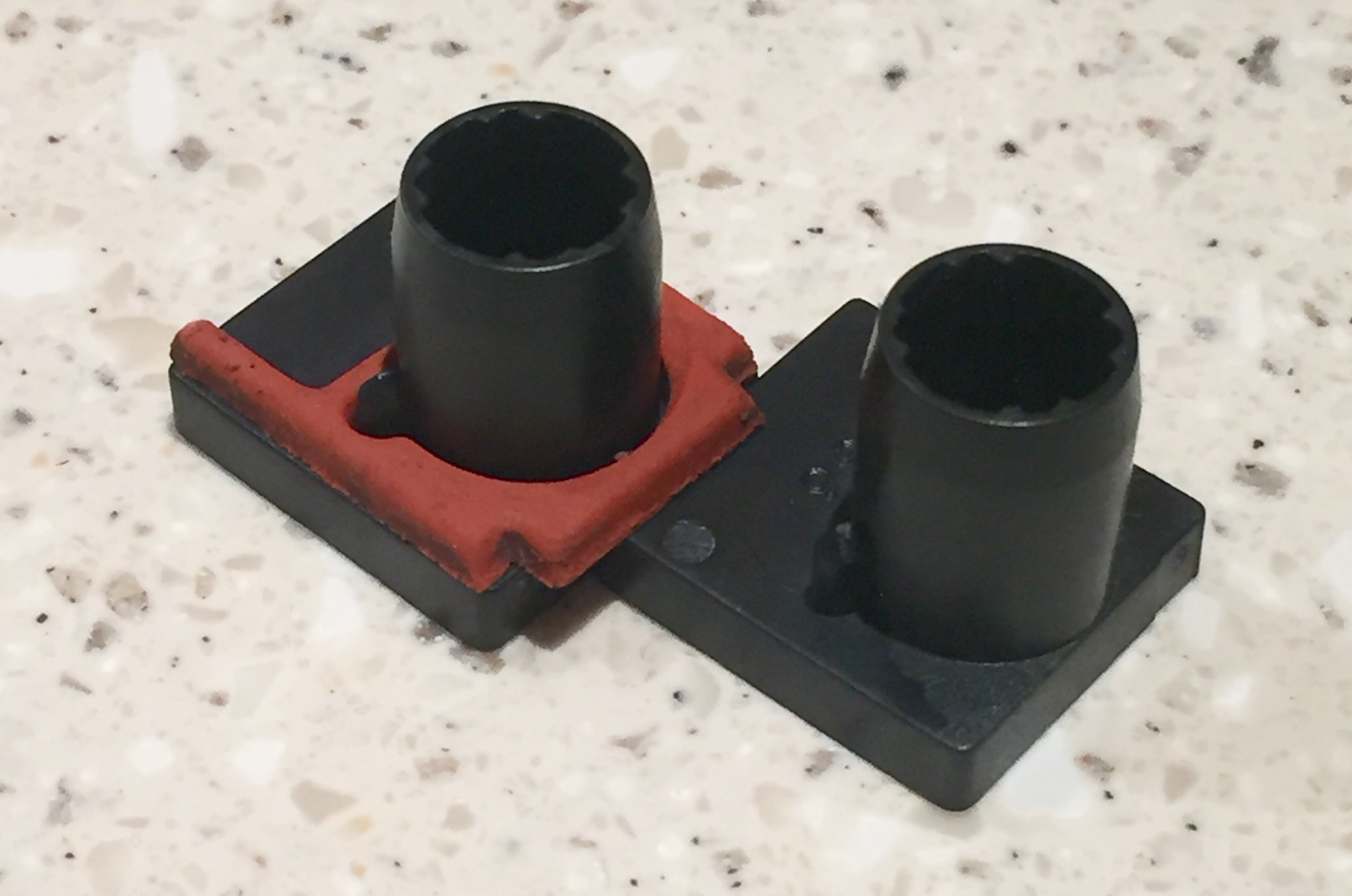

Foam samples from our supplier came in, and had the opportunity to try the cutter on something serious. This is 3/32 (2.35mm) silicon rubber. It took 3 passes on a single side but we eventually got through (each pass cuts less deep and less clean because of debris). 2.35mm of 50 durometer A shore hardness silicon is at least 1/3 too thick, but wanted to see what this thing could handle. I THINK we could get through 1/16 on a clean single first pass (the thickness of our actual target), but worst case we would flip and cut clean through from the back on a second pass. I can crank it up higher, but want to be prudent of machine wear and fire hazards
It's a great material (same o-rings your used to), but on a nice scale and should work out nicely. Hitting once from each side will produce sharp corners. I did try already, and confirmed it is too thick. 1/16 will be our sweet spot.

Always great to see validation of a theory. It looks like you even got some charring on that test piece. Burn, baby, burn!
