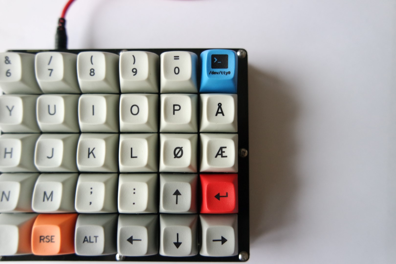

Just received my set yesterday, and here is another example of what the bold international set looks like:
01305222 (Large).JPG (225.79 KiB) Viewed 8876 times
The "Ø" legend also pretty off-center. I haven't had a chance to inspect at all the other keys, but so far it seems like most of them are acceptable, even if some of them are a bit crooked.

Dye-sub alignment can be difficult with spherical keycaps with such pronounced dishing. Especially if the manufacturer is new at this. I can't say I'm surprised by the alignment issues. Even SP warns designers of the margin of error to expect from this process, and it isn't zero.
