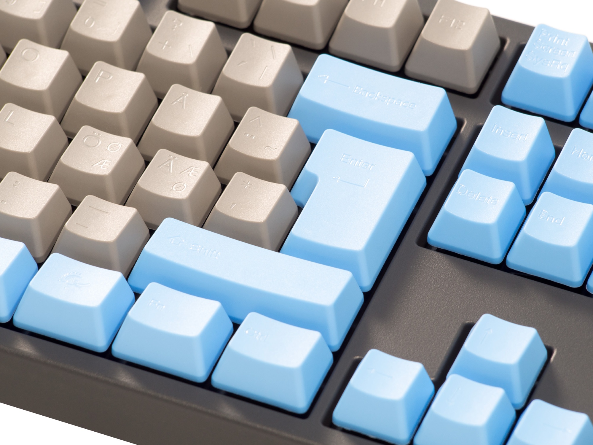

Ducky premier with dye sub caps?
Are keycaps like this dye sublimated? I thought dye sublimation produced normal visible letters.
guk
1896 Vintage Reds
03 Dec 2015, 19:41
Those are laser etched, the dyesubs with that color scheme look like this: Image
