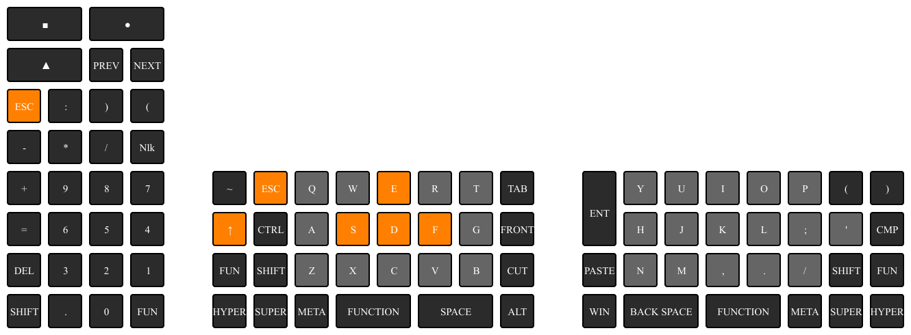

Here is my current layout.
As your can see, I need some more keys from Round 4.
Also, I still have to find suitable scan codes.
Some get blocked by the system, once the scancodes had been assigned a key code using setkeycodes(8).
- tipro_001.png (45.53 KiB) Viewed 14267 times

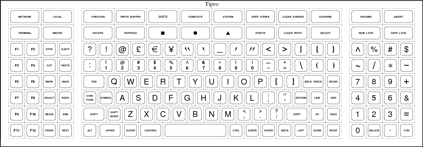

It is a mess-up of the Symbolics-, Sun-, and IBM-cultures.Minskleip wrote:So cool! A lisp keyboard! The parens are misplaced though
I'm currently writing a script to generate the mtx files from something like this:
8x4
F1 |F2 |Stop |Eject
F3 |F4 |Cut |Paste
F5 |F6 |Mark |Undo
F7 |F8 |Select|Redo
F9 |F10|Begin |End
F11 |F12|Prior |Next
122
F13 | |F14 | |F15 | |F16 | |F17 | |F18 | |F19 | |F20 |
ESC | |? | |? | |? | |F21 | |F22 | |F23 | |F24 |
? |! |@ |pound|euro|yen |`` |` |_ |' |'' |< |> |vert|{ |}
: |1 |2 |3 |4 |5 |6 |7 |8 |9 |0 |- |= |\ |( |)
TAB |Q |W |E |R |T |Y |U |I |O |P |[ |] |BS |BEGIN
Comp|Symb |A |S |D |F |G |H |J |K |L |; |' |CR |LF |END
SHL |ShWrd|Z |X |C |V |B |N |M |, |. |/ |SHR |UP |Page
ALTL|HYPL |SUPL|CTRL |SPACE |CTRR|SUPR|HYPR|META|LEFT|DOWN|RIGHT
8x4
NUM | |CAPS|
~ |n/ |n* |n-
n7 |n8 |n9 |n+
n4 |n5 |n6 |&
n1 |n2 |n3 |n=
n0 |DEL |n. |?

I got the keyboards from 7bit! However Changeme doesn't recognise the keyboard properly. It's a TMC-KMCV-C15-112 USB with 122 keys, but is recognised as a TM-KMQ-128A (120 keys). Two keys are missing, and I can't get to them! The two switches under the 'caps lock' to the left of 'A', and the two switches under 'enter' are each recognised as one custom key.
Is this a fault with the usb controller?

Hi Minskleip,Minskleip wrote:I got the keyboards from 7bit! However Changeme doesn't recognise the keyboard properly. It's a TMC-KMCV-C15-112 USB with 122 keys, but is recognised as a TM-KMQ-128A (120 keys). Two keys are missing, and I can't get to them! The two switches under the 'caps lock' to the left of 'A', and the two switches under 'enter' are each recognised as one custom key.
great to read that the they arrived!
It is normal that it is recognised as TM-KMQ-128A and the 2 keys are not working on all of these keyboards. The only solution seems to solder them to some unused switch in the upper rows.
There is no difference between USB and PS/2 except that the USB version can only deliver USB codes, wile the PS/2 can send scancode type 1 or 2 or so ...
