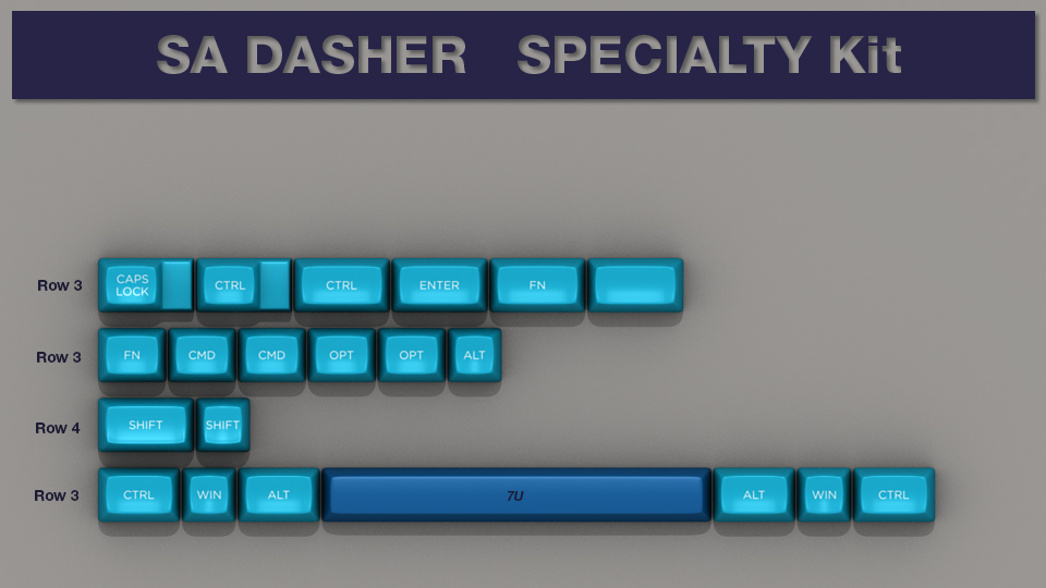

Here is an "early draft" of the SPECIALTY kit. Consider it a starting point for discussion. I really have no idea what should go into it.
SA Dasher SPECIALTY Kit
Note that for each SHIFT key (size) you see throughout the Dasher set, there will be a $50 charge to make its fixed legend plate. I'm assuming that this will be the first SA set to use my corrected vector definitions, so it will be the set that eats the cost of the new plates.

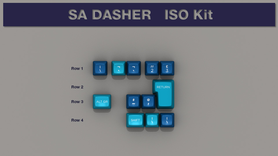

So here are some questions I have:
1. Should the ISO kit provide an "ALT GR" key?
2. Should the SPECIALTY kit provide spacebars of more sizes?
3. Should the SPECIALTY kit provide more blanks? If so, how many and in which sizes?
4. Along the lines of question 3 above, would anyone want twelve R1 blanks for the function row? The original Dasher keyboard had blanks for function keys.

Now, some answers:
1. Yes. As far as I'm aware. Alt Gr is the defining mod on ISO. I don't know for sure though because Macs don't use it. We have Option for all that instead, on ANSI too. But Alt Gr is always in demand amongst the PC guys in Europe.
2. Perhaps. That's a judgement call. Bear in mind that (besides absurd oddball blank keys that aren't really spacebars at all) even Round 5 only has 3 spacebar sizes: 6.25u (good for 90% of users), 7u (good for 10% at a stretch) and 4u (good for Tipros and a few custom keyboard designers like me). There is no SA tooling for the missing 6.0u spacebar, which sucks for those who need it, as DSA has it fine. And keys smaller than 4u wide ain't no spacebars at all. In SA, they're all concave, like Shift keys, only blank!
3&4. Another judgement call. Blanks seem like a good idea, and have their vocal fans, but in actual sales they always lag behind their legended brothers in GBs, so I'm quite skeptical about them in general. But! Your source keyboard has them, which rather invites a second look. I'd consider putting them in the main kit, though, as a bonus maybe alongside the inauthentic function keys. Almost no one would buy an oddball kit just for authenticity, and a bunch of identical keys won't cost much anyway.

Question: what uses the 1u R4 SHIFT key?
31 Oct 2015, 03:27
The Filco Minila comes to mind:
But it's already screwed with that sweet little spacebar. Speaking of which, there's a wiki page for those:
http://deskthority.net/wiki/Space_by_keyboard
I think Matteo has also designed a few customs with single unit right Shift. It's a "65%" thing. And one of the prime reasons I don't like that size class. Cramming arrow keys onto a 60% involves a lot of compromises.

The Manila also suffers from the need for a 1u R4 DEL key. Is there any point in having a 1u SHIFT without the R4 DEL? I'm inclined to just ditch the 1u SHIFT so I can also avoid the R4 DEL.
As for the R1 |\, that is already present in the ISO kit. If this set is offered as one Deluxe kit, then there'd be no need to duplicate it in a SPECIALTY kit. Even if not, I'm torn over the question of duplicating keycaps in kits.

I've added an "ALT GR" key to the ISO kit:
SA Dasher ISO Kit (with "ALT GR" keycap)
