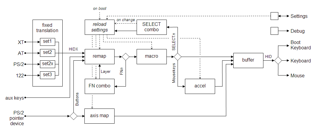

JBert wrote:I happen to have another (weird) question: will there ever be support for a few extra Fn keys connected directly to one of the free Teensy ports?
I'm thinking about adding an extra Fn key but I would like to avoid messing around with the keyboard's matrix. Connecting an external switch would mean that I'd just need to connect it between +5V + a resistor and ground, and it would even allow me to make it a foot switch.
Any thoughts on how complicated this is? I could understand that you wouldn't like to debounce the switch, but then again it's just an Fn key which is non-printable...
Hubbert wrote: I have the exact same question: did you come up with a fix, JBert? Otherwise, I guess I need 2 Teensy's: one to control a few keys, another to convert/translate, then connect them to a USB hub. Any suggestions on controller code? I think the PJRC demo code could be easily tweaked to send a few keys.
But then Soarer's converter won't see the extra layer keys, so then we have to implement them on the host computer (AHK / Linux keymap).
Did you look into adding this to Hasu's converter?
EDIT: I suppose there's no way that Soarer's converter can listen to two keyboards? That would allow wiring the secondary controller to a plastic USB/PS2 converter, then into the converter which could now recognize the extra keys.
Is there still desire for the extra few keys?
I've got v1.1 almost ready, and could possibly squeeze reading a few keys in somehow. There's 5 codes spare between AB and AF I could use, so it would be 5 key inputs - probably on PB0 to PB4, with each key simply grounding the pin (no matrix, and using the internal pull-up, although you could add an external pull-up resistor as well). If I do it, I might as well debounce them - any idea what the debounce time for footswitches is?

Soarer
29 Dec 2012, 16:07
I've been thinking a bit more about adding a second PS/2 input. There are... multiple issues :lol:
Looking at hasu's code, it seems that PS/2 mouse is only supported with a keyboard (matrix) project. It's much harder to run two PS/2 inputs concurrently, since they would both have to respond quickly to incoming signals at arbitrary times. I've had to work on all the other interrupts used in my converter to make sure they don't take too long, so that the PS/2 interrupt isn't ever delayed too much, but doing the same with the PS/2 interrupt would be quite a bit harder (mostly thanks to it being bidirectional).
With a keyboard, it really doesn't matter if you misread an input occasionally - you can just ask it to resend (except for PC/XTs, but they already have simpler interrupt handling). With a pointer device that can be almost constantly streaming events, that's probably not viable. (That said, I think working on all the other interrupts solved any resends that were caused by the converter).
Refactoring the code to cope with two inputs would be quite painful. As typical with embedded code, there's a lot of hardcoded stuff to do with ports etc, and lots of static/global variables. The simplest (but hackiest) way would be to copy all the PS/2 code to another file, rename the functions and variables, and modify the ports, interrupt and timer. Or I could change to C++, and implement it as a class with virtual functions or as a template. As a class would give the smallest code size, but performance would suffer. As a template would perform nicely, but would probably result in less readable code. All things considered, the hackiest way has its merits!
Then there's potential issues with the non-interrupt main loop code. Writing to a PS/2 port (e.g. setting LED state) currently blocks the main loop, so processing completed PS/2 inputs from the other PS/2 port could be delayed. Possible solutions might be to add extra buffering, or to make the writing a task with it's own state machine. Either would be fairly straightforward, but it's still extra work.
Overall, perhaps the biggest problem is that there would such major changes that it's almost inevitable that the new version would have some bugs affecting keyboards that could take a few revisions to iron out. That would be made more difficult because a lot of people wouldn't use the new version, if they don't want the new features (take-up of v1.1 has been pretty slow even compared to v1.01/v1.02/v1.03, which fixed things that didn't affect many people).
Still, just to tease you, this is how it WOULD logically look IF the dream was realised...
