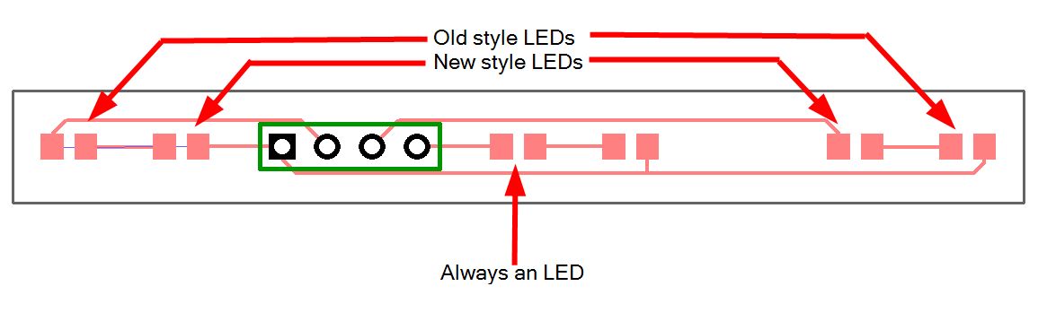

i actually took old/new LEDs into account with my design. The FExt PCB top has two silkscreen 2.25" x 0.25" rectangles at the top right corner. The new LED strip will be placed in the lower rectangle if the case top is the older style; the upper if the case top is the newer style. Attach with standard double-sided foam tape.
Each LED circuit requires one diode and one resistor in series and it doesn't matter which one is "first" in the series (though diode direction is very important). I put an 0805 surface mount pads at both 0.75" and 1" from a central pair - so you would populate the 1" pads with LED to get "old" style or the 0.75 pads with LEDs to get "new" style - then populate the remaining pads with resistors.
LED board.jpg (40.71 KiB) Viewed 8663 times
The LEDs can be almost any color you choose, but there is a little skill in choosing LEDs and resistors - i should take some time to suggested specifics for red, amber, green, blue, purple, white.

Thanks, wcass. You really did think of everything!

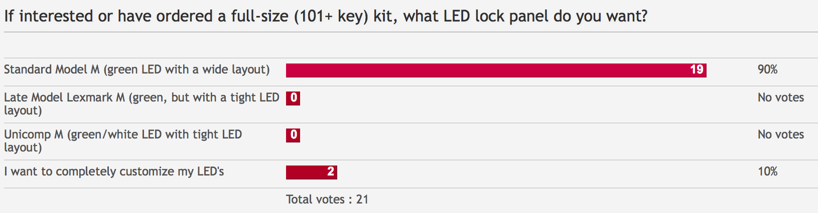

So back on this LED quagmire on the full-size kits. I have started another poll about options there. If you HAVE ordered an Full-Size kit, or plan to, PLEASE vote early. Essentially, I am trying to understand how many of you are comfortable with the LED panel being a drop-in replacement for the legacy Model M (meaning, the LED's are green and in the standard M location), or how many of you would either be putting these kits in LATE model Lexmark or Unicomp cases with a tighter LED layout and/or you want to try another color besides green). I can say this, regardless of the results, the only complete LED board will be the standard green M... but I am trying to decide if we should offer DIY bare boards for the others. Again... appreciate the early votes. It helps this process move along.

EDIT: Thanks everyone for voting on the LED bit. I think we have what we need
