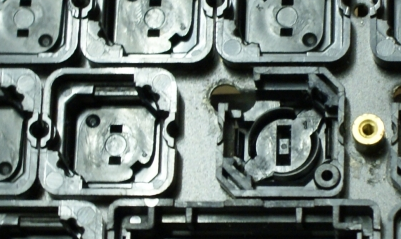

Julle wrote:Talking about 45 g vs 55 g, I've noticed some subtle differences in the key caps between the versions. The 55 g had a substantially better dye sublimation on the lettering. Also, some of the legends are different, for example the 55 g version has a thicker, hollow Enter symbol whereas the 45 g has a thin arrow symbol on the key.
Topre had some issues with the alignment of the plastic parts of the switches themselves, I mean more than before. I think my 45 g was manufactured before this particular 55 g, and the 45 g uses some type of thick, white grease in some of the switches to compensate for key cap swivel, especially in the larger modifier keys.
Is your 45g board the EK edition by any chance? I am pretty sure that Brian had Topre fix the legends on the EK edition which is why the Enter key and Back Space are different. I have an 87U variable at work and my friend has the EK edition and we see those differences.
As for the grease, I don't think there should be any difference here, maybe just one got a more liberal dose than another. I recall have a super wobbly left Ctrl key on my 55g (when I had it), and the reason for this is actually the flimsier slider that they have to use because it's an LED switch; like this:
Hitachi Topre.png (235.59 KiB) Viewed 5187 times
