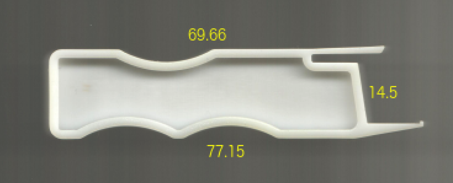

@fohat... thanks again for lending me the key cap puller for 2 piece caps. It will be mailed back tomorrow. Below are the dimensions (mm) for anyone that might be interested. We will eventually slap some mesh together and print this up. The design of the handle might change a bit, but the important part would be an exact duplicate. It is 9.9mm wide

20 Mar 2017, 16:44
In my opinion, the lip shown at the bottom right is crucial to catching just the thickness of the cap and not the stem, and the long "tongue" at the top right needs to hold the device snug against the cap.
My concerns about the material is that it be strong enough that the lip not shear off, and that it has the right flex for the arm ("tongue")to keep it pressed against the cap at the proper pressure.

lot_lizard
20 Mar 2017, 20:40
fohat wrote: My concerns about the material is that it be strong enough that the lip not shear off, and that it has the right flex for the arm ("tongue")to keep it pressed against the cap at the proper pressure.
It might take a couple of goes at it to the get the "tongue" right in printed form. As long as we use a plastic that is stronger than the original (this co-poly stuff is), the lip should be good. It might take making the "tongue" cut depth deeper though to get the right pressure. Will have to see, but I think we can get something very close after a few attempts
