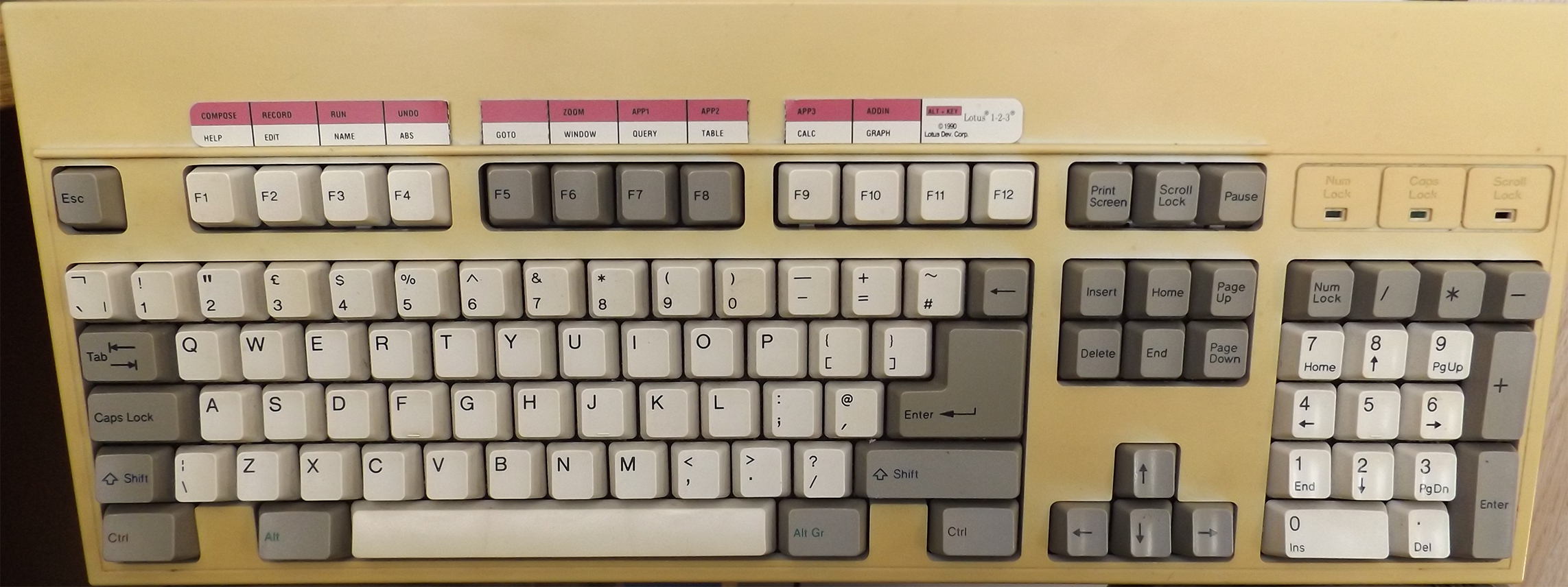

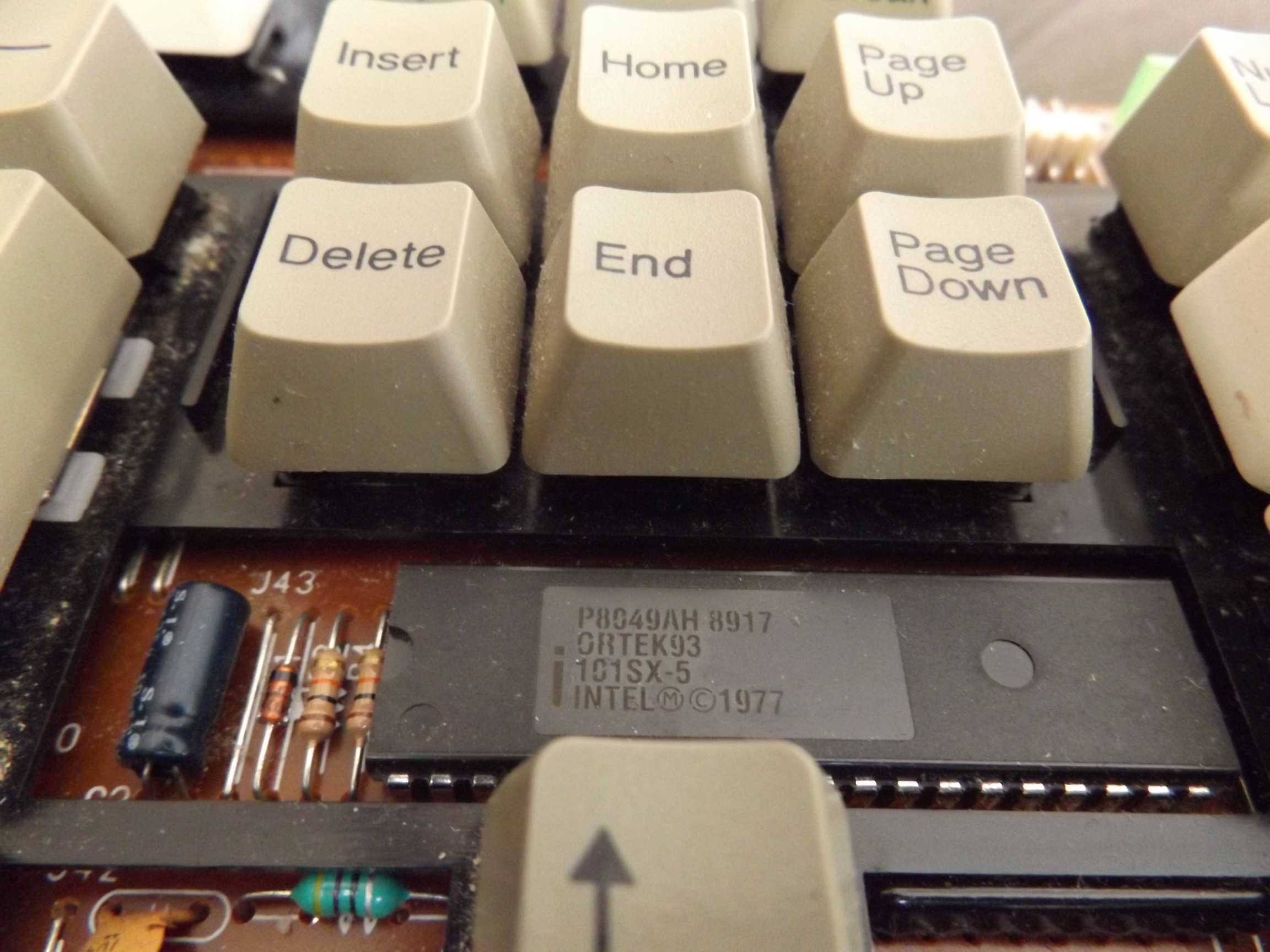

So I opened one of the extra Green SKCC's I had laying around from my P77 mod, and I was shocked to discover that it had a tall white switchplate! :o
The chips on the PCB date it between 1983 and 1984. Kinda confused here :?: White plates were introduced around 1989, and SKCC was out by that point.

The switch in question:
03 Aug 2017, 21:10
Hm ... so that's chamfered and unified roundy recess. SKCCBK001 shown on [wiki]Alps SKCC Green[/wiki] has segregated roundy recesses and is also chamfered, while the type found in the Heathkit keyboard is non-chamfered and has a rectangular recess.
My 1987 NOS tall cream switches are like yours: unified roundy recess, and chamfered. Grey switchplate.
My side-angled switches have a black switchplate, a more squary recess (neither roundy nor rectangular), and are chamfered.
Very tentatively yours would seem to be a later issue — does the base have a guide ridge to hold the switchplate?
If you've got consistent dates off multiple chips, that suggests that you're reading them correctly. Replacement switch added later?
Another dated example, this time from 1979: http://imgur.com/a/BUJCJ — non-chamfered, and rectangular recess.
There may be a general pattern to the changes.

There from a NOS Pingmaster, so I dont think its a replacement. It could be possible that they had a large run of PCB's and then slowly used them up as needed for the 4704 Asian market, not sure though.
Switch details:
04 Aug 2017, 02:00
It does seem like that is a newer part. 1989 does seem highly unlikely, though … I would expect the switchplates to be the same colour as SKCL/SKCM as they appear to be the same parts, so this is curious. I guess we won't know until we have more dated examples.

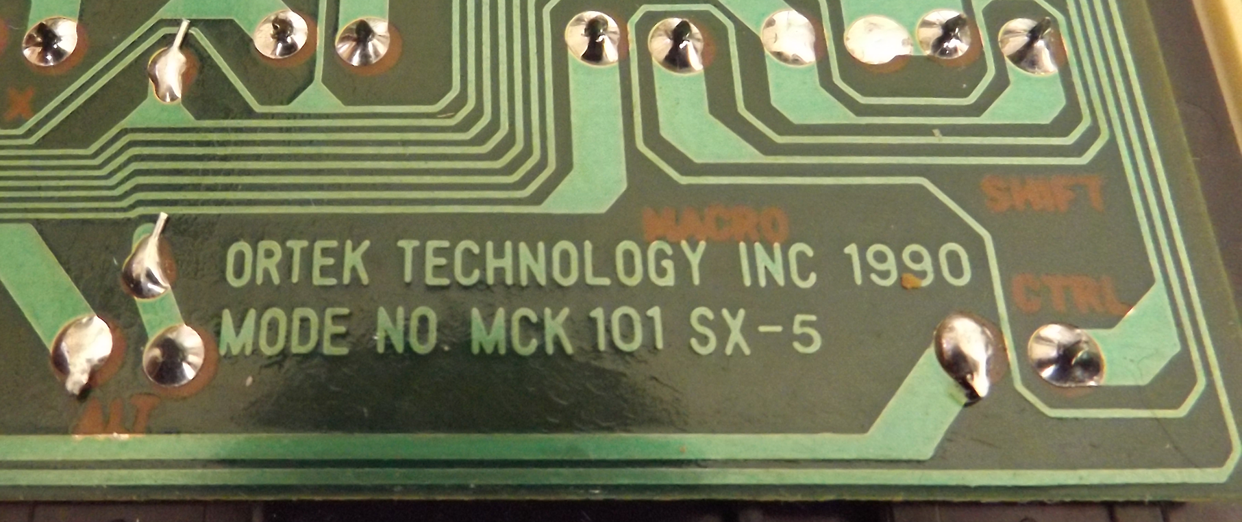

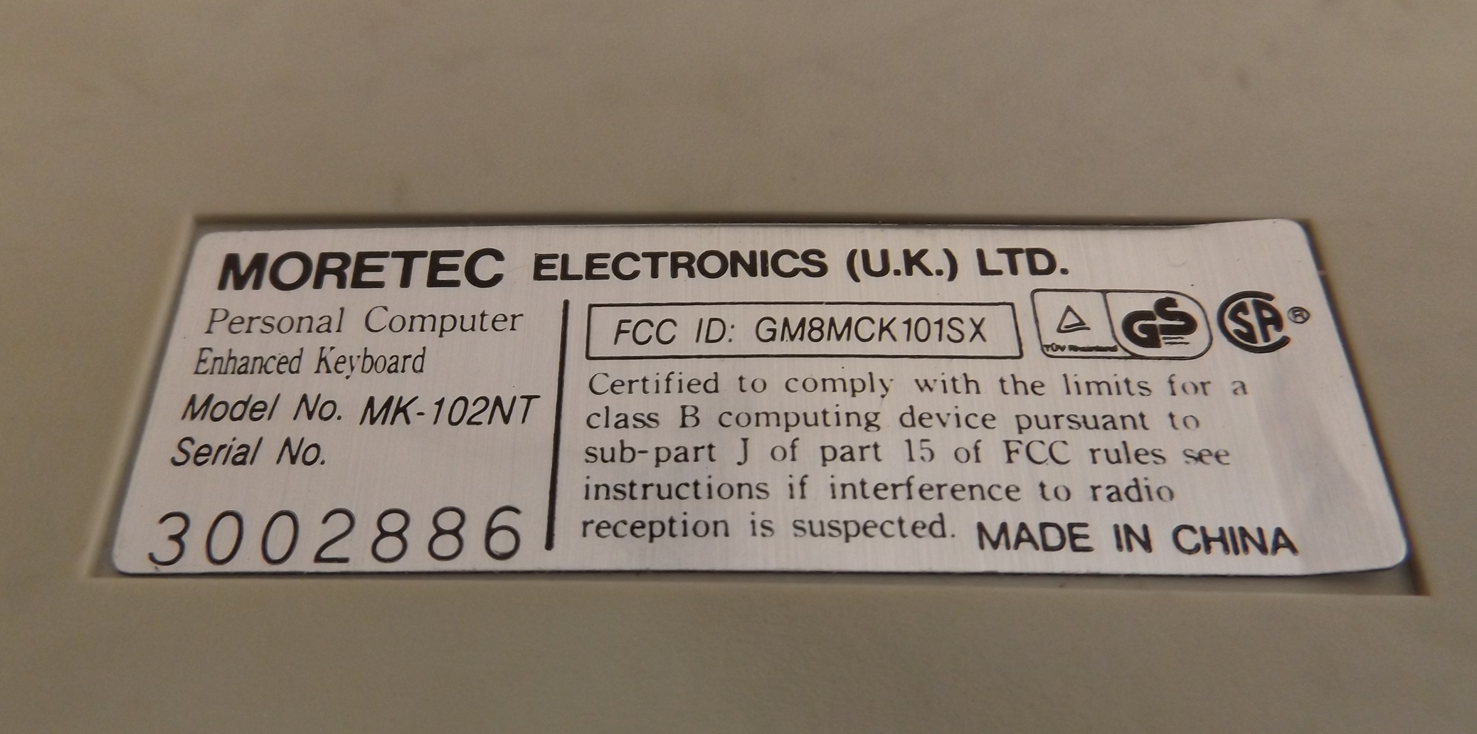

Sorry that it took a few days, have been busy with things but its Friday so i have time now
As you can see its pretty much just a standard Ortek MCK-101 case and pcb. the switch plate is plastic instead of the usual steel i guess taht was an economy option, though they did use the doubleshot keycaps. The keyboard sticker on the back is i guess some cheak knockoff from China?

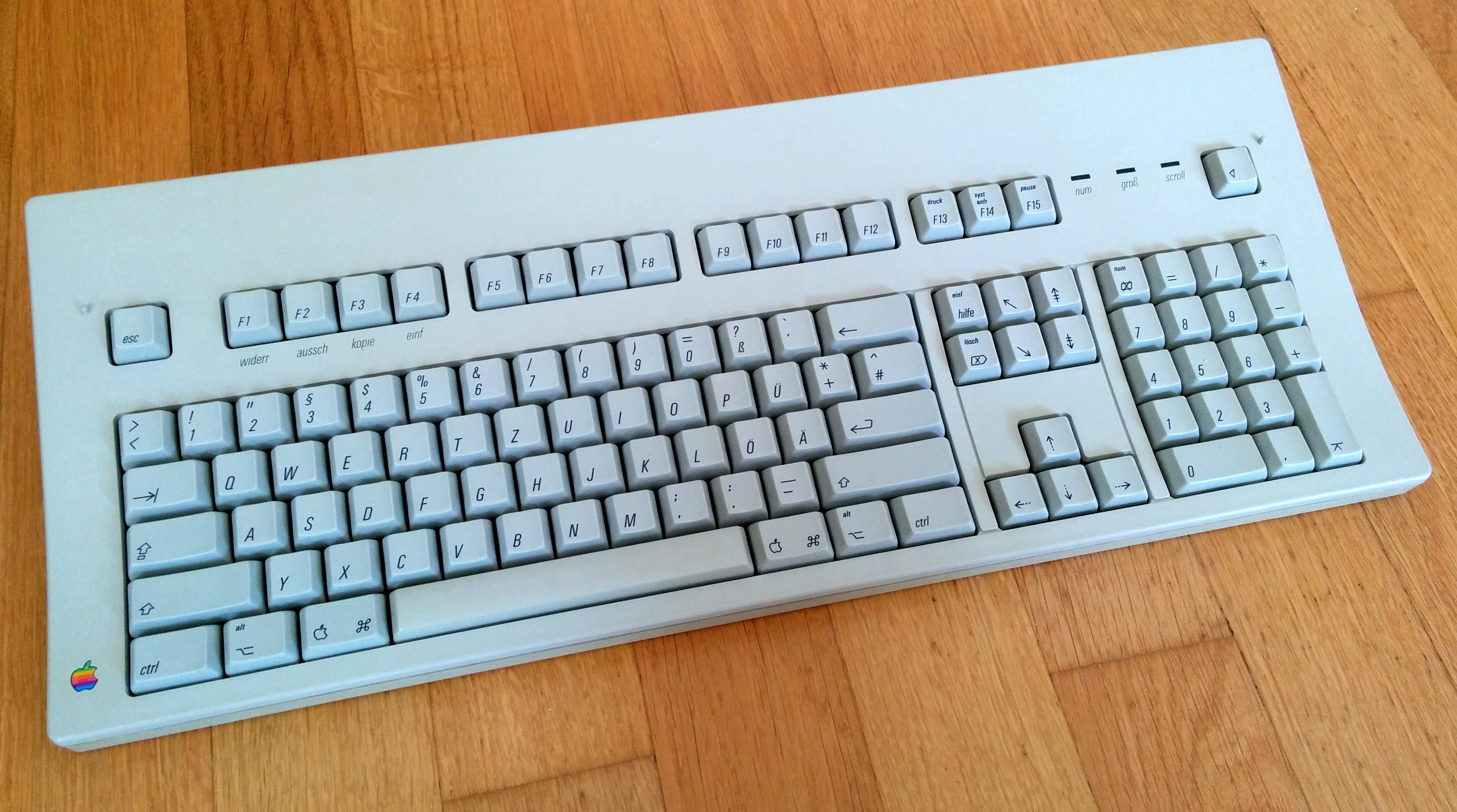

Retrobrighted my AEK on the weekend:
