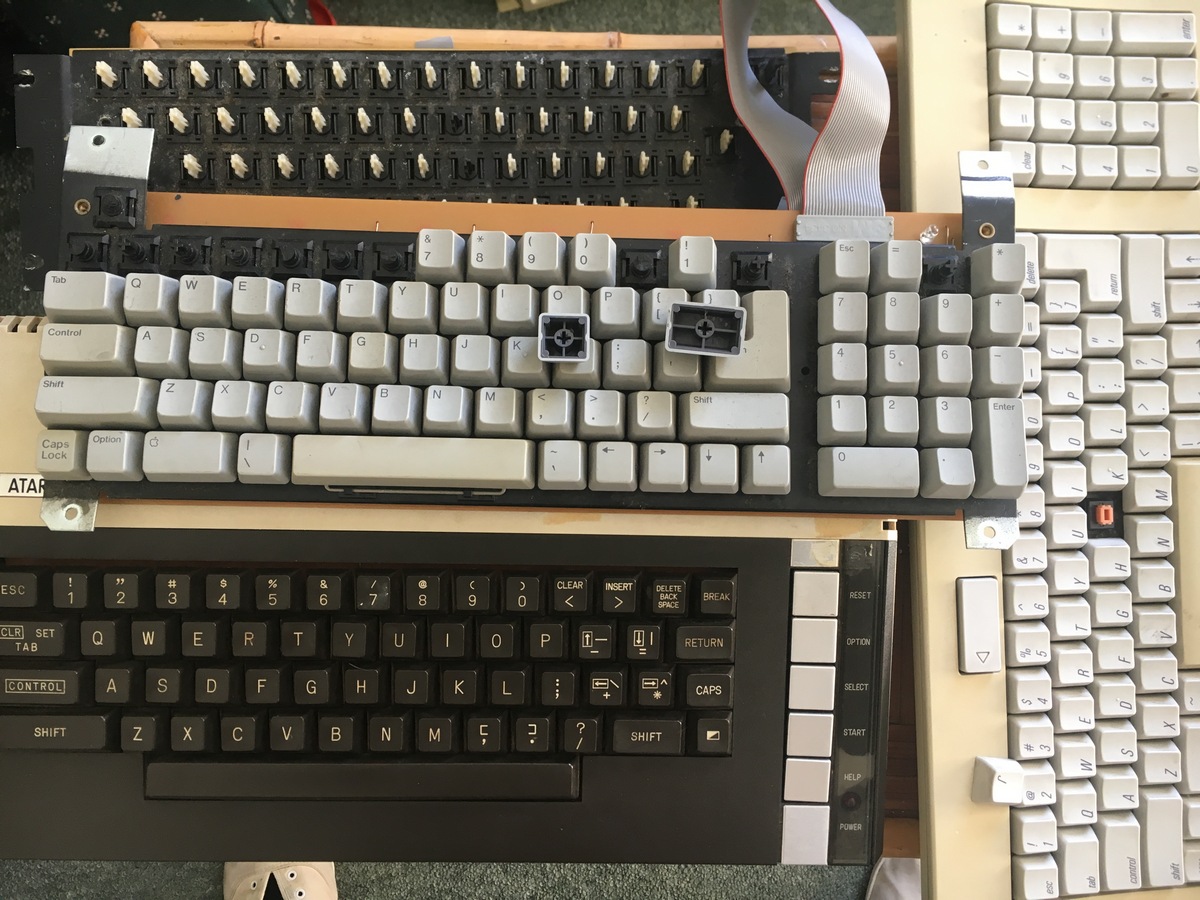

Got roped into helping my friend move into her PhD office, the storage closet of a closed department; property services told me any stuff we find is ours - as long as we dispose of it properly. Well worth the vacuuming and carrying a deskt two flights of stairs:
Orange SKCM Alps Standard Apple keyboard with mint switches, SKCC Tall Cream Alps IIe keyboard, 1986 Apple keyboard with SMK vintage linears, and... a working ATARI 800XL with Alps SKFL series oval slider switches. The IIe and Atari keyboards will require cleaning, but the oranges are mint. I'm super stoked, my first computer ever was a 600XL, so this is - perfect. Got a datacoder and ridiculous amounts of cables too.
Literally an Alps time capsule from the 80s.

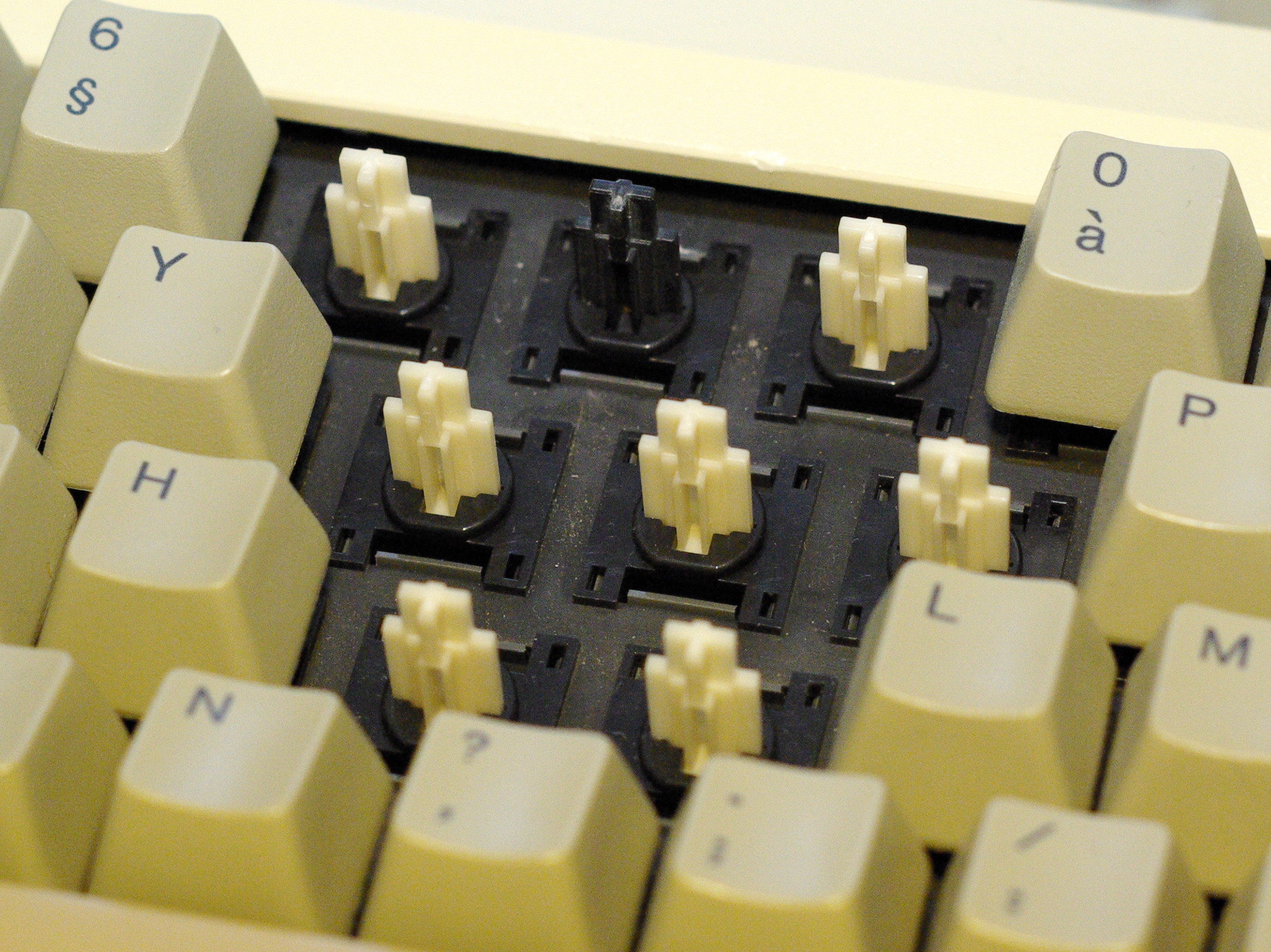

Ah, now that's interesting — the second example of a keyboard with tall cream Alps with one or more tall black Alps switches. There's another under [wiki]Apple M0110[/wiki].
15 Aug 2017, 10:54
Daniel Beardsmore wrote: Ah, now that's interesting — the second example of a keyboard with tall cream Alps with one or more tall black Alps switches. There's another under [wiki]Apple M0110[/wiki].
The M0110 consolation posted seems to have at least two though. Interesting that all those SKCC are aligned vertically. Here is mine:

The vertical orientation is on keyboards from the Apple 8 bit range, I think they switched to horizontal in the OG Macintosh.
I'm going to date myself horribly here, but as far as I can remember, the random black switches have always been a thing during the SKCC era. Going back to my high school days, there was an explanation commonly accepted at the time; the black ones were put in by quality control to replace bad switches when the keyboard was tested at assembly. I have no idea where this rumour originated, it was just "known..." to geeky teens. Looking at my Apple IIe, and the spare keyboard that's in the photo; the solder on the black sliders looks a slightly different shade, so maybe there's a kernel of truth there? I'd be keen to know if it's the same on other keyboards, or if my mind is playing tricks because that was my belief at 14.
*For those of you too young to remember, a "computer room" was a place where the school's computers were kept for lessons, not to do personal work on. In 1985 my high school had about a dozen various 8bit Apples (+ couple BBCs and Acorns) for a school roll of ~1k. Once a week we got an hour of "instruction," mostly playing with LOGO and BASIC. Joining the computer club got you access at lunchtime and after school, unfortunately it was disbanded when we got caught charging younger students to play games at lunchtime; 10c for 3 lives of Karateka, Montezuma's Revenge or Lode Runner. Oh, the memories...
Mattr567
16 Aug 2017, 02:15
Never posted this but got another PB T9102 but in pieces and rebuilt it with SKCM Orange. Used some that sublegend caps and the result is gorgeous :o
It's for sale BTW, giving Cherry another try ;)
16 Aug 2017, 09:29
consolation wrote: I'm going to date myself horribly here, but as far as I can remember, the random black switches have always been a thing during the SKCC era. Going back to my high school days, there was an explanation commonly accepted at the time; the black ones were put in by quality control to replace bad switches when the keyboard was tested at assembly.
That would mean a separate production line of these replacement switches, which would be strange. Surely if you were concerned about QC issues affecting certain switch positions on the keyboard, you'd fit a normal switch and mark it with a pen.
I'd also expect to see these stray black switches in other brands' keyboards, such as in an IBM Pingmaster. They can't be hugely common as they've only been seen here twice so far.
What it does seem to suggest is that these are not older switches being used up. We already know that there were dark grey and/or black short switches around 1979 (found in a single Monroe calculator), but we don't know if cream and green replaced them or whether the grey/black switches were a different specification. For example it would not be implausible to have blue and white Alps in the same keyboard as they're specified identically.
It's possible that the replacements were fitted after the keyboards were received from the factory from spares of an older type more readily available.
Having date codes for all these keyboards would be a start — are they all early or late production runs, or a mixture of dates?

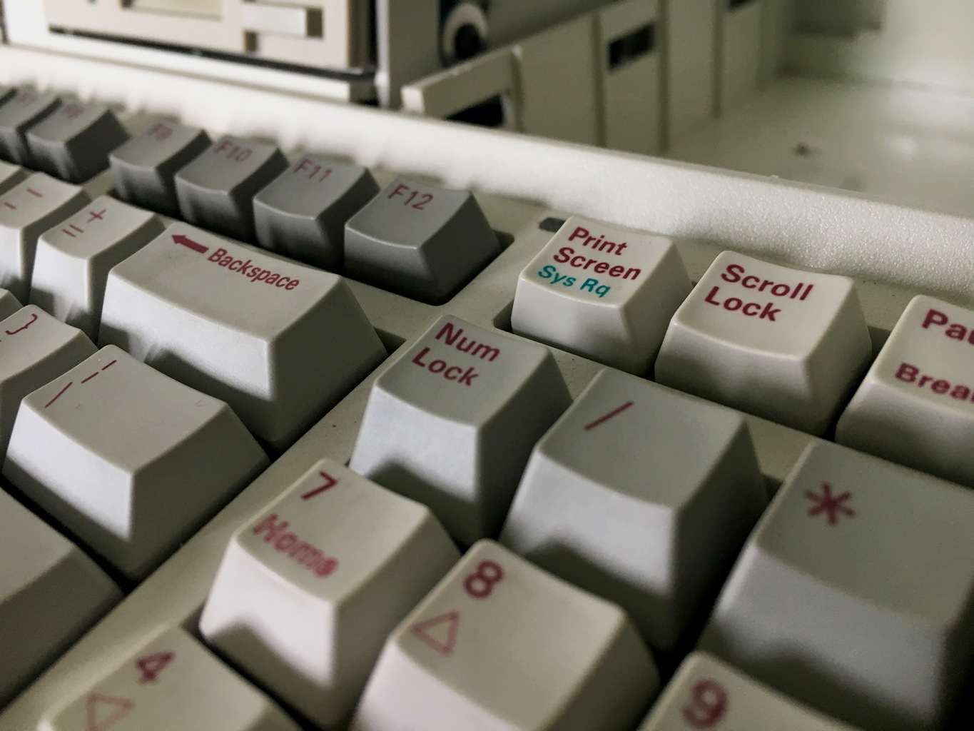

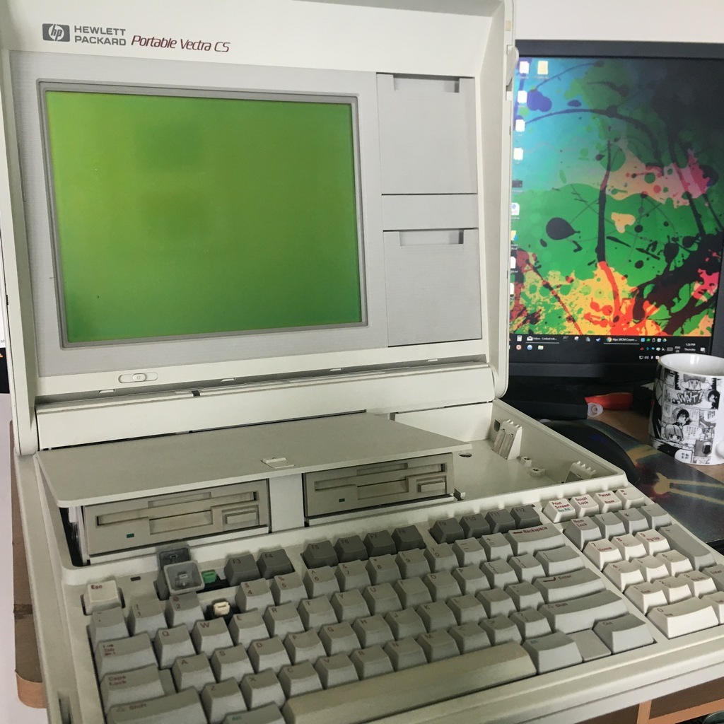

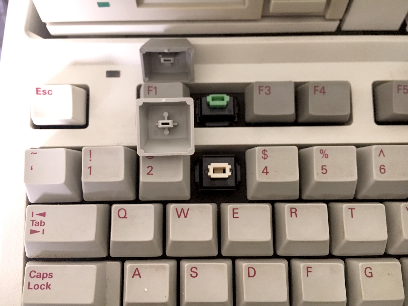

Another ALPS time capsule arrived at my door today. I'm not sure if this was posted here before, if not - I will add links to the relevant wiki pages next week sometime. But, for now, I give you my future retro gaming ms-dos box the...
A 1987 Hewlett-Packard Vectra CS Portable. https://is.gd/ev87SC
The hole by the floppy drives is where the battery pack goes; I'm trying to revive it atm. You can charge the battery separately as all the power management is in the module. You can also easily unclip the screen to plug it into an external monitor for EGA graphics - cool. The drawers by the screen are for storing the 3.5" diskettes.
It also comes with a combination of tactile complicated (SKCM) creams that are incredibly smooth and similar to orange alps I have; little bit more tactile, with a sharper feel. I'll look more into them when I get some free time. The function keys are linear green SKCL compacts that are ~50g. Spacebar is rather heavy, and might be a heavy cream - needs checking out.
cream and green.JPG (220.35 KiB) Viewed 8204 times
The keycaps are really nice with crisp maroon dye sub lettering, probably PBT, with a very unusual horizontal cylindrical profile. The front of the keys is strongly sloped, would be perfect for an ergodox. I tried to capture the profile below, I'll add a better photo later as it's rather unique.
I got this for essentially the cost of shipping as it was meant to have serious display issues, so this computer was going to be a keycap and switch donor, those are mint, it must have got hardly any use before being put away for a looong time. Amazing how smooth the complicated creams are, I'm going to compare them to the 1986 oranges more closely as soon as I get some free time. However, it turns out that some connections just needed to be cleaned of oxidation and chips re-seated, for it to work flawlessly. With its cool orange plasma graphics, it deserves a better fate then being a donor: so- looks like I'm going to restore it to it's full glory for retro gaming.
PS. That weird profile keyboard is actually rather nice to type on, weird, but nice...
