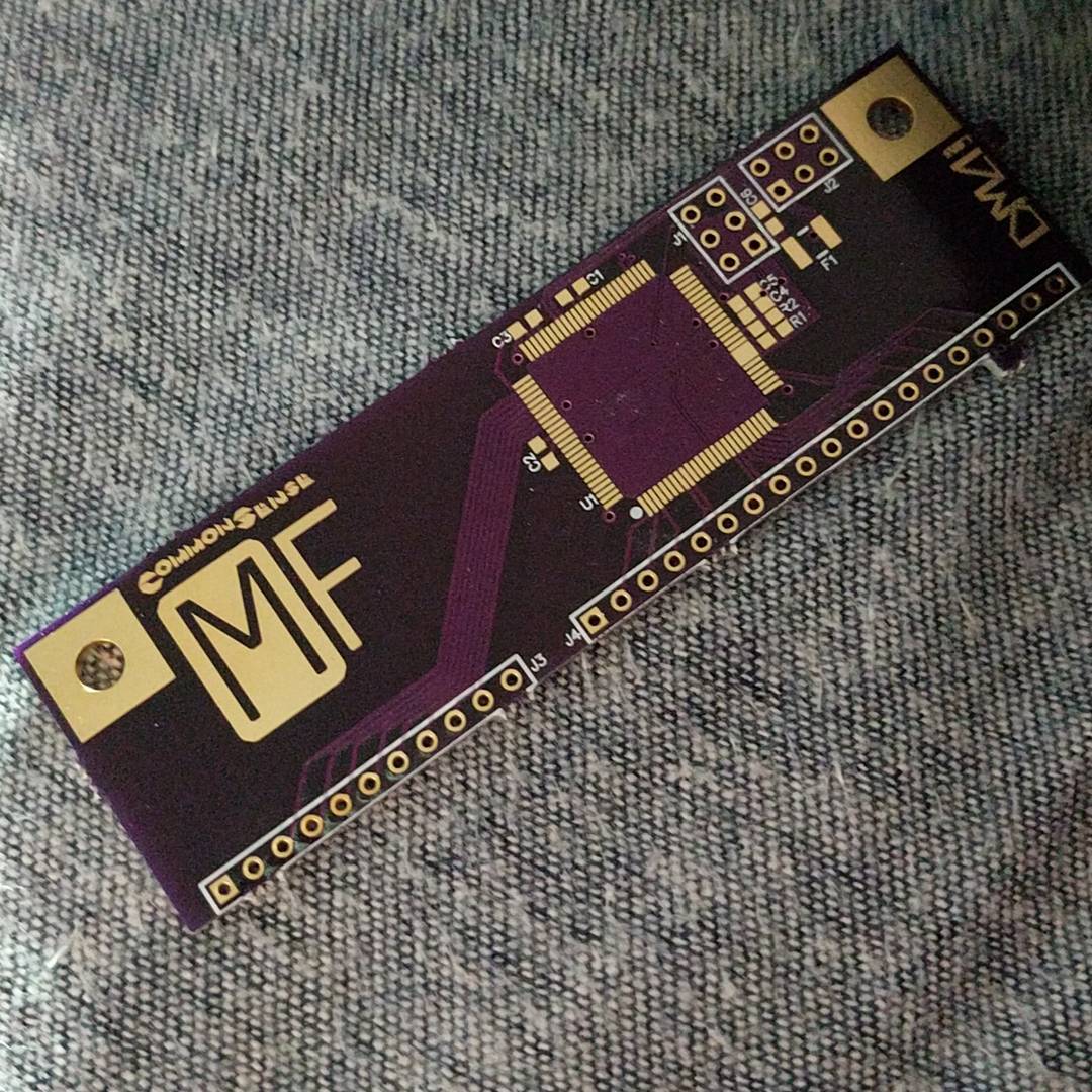

DMA
16 Sep 2017, 04:15
Thought I'll leave this here. Got this in the mail today.
Techno Trousers
100,000,000 actuations
16 Sep 2017, 06:15
Wowie wow wow, that is one gorgeous piece of hardware!!
drevyek
16 Sep 2017, 10:58
fantastic! Really great looking board.
