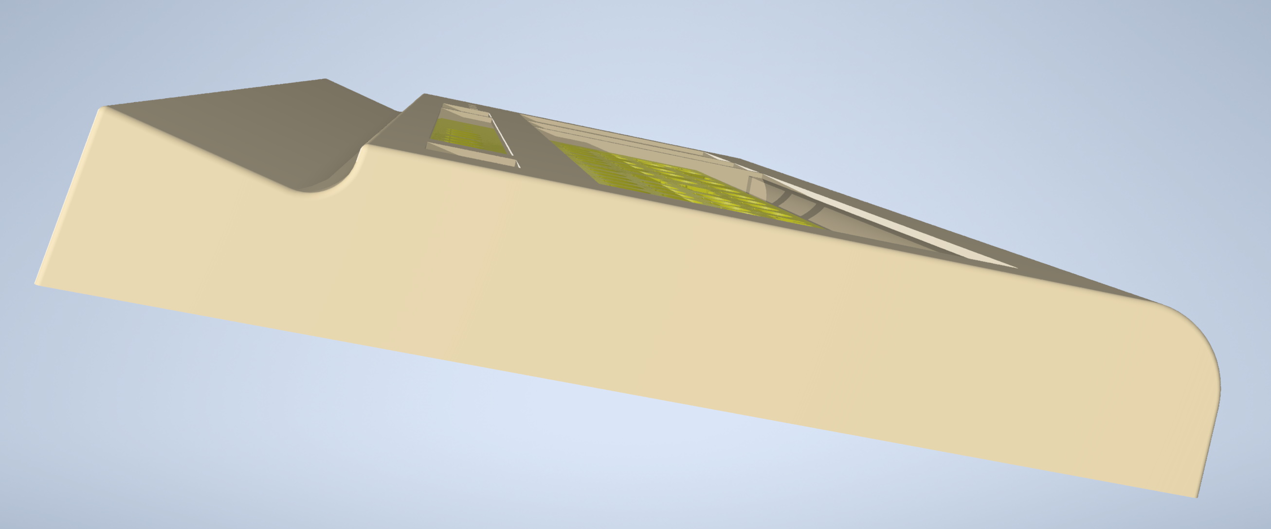

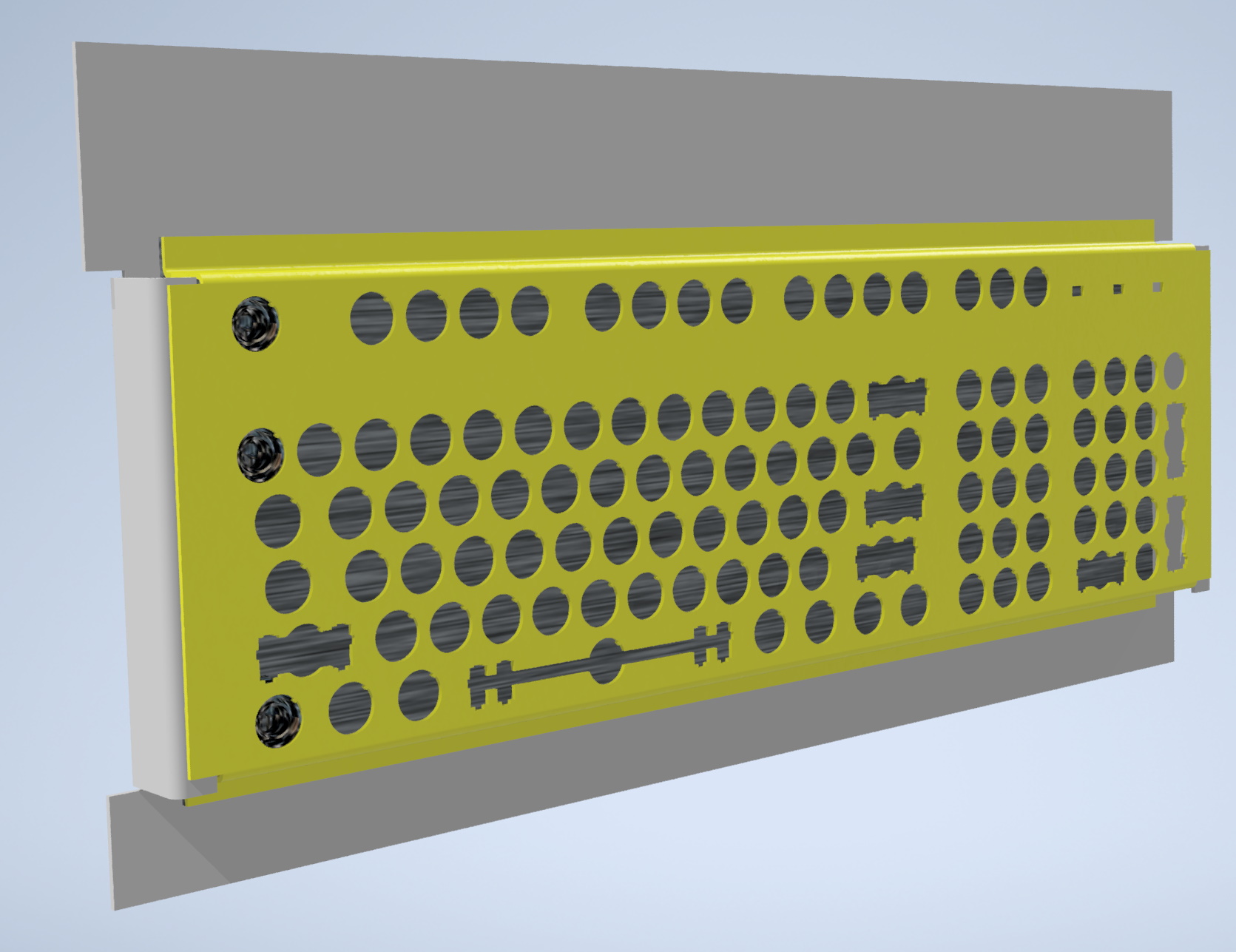

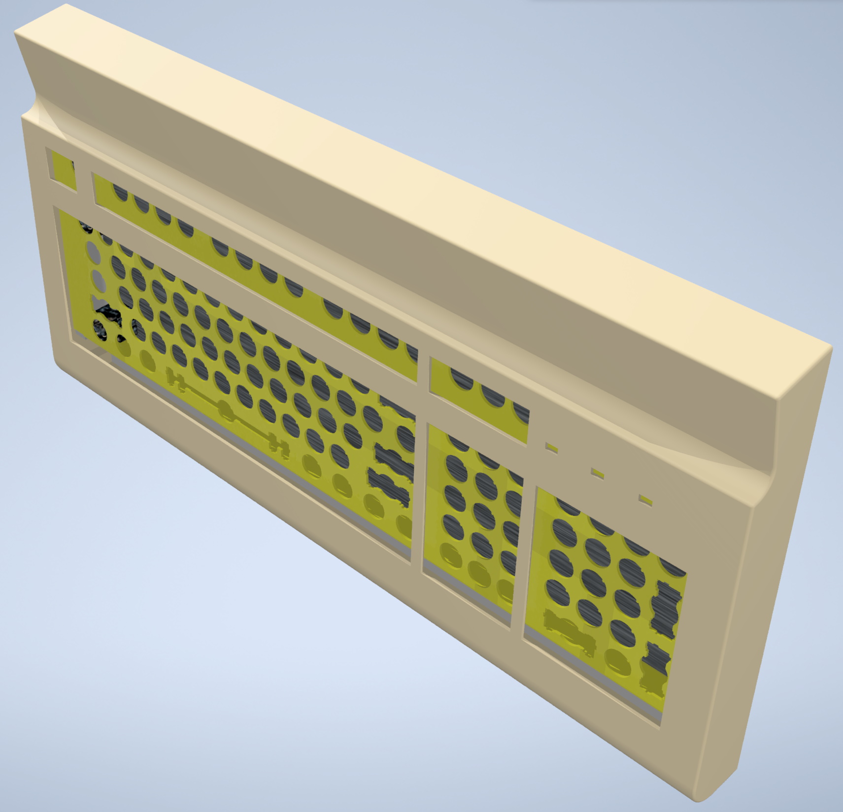

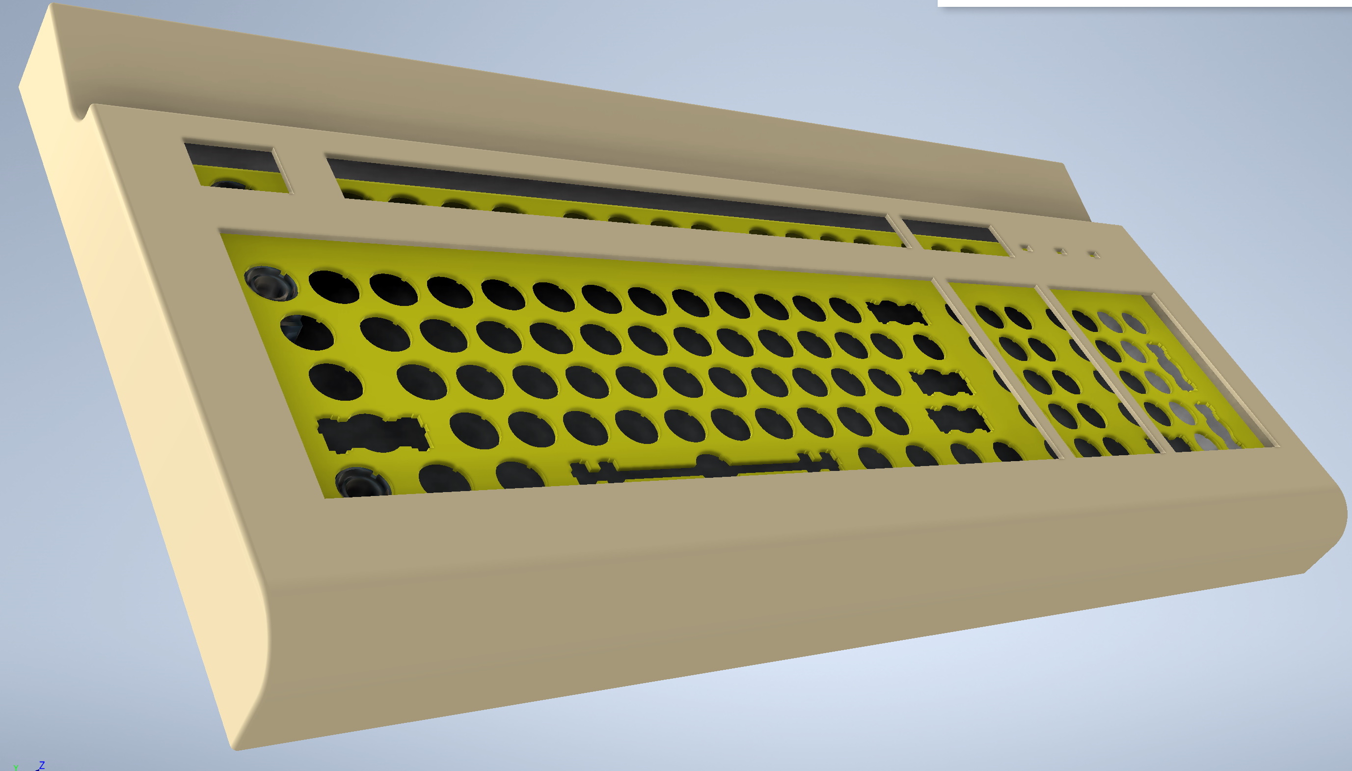

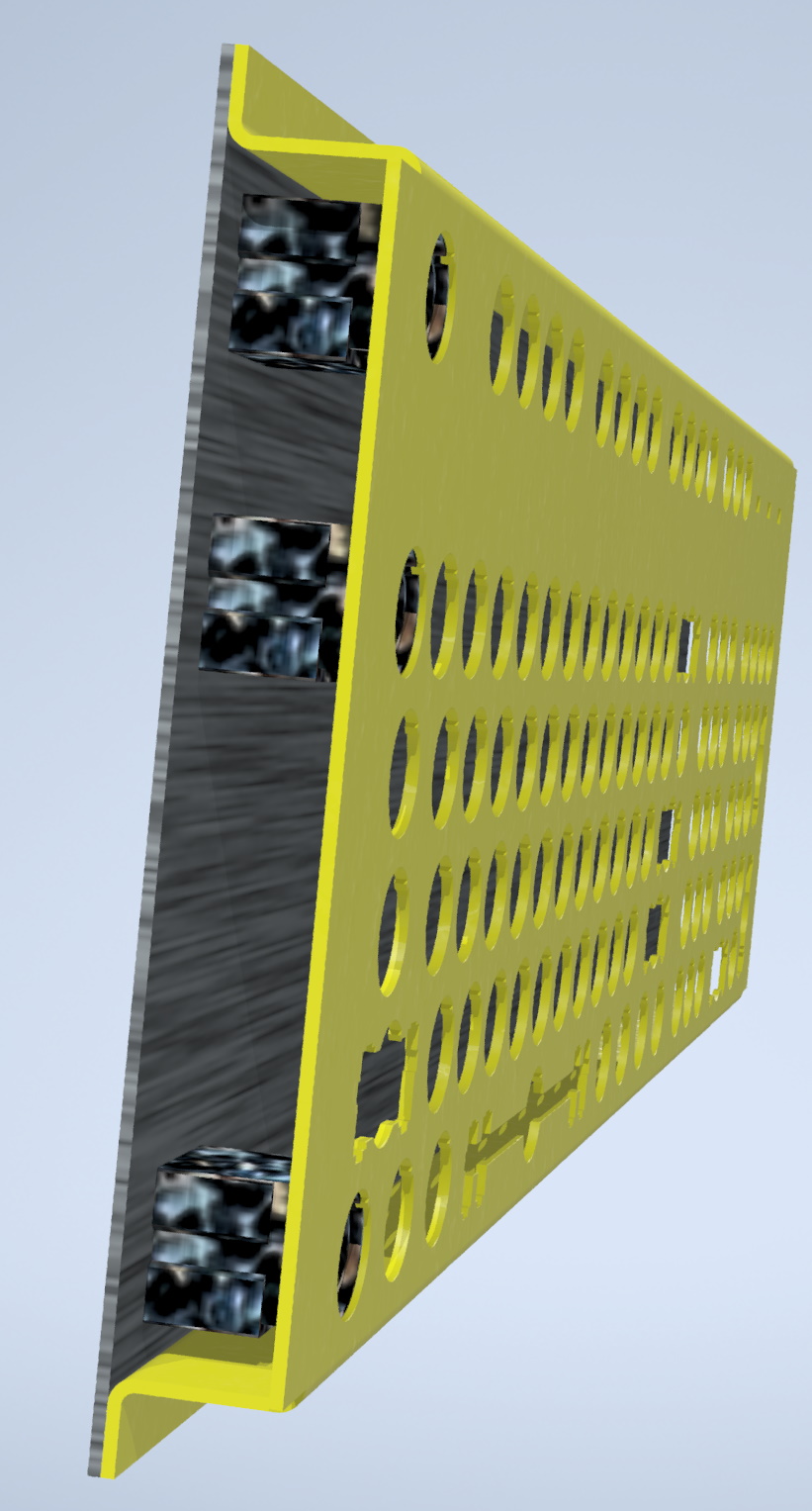

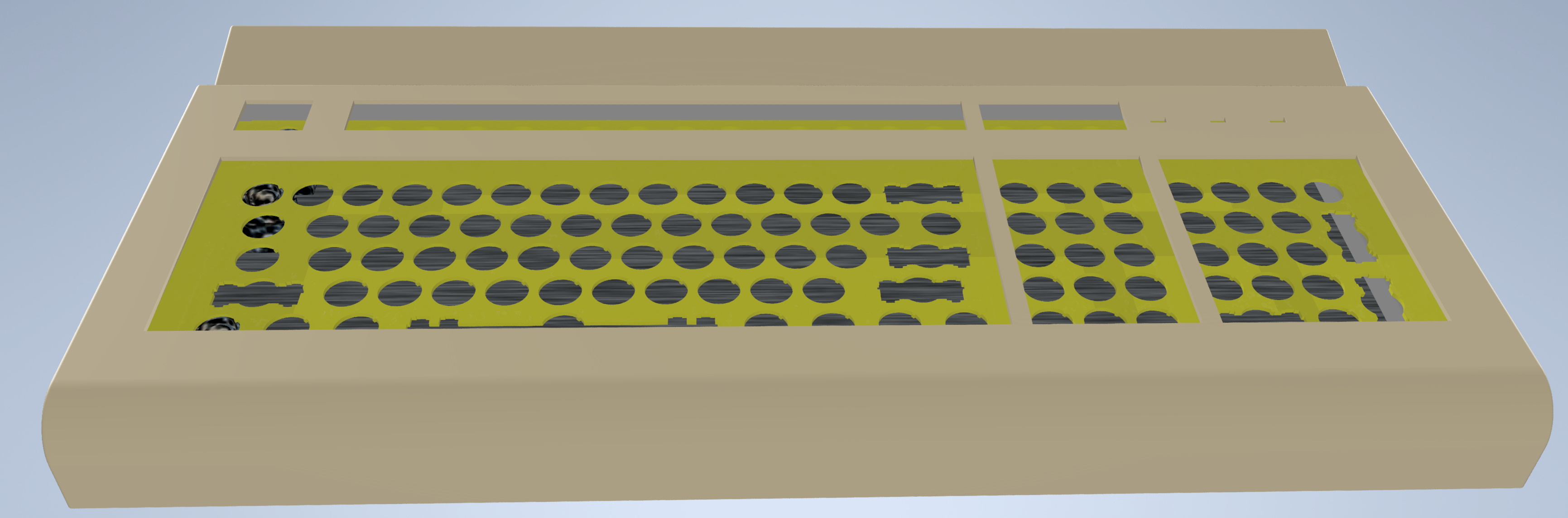

Yes that would be great! Attached is the first draft of a proposed second round case, inner assembly, and also the beam module whose injection mold was of course made already (also in standard CAD STP file format for everyone interested in offering open source case design options).
The sample keys in the first post were made by a factory I reached out to, not Signature Plastics.
This design is a compromise design with elements from various IBM beam spring cases: it combines the top curved area and near-exact overall length dimension and left and right side bezel thickness of the 3278, the gentler slope below the bottom row of keys of the 3101 and 66-key cases, a shorter profile 40mm case height given the reduced beam module height, and the interior folded sheet metal bottom plate style of the Displaywriter (to eliminate the need for additional die cast molds for the bottom case parts). Also the bottom case plate is recessed from view. Edges are rounded.

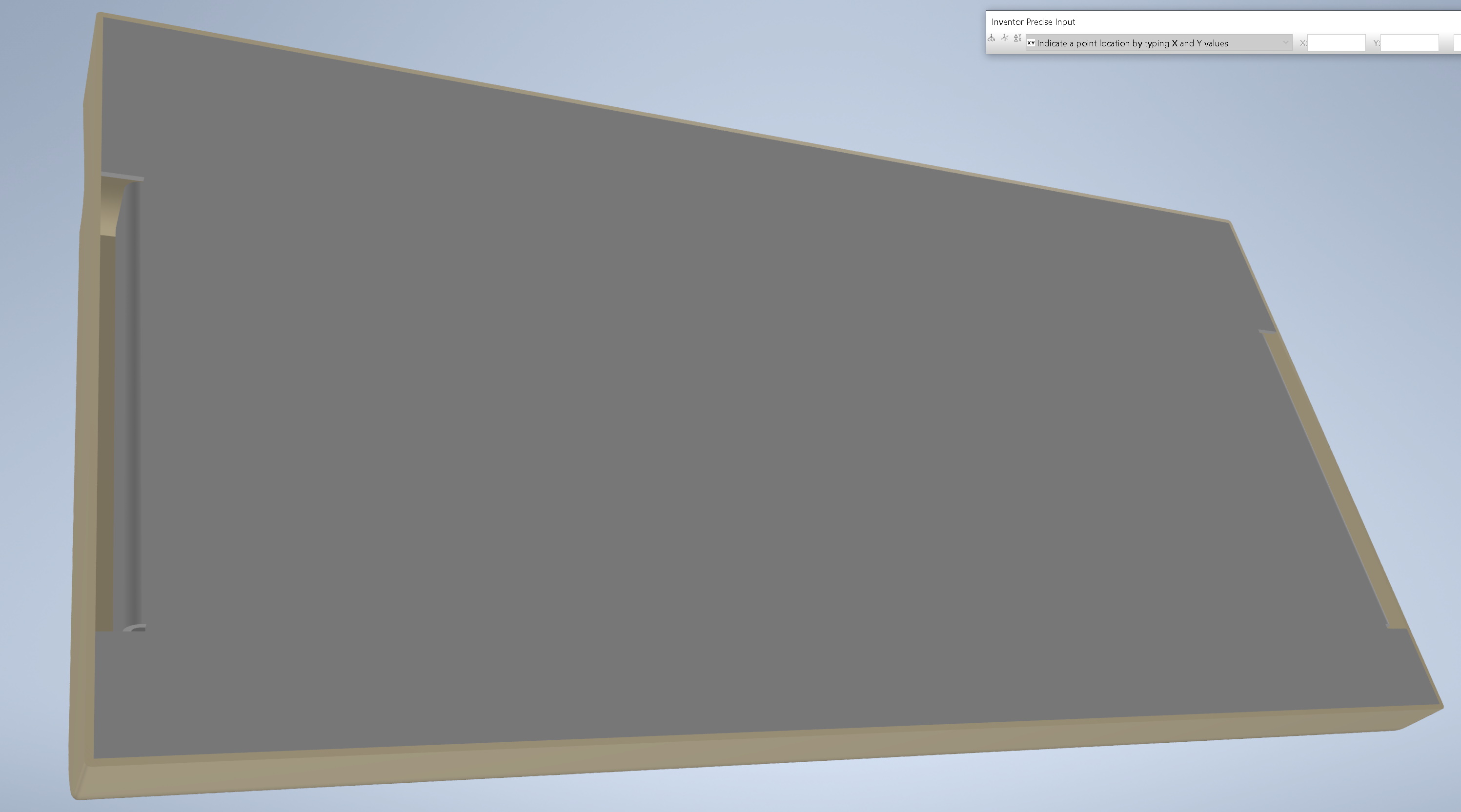

Not shown are the holes (for screws, bumpers, etc. - countersunk screws for the 2mm thick bottom case plate). Also not done in this file - proper LED cutouts, exact measurements of the cutouts and case height in the keys area, to sufficiently recess various profiles of MX keys into the case.

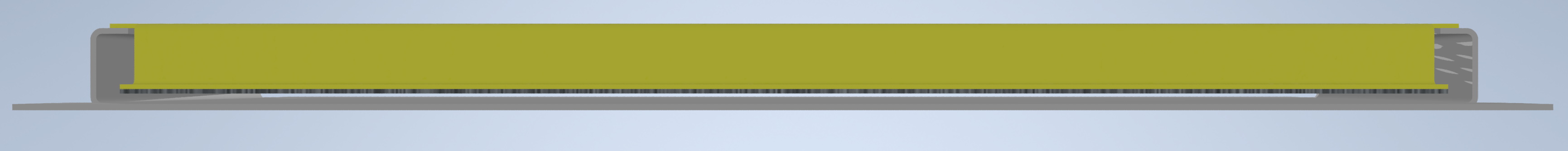

Elements not modeled in this file - most of the beam module itself (only the main piece is modeled), the 2mm thick foam planned to go on top of the beam module and below the top inner assembly, the capacitive PCB, foam or rubber PCB underlay, plastic mylar barrier between top inner assembly and capacitive PCB. I believe that the current dimensions also allow for an additional 2mm compressed foam below the inner assembly, for added sound dampening.
While the original cases were tilted significantly, to allow for fully customizable keyboard angling through bumpers the case will remain neutral. This also helps keep shipping and packaging costs as low as is feasible.
The file also includes the expected holes and beam module CAD files with the expectation that folks can order modules to make their own cases and layouts, though this would be much lower priority as the goal is to get enough cases and full keyboards ordered to keep the price feasible enough to proceed with ordering the molds. The modules are by far the most costly part of the keyboard so the overall costs for making your own keyboard will not be lower than the full keyboard cost in my estimate - I haven't finalized the cost of individual modules, though each first round beam spring keyboard does include a mini first aid kit of several spare modules as mentioned in the original post. The top inner assembly beam module holes are slightly larger than they were for the first round of the beam spring project, so as to allow for more wiggle room and more isolation between the plate and beam modules (with the goal of dampening the sound).
Draft case dimensions are LxWxH 495x248x40mm. There would also be a TKL version of the case without the right side block (and maybe with or without the LED indicators - not sure yet).
As noted before, the stabilizer insert cutouts are kind of vestigial at this time, with the exception of the space bar stabilizer which is required. I have found the non-space bar stabilizers prevent proper operation of the MX keys with the beam modules. They are all included with each first round beam spring keyboard though, in case anyone can use them.
Beam assembly - 104 v2.zip
(282.08 KiB) Downloaded 314 times

t8c
11 Mar 2022, 14:16
Looks good. Would a F62/F77-like 1.5u-1u-1.5u-7u bottom row require a new plate and PCB? It would be a nice option.
Guppy
11 Mar 2022, 20:04
That case design looks excellent. I really see the inspirations in it. Love the slope design of the 3278 (Pencil tray?) along with the shorter front lip of the 3101.
What are your thoughts on adding feet options?
JCMax
11 Mar 2022, 23:08
The case design looks good. Will it be possible to do different color options like the Model F's? (I.E. Beige, Gray, Black, etc?)

thefarside
12 Mar 2022, 17:55
I like the design. What is the case material going to be?

So with this new case design would it be possible to have a numpad etc on the right of the TKL, similar to the F77, and unlike the first round design that seems to only allow a nav cluster there?
Ellipse
14 Mar 2022, 18:01
Please keep the feedback coming! Now is the time to think about all these decisions.
The material will be powdercoated aluminum.
Confirmed different colors will be available. My guess is the same colors as the Model F project, but maybe without a few low volume colors like Silver Gray, dark blue, and light blue unless the additional tooling costs are paid for by those requesting it.
The photos show the standard 104 key and TKL options in the first post. Both options are available for this project. The 104 key option has the num pad block on the right of the keyboard.
Yes the 1.5u-1u-1.5u-7u bottom row would require another separate design and it seems like the 1.25U keys are more common for MX offerings. As noted before if enough people pay the tooling costs then I can offer the additional layout options. ISO will be definitely offered.
Regarding feet, the case bottom will have 6-32 threaded holes so various bumpers should be possible, including those offered by the new Model F project except the 8-32 medium threaded bumper, as well as your own bumpers.

I also strongly prefer this case design to the first one proposed. Definitely not a fan of floating switches.

ifohancroft
16 Mar 2022, 21:22
I'll be designing some cases and stream while doing it. Ellipse asked me to post about the stream on here when I'm about to start, so here it is:
In a couple of minutes, I'll be streaming while designing some cases (not all today) for the Beamspring reproduction project. You can watch the stream here if you want: https://twitch.tv/ifohancroft
At a later point I'd look into downloading the VOD, and recording a voice over it explaining what I'm doing and shit, and putting it on YouTube in-case it's helpful to people interested in CAD and/or keyboards
