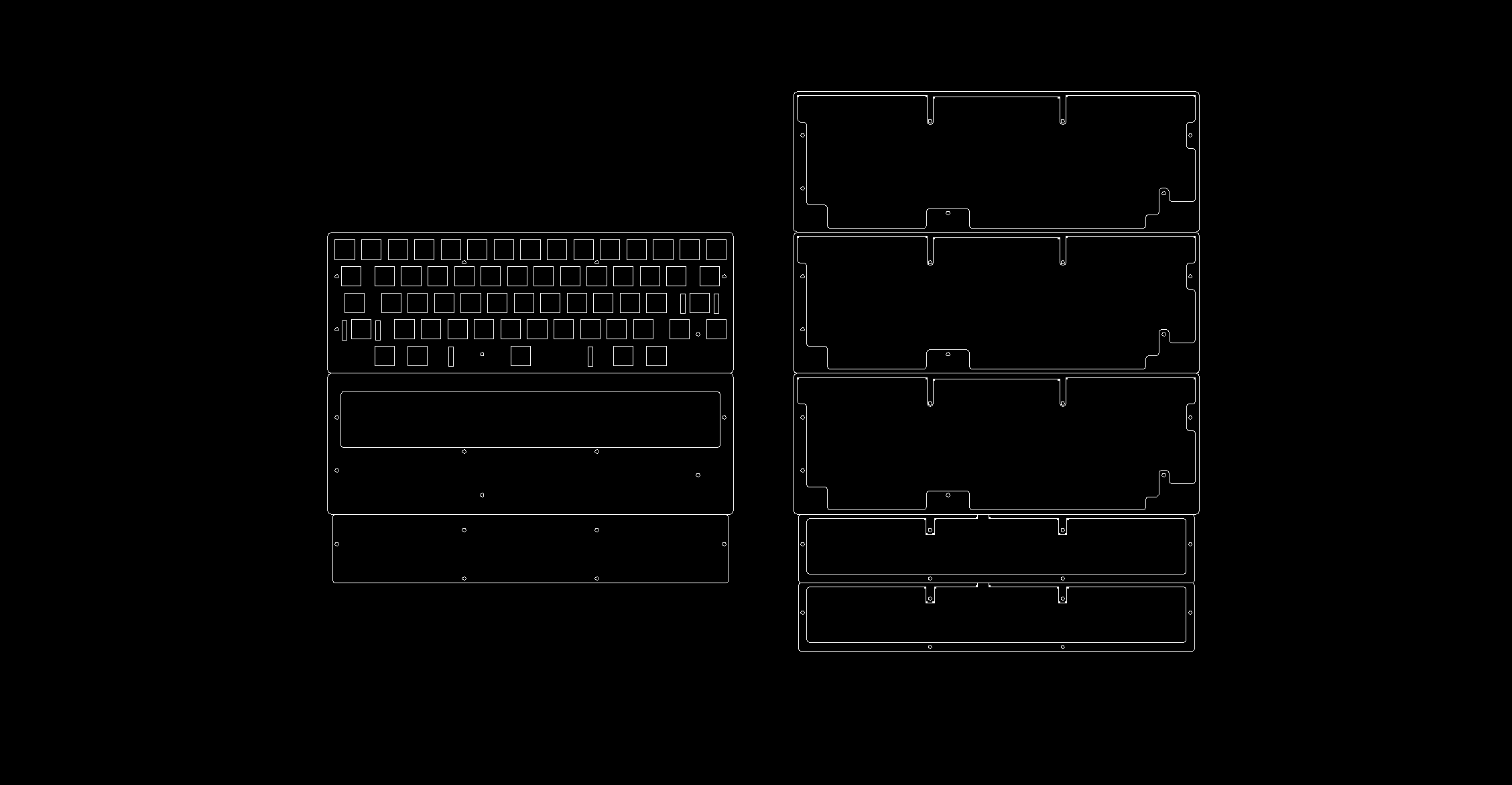

Okay I'm finalizing the design to push to the laser cutter. I'll post a preview as soon as possible. All layers will be named with the DT nick of the owner, you are responsible for your layers. If you see errors or you don't see your name let me know right away.

So, HHFox is still unproven? Because that plate design (with my layout) is what I really want. (And a stepped case if I can get away with it.)

I thought you were redesigning your own case. Do you want me to try to hide the screws from your original layout?Muirium wrote:So, HHFox is still unproven? Because that plate design (with my layout) is what I really want. (And a stepped case if I can get away with it.)
The stepped case is a possibility but I never tried it so it inherits a certain grade of risk.

Yes, try to HHFox-ify my plate, please! I'd love to see them side by side and understand your strategy.
Is there anything about a stepped case that would make it impossible to use HHFox style hidden screws? I understand that risk increases quite a bit when mixing two new things together, even if they are compatible

adding the step is not the easiest, so many things can go wrong. Anyway I'll post the design maybe you can help me spot errors.Muirium wrote:Is there anything about a stepped case that would make it impossible to use HHFox style hidden screws? I understand that risk increases quite a bit when mixing two new things together, even if they are compatible

I like it!
Visually, it checks out fine. But I would really prefer to do a scale drawing in 3 dimensions to be sure. Could you put a millimetre scale on your PNG (and export it nice and large) so I can transfer everything to paper? And could you label the layers with their thickness? I am particularly interested in working out what angle this body will sit at.
(I am banging my head against the wall with the available software! The only app I have found so far on Windows 7 to open these DWG files is DraftSight, which is pretty ugly. Inkscape and SketchUp both refuse the unzipped HHFox and HHFox Stepped DWGs for no sensible reason. I am horrible at using Windows anyway, so I have no idea what is wrong.)

The best I can do is to export to PDF so you can import and print easily. Anyway draftsight is good enough for taking measurements. Use the "distance" tool.
The layers are 1.5mm on the left and 3mm on the right.
I've spotted a couple of things that could be done better. I'll post v2 in a bit.
