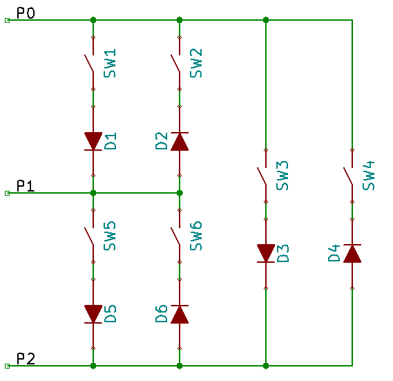

Here's an example:
Charlieplexed keyboard
The scanning goes like this: the MCU drives P0 high and configures P1 and P2 as inputs and with pull-downs. If SW1 is closed (key is pressed) P1 will be read as high by the MCU, and if SW3 is closed P2 will be read as high.
Then P0 is driven low, and P1 and P2 are configured as inputs with pull-ups. If SW2 or SW4 are closed, P1 or P2 will read as low respectively. SW1 and SW3 are ignored.
Then the MCU drives P1 and reads P0 and P2 as inputs. And so on...
If you add another pin (P3) bringing the number of pins to 4, the max number of keys would be 4*(4-1)=12. You would have to wire two keys with diodes between each of these pairs: P3 and P0, P3 and P1, P3 and P2.
Charlieplexing is usually used with LED matrices. I've been playing with a LED driver chip (AS1130) in the last few days and this is how I got the idea.

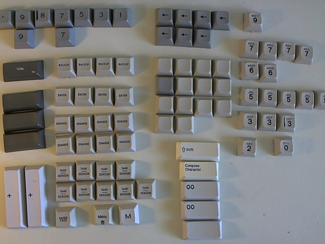

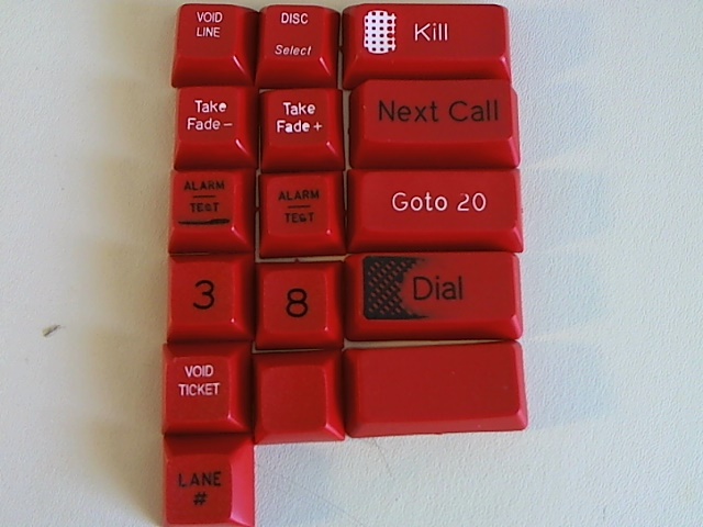

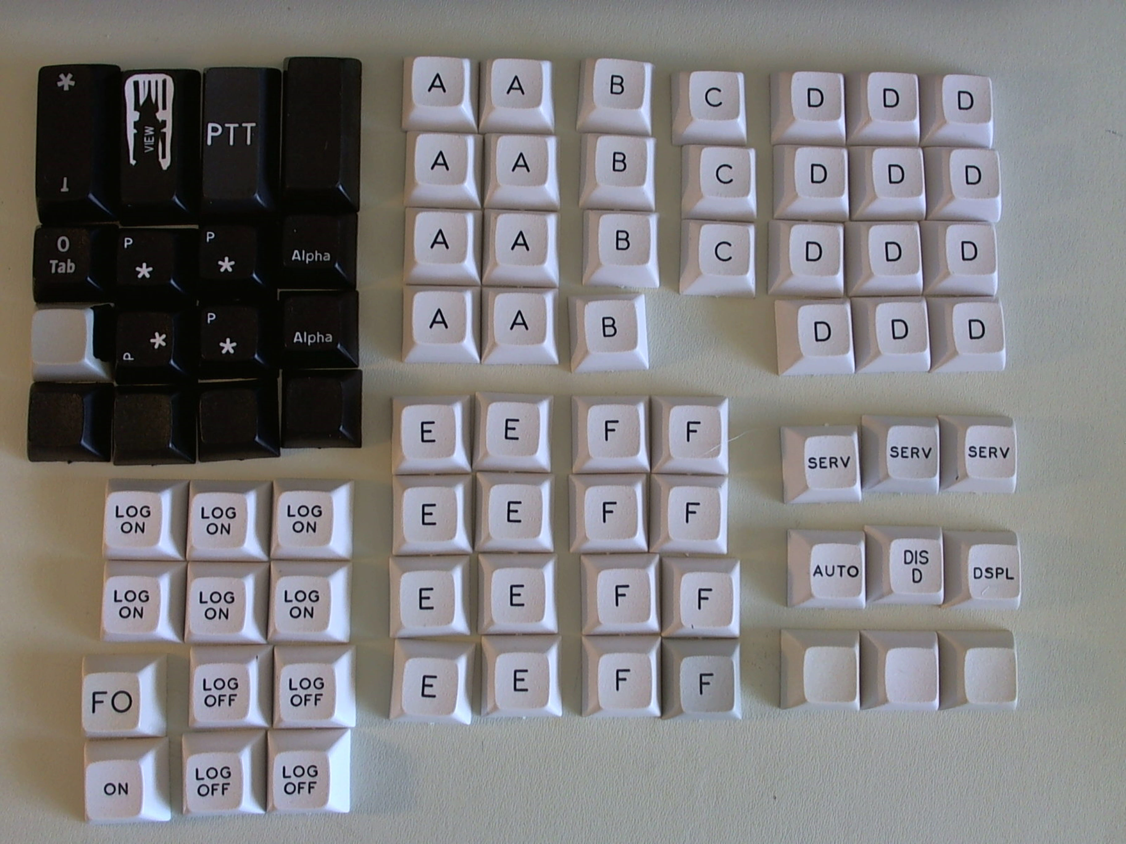

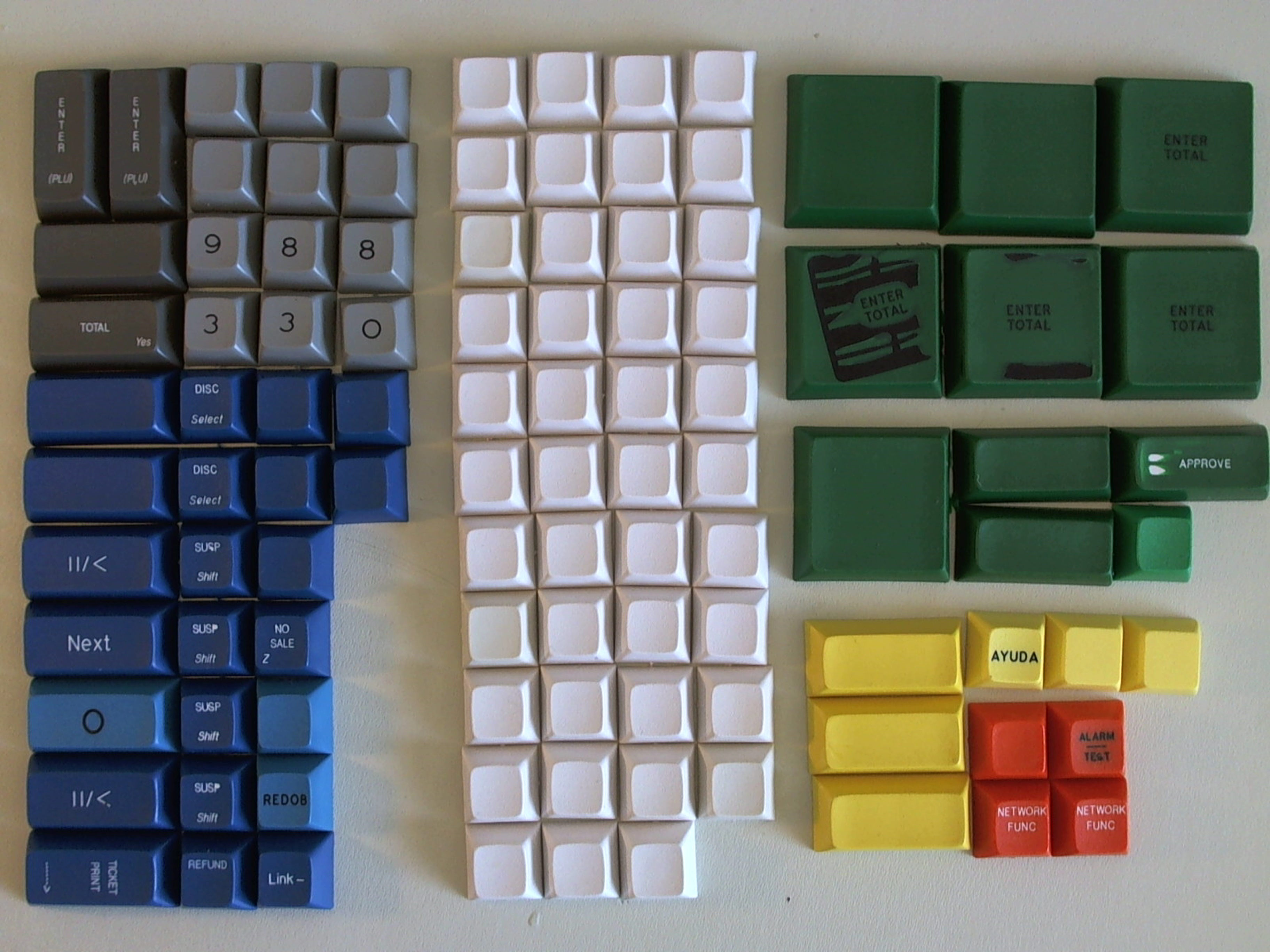

This project is great and I believe that my personal preference are somewhere between the OneHand, OneHand-v.Kile and ErgoDOX. When budget / time allows I will take away a lot from these projects. Thank you guys!
OT: DSA Keycaps - First pick: PJE -> Kile -> Anyone else actively participating in this project!
I don't want to hi-jack your great thread PJE, but since it's kind of connected to this, I still wanted to post it here. Mostly hidden behind "Spoilers" :)
These are the DSA Caps I've got. As mentioned, they are totally random and some are of varying quality. I.e:
- Some have mold marks on them.
- Some have the double-shot legends poking out etc.
- Slight shift in colour.
I would consider most of these as "try before I buy a real set" kind of deal.
But that said, a lot of them, especially the blanks are great!
If anyone got some questions of want to see something specific in more detail, just let me know and I'll see what I can do.
PM with what you would be interested in.
Price / Compensation / Barter / What'ev will be agreed upon.
Shipping within EU seems to be 2€.
The light-gray mods in the middle of this photo are NOT DSA. But maybe it would be of interest anyway.
-- noesc

Thus, each OneHand PCB allows the connection of 22 switches, 18 to 20 mounted on the PCB, and 2 to 4 externally. Using two PCBs together will allow up to 44 switches to be scanned by a single CPU without needing to add anything other than the switches. Additional keys could be scanned if the matrix was expanded, which would require additional diodes.
The additional DIO connector was added to allow the two DIO connections to provide a rotary scroll wheel (Encoder + push button) interface without preventing a PS/2 touch pad to be used.

From my rough experiments, I feel 1.5 high keys would be better for the additional thumb keys, and remove the need for a stabilizer as you would be pressing down on the stem location.
I'm going to have to splash out on some new key caps as well. I think the main keys will need to be DSA to allow the main A..Z function to be shown on the key for speed of learning, and also to allow custom arrangements. The standard number pad [Enter] and [+] keys provide a nice slope for the main thumb key when installed upside down. I'm not sure if there are any vertical non 1.5x keys with the correct shape. Only time will tell!
