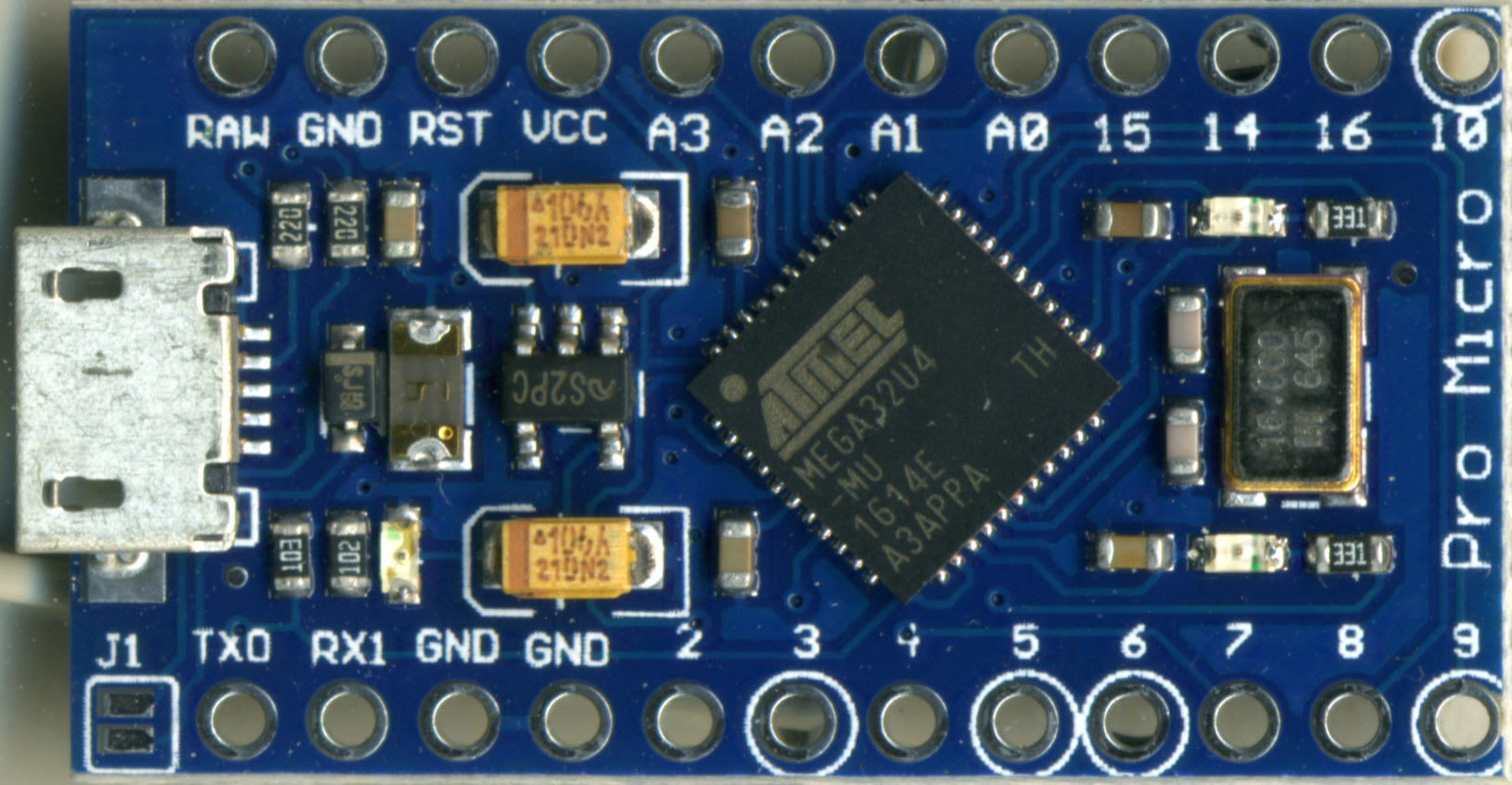

You see, the chinese boat finally arrived and I got THAT:
... 3.3V it seems to be, but with a 16MHz quartz, although the article listing specifically said 8MHz.
Very funny, my Chinese friends.
So ... could you send me one? I could offer this 16MHz one as a replacement.
No hurry - I'll be on holiday from next week until Sep 10 anyway.

I received the 8MHz pro micro - thank you very much, Wodan! - and could experiment with it.
For my purposes, the Arduino boot loader is totally unusable, so I created a version of Grendel's BootHID for the 8MHz pro micro. See my "adventures into pro micro land" for further details. I've attached it here, in case somebody wants it:
BootHID.zip
(2.71 KiB) Downloaded 555 times
This .zip file contains both the 16MHz and 8MHz versions.
Works nicely.
What doesn't work nicely, unfortunately, is Soarer's Converter. Obviously, 8MHz is not enough. In principle, it works, but every now and then a glitch on the clock line occurs, leading to lost keys and the like. The problem isn't in the PC/AT code; rather, it's somewhere on the USB side. Soarer's Converter sends a lot of debug messages which you can view on the PC with hid_listen; if I disable that, everything works nicely. Obviously, the USB transfer of the debug messages takes up too much time with disabled interrupts, so a PC/AT clock transition isn't processed in time.
I've spent some days on this problem, but couldn't find an obvious cause. Maybe there's an underoptimized code part in USB processing that isn't working fast enough (but does so on a 16MHz device), or maybe 8MHz simply isn't good enough.
Well, I'd rather call it a partial success than an utter failure ... here's a version of Soarer's Converter for the 8MHz pro micro that works (at least with all PS/2 keyboards that I could throw at it - haven't got any PC or AT keyboard for testing), but doesn't provide USB diagnostics for the hid_listen program:
Soarer_at2usb_v1.12_promicro8.zip
(14.52 KiB) Downloaded 571 times
... maybe somebody finds it useful.
Note: this entire posting was created with Soarer's Converter on the 8MHz pro micro :-)

I finally made it, after hours of trying I got one working (debian).
Btw is it possible that I have destroyed a pro micro board, after soldering it didn't recognized at the PC anymore and the led are dead?

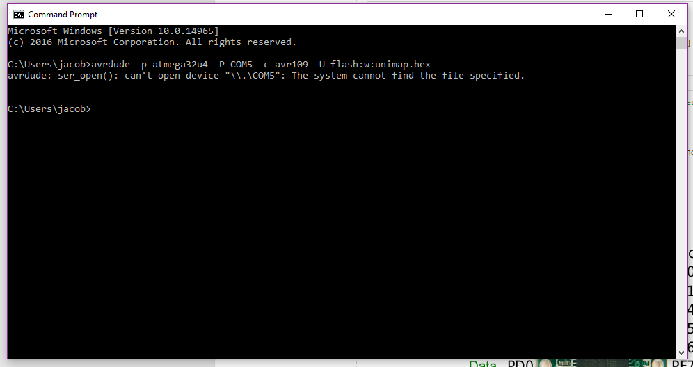

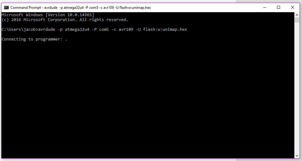

Norman_
17 Nov 2016, 21:35
Am i stupid or why isn't this working? :(
It hangs here completely, no change even after relatively significant time (20 ish minutes)
Edit: fixed the error by soldering in a switch to help reset and resetting, now i get this...ugh, something has gone wrong at every step...
Rimrul
17 Nov 2016, 23:37
You did verify COM5 is the correct port? IIRC it changes when switching to bootloader and I just tried them until I hit the right one, resetting again every few tested COM ports.
