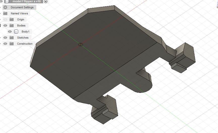

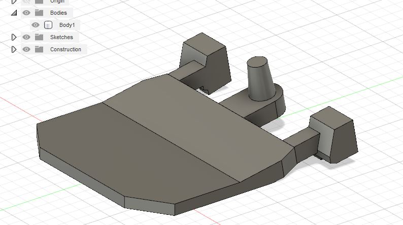

Hi,
This model is not optimal/may not work but its my progress so far. The dimensions do need to be edited. It is untested and may not exactly work/fit yet. So do not take this as a working model. It's just my current draft.
I think the nubs on the "ears" are not optimal and extend down too far.
I just got the resin printer for making beamspring parts so I'm not very good at it. I will try printing the flipper again. The first attempt didn't work at all. The resin... had some issues.
When I get more experience I will just add 20% graphite to the resin and see if that works.

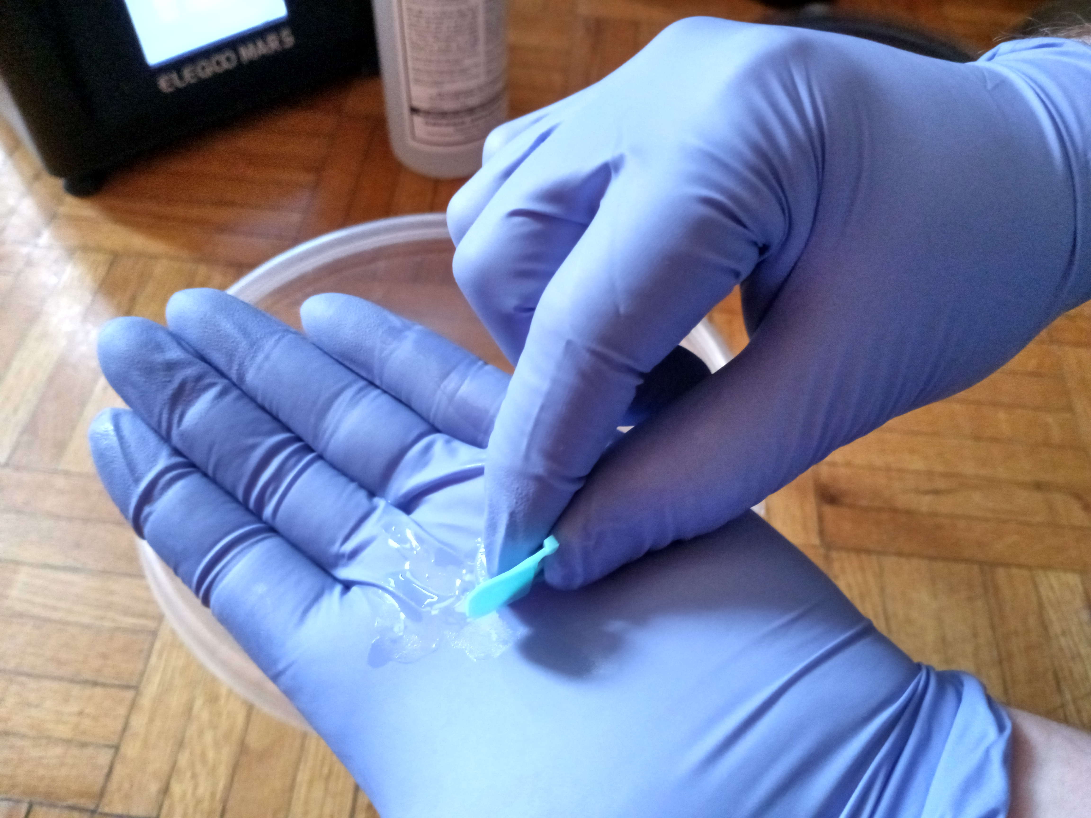

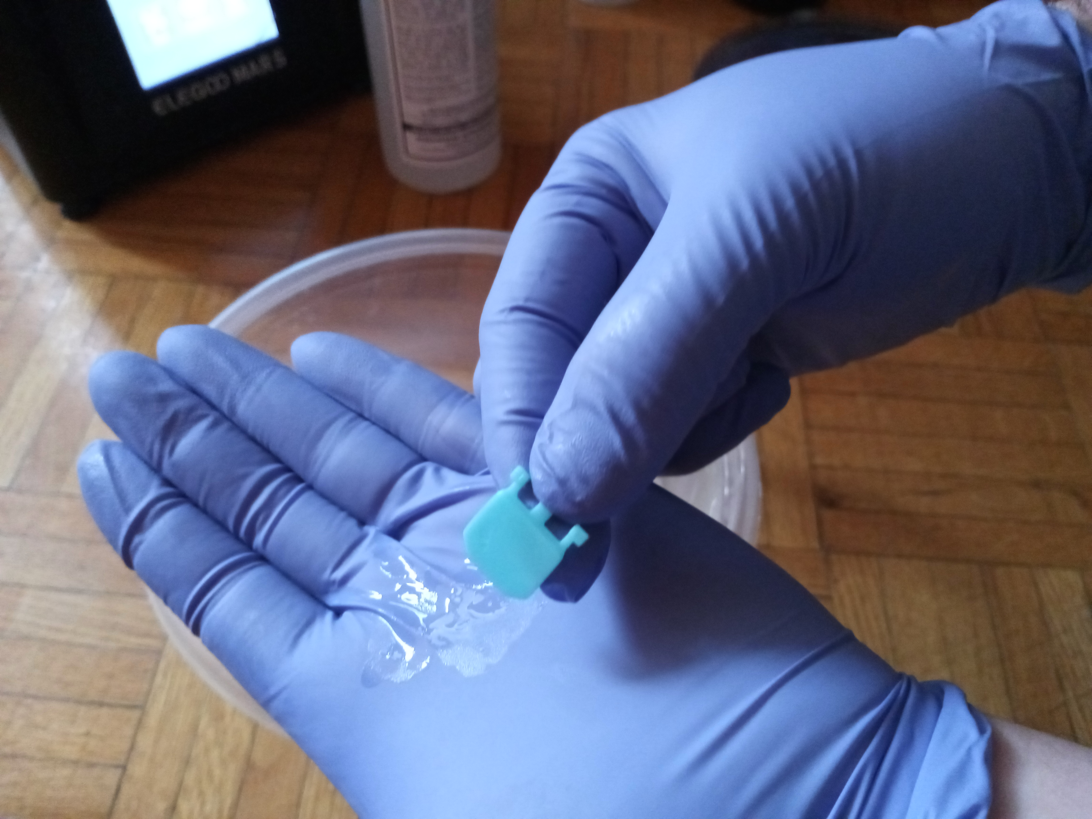

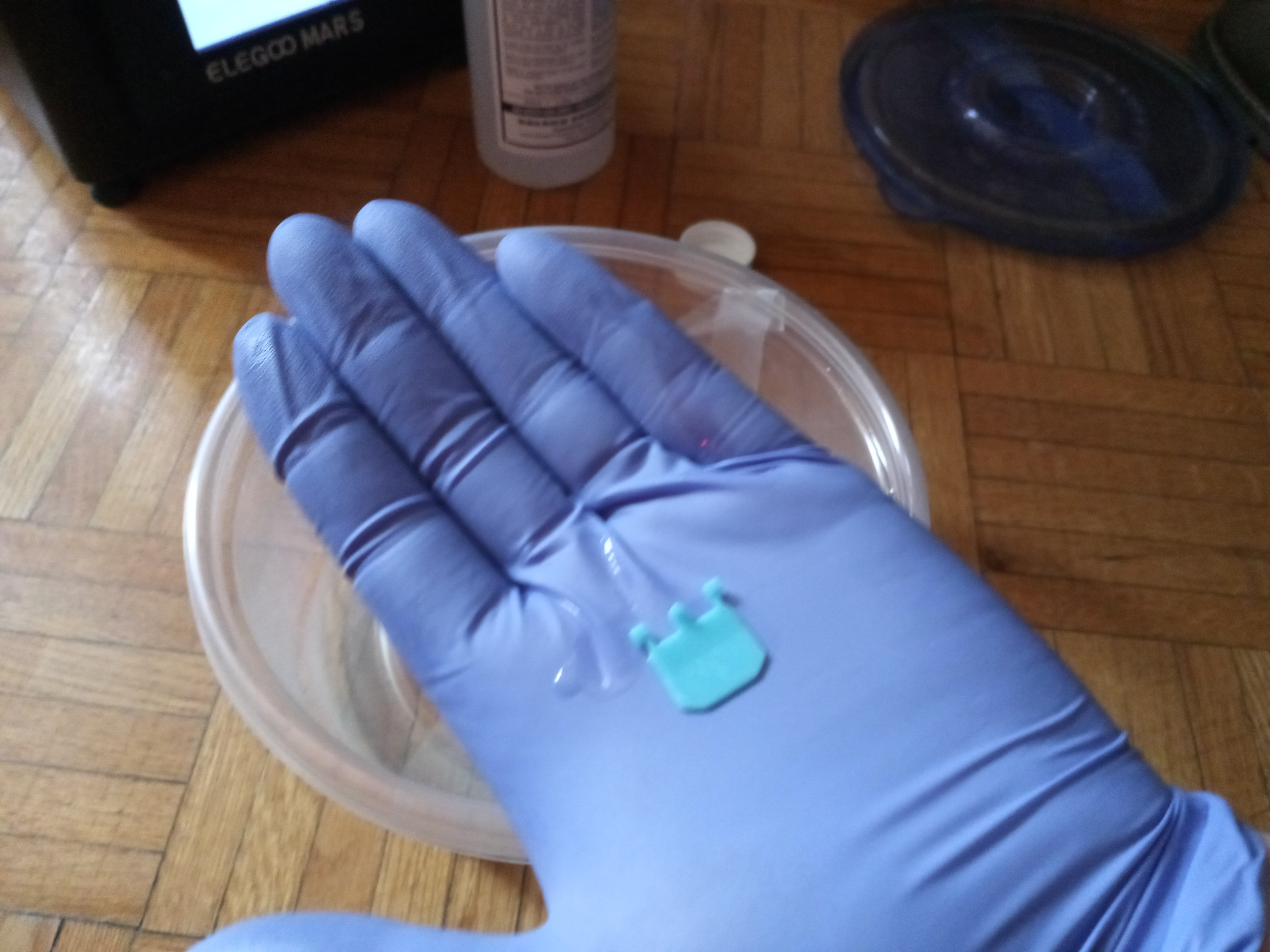

Hi,
Okay it needs refinement but I managed to make a new model f flipper in resin. Very exciting.
Dunno if work. Seems a bit wide. Regardless happy with results.
