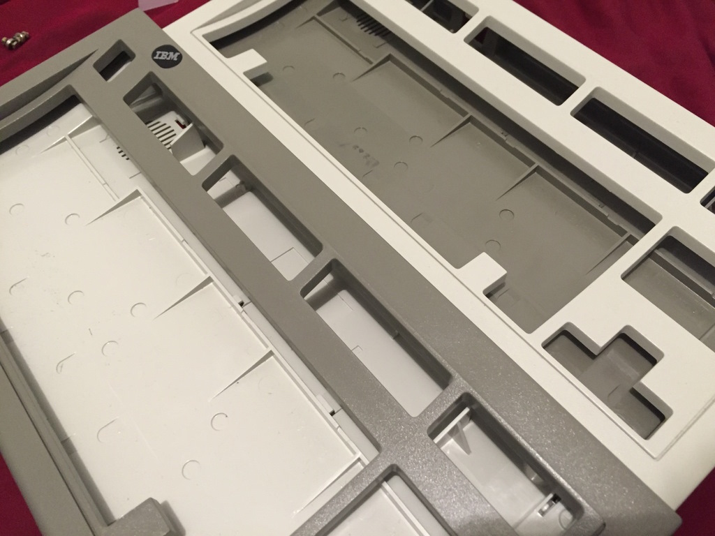

- micrex22
- Location: Canada
- Main keyboard: UltraNav
- Favorite switch: BS
So it looks like there are "FSSK" keyboards being sold now.
Does anyone know if these assemblies will fit in an model M SSK? Because then that basically solves our problem:
https://www.modelfkeyboards.com/product ... -keyboard/
Cheers,
Cheers,
- Muirium
- µ
- DT Pro Member: µ
Ask Ellipse, the man behind them. He’s active here on DT, too.
I know where you’re coming from re: shell compatibility. His aesthetic is… clunky to the point of brutal. Don’t know if he’s done us a favour and kept his design within IBM’s shell tolerances. Certainly wouldn’t count on it until proved.
- micrex22
- Location: Canada

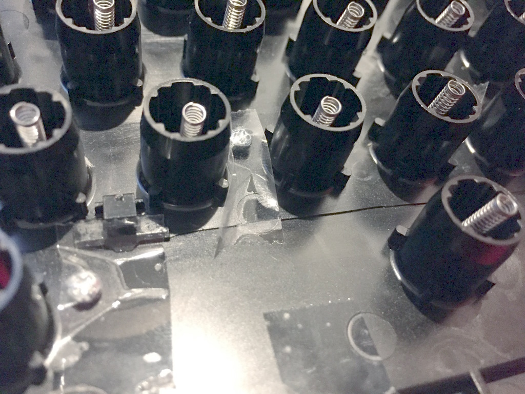

Well it's moreso because the SSK assemblies in mine brokeMuirium wrote: 20 May 2023, 11:35 Ask Ellipse, the man behind them. He’s active here on DT, too.
So it would be nice to use them again
- micrex22
- Location: Canada
Well, the first one started to crack because SSK plastic assemblies are VIRTUALLY CRACKING out of box from the stress they're in. And then the other one fell off from a high shelf where I was storing it and it split in half completely.
I'll just have fun with my two empty shells
- shells.jpg (167.56 KiB) Viewed 15718 times
- ssk_crack.jpg (259.46 KiB) Viewed 15718 times
- Muirium
- µ
- DT Pro Member: µ
Well, look on the bright side: the cool grey industrial one should be very easy to sell.
