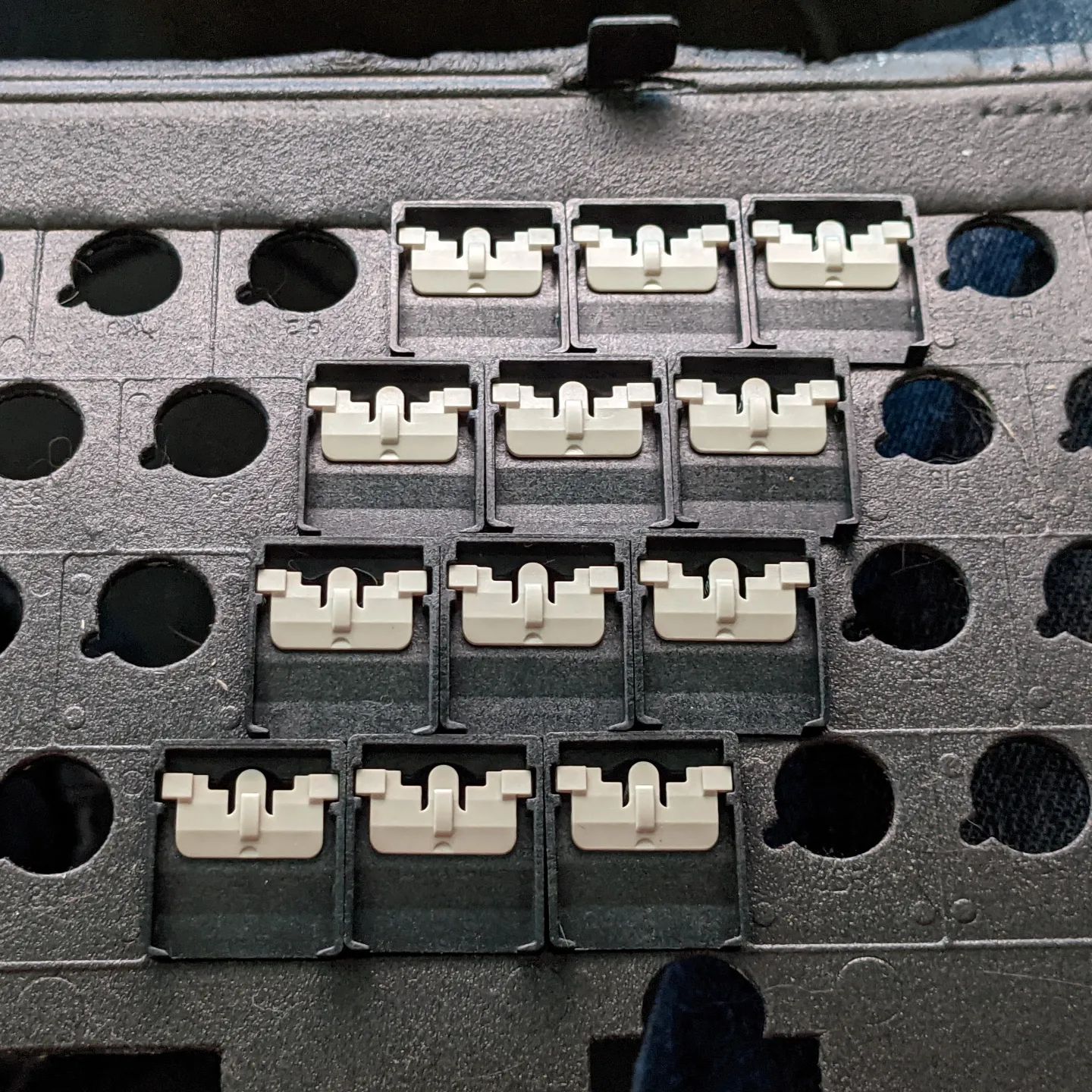

How well do big F flippers fit in an M barrel frame? Got some pics?
The reverse certainly looks different. :lol:
pyrelink
06 Jun 2023, 22:52
Muirium wrote: 06 Jun 2023, 12:45 How well do big F flippers fit in an M barrel frame? Got some pics?
Surprisingly fine (with some minor modifications to a couple rows). Really doesn't seem like they changed the important dimensions too much.

DMA
07 Jun 2023, 02:55
pyrelink wrote: 06 Jun 2023, 22:52
M "barrels" are actually greatly simplified F barrels: the flipper chamber height is 5mm everywhere, transitions from stem support ring to the upper part of the barrel are all 45 degrees instead of what can only be conveyed as "baroque", and flipper retainer is blockier.
Oh, and reinforcing ribs are added in an "X" pattern to spread the load from barrel to the plate more evenly.
Oh, and plastic. Shittier plastic.
07 Jun 2023, 15:03
Man, that looks marvellous! :D
I expect the sound still has a bit more Model M in the mix compared to a full F barrel plate, but otherwise it should be very close, I’m guessing.

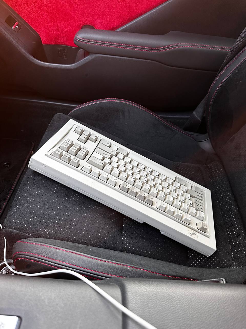

Also I know this isn't the place to brag, but as I have been going back through a lot of old keyboard stuff lately (archiving all of my posts and photos here and elsewhere) I guess I got a bit of the bug back. Last night I did one single search for "IBM Keyboard" on facebook marketplace, and within an hour I had this for $50:
1987, single piece caps, mint condish
I couldn't help myself :roll:
So with 2 spare SSKs I am determined to find myself a metal plate and build another FSSK, maybe with the fancy new ESSK PCB. Genuinely haven't wanted to type on anything else in years, so much so my HHKB almost collects dust.
