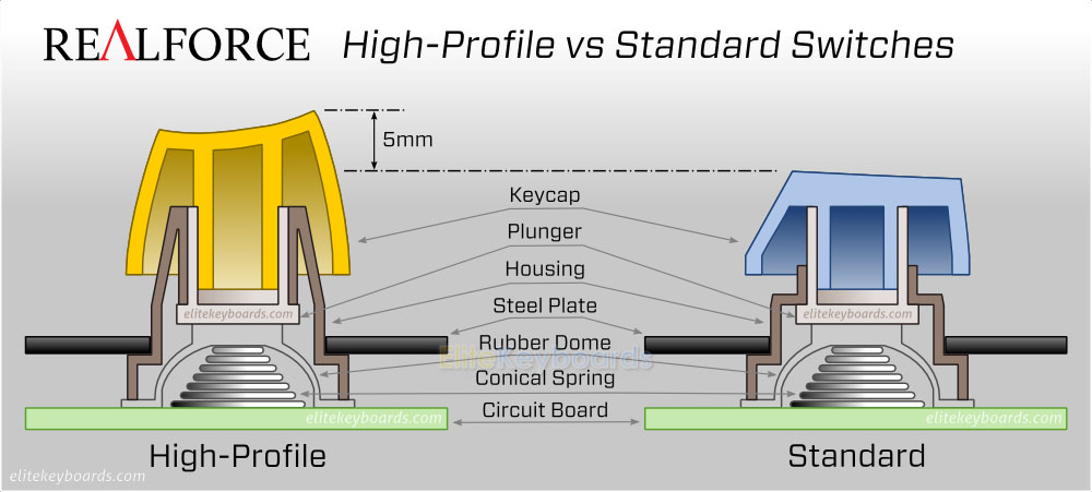

Has anyone here tested the Silencing Rings in the HiPro keyboard? If not, based on what you know about the design, would you expect the rings to work?
UPDATE: I checked the Deskthority Wiki, where there is an image of a standard slider next to a HiPro slider. They are the same height, but the design of the base in the HiPro differs from that of the standard Topre slider. Unfortunately, the base design in the HiPro looks similar to that of the Left Control in the RF87U, and I have determined that a Silencing Ring cannot be used on this particular slider. Based on this, I think that the rings might not work in the HiPro, but this has not been tested directly as far as I know.

does this mean any silencing ring will not work with the HIpro?

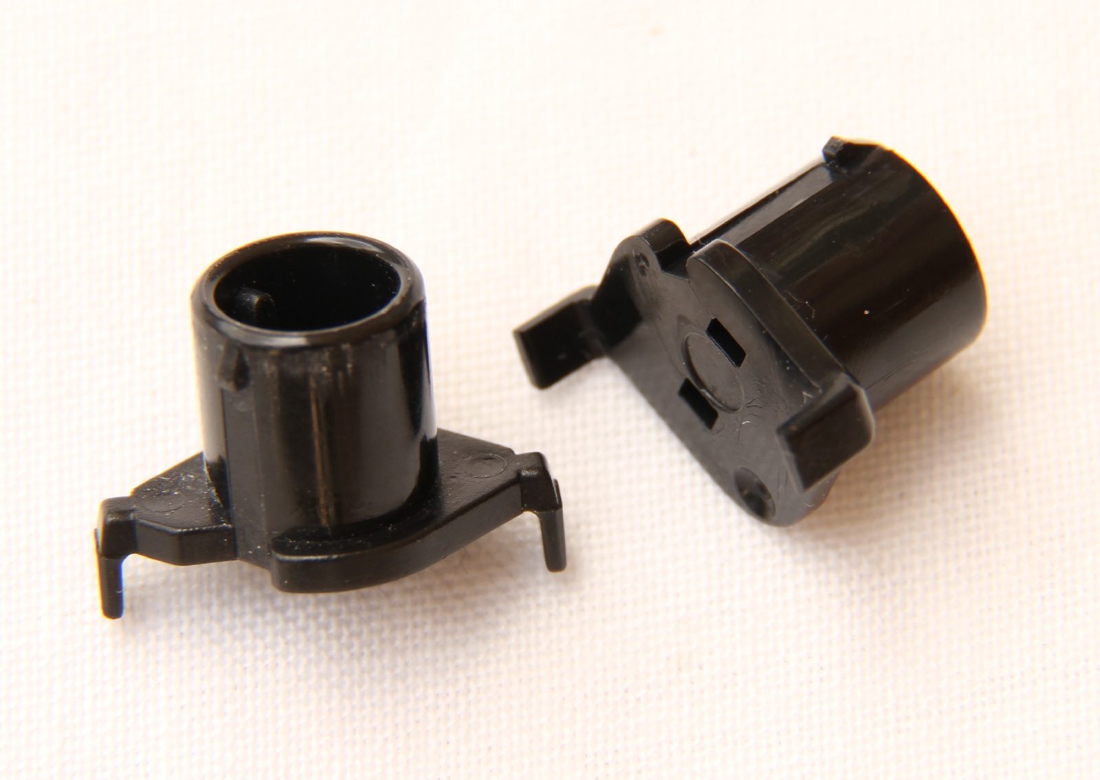

Yes, unfortunately, it appears that the rings might not work on the HiPro. Here is the pic from the DT wiki:
The design of the base on the HiPro slider looks similar to that of the slider in the Left Control switch of the RF87U keyboard, and I have found that a Silencing Ring cannot be used on that particular switch.
I haven't tested a HiPro directly, and I am unaware of anyone else testing one with Silencing Rings. If you like, I could send you a few rings for you to test. If you were willing to do this, it would be valuable information to share, regardless of how it turns out. Please send me a PM if you are interested in pursuing this.
17 Sep 2015, 16:37
The problem in the 87U's left Control key is the switch housing, rather than the altered slider. I reckon there's still a good chance the rings will work fine on a HiPro. But it definitely remains a guess until someone tries!

I've got a HiPro and am curious to know the answer to this.
I'm also curious to see how much they help. The trouble with the HiPro is that the underside of the key caps hit the slider housing before the switch bottoms out. The bottom out hard! Ow! Most Topre are naturally damped at the bottom of the stroke on account of the "cup rubber" but not the HiPro! It needs soft landing pads as much as anything.

Could you show us on the HiPro switch diagram where the keycap is hitting the switch housing?

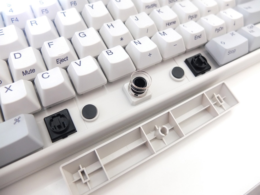

Well, I have 3 extra rings from the pack of 90 I bought for my Novatouch (or, 2 rather; I damaged one). What I don't have is time. :-(
Working at my fastest I found that installing rings in a Novatouch takes an hour. When you factor in removing dental bands and having to re-seat all springs and the rubber membrane due to a misaligned spring that bumps to 90 minutes.
On the switch diagram above, the bottoming out is the underside of the yellow "keycap" hitting the top of the brown "housing". This is a result of the "housing" being so much taller on a HiPro.
There is a small chance that these rings would help if placed at the position I just described. However IIRC the "plunger" does not protrude from the "housing" enough to keep the rings centered.

If you are willing to invest the time, you would be able to use your 2 extra rings to find out if they are going to work in the HiPro.
Regarding the bottoming-out noise in the HiPro, it looks like it might work to put a conventional rubber O-ring on the stem of the keycap. This is something you could readily test if you have some standard O-rings. I don't think the Silencing Rings would help with the bottoming-out issue.
