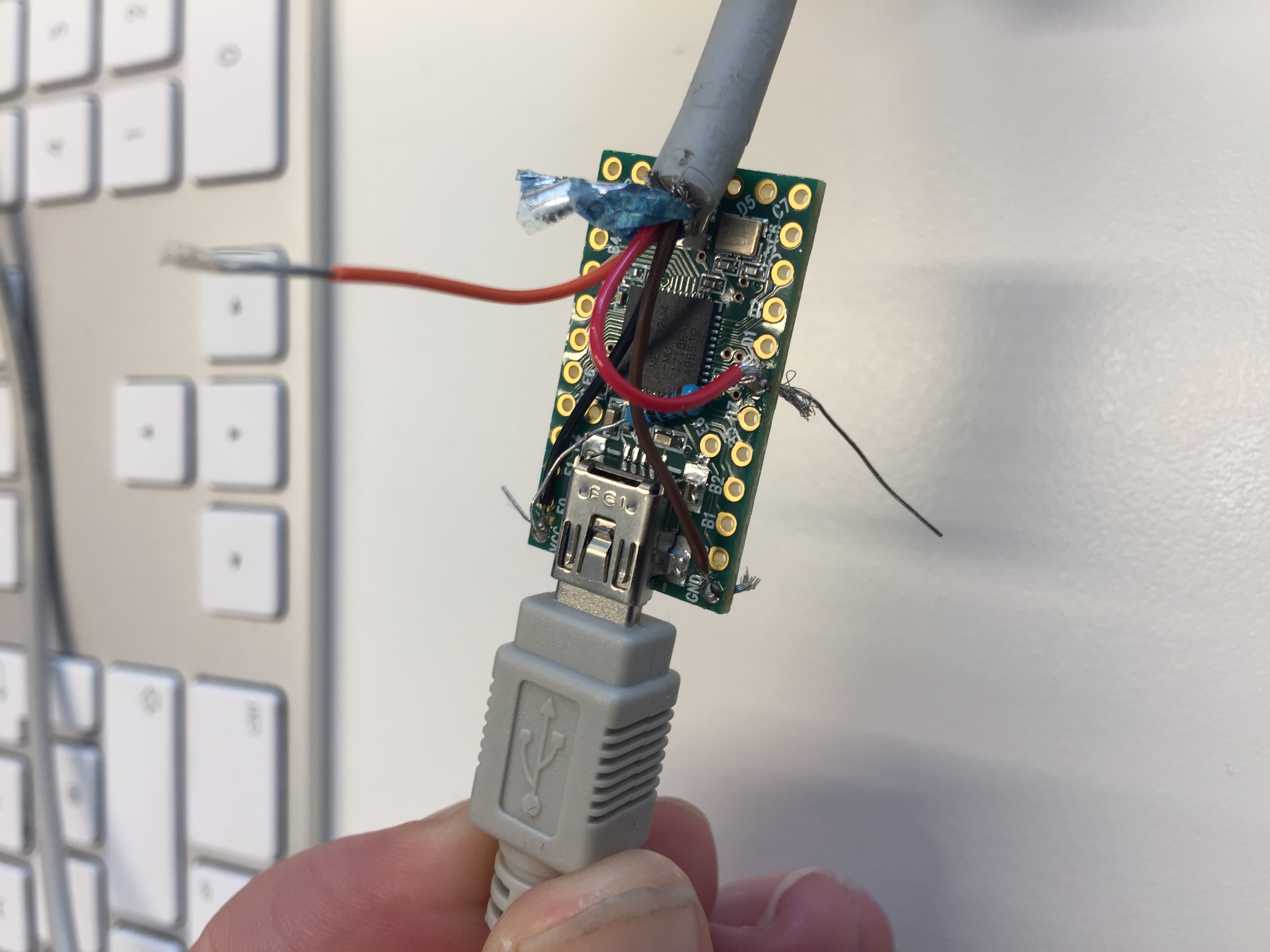

snufflecat
25 Apr 2018, 17:06
Hi Hasu, hope you don't mind me asking here in stead. I can't stand GH's forum-design and layout.
OK, so:
- I've flashed my Teensy 2.0 with the correct HEX-file (I think)
- Solder joints on the Teensy are good
- Resistor is in place where it should be
- Wires going from the cable to the Teensy are correct (I've triple-checked)
- The Teensy loader software detects the chip
Still - no action.
- One chip on my Apple Extended II got really warm after a while.
- The keyboard is family number M3501 with Norwegian/Scandinavian layout.
- I did not do any changes to the config files (I can't figure it out anyway), just compiled the hex fil with "make -f Makefile.teensy"
Please see the attached image for photo of my solder joints.
Any help or tips what so ever are greatly appreciated.
hasu
25 Apr 2018, 23:48
You problem is likey to be your wiring as many poeple had.
I can't say soldering job in the pic is good I think you are very new to these things. Your will find someone with skill to ask help in your family(dad or son?), classmates or colleagues.
snufflecat
26 Apr 2018, 09:00
hasu wrote: You problem is likey to be your wiring as many poeple had.
And here I was, thinking I did an OK job. :p Thank you! I will have someone skilled help me and see if that helps.
Edit:
I got help and now have much better connections. Now my mouse cursor jumps around at random intervals, but I was able to run the "hid_listen.mac" and keep getting the following message(s):

hasu
29 Apr 2018, 00:41
Error -30 usually indicates that your wiring is wrong unless your keyboard is in bad shape.
Check your pullup resistor value(1K-10K should be ok) and wire connections.
Are you sure that wire connections from keyboard is correct?
If your give power and ground connection properly the keyboard LEDs blink at startup.

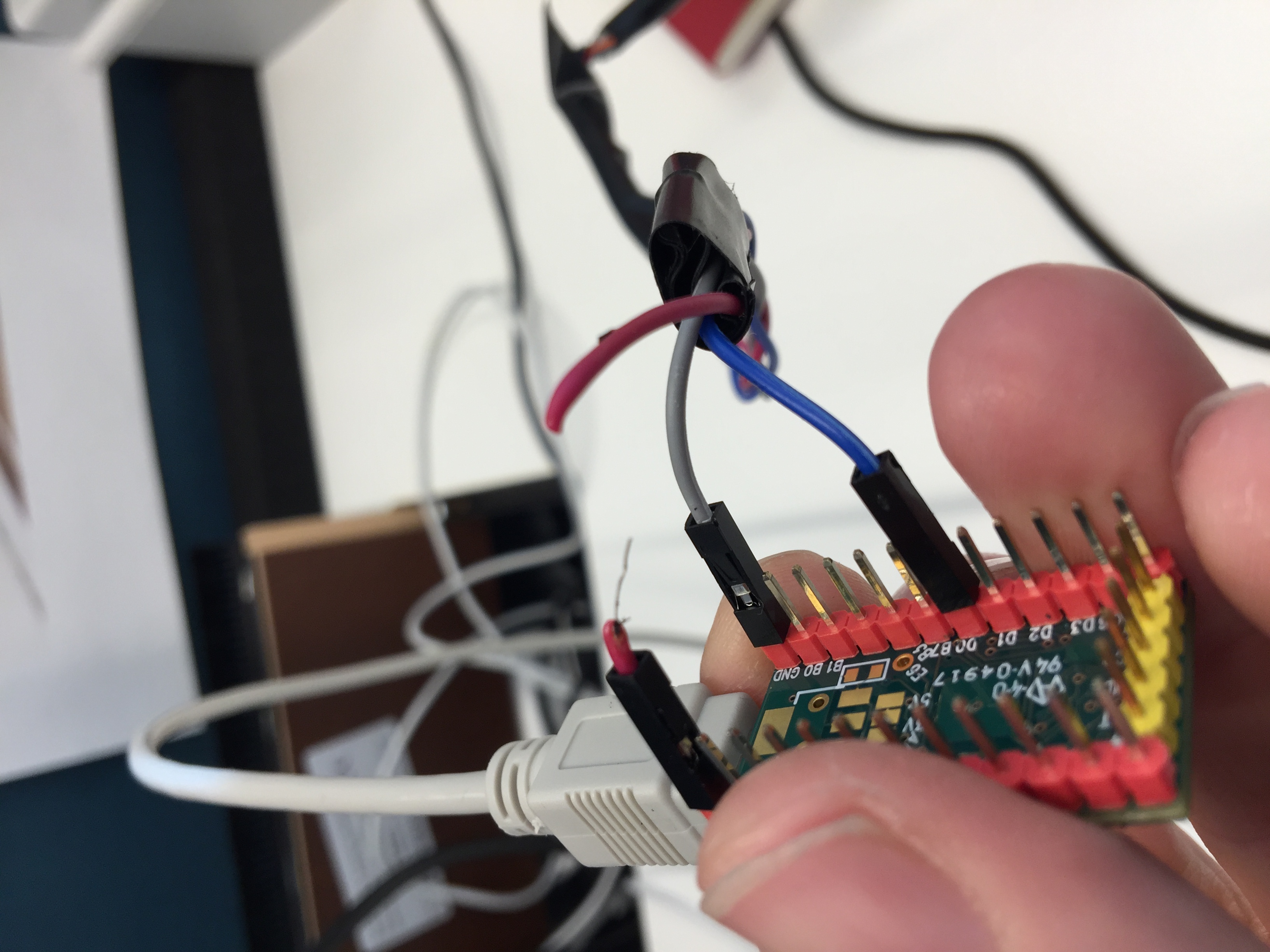

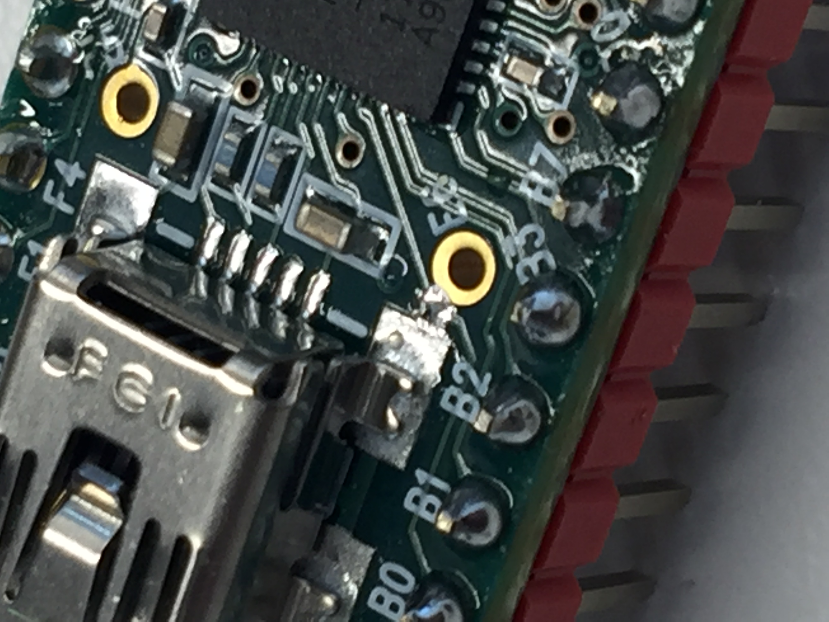

snufflecat
30 Apr 2018, 15:28
hasu wrote: Error -30 usually indicates that your wiring is wrong unless your keyboard is in bad shape.
Thank you Hasu. Here are some pictures of what I discovered this morning, and what I might suspect is the reason for my errors:
One of the wires going from the cable to the Teensy melted. I have no idea why I didn't notice this before.
A tiny drop of solder on the Teensy. This is because of my very bad skills with soldering.
:oops:

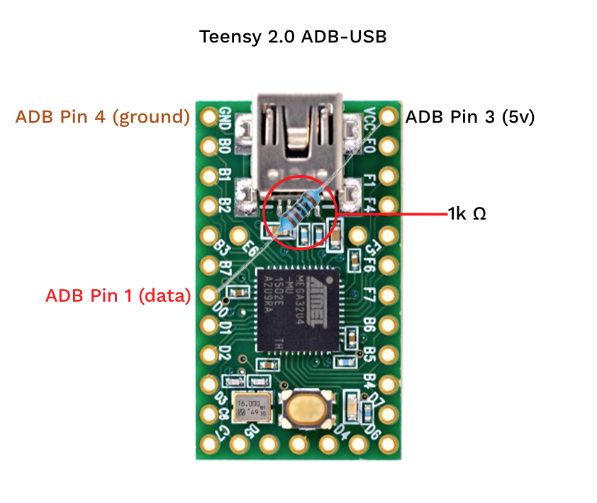

snufflecat
02 May 2018, 09:17
By the way: Here's a mockup of how I thought I was supposed to wire it up, if it's of any interest. Could it be that I messed this up as well?
Screen Shot 2018-04-25 at 15.43.08.png (416.18 KiB) Viewed 13249 times
