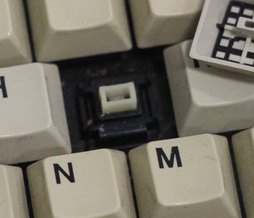

Just would like the experts at Alps switches to chime in here and answer a question.
Have two images;
Are both equal Alps switches or is one inferior to the other in build or finish?

Well...the first one actually isn't Alps at all:
wiki/SMK_Alps_mount

Also note that this particular white SMK switch is clicky. It is not the tactile variant found in ADB keyboards.

Polecat wrote: Well...the first one actually isn't Alps at all:
wiki/SMK_Alps_mount
Oh right.....it's a sub standard Monterey switch.
Is it well below par to the standard complicated White Alps switch?

Don't write off the SMK switch so quickly. It's one of the better clicky switches out there. And I wouldn't consider it an Alps clone really. It is rather unique. You might even like it better than white Alps.

The switch was definitely inspired by Alps, but have lots of character of their own.
31 Mar 2018, 12:35
Elrick wrote: Are both equal Alps switches or is one inferior to the other in build or finish?
The first one is SKBM White, made by Forward Electronics, AKA simplified Alps. It's real Alps in the sense that they started out Alps branded, but that one is from after the Alps branding was removed (instead it just says "FD" on the bottom).
They are not great switches — instead of a single tactile bump, there are (at least) two, one intentional, one unintentional, and they ping like crazy. They're too heavy, don't have a clean force curve, and especially in that chassis, sound terrible.

It's not SKBM, it's SMK as noted above. I like SMK switches but they are even more uncommon than Alps so I've never paid much attention to them.
31 Mar 2018, 16:32
Oh, sorry, the second one I meant. The one that is obviously SKBM …
