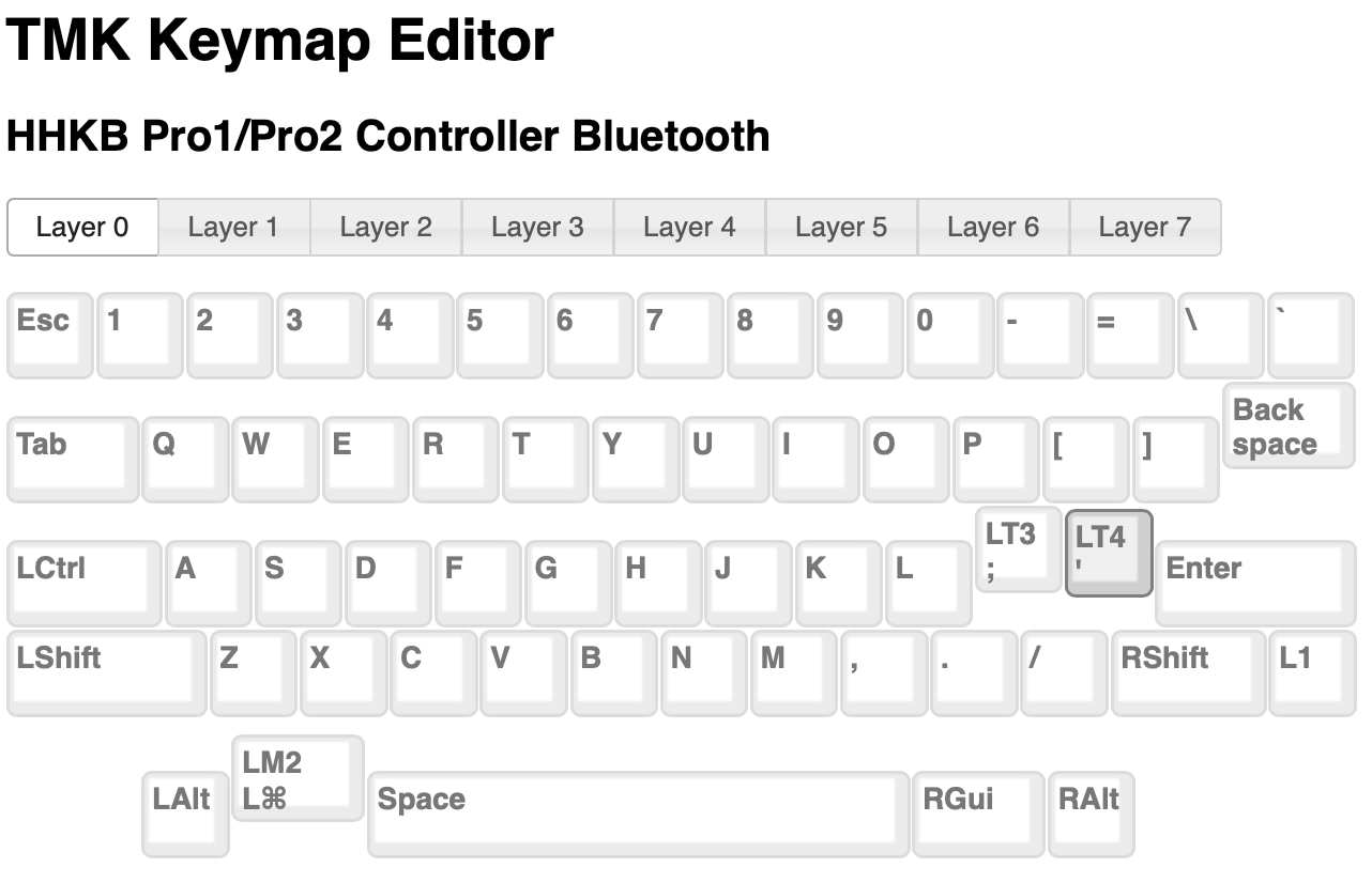

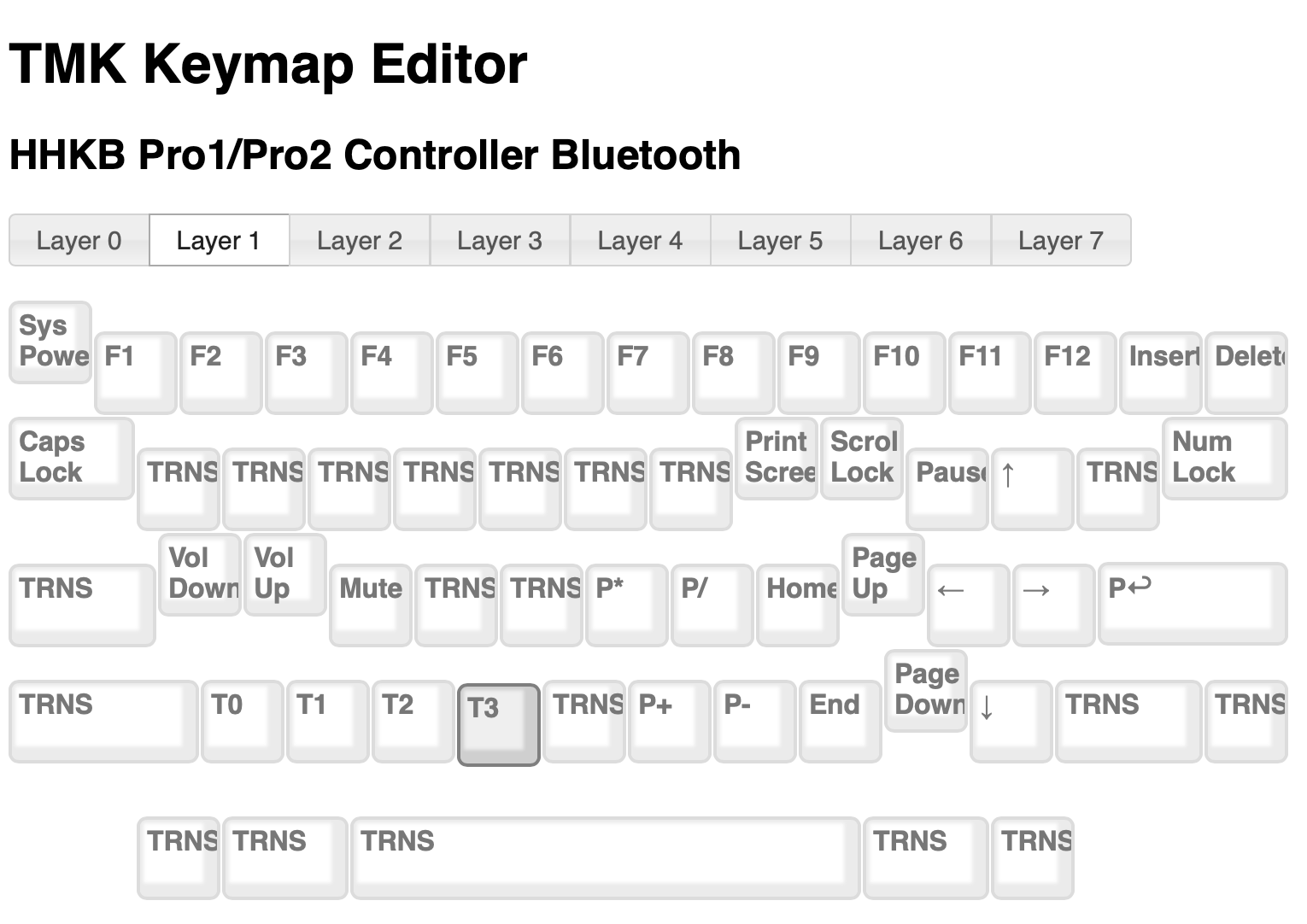

15 Jan 2019, 05:35
Hey Hasu (and anyone else with more clues than me!),
Here's my current HHKB layout in Unimap. I'm trying to add an integrated numpad mode (like my Realforce 87U) and even some mouse keys while I'm at it. The mystery is how best to access those layers. Here's what I'm trying: a whole line of layer shortcuts along the unused ZXC and V keys in Layer 1:
Screenshot 2019-01-14 at 8.29.36 pm.png (42.31 KiB) Viewed 22946 times
What I'd really like is to fall back to Layer 0 whenever I want to get out of numpad or mouse modes. But layer toggles don't work like that. They seem to be a stack where you pop things on and off. But I don't want to wind up "stuck" in numpad mode or mouse mode, or indeed a hybrid of both, which is what it feels like using this! I don't want to memorise the "route" I took to get to a given state.
I'd much rather have a sanity key that takes me back to layer 0 and the HHKB I love! Any idea how to do that?
hasu
15 Jan 2019, 06:46
Can't you disable the numpad and mouse layer with pressing L1+{C, V}?
Layer1 is disabled when you release L1(on layer 0), so Toggle keys(T*) on Layer1 is not available on Layer2(numpad) and 3(mouse) without pressing L1.
Or you want to place real toggle keys on those layers instead of 'TRNS' so that you can press just C and V without L1 to leave the layer?
15 Jan 2019, 07:06
Hi Hasu! Strange things happen…
Just now, for instance, I noticed your reply in the Forum Spy, so I toggled the mouse keys layer with Fn + V to mouse over and click the link to this thread. Which worked fine.
Then I tried to get back to Layer 0 to write this response. But I couldn't! I was stuck in mouse keys. I could only disable them with a power cycle of the keyboard. Let's try a numpad example…
So I'm in Layer 0. I press Fn + C to enter Layer 2: numpad. 123456789. I press Fn + C again to exit it. Works good. But what I really want is to tell the keyboard where I want to *go*, not to "undo where I am". So let's try that. I press Fn + C 987654321 And then Fn = wa5t a 05n45t+ No, needs to be Fn + C. Fn + Z actually puts me in a weird hybrid layer where, as you can see, the keys specified in the numpad layer act as a numpad while the others are still regular alphas; falling back to TRNS I suppose. The only way to escape this is by popping the stack with Fn + C, not Z.
Real problems begin when I've already switched layers a few times. That's when I can get completely trapped, I guess because I'm adding *more* layers to the stack by toggling them off in an incorrect sequence. It's very weird when you wind up trapped!
Edit: I get what you're saying about putting layer toggle keys inside the alternate layers. I tried that with Z always being T0 on every layer. Didn't seem to help.
What I'd really like is to change (with layers) what the Fn key does. Because to me it feels more natural holding Fn when using the mouse keys and numpad. And whenever Fn is not pressed? Layer 0, of course. Perhaps I'm looking for Fn + C <hold Fn> press keys for numpad function <release Fn> return to normal HHKB Layer 0; with subsequent presses of Fn going back to Layer 1 as usual.
hasu
15 Jan 2019, 09:13
Muirium wrote: 15 Jan 2019, 07:06 Hi Hasu! Strange things happen…
How did you leave the mouse keys layer?
I assume you used Fn+V, this doesn't work for you? This shouldn't be stuck in the layer.
Or You are using T0? No, T0 doens't work like that and it is not useful at all in most use cases. I don't think using T0 is harmful here, though.
I'm still not completely sure but probably you want to use 'ACTION_LAYER_SET(layer, on)' to enable a layer at a time. Unfortunately the action is not support in Keymap Editor at this point, you have write keymapping file and build firmware from source.
https://github.com/tmk/tmk_core/blob/ma ... -set-layer
You may find useful actions in this document for your needs, otherwise, you will have to write you own function for the key.
https://github.com/tmk/tmk_core/blob/ma ... /keymap.md
15 Jan 2019, 09:33
Thanks for the pointers, Hasu. I may get good and nerdy and redefine the Fn key for real, someday…
For now, I'm using this keymap which is working better. I changed Z in the other layers to ACTION_LAYER_CLEAR in Unimap's Code tab. That actually shows up as ACTION_LAYER_BIT_AND but works as I thought: the layer toggles are dropped and you're back in Layer 0. I don't seem to be getting "lost" now, phew!
Incidentally, I'm doing all this firmware flashing with QMK Toolbox. Works great. A much friendlier GUI experience for me.
16 Jan 2019, 02:22
All right! Here's today's fresh attempt, this time using tap layers:
Screenshot 2019-01-15 at 5.17.03 pm.png (29.3 KiB) Viewed 22878 times
LT = layer tap. The key works like normal, unless held down in which case it becomes an Fn key for a whole other layer.
Works really nicely! Hasu's link to the documentation got me reading about tap keys, and the example in there using semicolon as a second function key made me try the same. Brilliant! So now ; = mouse key layer, and ' = numpad layer. Those two keys are well placed and aren't alphas I often need to type quickly in succession. So far so nifty.
