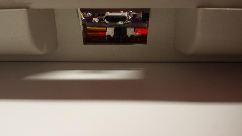

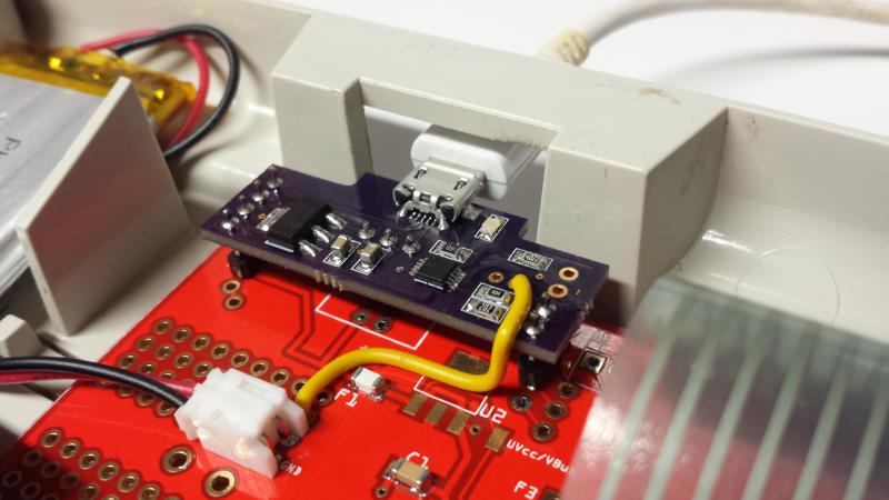

05 Jul 2015, 01:58
Sneak peek!
That jumper wire wouldn't have been necessary if I hadn't overlooked the placement of the connector being right over top the mounting post. Always at least one thing...
First one in all of it's hand soldered glory:
2015-07-04 19.52.24.jpg (54.58 KiB) Viewed 7195 times
And the port side with switch:
2015-07-04 19.53.02.jpg (26.47 KiB) Viewed 7195 times
(It'll be neat when I make the port cover because it'll have a subtle green glow when the battery is done charging.)
