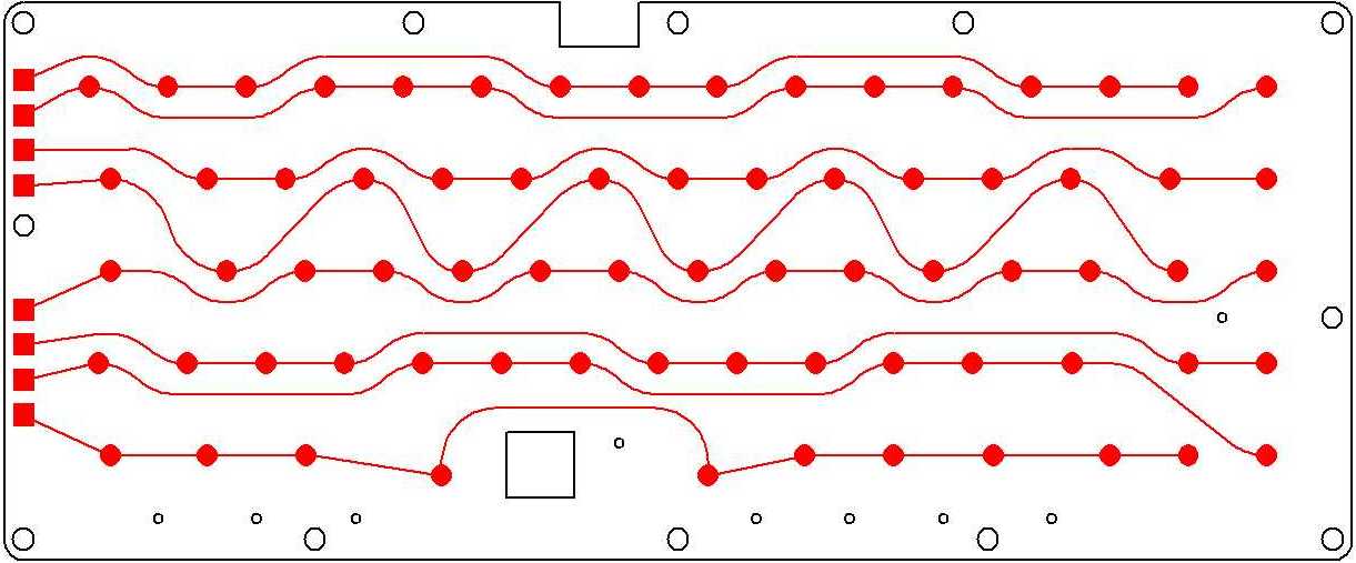

But i'm not going to let that slow me down. I'm finishing up PCB design and looking for quotes on laser cut acrylic sheet.
This is going to be using membrane type buckling spring switches. The bottom "membrane" will be a PCB (with integrated controller, microUSB connector, and 6 LEDs. The top membrane will be copper printed on thin, flexible plastic. I used this before and it worked well (for every key that i didn't screw up because my DIY PCB was so bad). I am happy with PCBWay who did the PCB for the XTant, so will likely use them again for this. The copper printed plastic is made in the UK. CIT Tech is the same as the InkJetFlex that i used last time. Quality was excellent.
The red lines are copper and the black lines are cuts. The USB connector will fit in the cutout at the top, left of center and the entire controller fits in that half square inch rectangle (under one barrel that is also used for a space bar stabilizer. Six screw holes and six LEDs are the larger circles; the smaller circles are for NKRO diode arrays. Z-conductive tape will electrically connect the 8 pads on the left to the PCB.
Top membrane.jpg (62.03 KiB) Viewed 14708 times

wcass wrote: I didn't win in the contest. :(

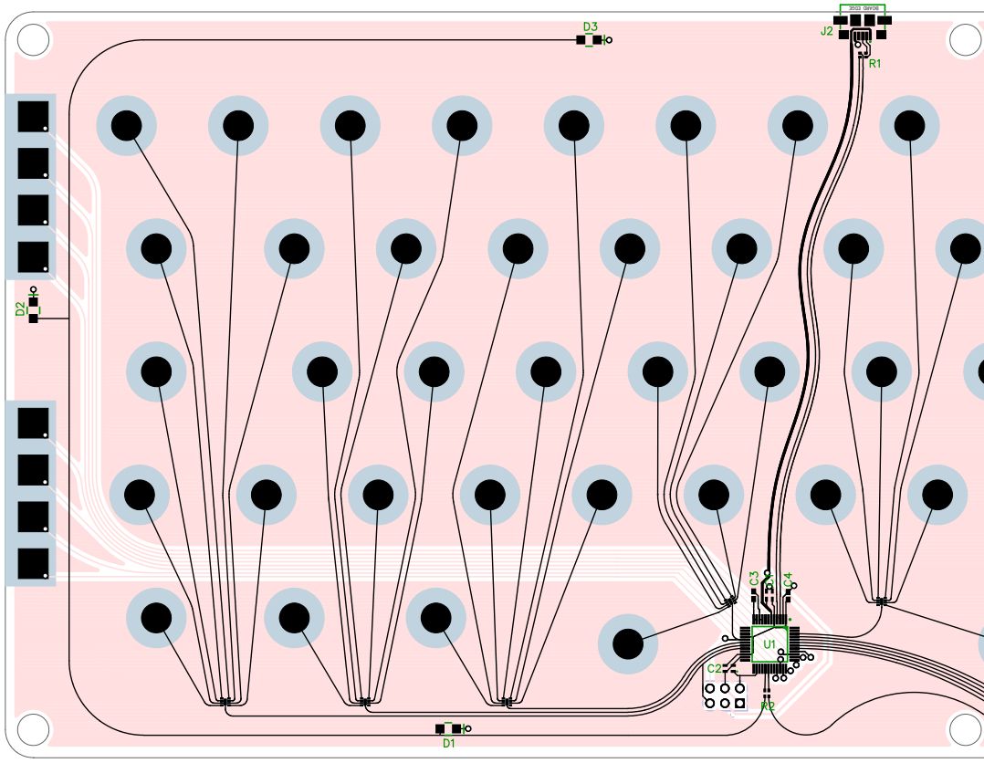

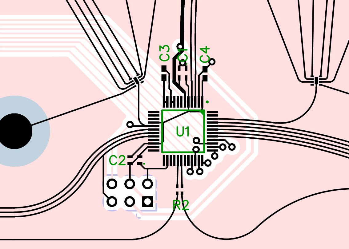

OK, i talked about the top membrane in an earlier post - now to talk about the bottom "membrane". Because it is actually a PCB, we can build our controller right on it and we can run traces on both sides. I'll start with a close-up of the controller itself - this is under the left thumb key (space, backspace, function, or whatever you want it to be).
This controller is basically just a copy of Parak's design for the Infinity keyboard and will use HaaTa's firmware. At the heart is a Freescale MK20DX128VLF5. This is a great controller chip because it is small, cheap, and requires so few support components - just 6 capacitors and two resistors. I've compressed that to just 5 support chips by using resistor and capacitor arrays.
Entering the processor at the top-center of the image - the thicker trace and two traces to its right are from the USB plug; +5 and data lines (VSS is the fill on the back). Exiting the center bottom of the processor are two traces feeding a 2x current limiting resistor array and then off to the LEDs. The 2x3 header to the left is for "serial wire debug" and reset, and will not be populated with pins. I will use spring loaded "pogo pins" when needed.
Six switch matrix columns enter the processor from the right and four columns enter from the left. Each trace is connected to a (looks like a spider) diode array; eight diodes combined into one very small chip. This prevents back-flow through the switch matrix when any key is pressed and will allow NKRO. The eight pins at the bottom-right of the processor go to the back side of the PCB, route to the far-left side of the keyboard, come back to the top of the PCB, and connect to the top membrane trough "Z-conductive" tape.

The Infinity keyboard PCB https://github.com/kiibohd/pcb
pogo pins https://www.youtube.com/watch?v=MwjQuXaowDg
Z axis tape https://www.youtube.com/watch?v=K3SPijvXtew

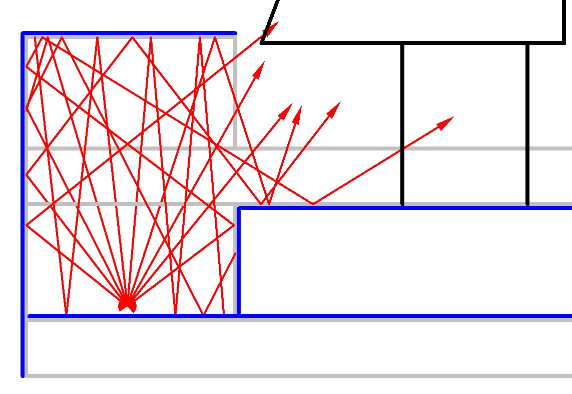

On the backlighting do you mean the clear acrylic on the board is lit so the board itself lights up? Or is it per key backlighting with transparent legends I assume?

Not per-key lighting. The LEDs will be in the frame of the case and my hope is that the case will funnel the light to the barrel frame (under the key caps) and the case edge around the key caps. I will be using just a few bright LEDs so it is quite possible that the light will not be evenly distributed. The only way for me to know for sure is to test. Just for this test i will be using adhesive vinyl to make temporary reflectors to try to channel the light where i want it to go. Once/if i find something that I like, i can replace the vinyl with thin acrylic for a more professional look.
To illustrate what i am going for, consider this side view of the front edge of the keyboard. Grey lines are clear acrylic, blue lines represent a thin reflective covering. A red LED on the PCB shines up in a 120 arch. The top and front edge of the case (top and left side in this view) reflect the light so that the only place light can escape is under the key caps.

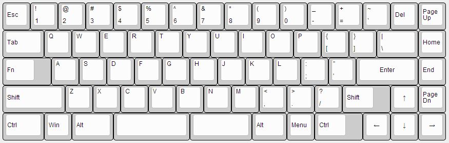

Muirium wrote: Aye. And for name suggestions: what does the (suggested) layout look like?
Mine will look like this:
Left "space bar" = backspace; Fn + right shift = Caps Lock; Fn + P = Print Screen; Fn + Del = Ins
It will use HaaTa's kiibohd controller software (same as the Infinity keyboard), so any key can have any value or function. I like the Fn in the "Caps Lock" position, but I know many of you will want to move the Fn key to one of the "space bars". It also uses IBM's common barrel spacing, so you can substitute ISO Enter and left shift if you prefer or you could substitute a 2x (backspace) key for any two adjacent 1x keys.
