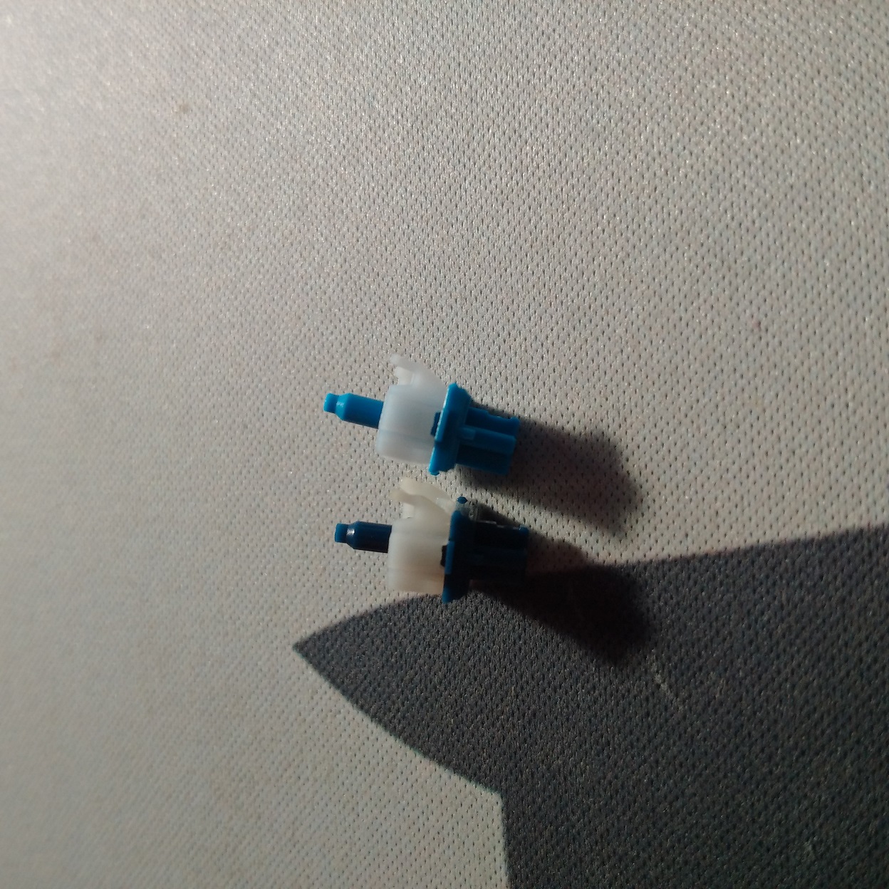

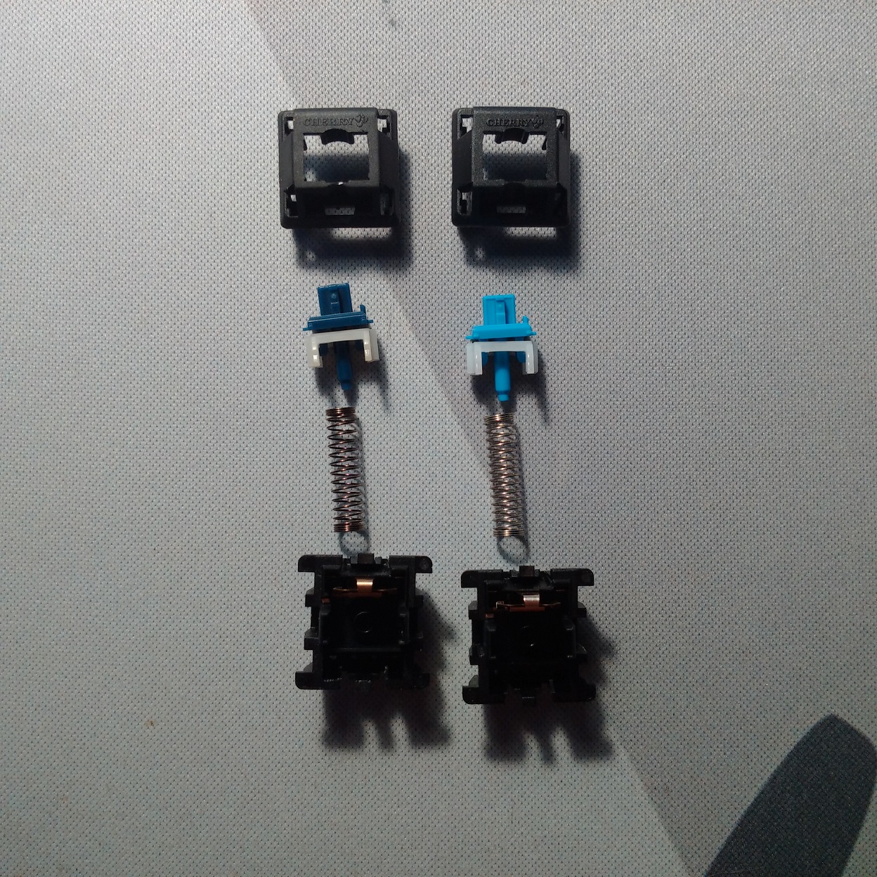

I just took apart one of my dark blue MX switches to take a look at the insides. I didn't find any similar pictures on here, so I thought I might as well take some. They aren't the best as I'm horrible with a camera and the camera of my BB Passport isn't that good either.
Darker spring (oxidized?)
Dark Blue 1.jpg (834.15 KiB) Viewed 5830 times
Darker jacket (because it's older? Some old Clears I got are pretty much the same colour)
Dark Blue 2.jpg (585.41 KiB) Viewed 5830 times
Although the switches seem to be exactly the same, they sound a liiittle bit different, the click of the usual MX blue is a tad more poignant and overall noticably less rattling. I tried recording it, but somehow the background noise is quite loud (in skype it's perfectly fine...). Anyway here's the recording. First is usual blue, second is dark blue.
http://vocaroo.com/i/s1nTIP5vpyh9
The difference is larger in real life. Overall I don't know whether it is actually a different switch than usual MX Blue or if they just messed up the colouring, but at least in comparison there are some slight differences. I don't think that the dark blue switch feels any smoother than the new MX blue.
(I got these switches from a Highscreen branded Bondwell B200)
