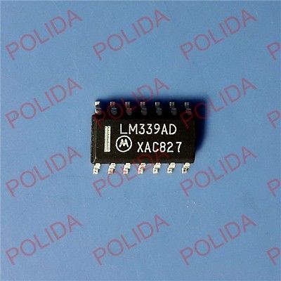

I have found this (x25 for $2)
http://www.ebay.de/itm/361426485831?_tr ... EBIDX%3AIT
Also, if done, I would try to ensure different thresholds for each key ...

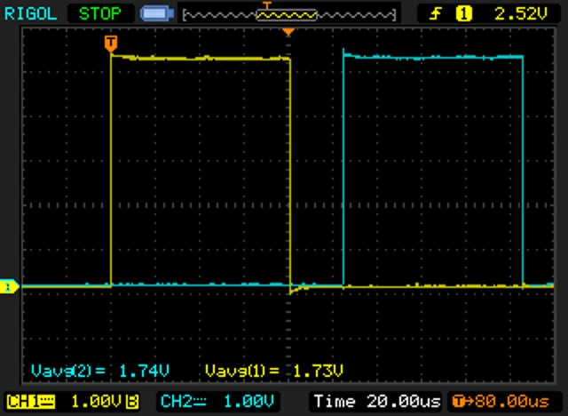

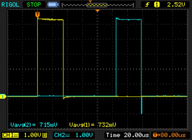

As an update I have been testing the smaller xwhatsit controllers re-designed and assembled by red/wcass/phosphorglow and there are some issues with the prototypes.
I have tested two of the prototypes on 3 different computers (2 desktops and 1 notebook) running Win 7 (one) and Win 10 (two PC's) as well as two different 10 foot USB micro cables and there is an issue: the keyboard stops working after a few minutes and it requires disconnecting and reconnecting the USB cable for it to resume working. Sometimes the threshold in xwhatsit's GUI also resets to a random number, even though I have clicked the store override in EEPROM button and closed and re-opened the utility. I have set column skips where appropriate and that helps make the crashing every few minutes instead of every minute or so.
Also the pad for the "1 !" key shows up as pressed unless the threshold is set to 192 (too high a threshold for any other key to be recognized). Switching the jumper wire for rows 7 and 8 move the affected pad's position on the matrix in xwhatsit's software but it's always the same pad.
Also I saw when testing the columns for strobing that the voltage levels were about 1.7v instead of the 0.7v of the originals and the strobing time was about twice as long (the size of the "rectangles" actually changed depending on which two columns were being tested - possibly due to smaller or more variable trace lengths? This could be due to the smaller board size and total length of the traces and may or may not be an issue affecting operation.
Test with original xwhatsit (1st screenshot) and small xwhatsit (2nd screenshot):
original xwhatsit column strobing test.jpg (62.78 KiB) Viewed 11491 times
small xwhatsit column strobing test.jpg (64.57 KiB) Viewed 11491 times
