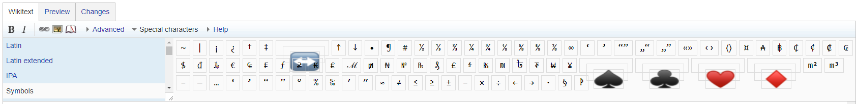

You guys got this issue in the editor when going 'Special characters' > 'Symbols'?
No idea if it's new or not.

@002
Works fine here with both Firefox and Chromium on Linux. Some pages return non printable chars (Cambodian for example) but I'm presuming this is due to the lack of a suitable typeface installed.

Weird -- I only seem to have the problem in Chrome. I just checked IE and it looks alright there.
28 Jan 2018, 11:40
Firefox 56 in Windows 10 1709 shows OK for me. No colour symbols though.
28 Jan 2018, 12:29
The html is fine, my chrome too. You have some kind of font problem in your Chrome.
