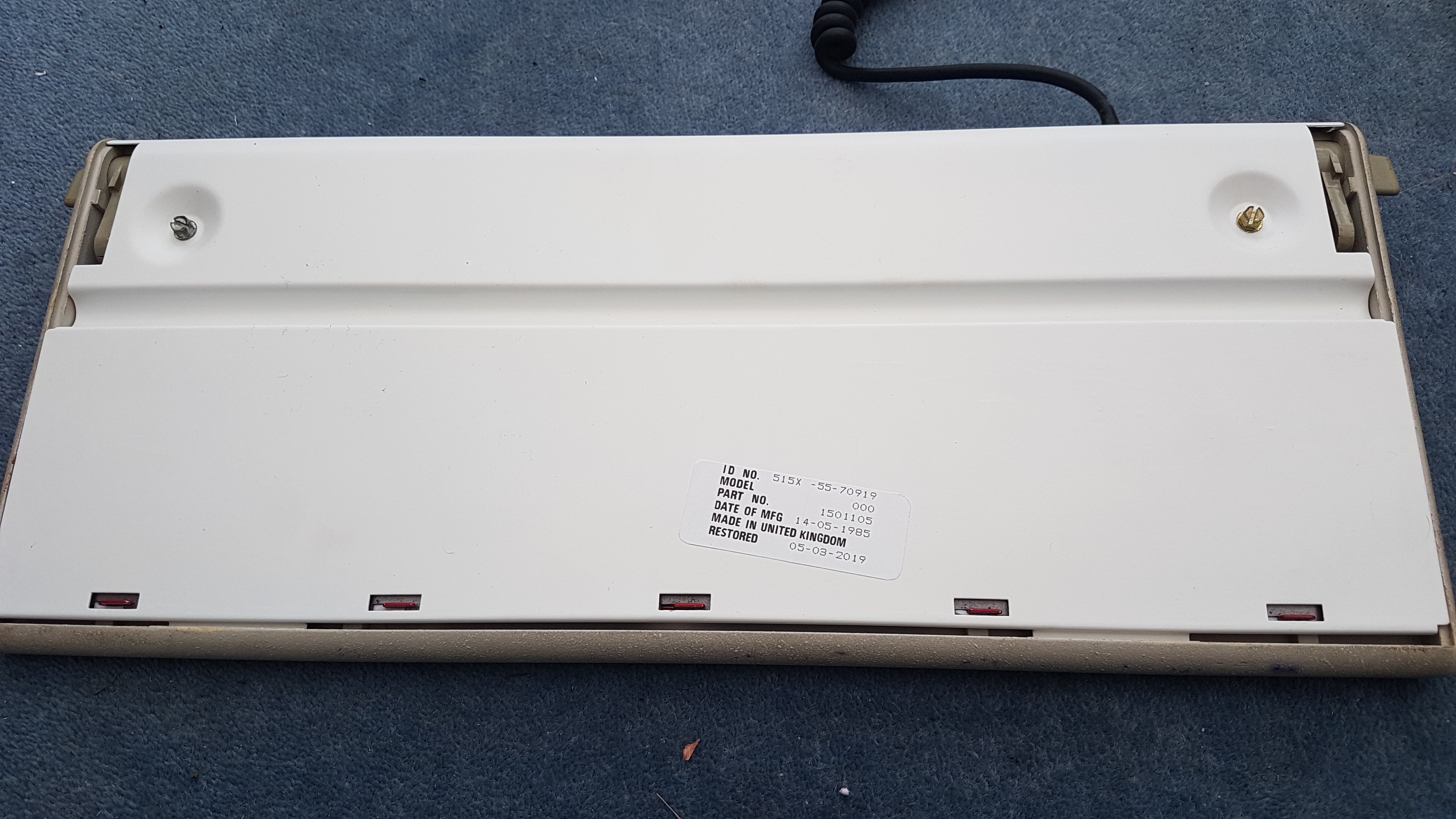

Bottom plate is currently waiting for it's last coat of paint but it's raining (expected in the UK) so I can't get that finished just yet.

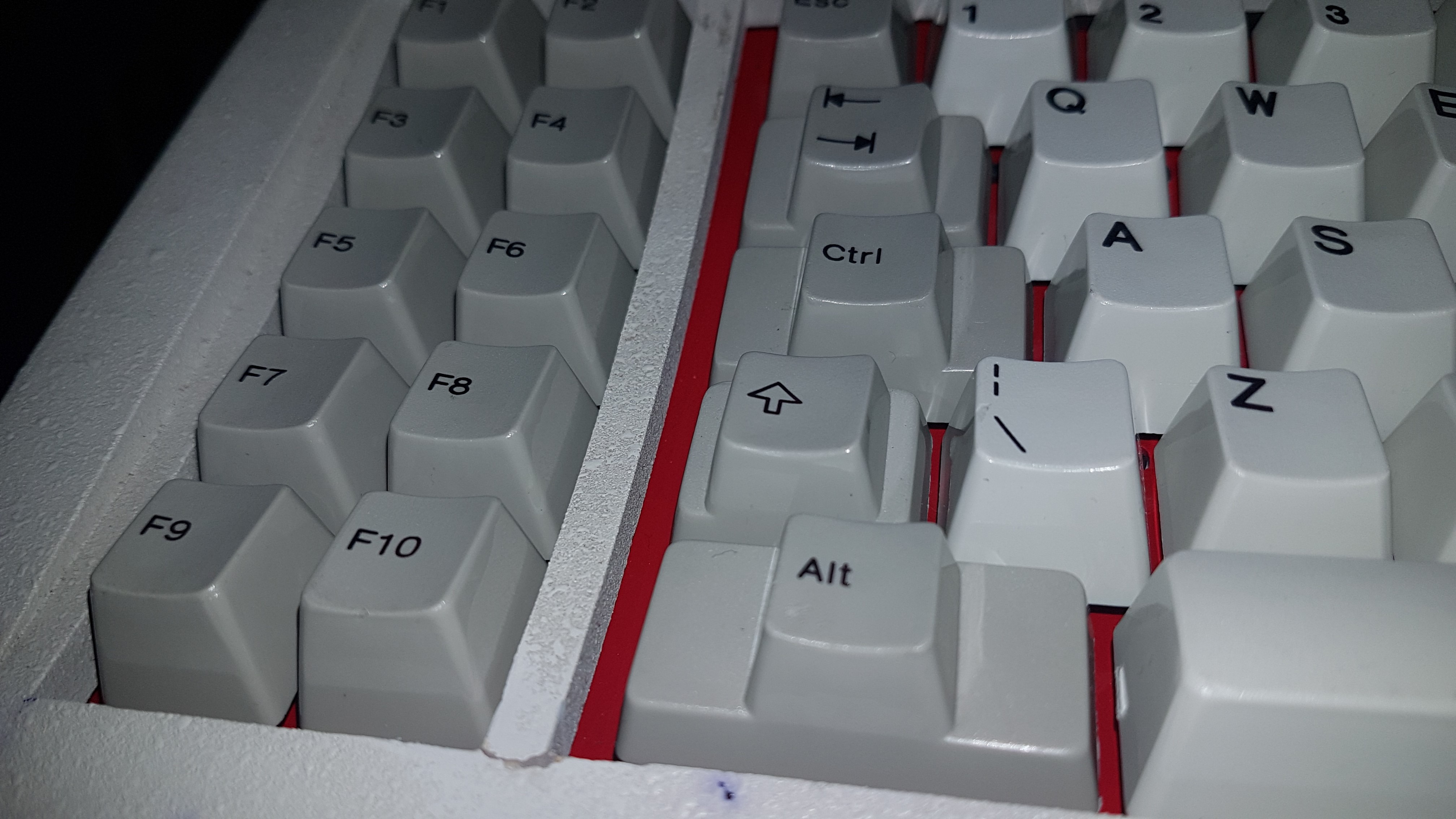

Update 2 - Got it back together. Bar clamp method didn't work one bit, most likely because the foam was too thick. This time, the keycaps went on first try for the most part. Everything works however the keys sometimes the keys activate random ones but that's probably down to the fact that it's a 30+ year keyboard thats been submerged in water.
Some pictures (will post more tomorrow)
Close up showing fixed plastic and red plate.

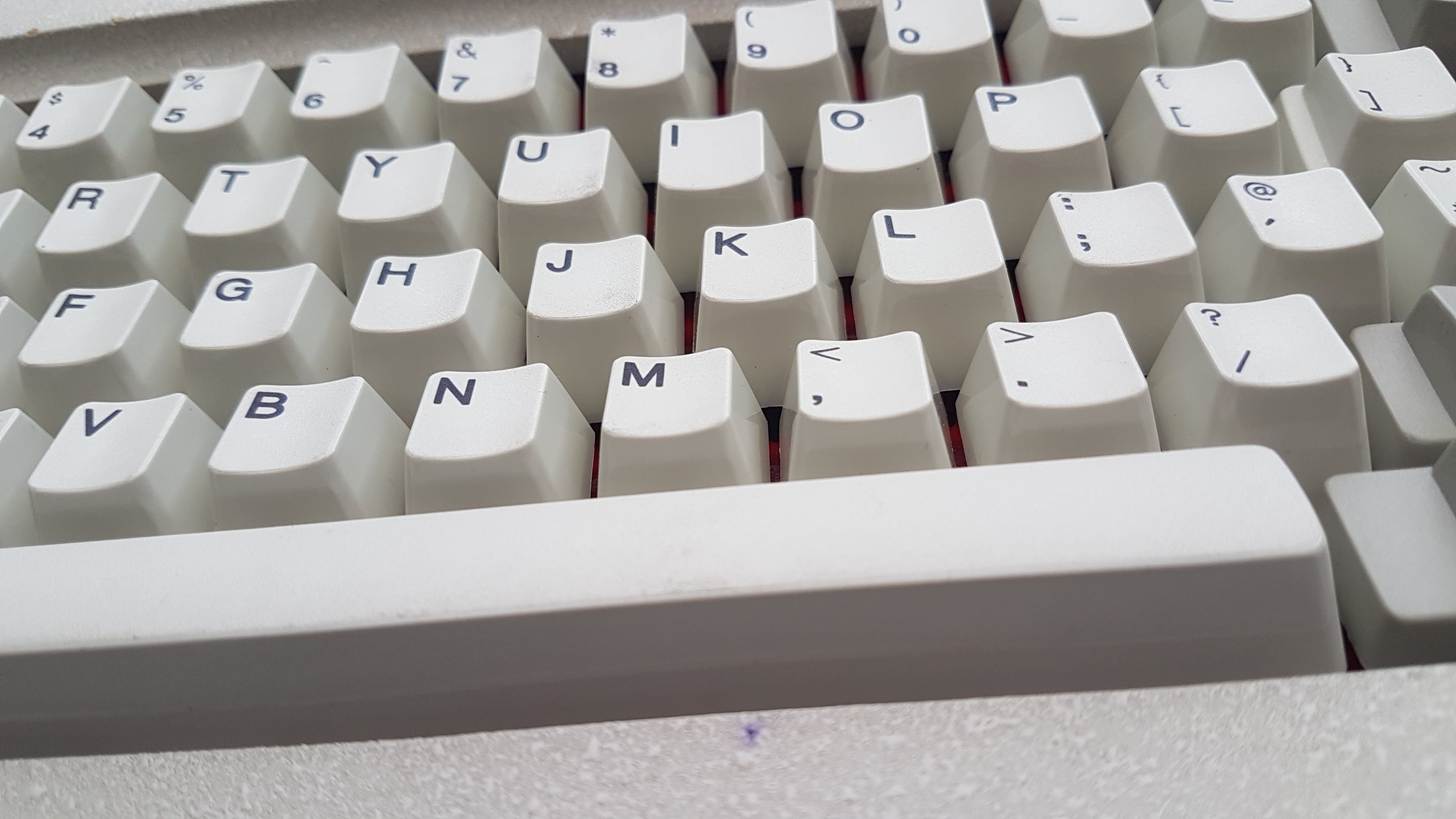

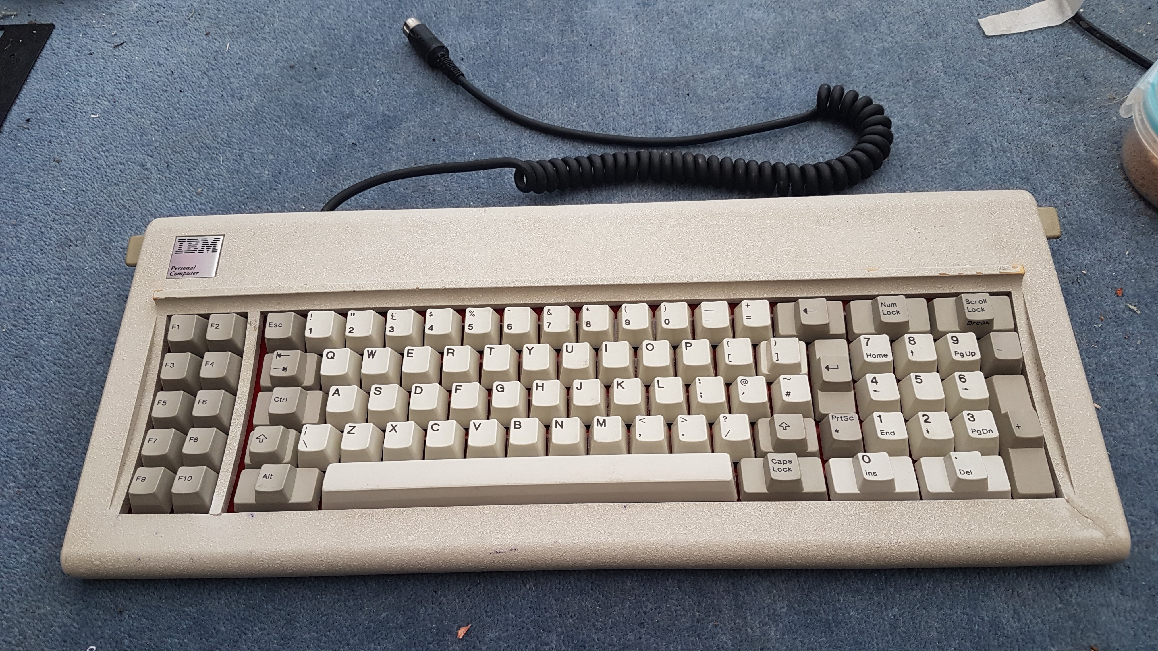

Here are some more pics of the completed keyboard -
alpha close.jpg (1.13 MiB) Viewed 3046 times
All I need now are some adhesive pads to call this complete!

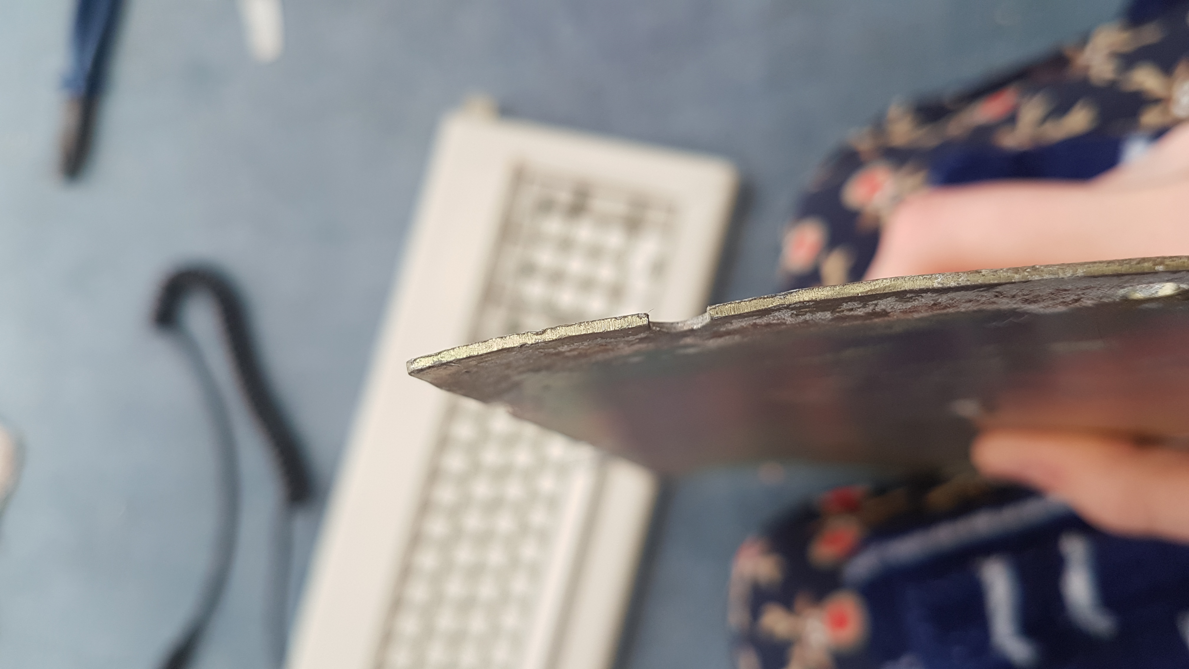

Regarding the 2nd keyboard, I've fixed the bottom plate by hitting it with a hammer a few times over a block of soft wood. This has worked really well but still bulges a tiny bit.

Sorry about the late reply, I've been fairly busy! I think it turned out pretty good however the foam really annoyed me - it took a lot of time to get right and I even ordered a thicker sheet as the first attempt was probably too thin. I think I should have used neoprene instead however there isn't much information about what size to use and it isn't cheap. As for the sound, I will try to do a recording hopefully be next week (I'm getting a nice ribbon mic that needs a lot of work so I want to use that rather than my current one). The keyfeel is different to what I remember - I'm not sure if better or worse. On one hand, it feels smoother because it doesn't have dirt in it but on the other, it feels somewhat unresponsive. The keys only register when at about 95%+ travel which for all I know could be normal but I have a feeling it isn't. I ideally want to get the other keyboard finished but the farthest I've gotten with that is sanding the barrel plate and hammering the corner of the bottom plate flat.

25 Mar 2019, 22:31
