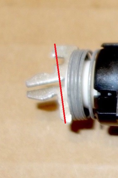

I just noticed the angle on your stems is flat. The stems on mine are angled. Neat.
*mine are like from this Orihalcon photo

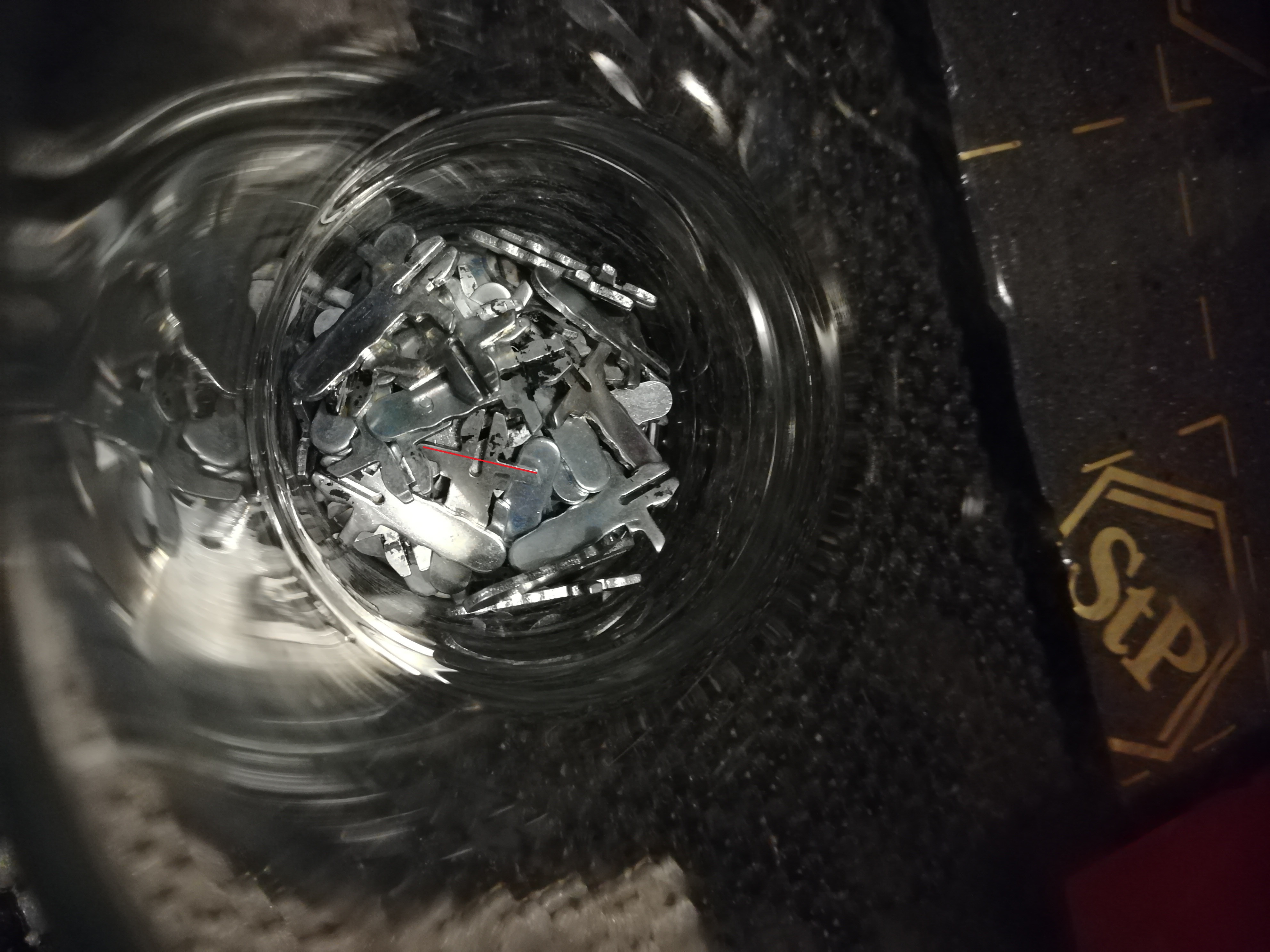

So i had all the modules cleaned. Springs were evaporusted(left small layer to prevent further rusting),o-rings, and housings were ultrasonic washed and sliders were done with cotton stick,fly plates were left untouched.
Housings in their bath:
Modules back together:
I actually ended up assembling everything back together before adjusting stems but noticed that keypresses felt loose.I proceeded to press down the stems properly and got really great results.

Sneaky: Thats actually quite nice catch,in didnt even think of that before you pointed it out,i wonder where this difference comes from tho?
SneakyRobb
THINK
28 Nov 2019, 16:52
Hi,
I am not sure why the stems are not as angled as other beamsprings. Perhaps due to the typing arrangement with the embedded desk keyboard they felt it not necessary to angle them. Other beamsprings are on-top of desks and much higher so it would make sense to angle the keys a bit. I am just speculating though.

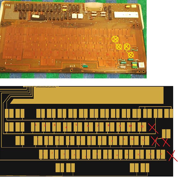

As well you mentioned the PCB you are using has most but not all of the pads your original pcb has so you are missing 3 keys.
I have modified red's pcb so that the keys you are missing are present.
Because I imported a gerber into diptrace there could be slight formatting issues so, I will send the files to _red_ to look at/ask for his advice as well.
We will get those last 3 keys working!!
What i noticed about your 3 not working keys, they are missing pads. As well your enter key is overlapping, which is why you can still use it. Cool.
fix pads.JPG (110.25 KiB) Viewed 4565 times
