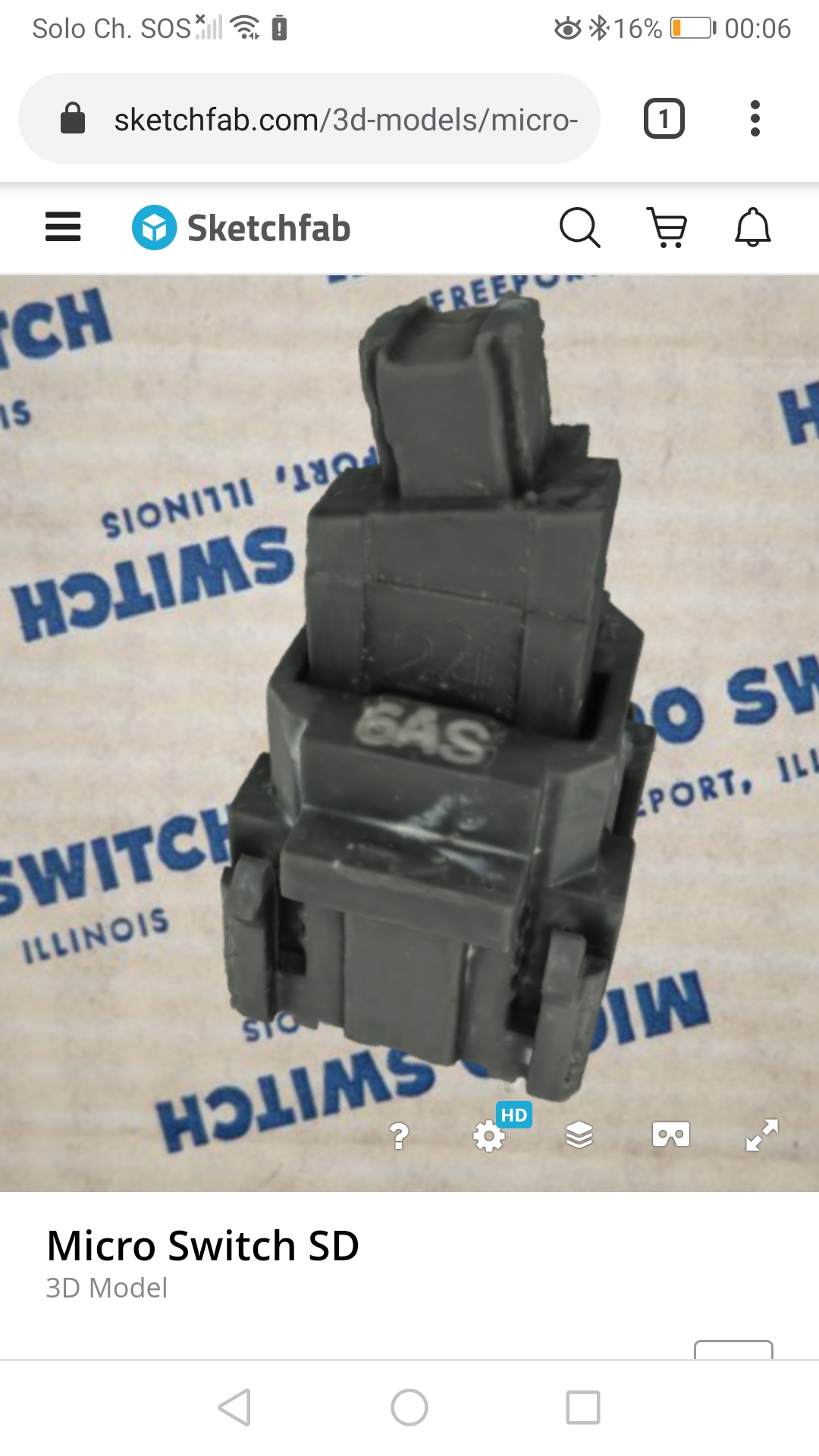

The small object I referred to above was a Micro Switch SD keyswitch. Compared to the XMIT keycap (which is roughly the same size), this one didn't present nearly as many problems scanning. That being said, I was primed with the knowledge I've gained with all the failed attempts to scan a keycap, so going into this I did things in very specific ways.
https://skfb.ly/6PFIV
A few things off the top of my head that I did thoughtfully:
  • Pushed the exposure pretty high -- otherwise no features (e.g. scratches) show up in the black plastic
  • Left the camera focus the exact same for all 322 photos
  • Reshot a set of photos that didn't align well
  • Set a custom white balance and used it for all sets
  • Shot from the same angle (~45°) with the switch positioned in 5 different ways, masked out background to recreate whole object
The main reason why this was so much easier to scan than the keycaps is it has so many more features in any given view. There are changes in colors, textures, depths -- whereas the keycap was smooth and uniform across most of its surface. I might give that one last try with a lot of light and slightly over expose it to bring out the little micro scratches on the surface. Maybe trick the software into understanding what we're feeding it.
Oh and the "MICRO SWITCH" background is a photo I took as well. I have a few Micro Switch boxes from keypads I bought a while ago. They have this really cool printing on them. Whenever I send someone something small, I like to use these nifty boxes.

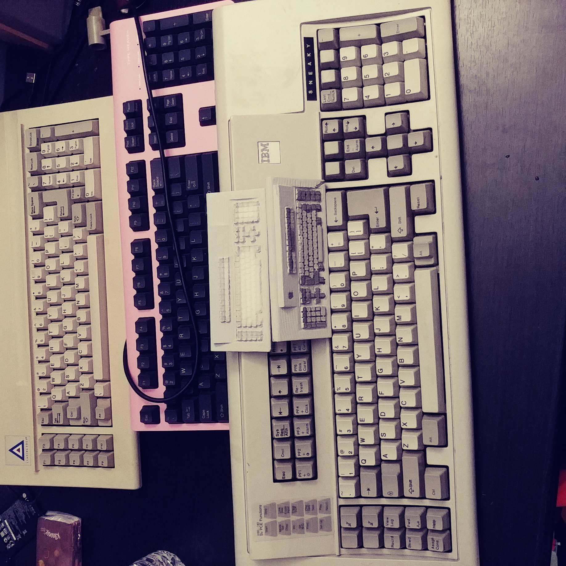

As well I had the thought, not for sale or anything. But one could 3d print some of your keyboard models and paint them for minatures. I think that could be a cool sort of trinket to make.
Imagine a little scale F122 on your F122. It could be a cool desktop little model.

And the F122 miniature would be awesome! The little crack in the corner would be adorable rather than tragic.

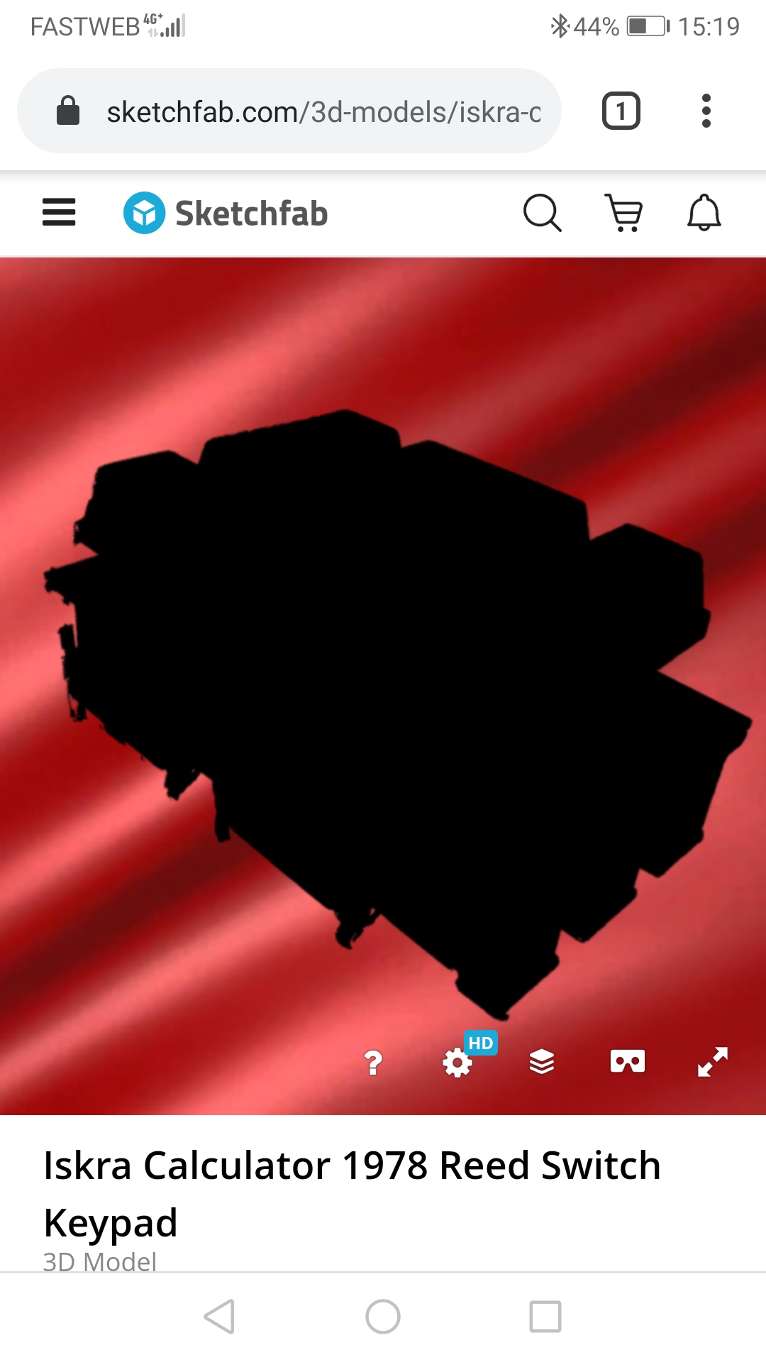

Ooof, that really is a shame that it doesn't come up properly on (at least some) mobile devices. I wonder if it's something I'm doing wrong in the sketchfab settings when I upload the model. In any case, thanks for letting me know!
I didn't imagine there could be some wrong settings misplaced during the upload step, but giving a look to this other model, that strangely works flawlessly, some doubts are arising...
Interesting, thanks for the test.
