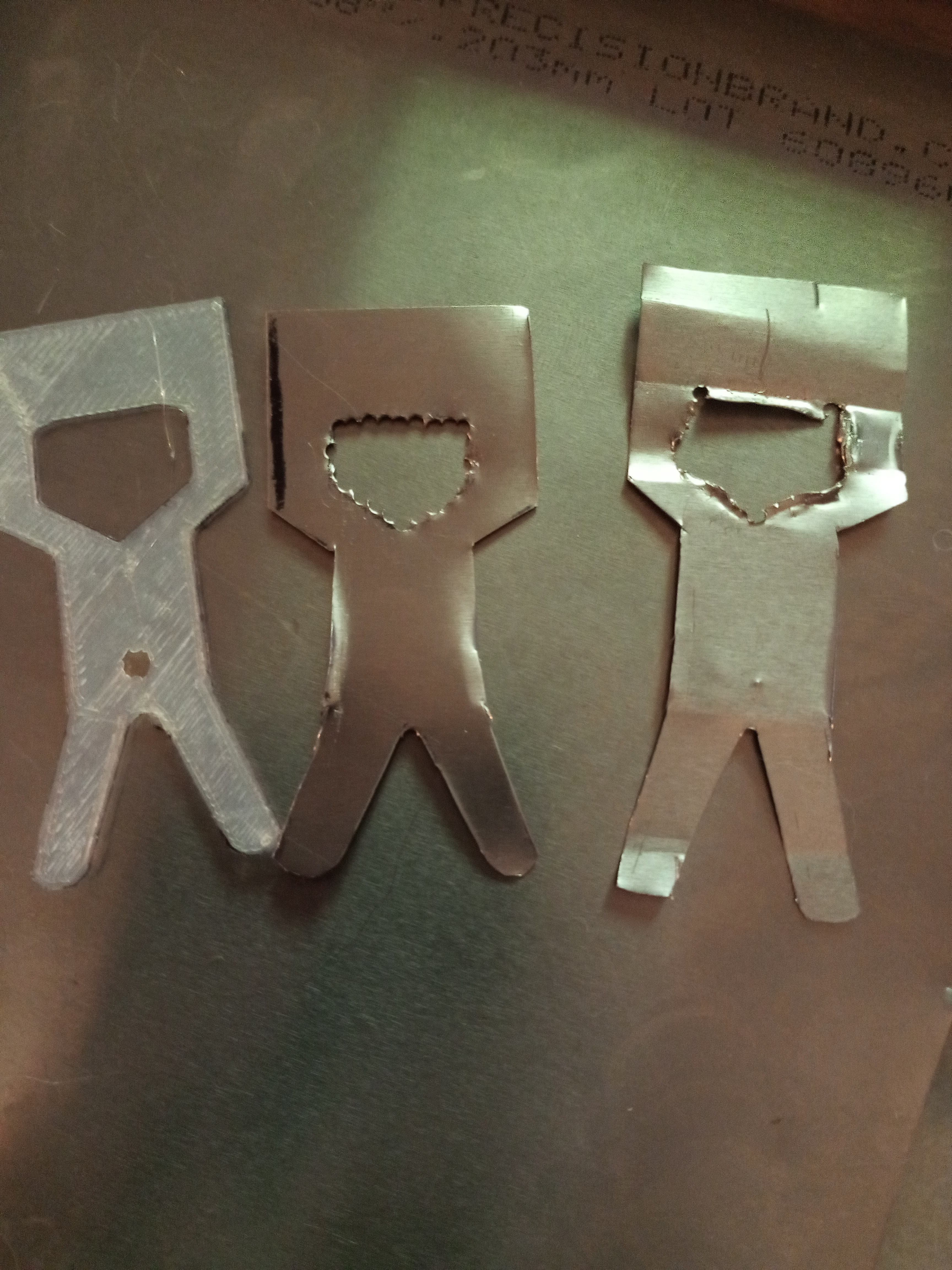

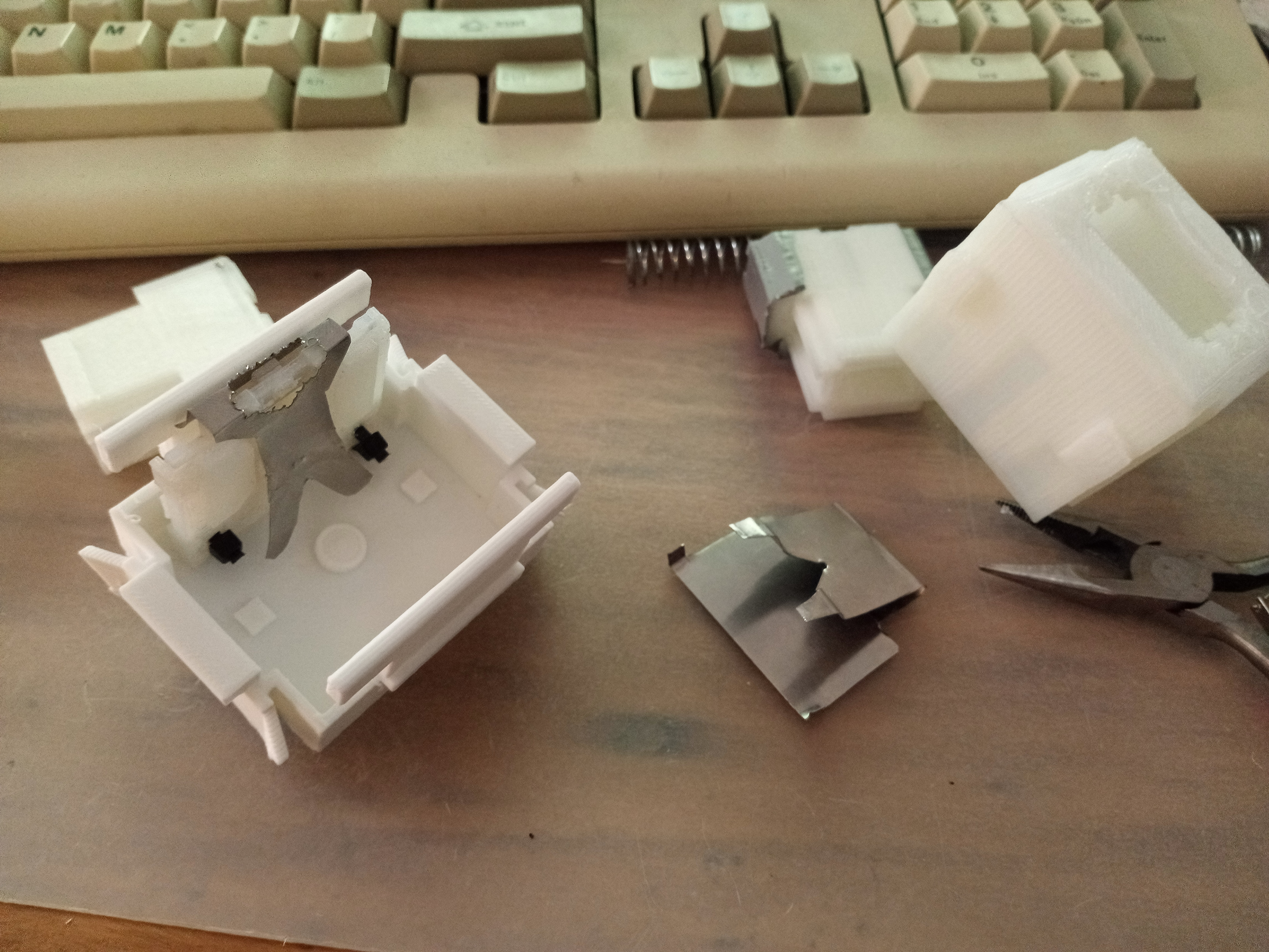

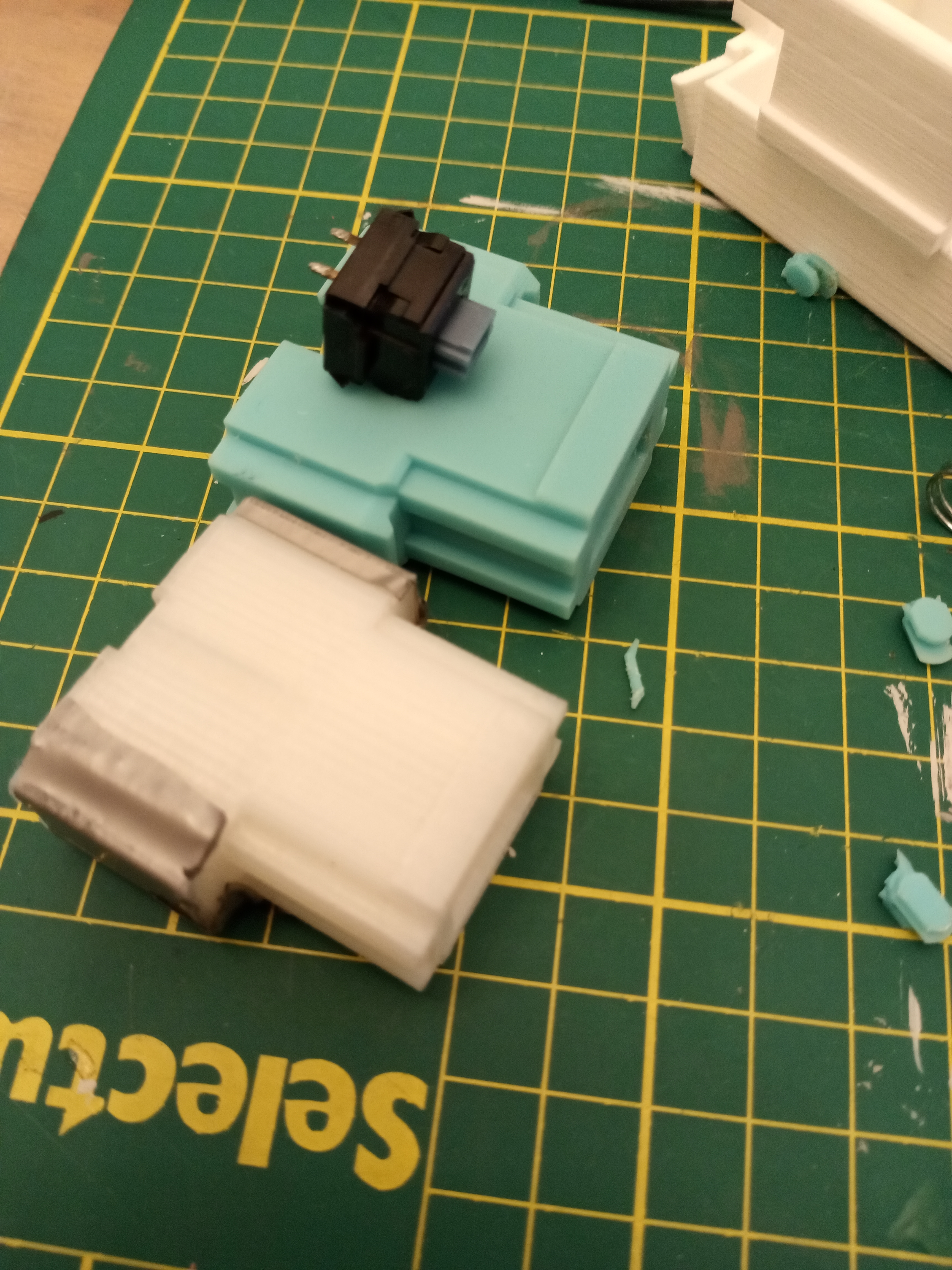

Hi,

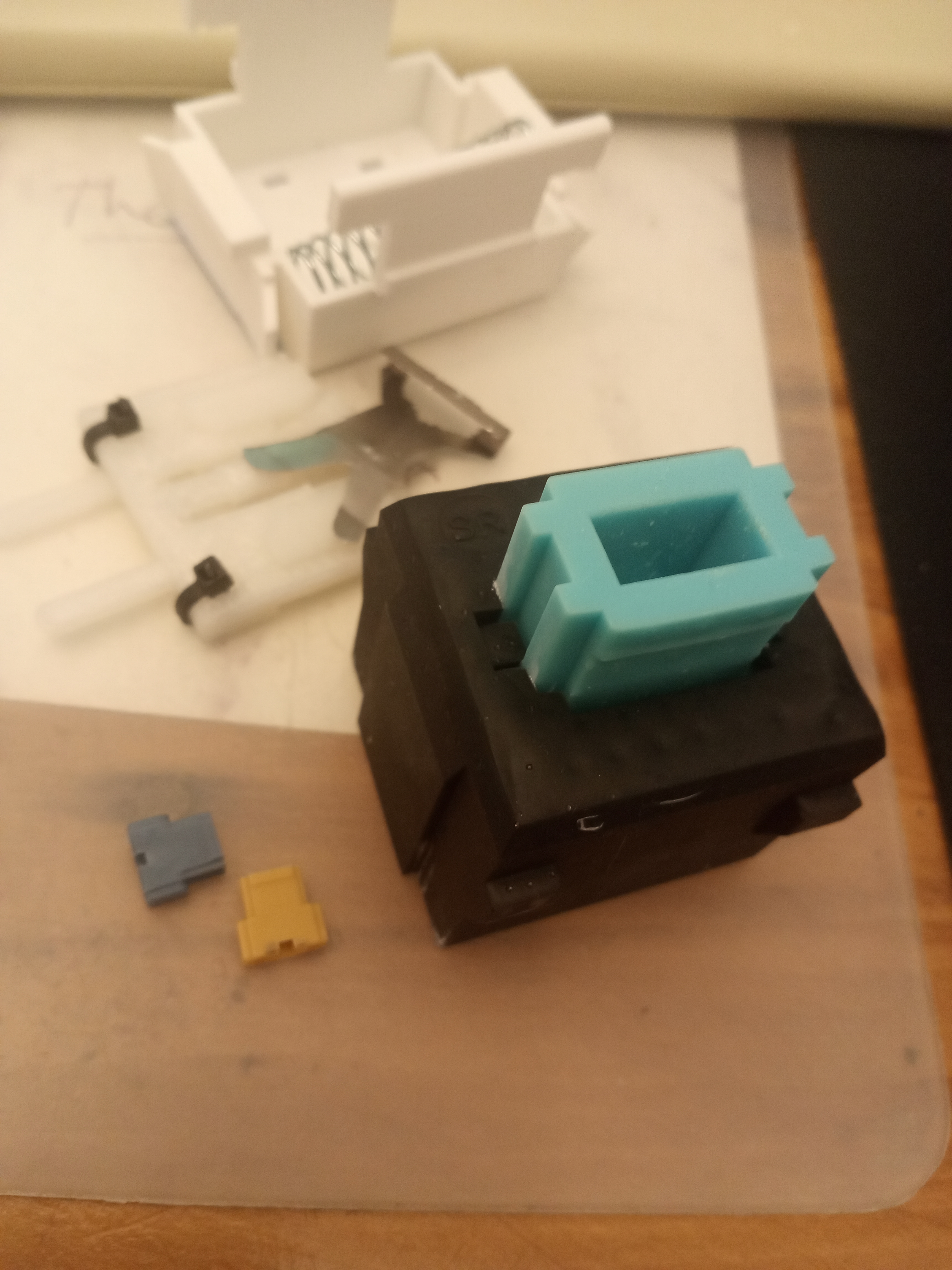

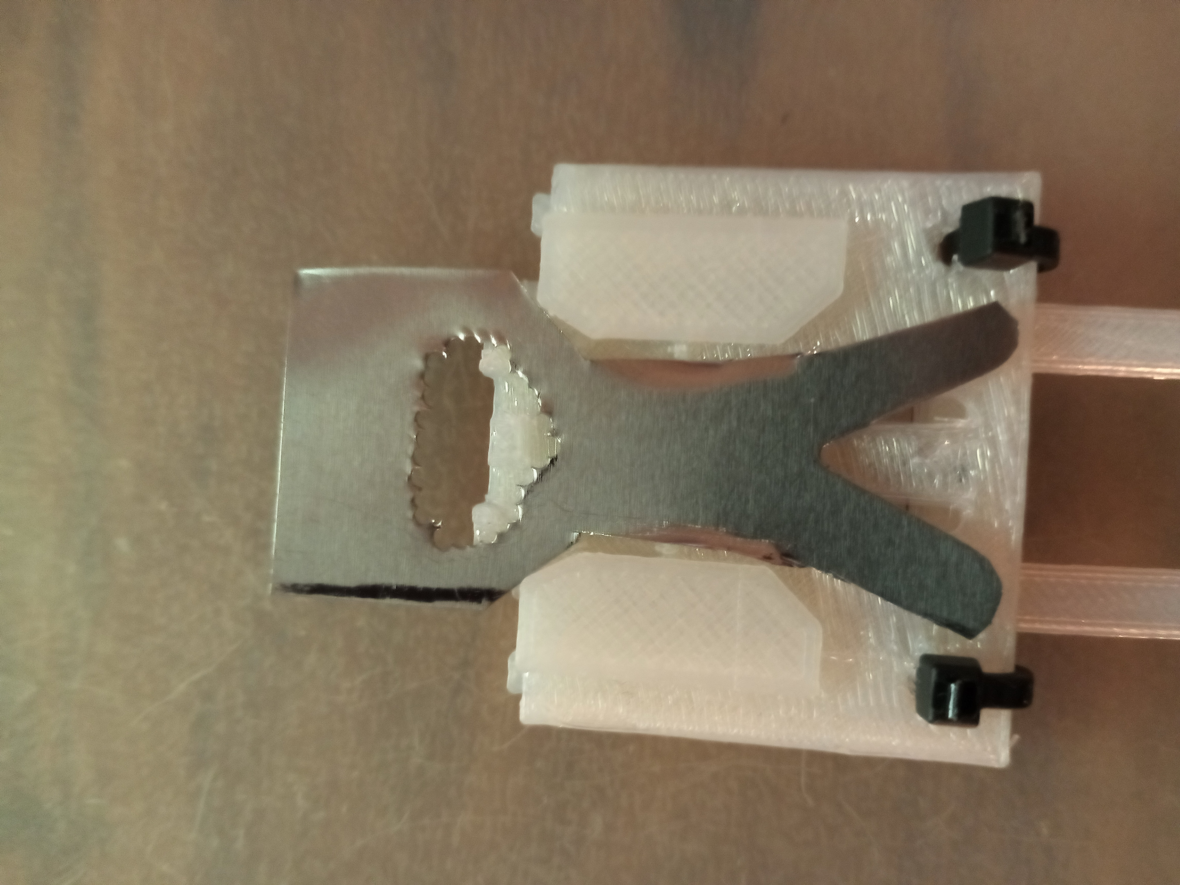

So my spring came and it seems to work with the top housing on the desk. Slight problem is that the lower housing part nub is a bit too big. So I will need to make a new one with a smaller nub. Regardless It's coming along!
Comparison of the template for the leaf spring/switch plate metal part. I will get the square punch to make the inside cutout nicer. Fit of the old leafspring piece on the switch plate. Bit too big. Better fit of the new one.
All the switch pieces with the 1st and 2nd gen style click leafs. Top of the switch with the spring inside
and the sad doh moment of seeing that I forgot to make a bottom part with a smaller nub to sized for the new spring

Would you consider it's easier to work with a bigger switch than a real-sized one? Loooks good for prototyping.
- SneakyRobb
- THINK
- Location: Canada
- Main keyboard: KB-5161A, F122, Dc2014, Typeheaven, Beamspring FXT
- Main mouse: MX518 Legendary
- DT Pro Member: 0242
Hi it's definitely easier to make a bigger switch than a smaller one. Much easier to hand cut metal etc. Its good for prototyping but there is one consideration.PlacaFromHell wrote: 02 Jun 2020, 01:16 Would you consider it's easier to work with a bigger switch than a real-sized one? Loooks good for prototyping.
There is a minor thing to keep in mind. The variances are scaled up with the switch. I can adjust the sizes of various parts by quite a bit of ranges.
I have huge leeway with things like the return spring. But I've found for the alps click leaf that even the slightest of changes bend wise make the click disappear.
So if you are making a big click leaf. It's great. But if you are scaling down your big click leaf design suddenly your slight error makes it not click. It can be harder to adjust those smaller pieces.
The main thing is that scaling the switch down might not necessarily be as easy as reducing every measurement by 4x.
Some materials like thin metals might not scale correctly requiring changes. For instance in my alps switch the switch plate metals are 1.3mm thick. Which is 4x scaled up.
Imagine if the skcm blue alps never existed and I was prototyping a new click switch in this thread. I might not think 1.3mm metal was required. That 1.3mm metal is me scaling up the switch plate .3mm to .4mm metal of the small one to the big size. If I was independently making a new switch I might use .6mm thick metal. Why not? For my big switch that is sufficient. Scaling that .6mm down though would make it be too thin for a small scale switch.
For very complicated switches this could be a slight issue.
It's not the biggest problem though, just a consideration to keep in mind.

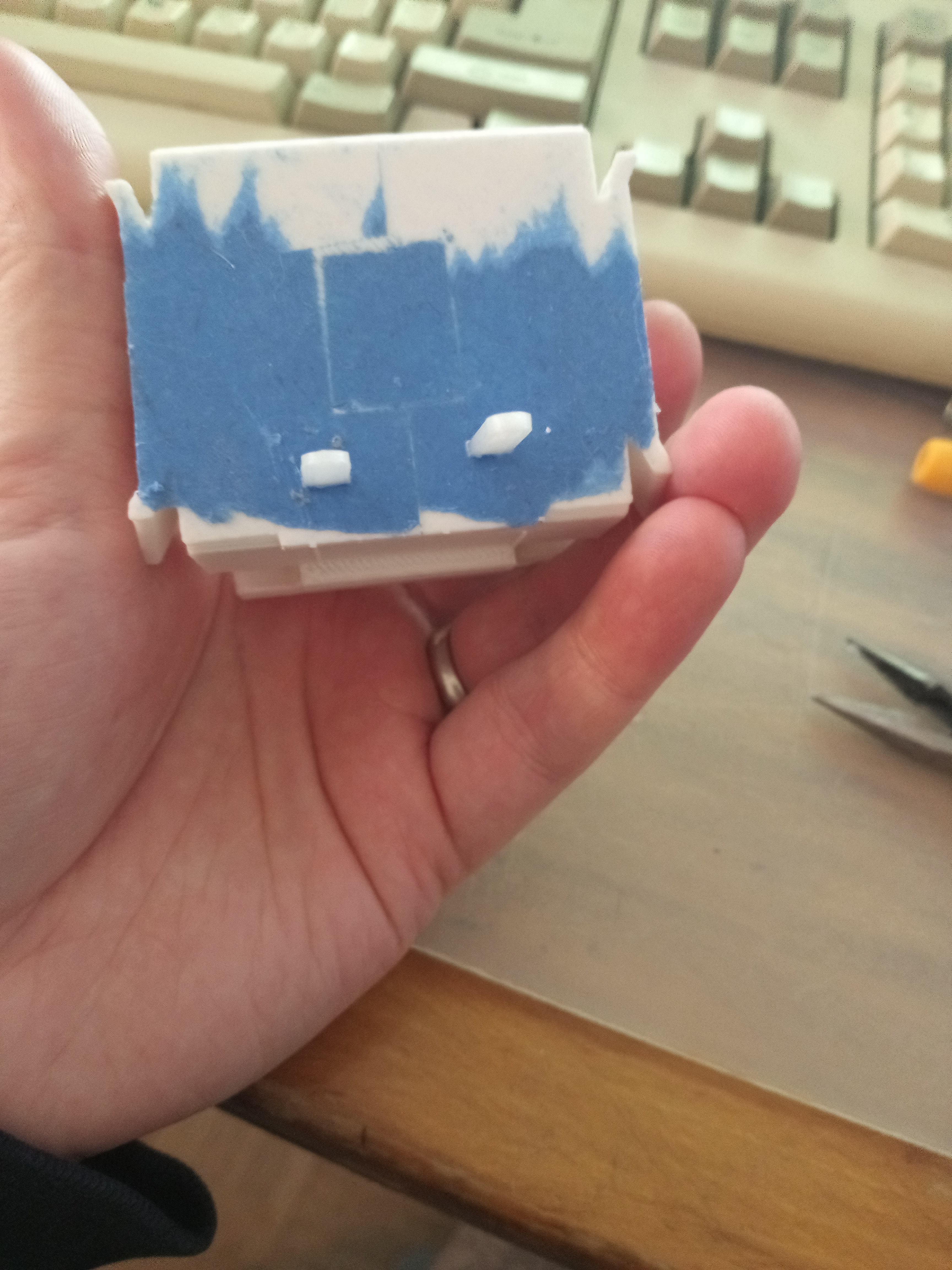

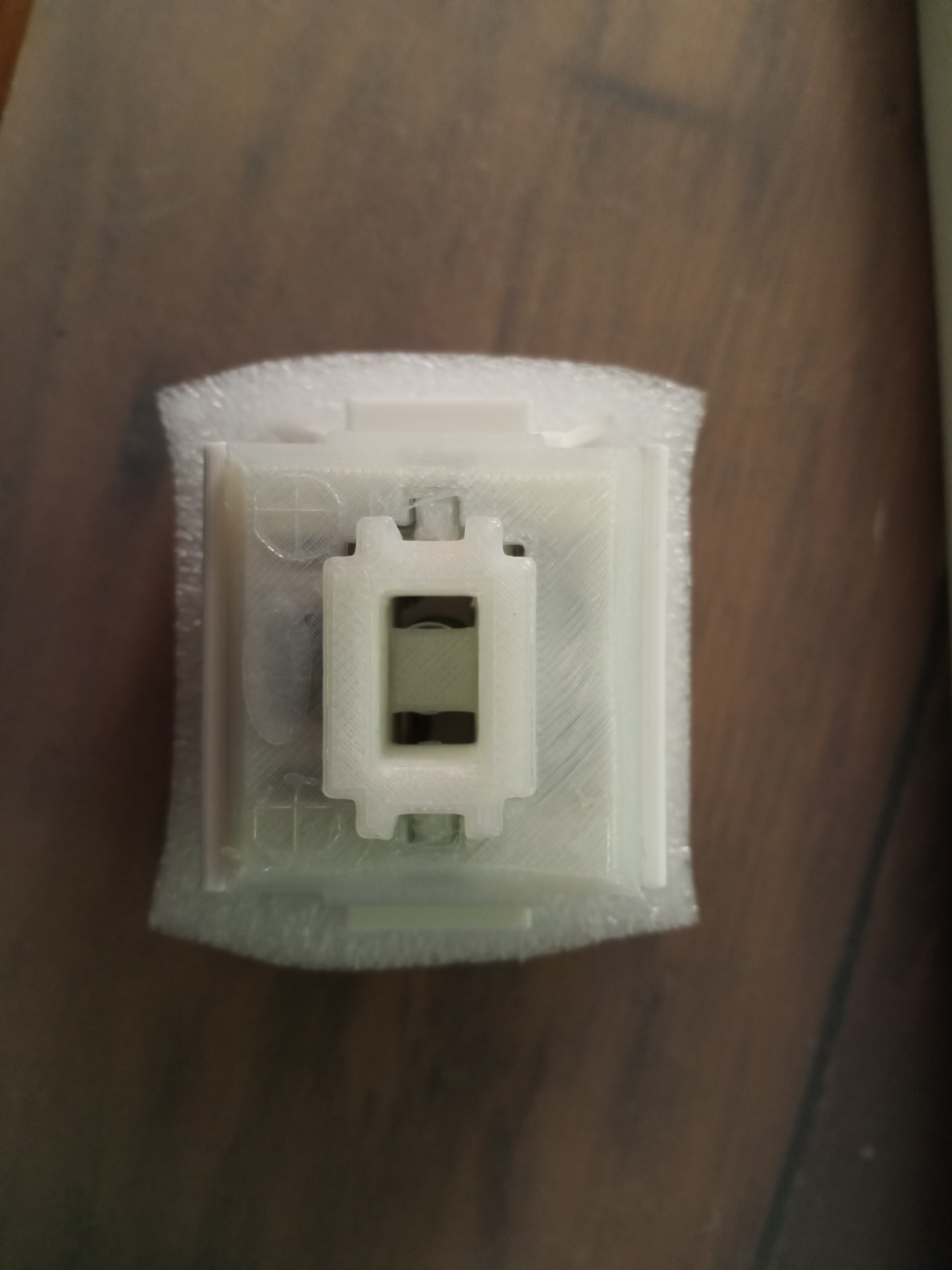

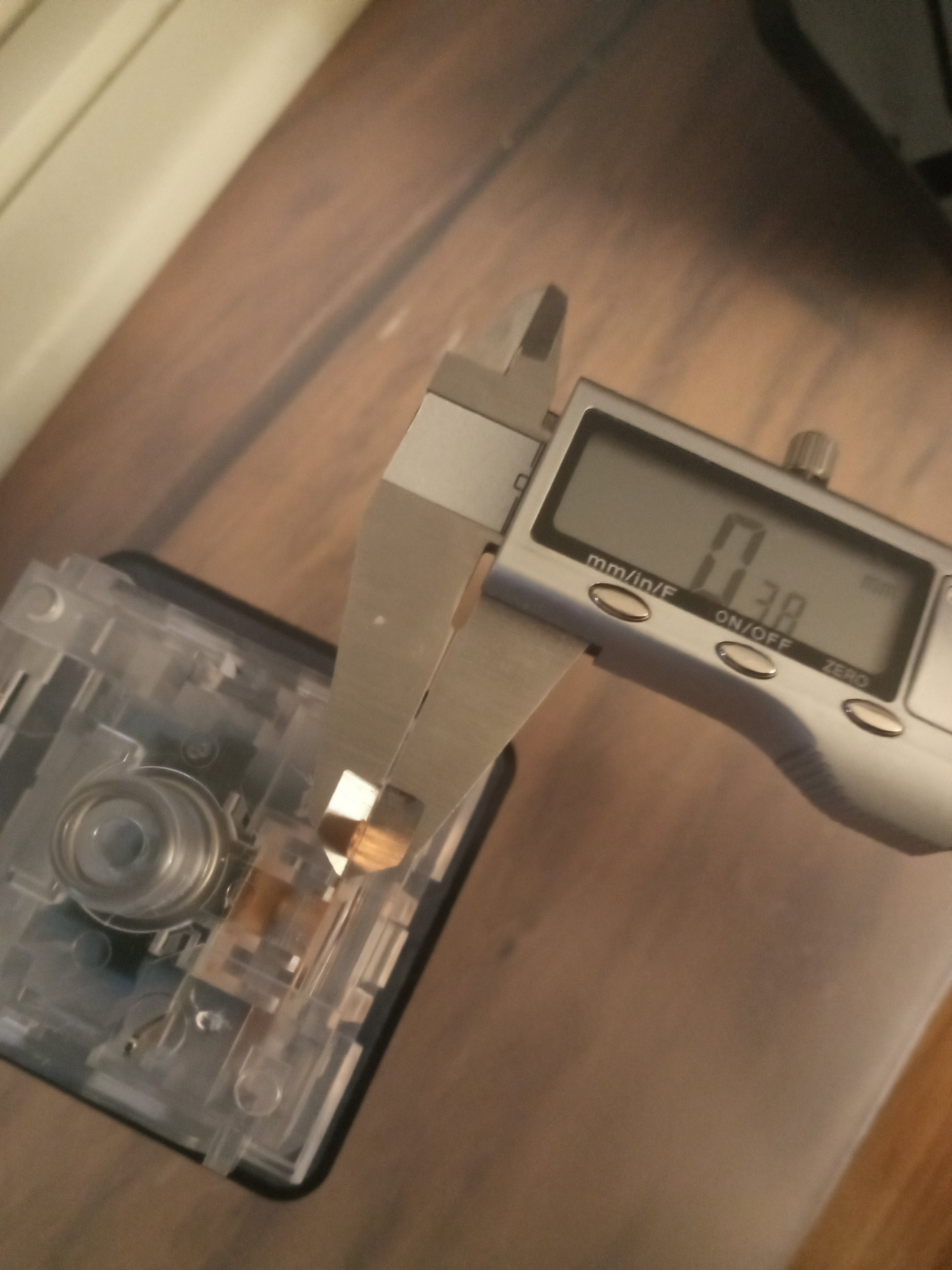

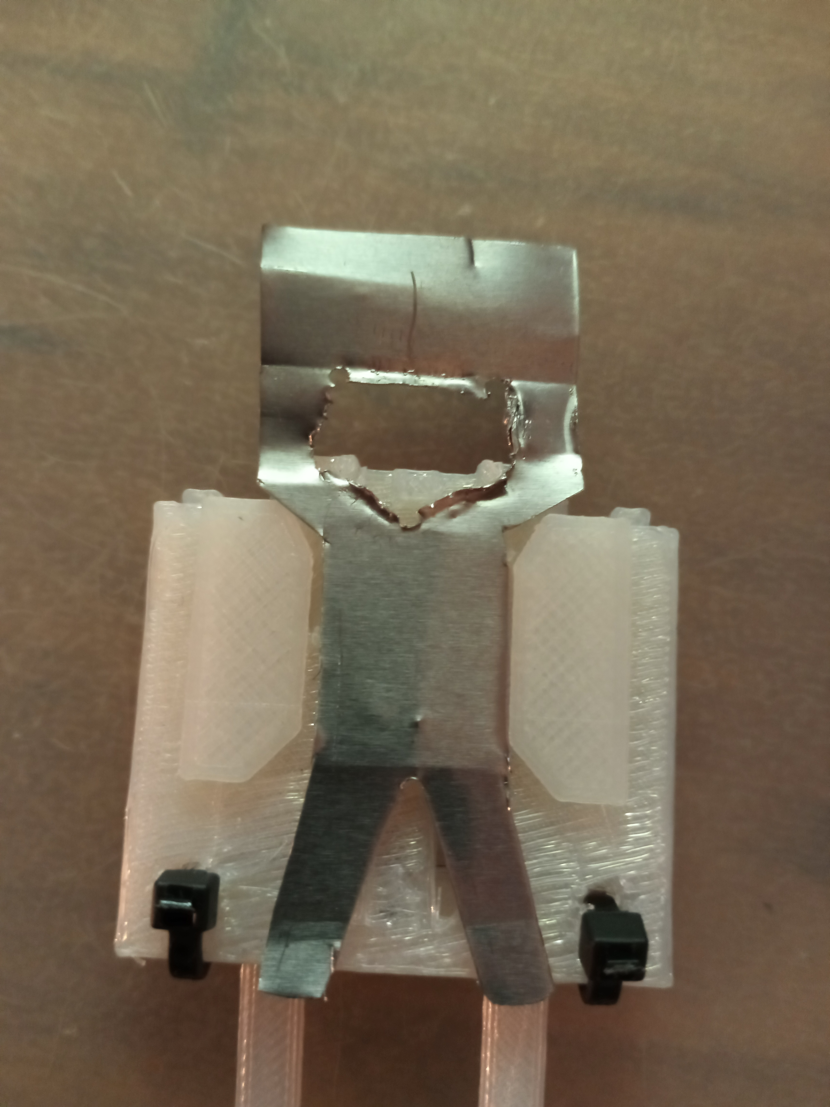

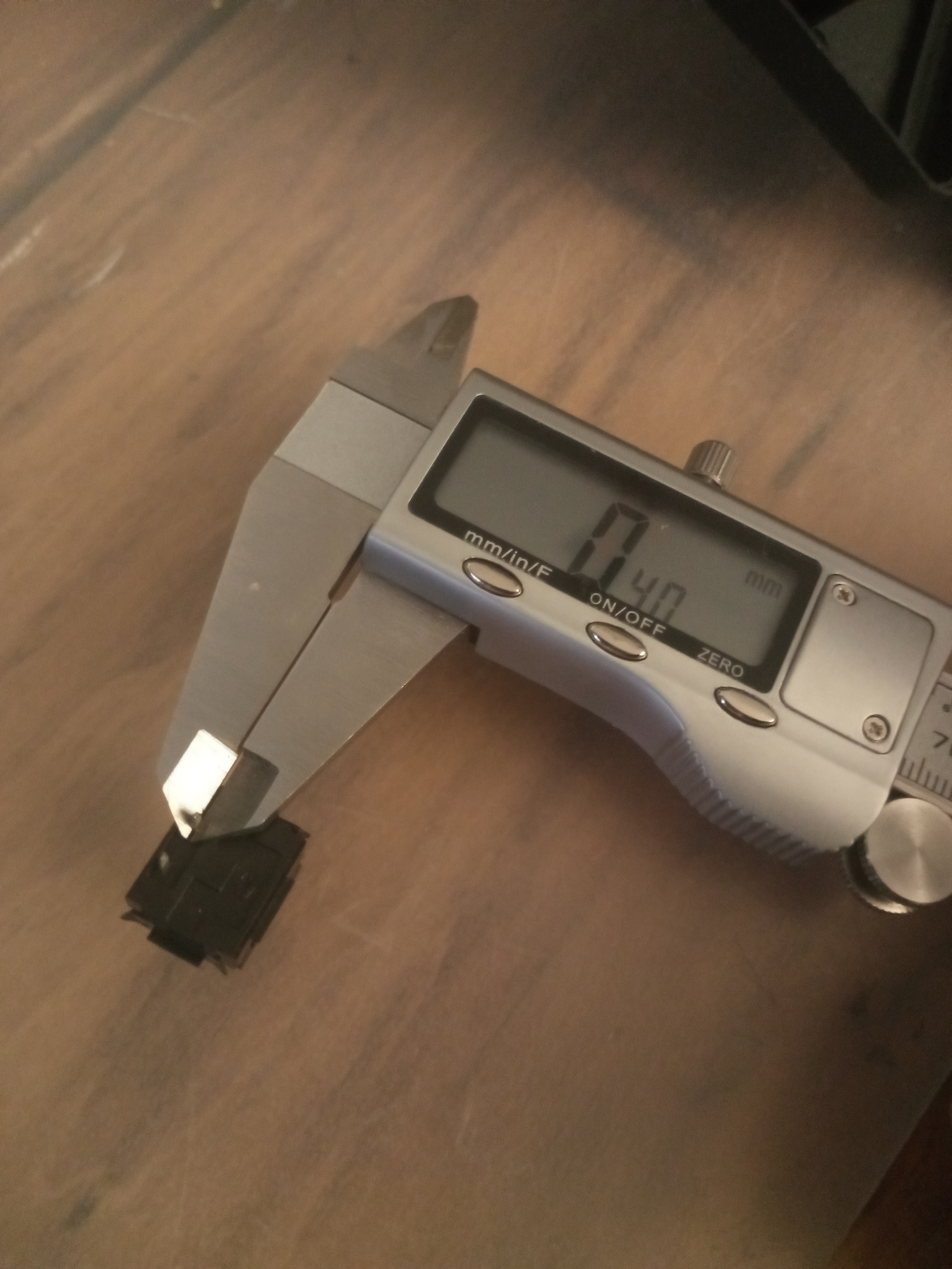

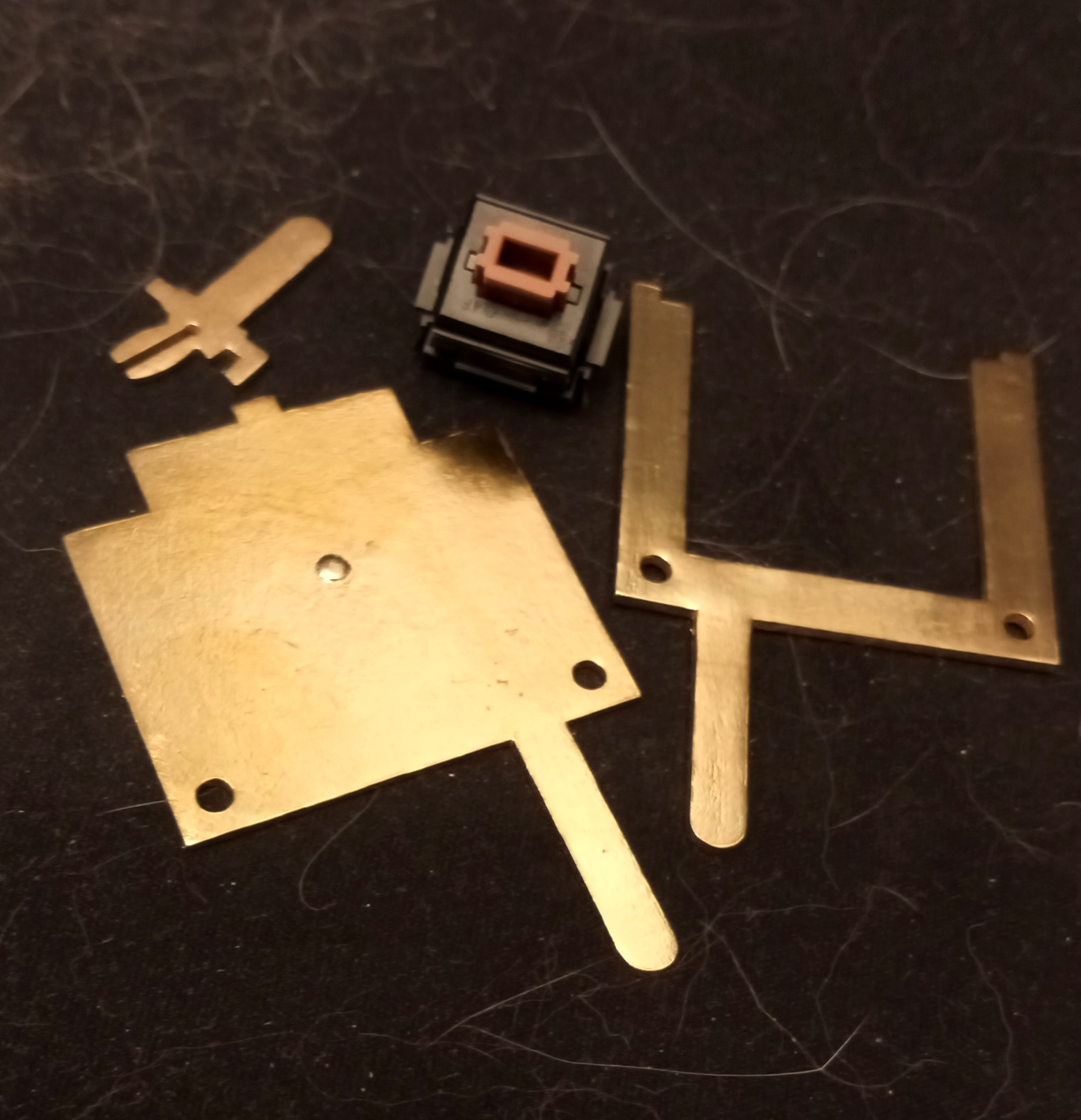

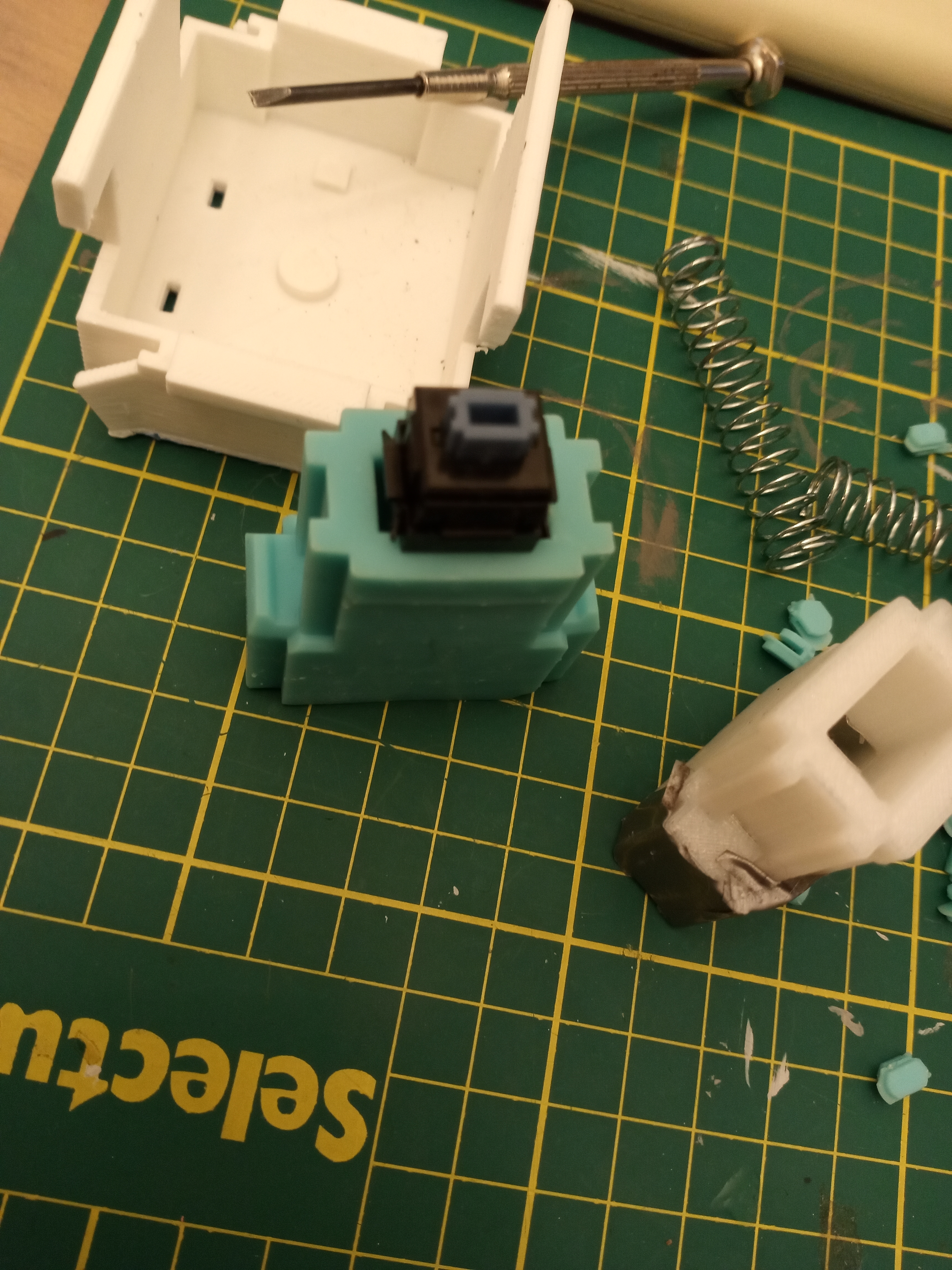

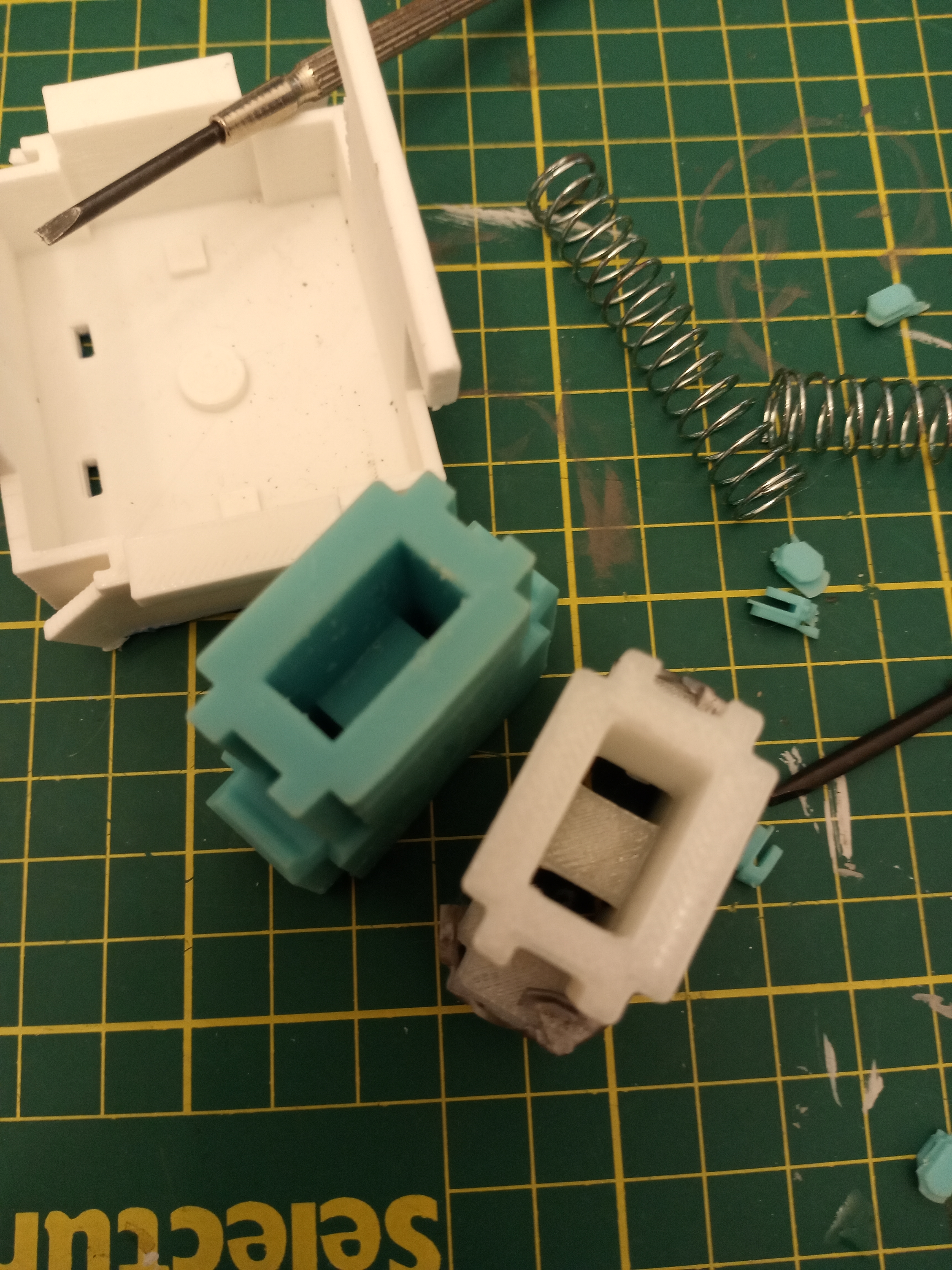

Here is what I mean. Again, this is not a major issue at all but if your switch is complicated it could add some minor headaches later if you design the big one first.
This skcm blue has its contact switch plate thickness here. And this novel keys big switch has a comparable thickness contact.
If you independently designed the big switch then scaled it down the metal contact would be too thin.
Also some metals might stop bending/deforming in the correct way at different scales. They might just crease and fold if directly scaled down. Or not bend or snap if scaled up.
Just something I noticed.

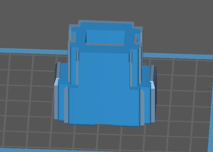

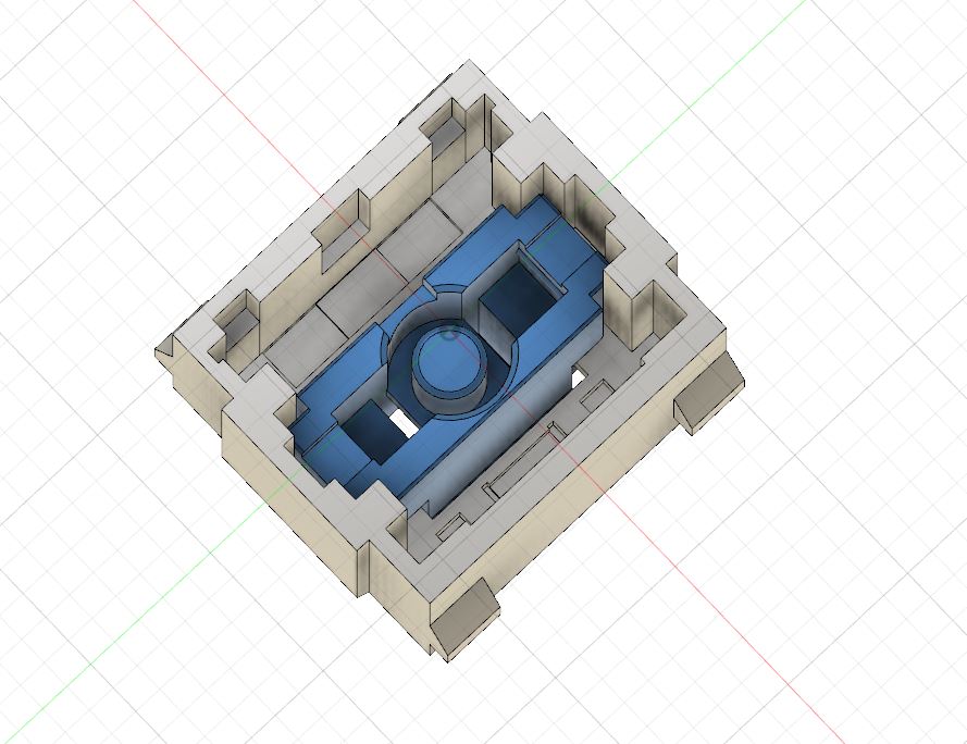

HI,
Hopefully have the printed new bottom part with the correct nub for spring soon.

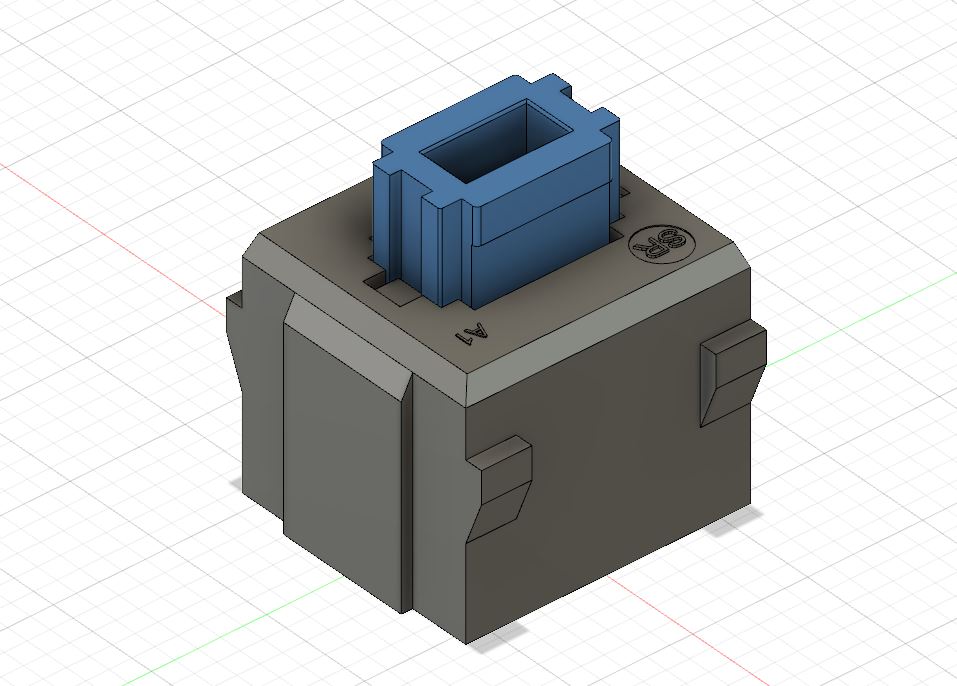

For now I've started to model the switch in fusion360. Here are the STL files for the stem and top housing so far.
I was using a random stem model I found before, but now I have made my own. Which is great.
The upper housing is missing the chamfering, but otherwise they are much more accurate than the previous ones. Must figure out how to share parametric models.
kralcifer has been a great help with parametric modelling and fusion360. It has been great learning how to make parametric models. The ones I have are pretty inefficient, but the abilities the system unlocks are great.
https://grabcad.com/library/skcm-stem-and-top-housing-1

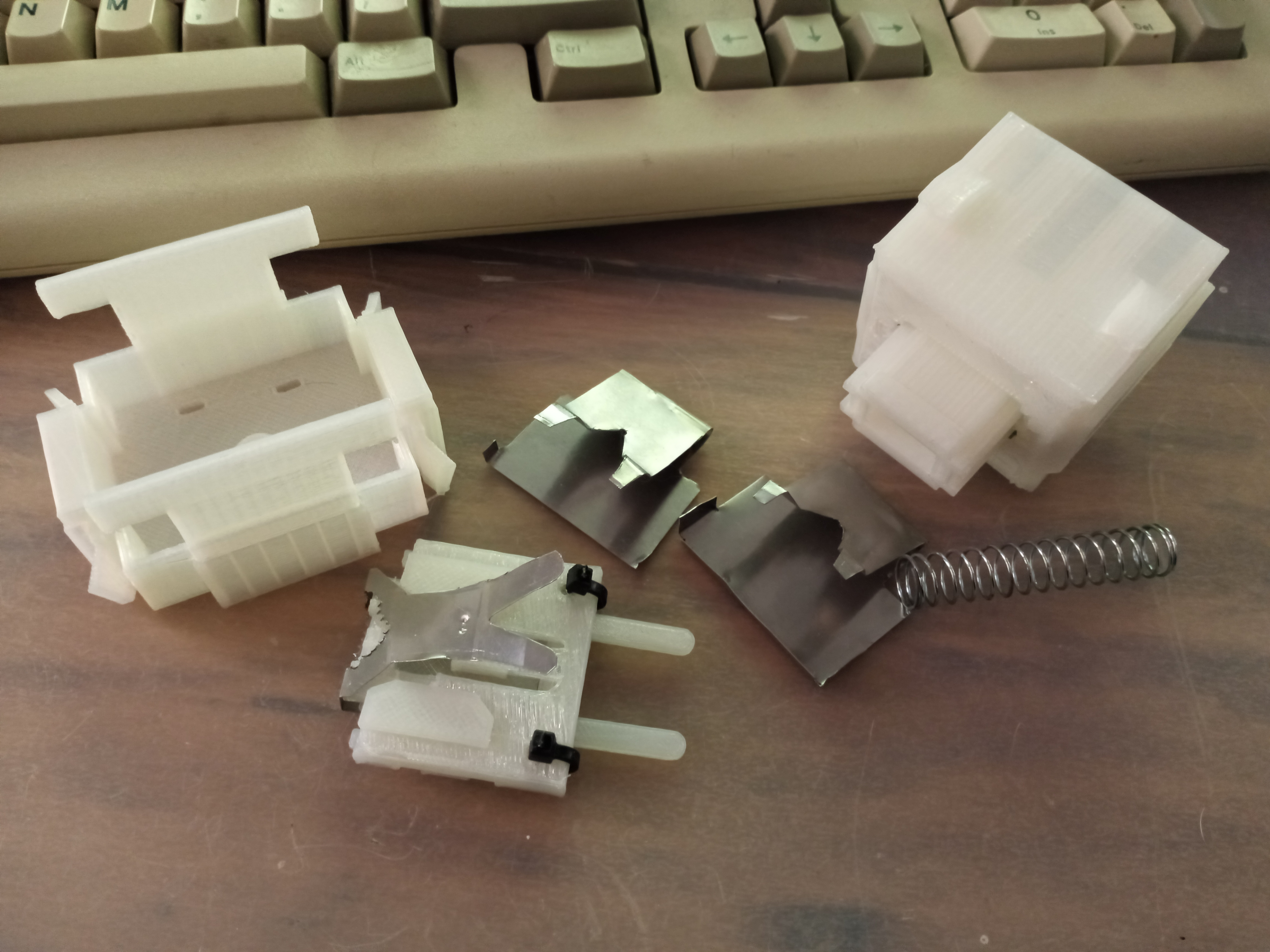

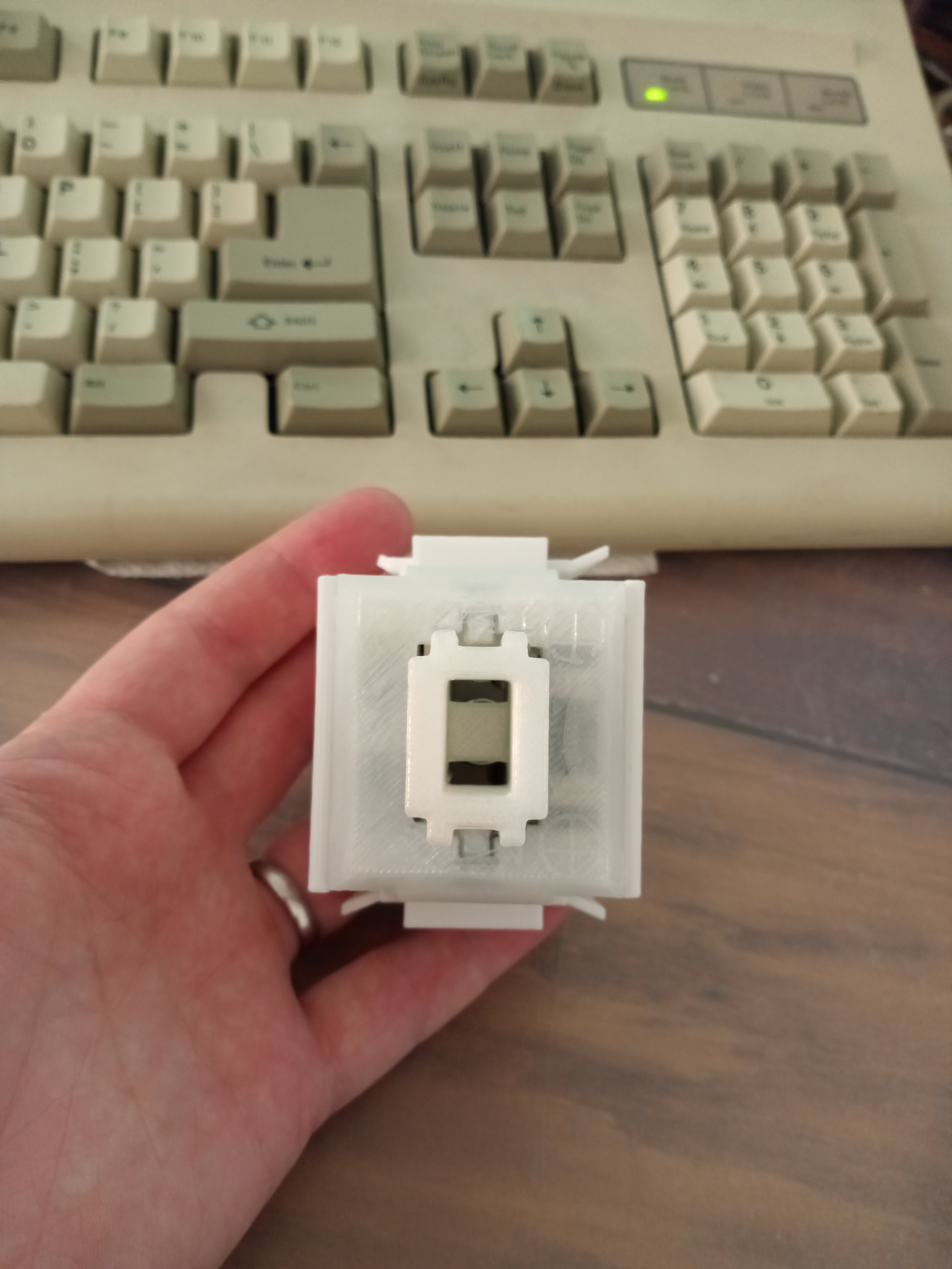

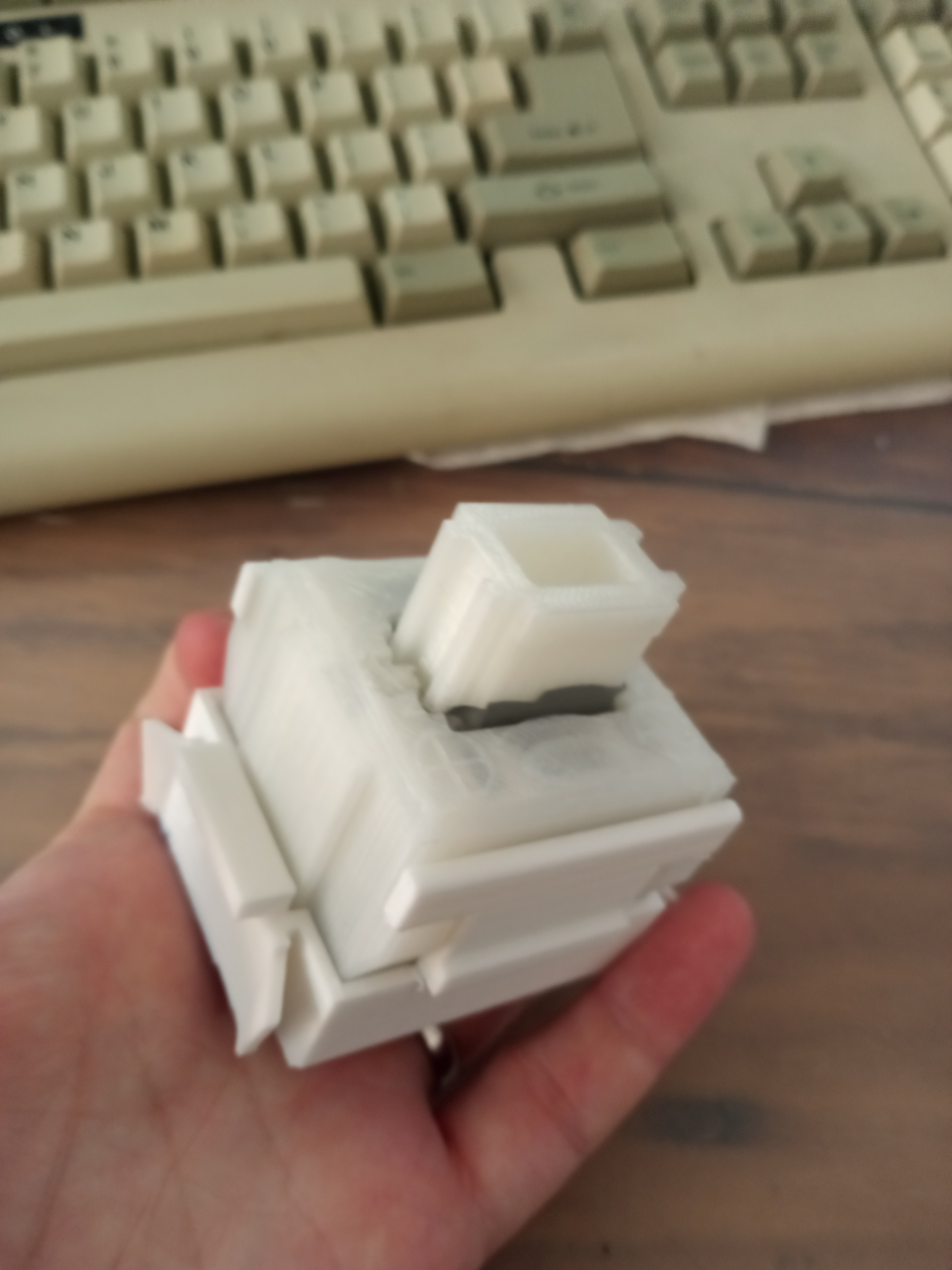

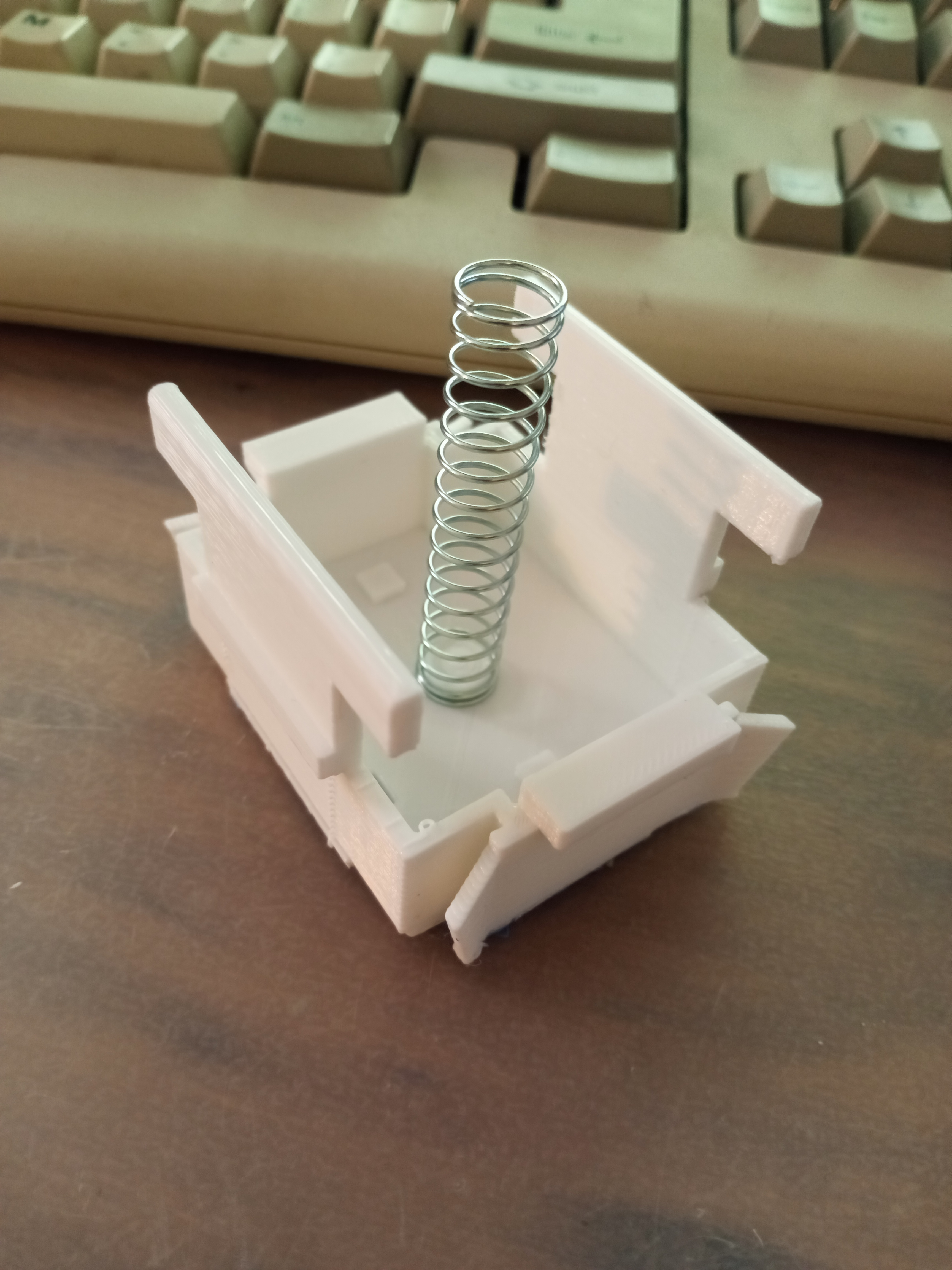

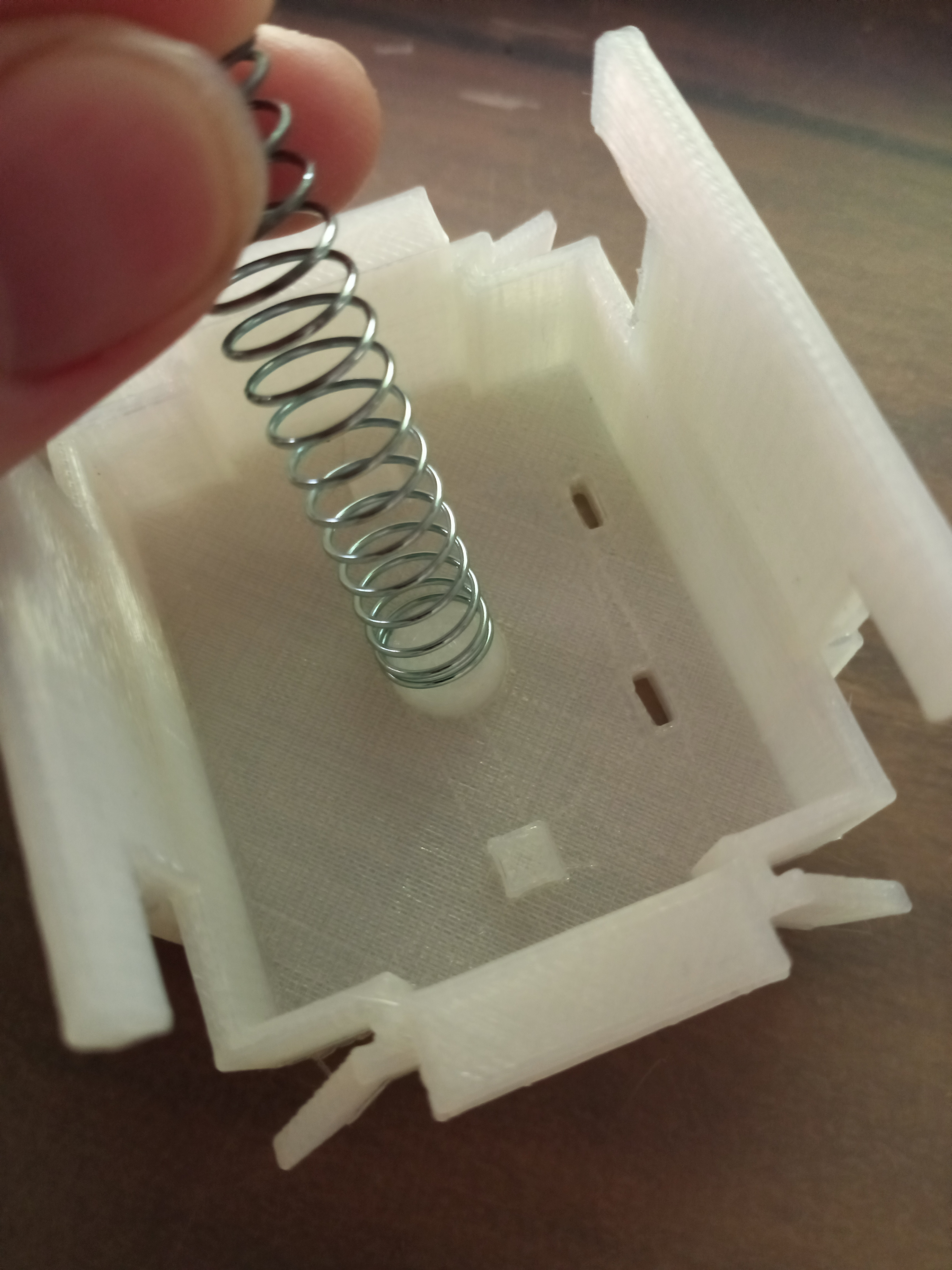

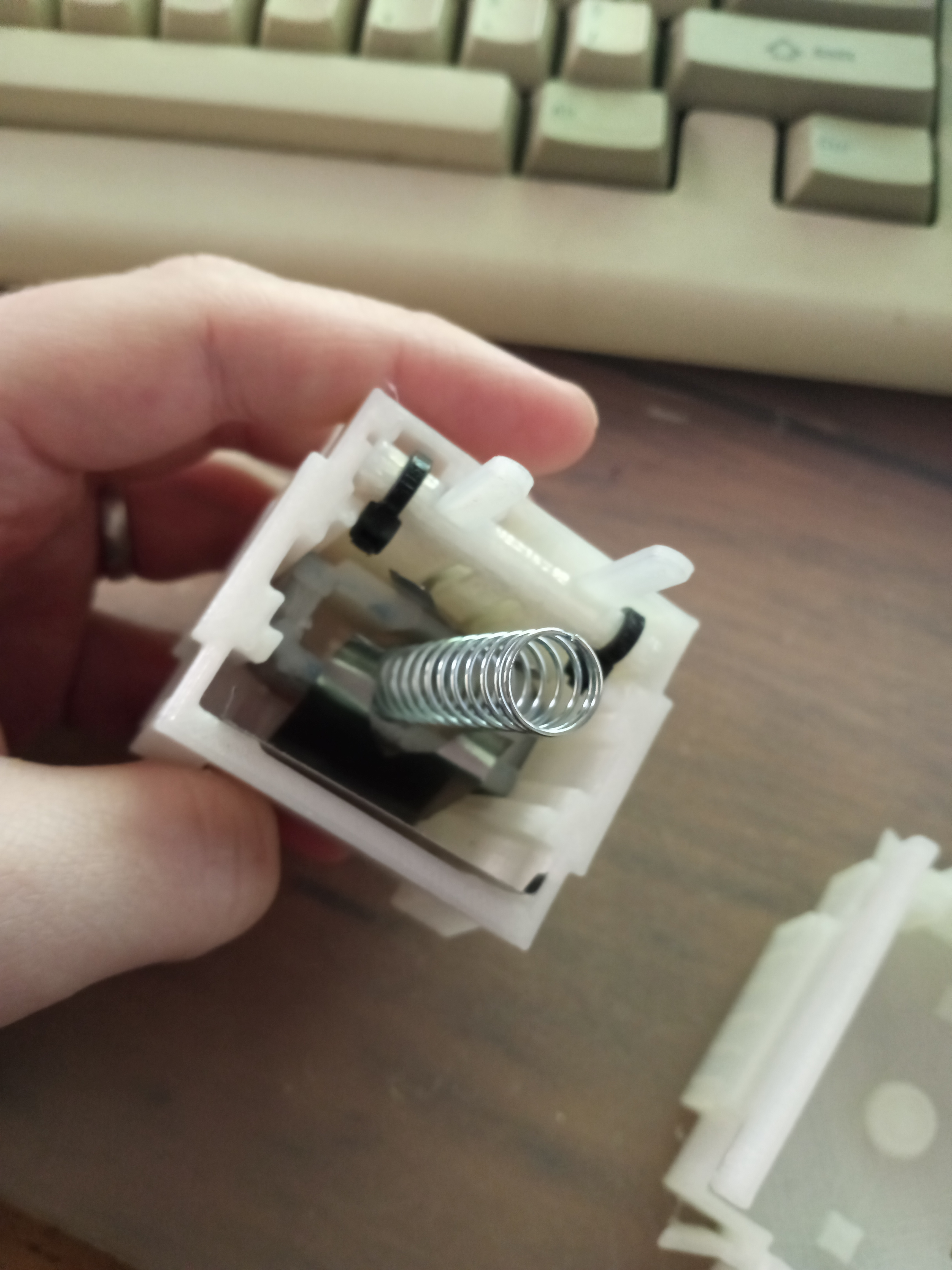

Hi,
So I was able to have the new lower housing part printed. The spring that I got now fits.
Can't remember if I mentioned this was the spring I got
https://www.primeline.net/sp-9705-compr ... ring-steel
Its a bit heavy, but will work for now. The tape on the 3d printing bed came up with the print. A curious colour and a sign of things to come. So lets assemble it It fits and works! Of course almost immediately a corner tab broke I reused the shipping foam from the professional bigswitch to hold it
So prototype number 1 is complete!
What is next
Redo the lower housing in the fusion360
Redoing the switch plate in fusion360

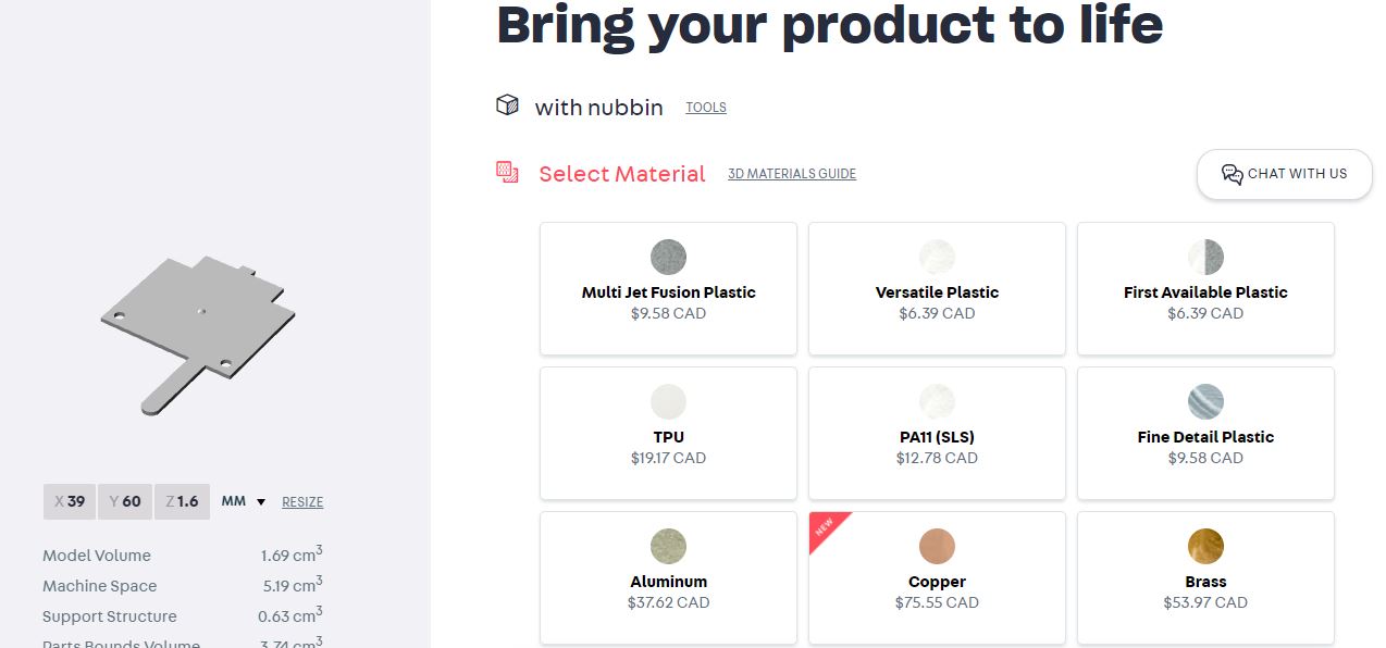

Deciding how to do the electrical connection part. I may get the 2 switch plate pieces water jet cut from steel, unsure.
Testing if the various thicknesses of steel can handle the deformation/metal leaf piece
Get the square cutter I ordered to make the leafspring nicer.
Reliably generate the bump in the leafspring that presses the switch plate
Reduce upstroke click
What is next

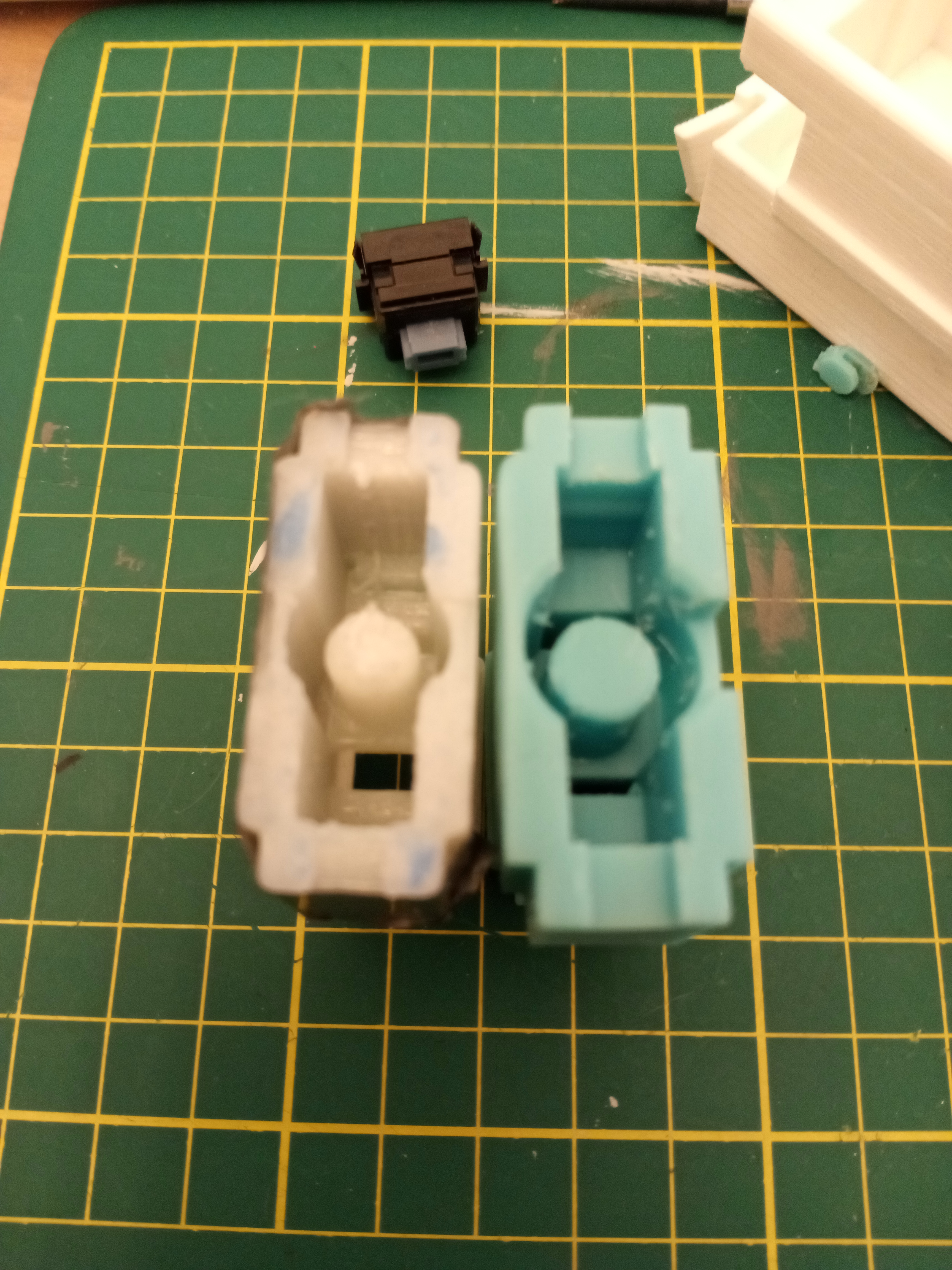

Hi sounds like a great project. My only recommendation is to quote user DMA and recommend you post what you have when you have it. The process is very important and id recommend against posting when your project is done. It's must more fun to follow a project alone vs just a single end product post! There is a reason we buy pistachios in the shell vs pre-shelled! The ones in the shell taste better.M9HM wrote: 19 Sep 2020, 13:25
It is a great project and inspiring for sure. I am in the middle of a project I will post on the workshop once it's finished, I'm curious about how people will receive it as it involves acer switch over membrane and not everyone likes them, but they are everywhere and I can get them for free without much trouble.
Also because of your post I went a head and printed the stem in the blue resin. The colour isn't the same, but heh it looks pretty good!
Also the dimensions are different because the previous PLA one was printed to fit an older top shell model. This new blue one doesn't fit it but it's a faithful model! Very happy with it, aside from the colour it looks great.
- compare 3.jpg (4.17 MiB) Viewed 10866 times
- compare 4.jpg (4.23 MiB) Viewed 10866 times
- stem compare.jpg (23.11 KiB) Viewed 10866 times
- stem 1.jpg (4.03 MiB) Viewed 10866 times
- stem 1 colour compare.jpg (4.21 MiB) Viewed 10866 times

Hi,
Many IRL work so slow progress but still alive. Did manage to print black top housing. Investigating alcohol dyes to match the original slider colour. Working to finish up a good usable switchplate model. Has presented some problems re:bending. Getting a proper bench vise so I can 3d print press dies in order to make the folds for the click leafs, both 4x and normal.
- IMG_20201116_113344.jpg (3.39 MiB) Viewed 10089 times

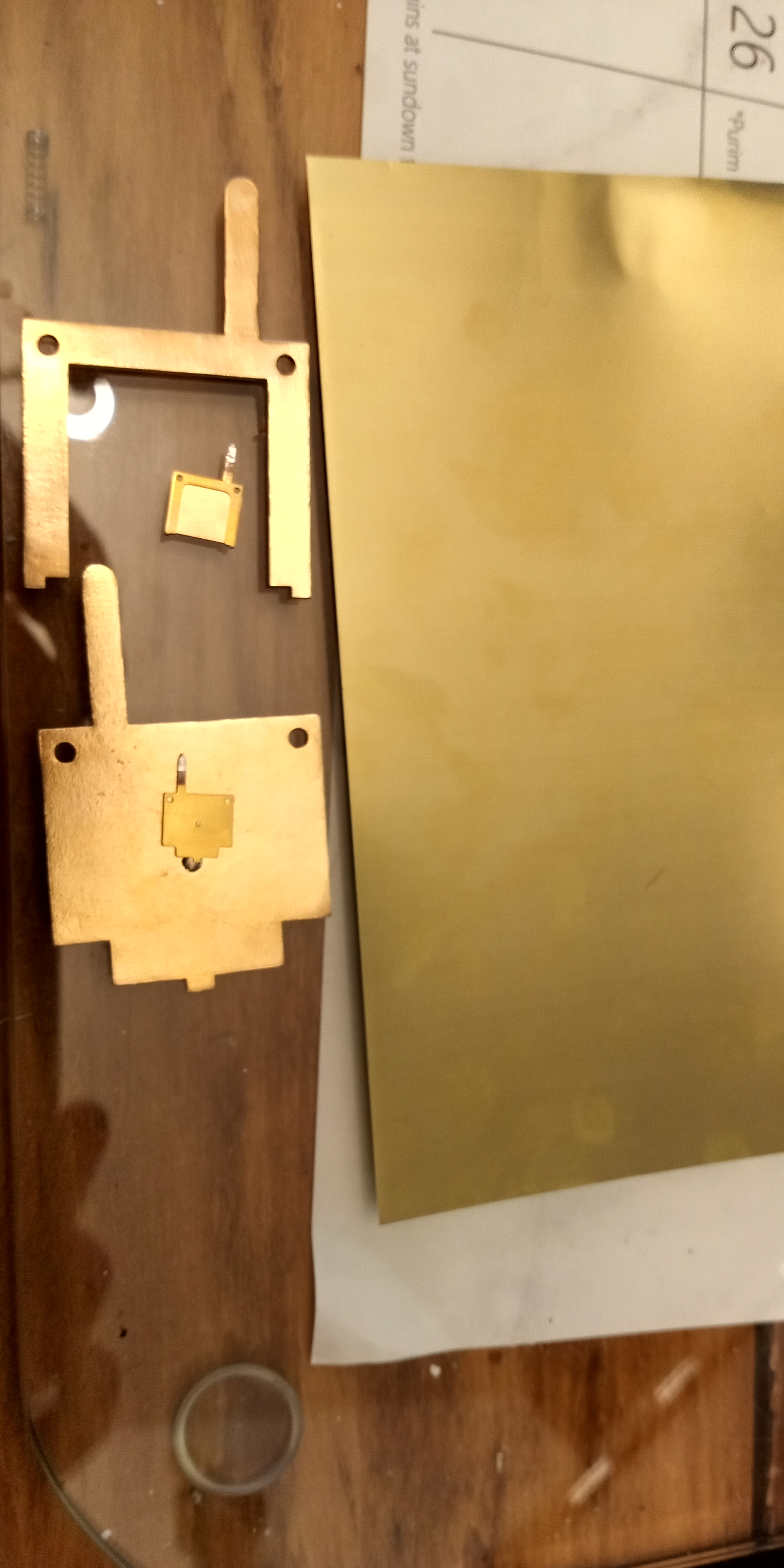

Hi, minor update-ish.
Didn't want to risk going to my parent house where my CNC is due to pandemic. To make switchplate parts. Want to finish this project though. Decided to just drop cash, broke the bank and ordered some brass full size parts for switch plate. Used shapeways, which is extreme expensive. Should take a month to arrive.
Probably could have gotten less expensive somewhere else... oh well. Keyboards. I will buy some brass sheets later to cut the foil from. Then ill likely solder the foil to the fork part. Eventually I will also just use stencil maker to get better click leaf and actuation leaf as mine are quite rough.
Anyway its basically $100 for those switchplate parts... I think it will look ultra-cool when they arrive. I decided to not get gold plated brass as I'm not exactly looking for long term functionality with the switch. As well it will look more original. Excited to receive the parts though in order to make the switch actually functional.
Robb
Robb

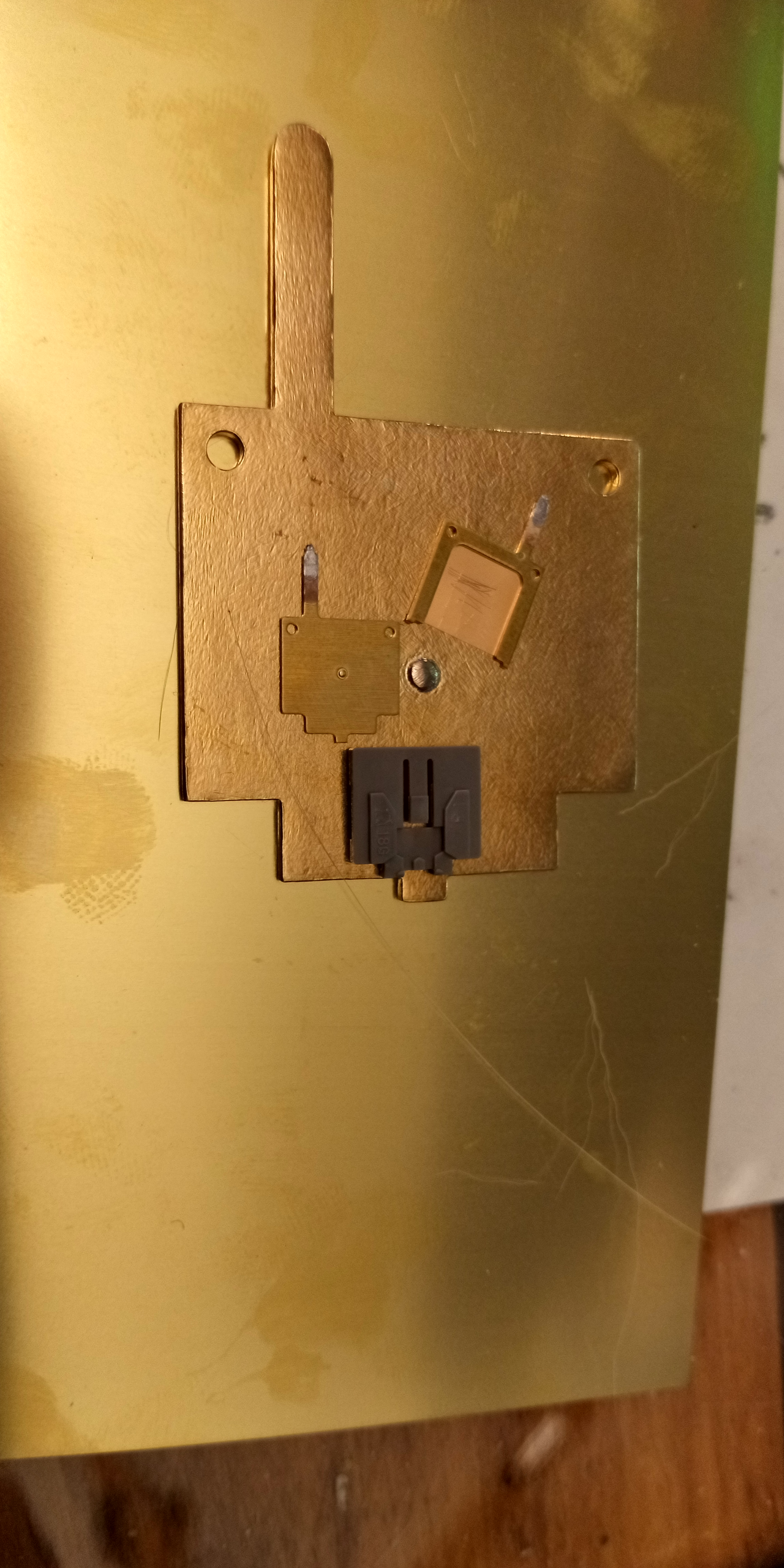

Hi,
So these arrived. Neat.
Will need to figure how to attach brass sheet best. Maybe solder, maybe glue.
I think it might be mirrored... Shouldn't matter! Also cat hair on mouse pad.

Hey, thank lel.
I measured 0.001" for the foil on the original. I will try 0.003" foil for this big one.
I soldering seems annoying. I think I will just try glue at first to attach the foil. I will use siccor to cut the foil and try.
Also it is not mirrored. I just accidentally printed the lower part mirrored. Will make replacement.
