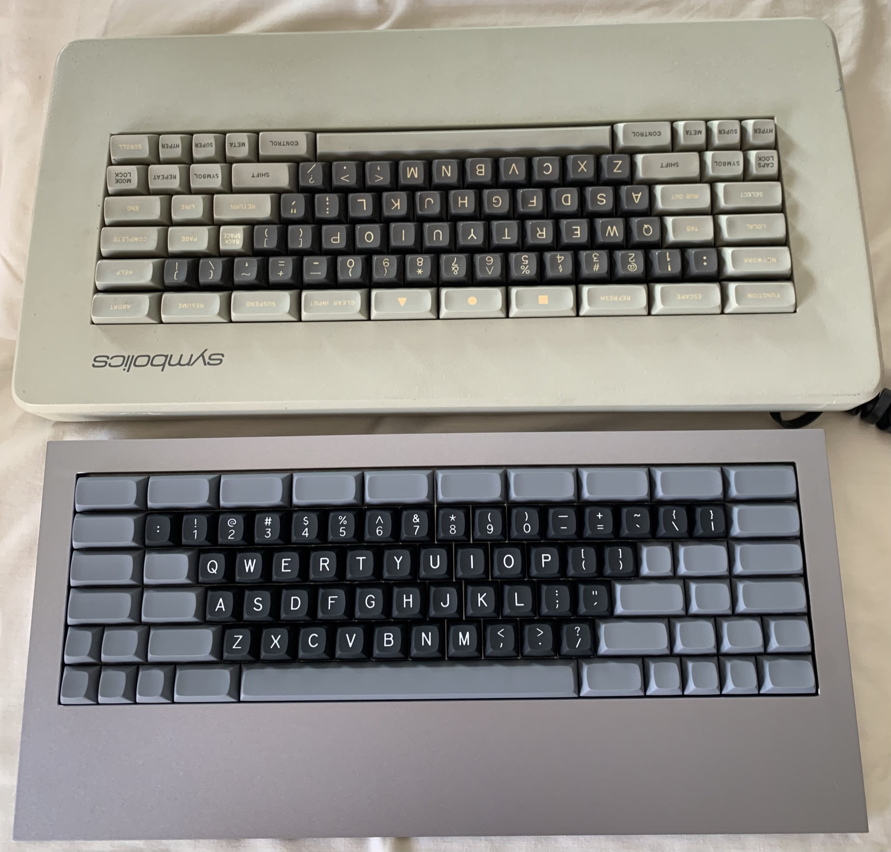

Got it out of customs. Here it is with a senior relation.
It's interesting; there is a bit of scuffing on the L key. Probably not visible in the photo. I'm not bothered by it, but now I'm curious what happens after the key caps get used for a while. What have you found?

MMcM wrote: 01 Apr 2021, 18:31 Got it out of customs. Here it is with a senior relation.
The material has Shore hardness 70D, so it is a bit softer than ABS. It can be scratched but I did not experience that during a standard use (I use mine about a year as the main keyboard).
