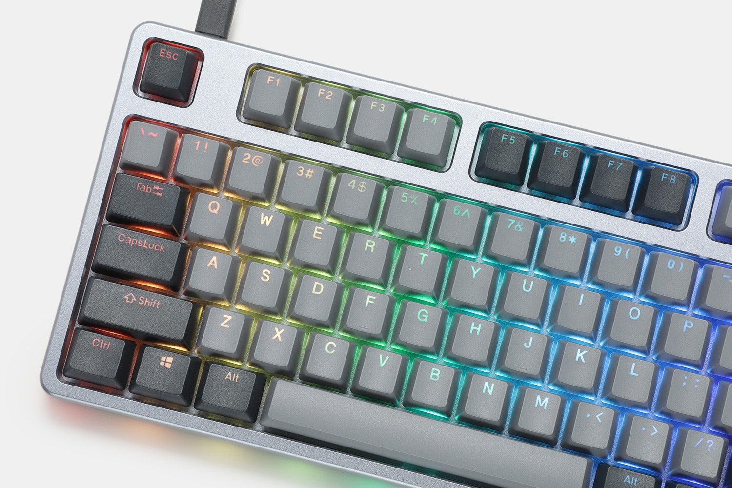

Findecanor wrote: 24 May 2021, 08:42 I don't think the strange-looking PCB design is a result of cutting corners, but more of the designer's (lack of) style ...
I've never heard about any problems leading from the ugly routing though.
My accusations of cost cutting mostly come from the quality of machine work. They used too large a cutter on the high profile cases. The corner should be tighter, but instead they just increased the gap on all sides to work around the radius of the larger cutter.
It looks cheap and the stabs are poor. Boards like the Hansung TFG line show that better fit and finish can be had for $100 less. The standard CTRL may well be competitive in it's price range though.
Edit: I could not find an official close up image of the Hansung TFG ART so I poached one from reddit. Those are no the original keycaps, but the tighter tolerances should be visible.

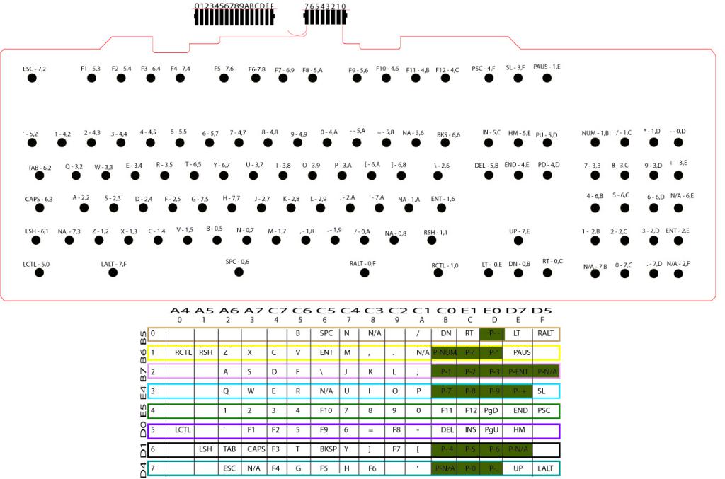

Well designed 2KRO boards, like classic Model Ms, are fine with many combos like Shift + Alt + Arrow keys because they were designed well to prioritise the modifier keys. Rollover is an artefact of the matrix design, the logical layout, rather than the physical layout. So if you separate important keys out a bit in the matrix, you can score extra key presses while still remaining technically 2KRO.
Here's how IBM did it on the Model M:
Nice and roomy around those Control and Shift keys, as it should be. They won't block or ghost, because the relevant cells in the matrix are simply empty!
But the Model M is still 2KRO. Just try mashing the WASD keys on a vintage Model M. IBM had no idea some kids writing videogames would use those in lieu of arrow keys! They block badly, proving the board is still just 2 key rollover in the worst case; which is how rollover is defined.

Muirium wrote: 24 May 2021, 14:06 Nice and roomy around those Control and Shift keys, as it should be. They won't block or ghost, because the relevant cells in the matrix are simply empty!
Thank you, thank you, thank you for that graphic. We'll use it in the video, it illustrates the point about prioritizing the mod keys well and I have upgraded the explanation in the script to match.

FADE IN: download/file.php?id=55938
Model F keyboards, both old and new, have unlimited rollover
and never ghost. For model Ms, it's more complicated. They
never ghost, but their rollover is limited. Most variants only support
2-key rollover. However, modifier keys like Shift, Control, and
Alt have their own traces so they don't count against that limit.
As you can see from this diagram, the WASD cluster that many
modern games use as arrow keys does *not* have its own traces.
That's because the Model M was designed well before that convention
developed in the 1990s.
FADE OUT
