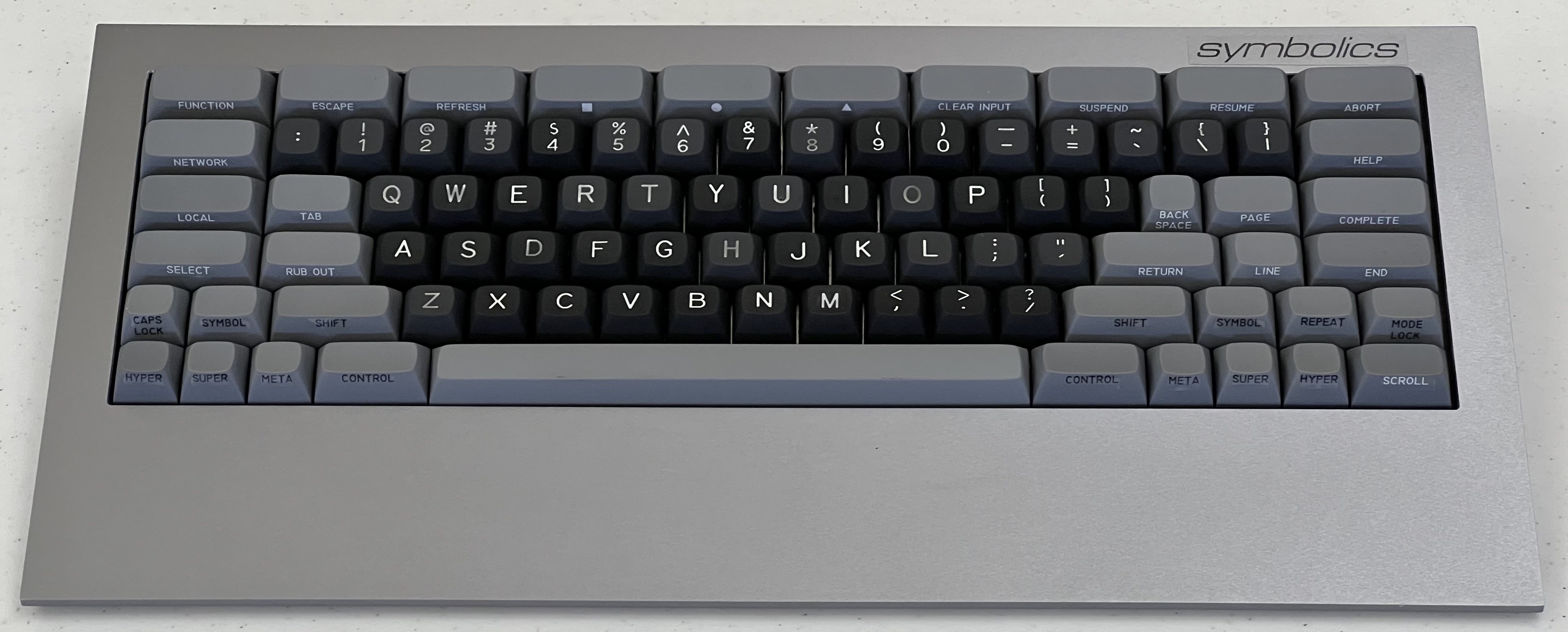

lispnick
01 Oct 2022, 13:55
Ok, here you have it: Keycaps and additional keys.
I will start the manufacturing in Jan 2023.
