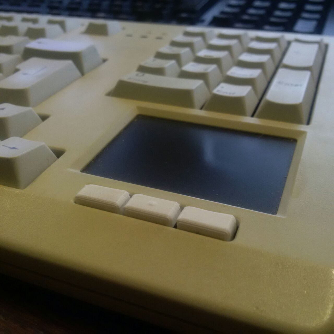

Third mouse button is just wired to the matrix as an additional key. And you can scroll with it like on a thinkpad.

The middle mouse button has a tiny bump on it to help locate it without looking.
30 Jul 2023, 07:26
browncow wrote: 29 Jul 2023, 22:54 The middle mouse button has a tiny bump on it to help locate it without looking.
[photo]
I don't quite see the use of a bump there, would one not cover all 3 keys with 3 fingers anyway (and feel misplacement at once)?

i found that the keys are now a little bit to small to be comfortable, and i often had troubles not pressing the left/right one by accident

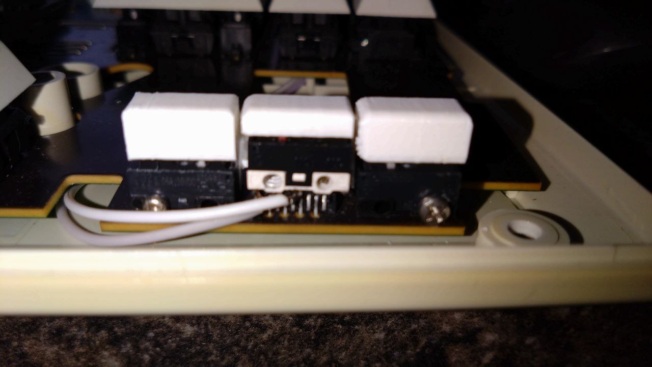

Here's a closeup of the third mouse button assembly with the printed keys/holder. i went through few iterations, thinning out the "hinge" on the keys, because it was way too stiff.
cicistrici
13 Mar 2025, 12:36
browncow wrote: 01 Aug 2023, 23:07 photo_2023-01-15_13-20-10.jpg
Hey! This project is completely awesome! Do you still have your code?
I'd like to use an ESP32 module with bluetooth, and did the same connected the 2 multiplexers, but basically stuck here, I've no idea how to do the scanning of the matrix.
